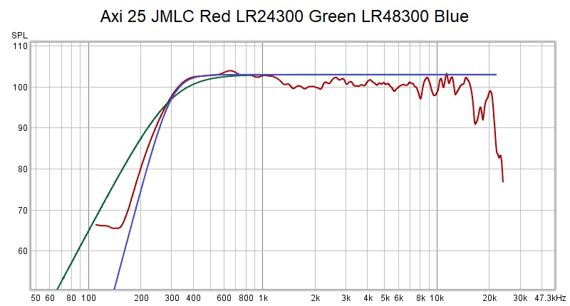

So going back a few pages, and looking at the pdf spec sheets for them, what are people's views on the Celestion horns that are available for the Axi2050?
Would they give a good domestic room listening experience, albeit not crossed as low as 300Hz? Probably looking at crossing at 450-500 Hz to a 15" in a BR enclosure with an active sub or two from 45-50 Hz down.
Would an Autotech EJMLC or similar be a better bet in this situation?

What is your goal Keith? The guy from diy sound group has a pair of 300hz 2" ejmlc hes getting rid of but I haven't communicated with him in a while so that might of changed.
Well I have the Axi on a 200Hz JMLC over an OB 18" at present which is fine as it's in a dedicated room.
However, we are 80% certain to be moving and the hifi will be going in the living room so I need horns that are better finished such as the Celestion ones or Autotech. My wife is ok with the look of the Celestion and they only come in black now but wondered how good they will sound if anyone can judge that from the polar plots posted earlier in the thread. The Autotech EJMLC is also approved and I wondered if this would be better?
Celestion will go down to 400Hz and the EJMLC300 has a lower cut off of 500Hz according to the website so I would be looking to put a 15" in a BR cabinet as I wouldn't want to take the Fane Colossus 18XB up to 400 or 500.
What are good combinations of horn for the Axi and which 15" in which BR cabinet?
Is the present 320Hz too high for the 18" XB anyway so will be better to go for 15"?
If the 18" XB would not be bettered by a 15" what alternative horns are there out there for the Axi? Has Joseph Crowe made his prototype for the Axi yet, how low will it go and more importantly how much shipped to the UK??!!!!!

Camplo, I have added some textbook crossover slopes onto the Axi2050 in a JMLC 250 Horn measurement to give you an idea of what they look like. The rolloff shown in the bare measurement is very close to LR48 300Hz, for comparison there is an LR24 at 300Hz. I think 300Hz is quite achievable with that driver, 200Hz would be more of a stretch and could be output limited if that is an issue. The impedance peak shown on Celestions website on their horn is around 250Hz so pushing below there might be more problematic.
