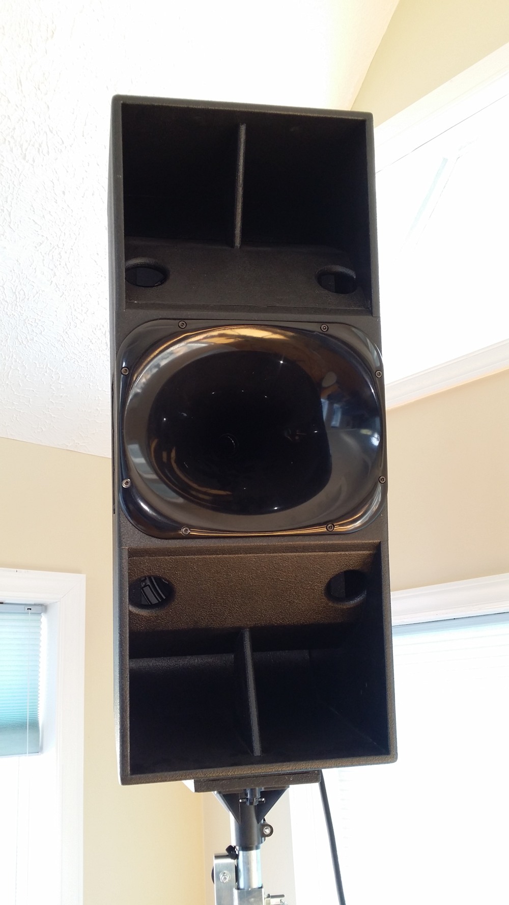

A particular MTM with the XT1464 has been my model and the box to try to beat for several years.
It's been the Peter Morris PM60 (with XT1464) and PM90 (with HF950) horns using two horn loaded 12"s ....
They simply rock, and image as well.

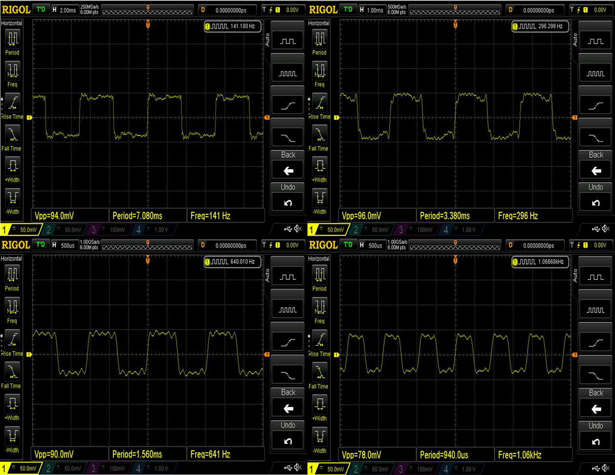

Below are a set of measurements made from one, recently put up on the Square Wave thread.... good square waves are even harder to get than flat mag and phase traces...
I've also made modular MTM's, MMT transmission's, and simple MT's, all with the same drivers.
All measured nearly identical in the far field where imaging becomes optimal (>3x longest speaker dimension ),
but the MTM's "virtual vertical center" gave it a bit of an imaging edge.

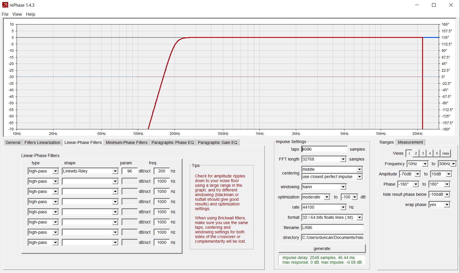

I have attached two screenshots from rephase showing an LR96 linear phase crossover. With no optimization 16384 taps is needed to get an exact match to the textbook slope. You can see that the red and blue lines are virtually on top of each other. Blue is ideal red is actual. That gives 185ms latency, so less than 2/10 ths of a second after pressing play before sound starts.You nailed it on the crossover stuff. I will be using minimum phase because I won't tolerate the excess latency of FIR processing. If I was shown otherwise I would consider it later I guess. My amps have build in dsp that is minimum phase.
If that is too much with a little optimization, you can get the same exact match with a 4096 tap filter and 46ms delay. You could take it further if 46ms of your time is too precious to waste after pressing play to hear sound 🙂
The flat line through the middle of the graphs is the phase response.
That being said minimum phase LR4 acoustic is still a good target.
If you want to go MTM then I think you should seriously consider putting the waveguide in the box with the woofers for the reduction in diffraction or if nothing else just to make it easier to build. Diyuser's speaker above is a very good model to start from.Don is already on it with the horn roll back. The best I know to do for the box is to put the angle or round over on the edges.
You would say that 😉 No offence was meant by it, your's is the build I was referencing and I think it is very well thought out. I came very close to buying 4 15PR400's after seeing it as I have the same horns sitting around, who knows maybe I still will 🙂Not overkill, in my opinion.
