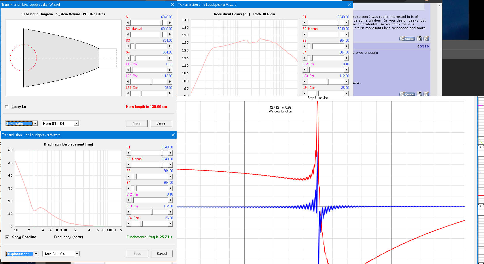

Thanks for that. This is my first look at this type of enclosure and I'm enjoying the exploration. I thought I had to enter a known value of Fr but I see from playing with your model that HR calculates the lbs of polyfill needed to get the Fr entered and the achievable Fr range with polyfill is 100 ++ which is what Camplo needs to get his response. Except for the size, these things are almost too good to be true.
And David clued me in to use of F9 key to export SPL data from the Tline wizard so I can see a real IR.

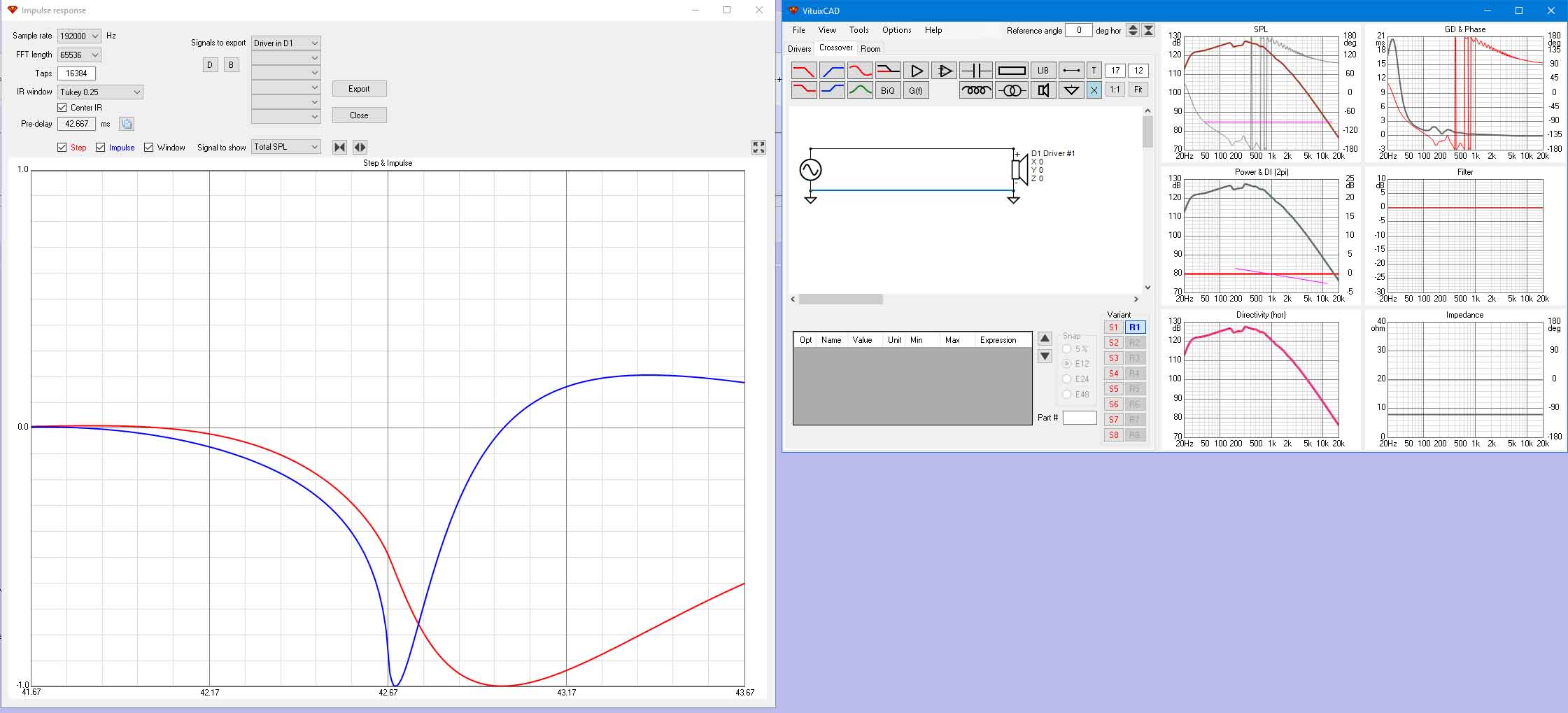

Welt, I don't know how to use VituixCAD...thats obviously not the correct impulse/step responses.....

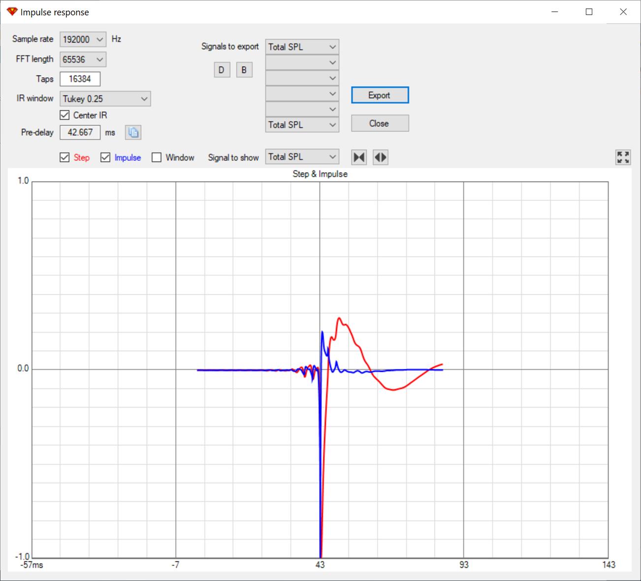

RIght, its not. Sorry I didn't get back to you sooner. Here is what I have:
attachment.php
This a normal IR but inverted.
Now let's figure out what you did wrong!
In HR, did you F9 in the wizard power screeen to export the SPL as a text file?
In Vituix mainscreen after clicking crossover, your schematic should just be a wire from the generator symbol to the driver symbol.
In Vituix mainscreen after clicking driver, to the right of the the bold "frequency response", use the browse button to get to HR export directory and select the file you exported earlier.
You should now see the same FR as you had in HR in the SPL window.
If so, then selecting Impulse Response from the View drop down should show you the IR I show here.

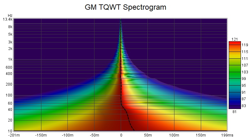

If you export that from Vituix, you can import it to REW as a .wav and see IR spectrum, which looks like

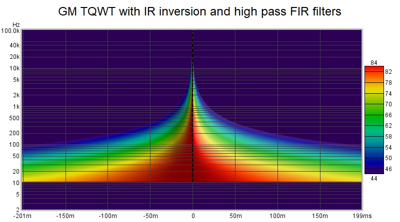

If I do some trace arithmetic in REW to model FIR filtering, I get this, which is what I mean by too good to be true:
attachment.php
I took the IR exported first from HR and then from Vituix and inverted it with REW "1/A". Then I did A*B where A was the original IR and B was the 1/A result. This produced a flat line as expected. Impulse inversion EQs the response perfectly flat. However that is too much EQ, so its necessary to convolve in a bandpass filter that limits the EQ. I had a room response curve already prepped with a high pass at 20 Hz and a slight downward tilt at 100 Hz and used that. You would likely want a low pass filter at/around 100 Hz but it seems to me you could go higher, perhaps high enough to not need the TD15Ms.
If doing this with measurement instead of a simulation, the pictures wouldn't be so clean and there would be choices to make about how much smoothing and gating to use on the measurement before IR inversion. A program like DRC can do the IR inversion and windowing with more sophistication to produce a filter with less ringing, I see some of that in the IR of final predicted result.
813020d1580473526-cover-spectrum-spl-low-distortion-2-a-gm-tqwt-spectrogram-jpg

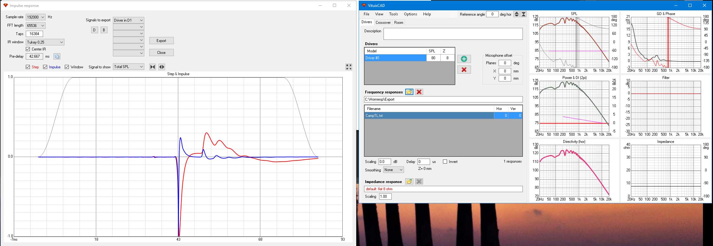

So I made it this far, sorry but I'm completely green to this app, I need to learn it more....for example I didn't know I needed to connect wires in the crossover to make it show a FR....so now I've added that step, this is the impulse I get...I'm sure some other setting is off...some setting that I don't know about with my....=/
Ok, ty so much for helping with that! If I could only figure out how to get the impulse to be "right side up"
This response looks strange....I'm not 100% on how to translate it...is it ringing?

have you tried inverting the polarity? as in simply reversing the connections to the driver your testing?
That was my first thought, I just didn't figure out how to...I know photoshop though lol

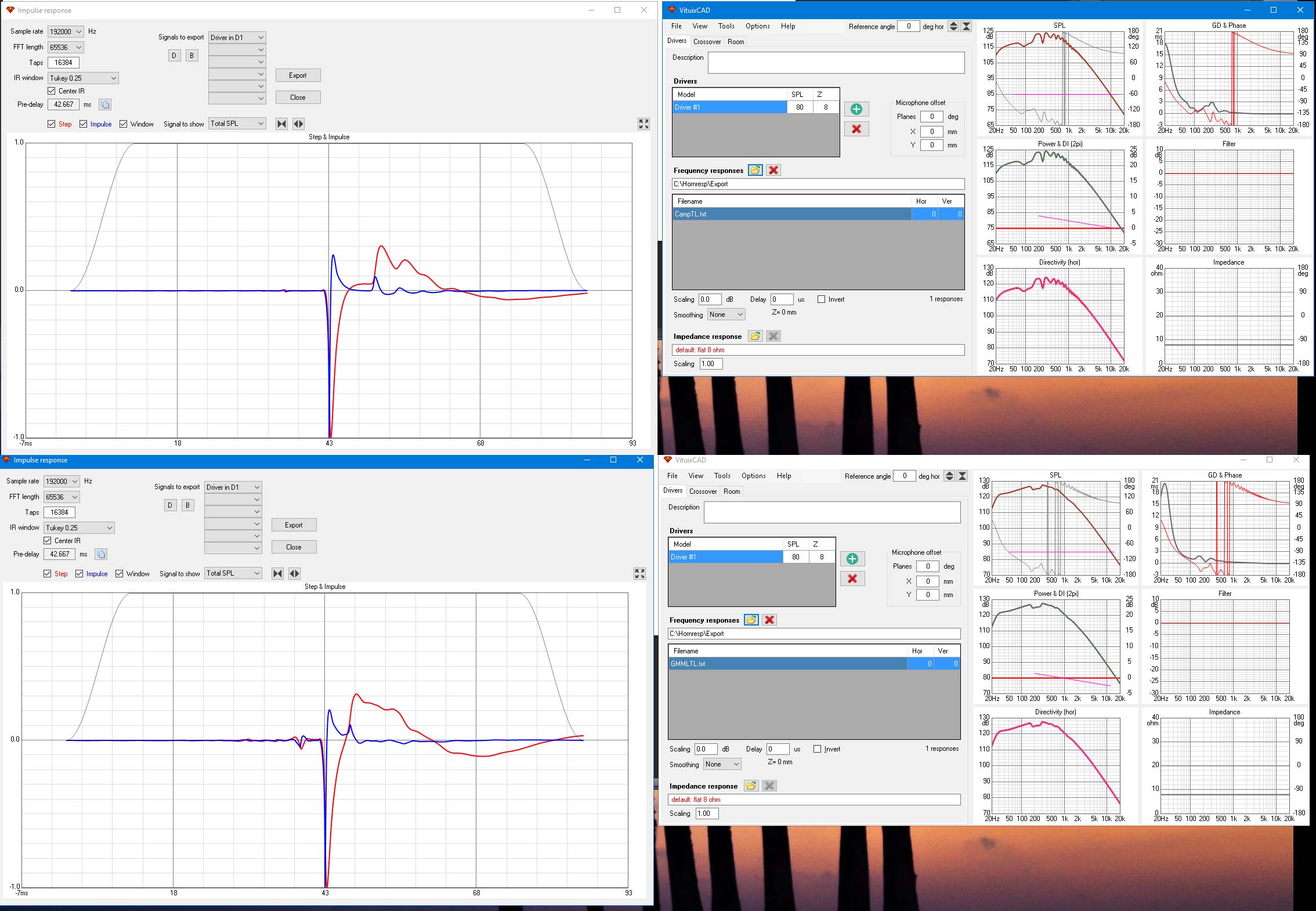

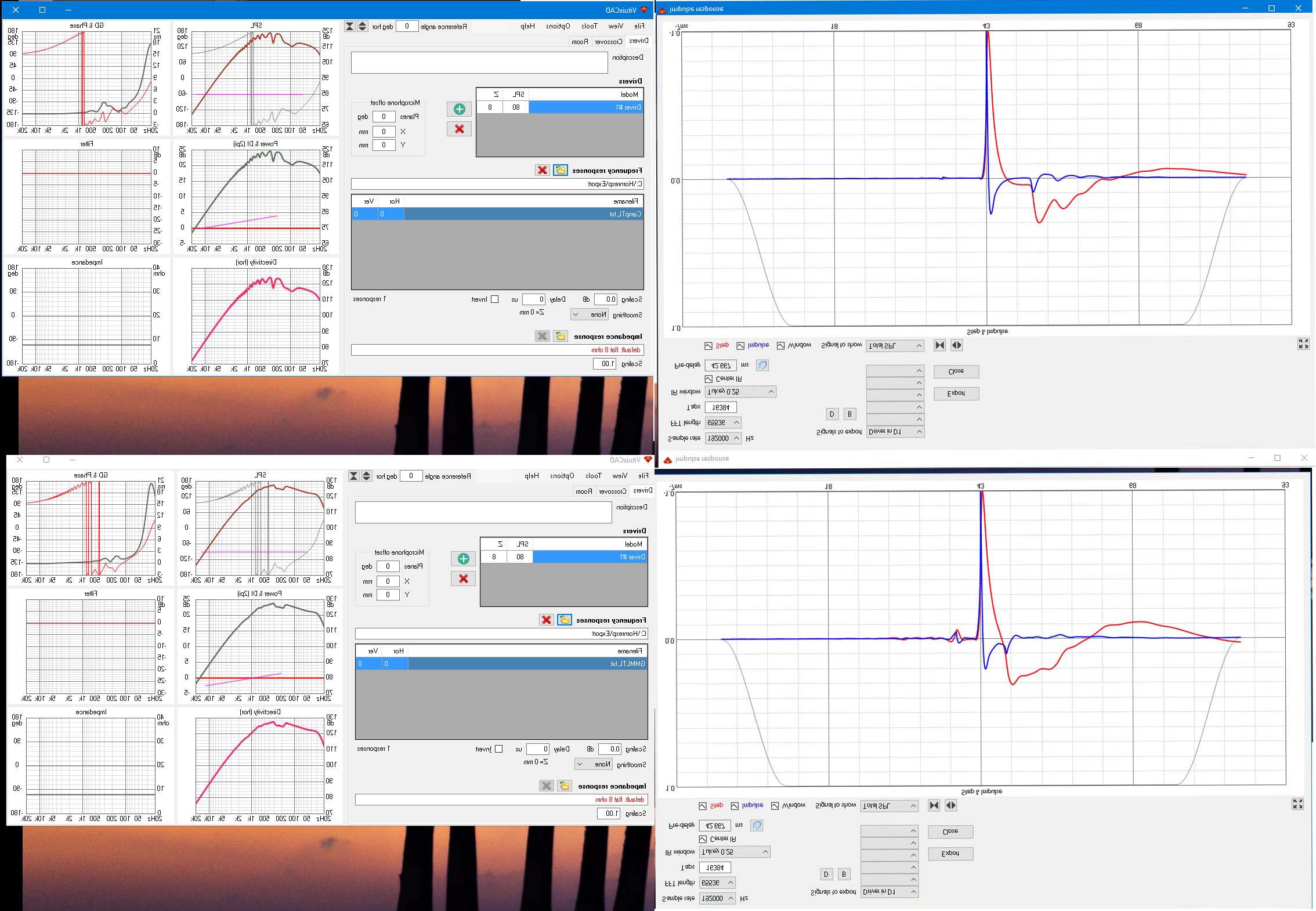

Can I get some wise eyes on these impulse's please? I can't say that I fully educated how to interpret...I do understand some but it would be nice to hear the experienced opinion.
In my opinion they both look ok...the strength of the qts is obvious...one has much more decay than they other...one has more over shoot than the other...step response is still little foggy for me but obviously one has more bass response than the other.
