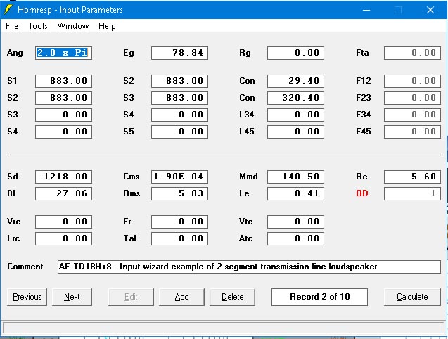

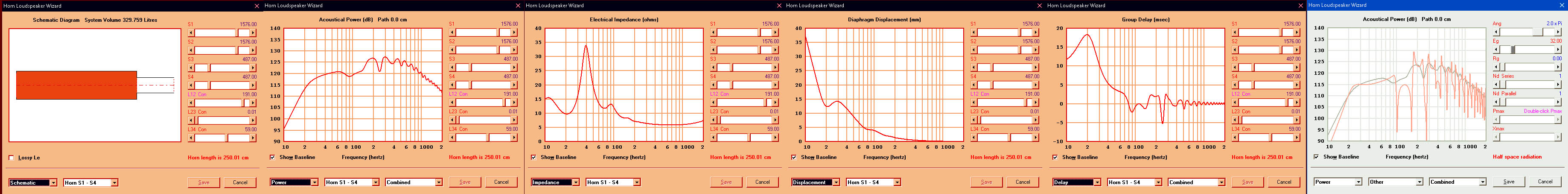

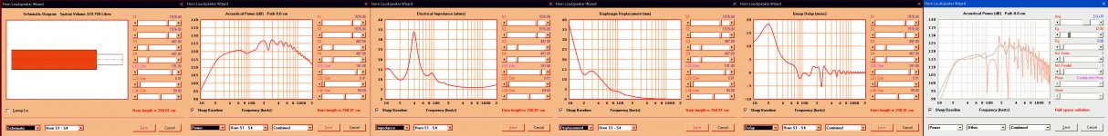

I have an Acoustic Elegance 18h+ that I want to use for a subwoofer. I have grown to respect the Transmission Line enclosure, there are many ways to configure it. I think that what I am starting to design is in the middle of a TL and a MLTL, and that semi dampened is the goal.
My first design is aperiodic, which would result in very dry bass, but I am concerned about the box pressure it might face for the enclosure being so dampening....though I am not certain that pressure from the box is what dampens the driver anyway so my worry might not make sense at all.
So with my first design fully dampened, I achieved 115db@30db - 777watts. lately my designs are aimed towards using no dampening but IO noticed when IO add dampening material in hornresp, once I find a nice result, the impedance curve is slightly different and less dampened but, 777watts/30hz/115db is usually the best I can do...unless dampening is removed of course.

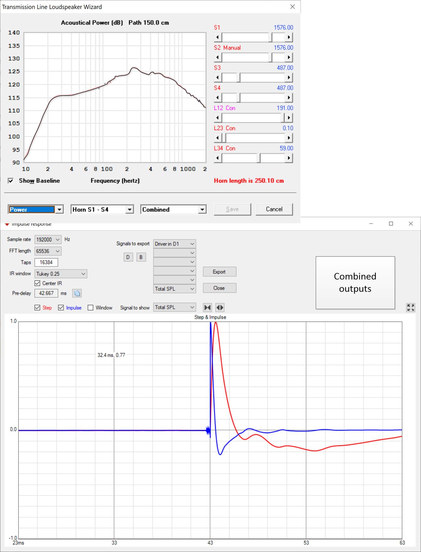

I present Acoustic Elegance 18H+ MLTL.....As I continue to scrutinize the scrutiny😁, I present to you, my latest....This is a hybrid of my first design ( which turns out to be the most dampened TL I've made, able to hit 115db@30hz@14xmax@777watts, with a smooth FR and really low impedance) and a follow up, reverse philosophy design (that is the most efficient of my designs, undampened, MLTL, with smooth FR, able to hit 115db@30hz@7mm@116watts)...The latest design hits 115db@30hz@10mm@276watts, smooth frequency response and low impedance. This design looks like a lot less folding but the bends will be large. 320 liters is a little large than the first 2 designs.The dampening required to get pictured impedance is much less than the first TL. Un-dampened, the frequency response is still usable, doing 115db@30hz@7mm@128watts....

I've been following your TL design with interest, wanting to learn from it, to understand if and where a TL makes sense. This latest one looks pretty good. I've got an HR model going, damped it differently and got a smoother response for what that is worth.
All along I've wanted to look at the time domain response and HR wasn't helpful, except for the undamped line, where the IR and Impulse spectrogram are almost frightening.
How to get IR with damping in the line? I found a way:
*export the FR from the wizard via a screen capture, making sufficient change from the desired baseline so that you get a grey trace instead of red
*drop the screen capture into Vituix's SPL trace tool and trace it (won't trace red) and export
*now point to that exported SPL in the main Vituix screen as a driver frequency response and ask Vituix to show you the IR
Here is what I got and it looks really good:

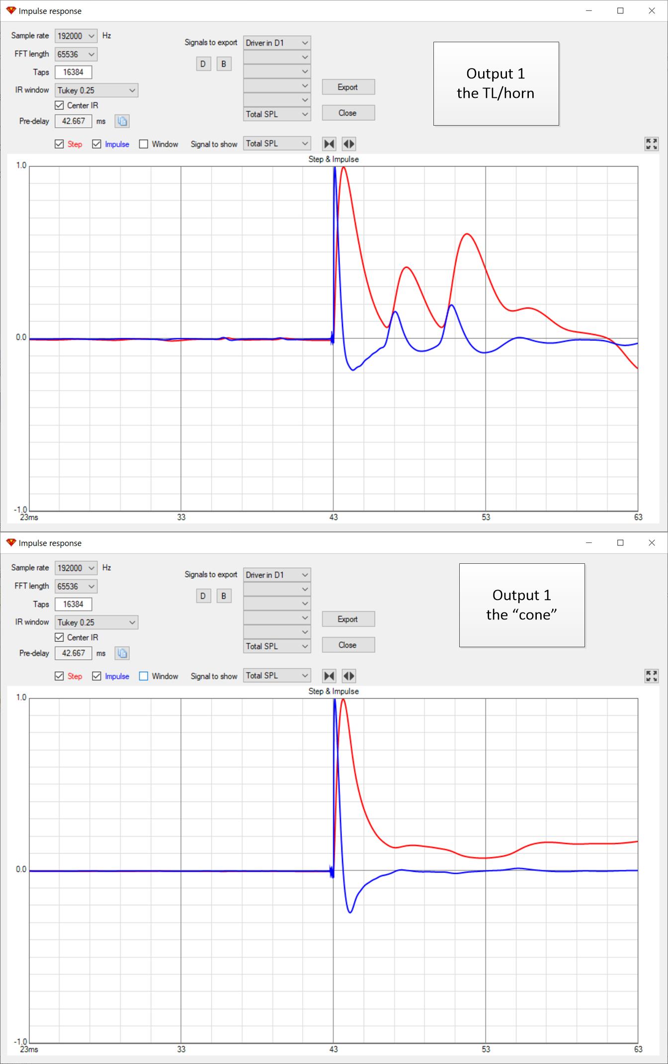

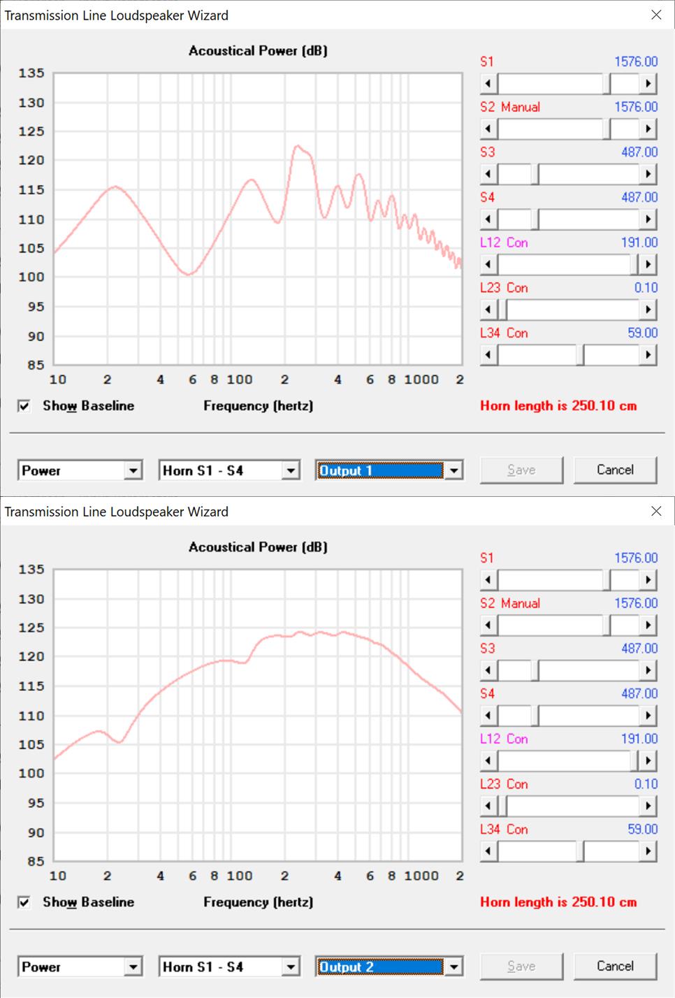

But what about cone and TL exit outputs separately:
The TL output is above that of the cone only well below 100 Hz. That is the desired result, the TL delays the back side to shift its phase to contribute to the cone where the cone needs help. Above 100 Hz, there is enough output coming from the TL to put small ripples in the cone's output. Perhaps we need more damping to suppress it further.
I also see the TL output coming in 3 pulses - it can't be called minimum phase and might cause issues in XO to AXI.
