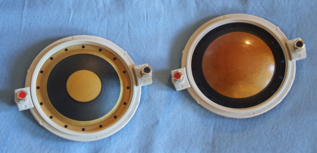

Yes, Carbon-Cotton, or Cotton (the one on the right).
Eminence is slowly getting overpriced, just like the majority of the "A" brands.
WRT output in the top octave, the Cotton-Carbon driver walks all over the 18Sound.
In Bulgaria you buy 3 PAIRS!! of these drivers for the price of just 1 ND4015BE.

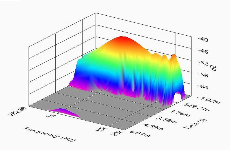

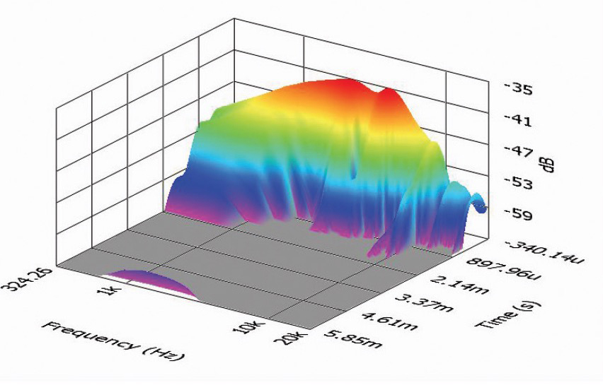

The ND4015Be is measured on a CD horn, according to their PDF, the XR1464C.
Eighteen Sound - Professional loudspeakers
From the 18 sound webpage, the graph shows about 95 dB @ 2.83V at 20khz, for the ND4015Be.
From the Voice Coil test bench, the ND72HB is showing 90 dB@20khz, mounted on an aluminum Oberton horn, the H-1464. The diaphragm was changed out to the CT version for the distortion test, but the output is comparable to the HB.
Comparing the horn polars, it appears the H-1464 has a bit more narrow pattern than the XR2064, bringing up the on axis spl of the tested ND72HB / H-1464 combo in the 12 + khz area compared to the ND4015Be / XR2064
A plane wave test is needed to directly compare units, without drawing erroneous conclusions.

The ND2080BE is the 2" version, the XR2060(c) the matching horn.
After you've flattened and eq-ed the response you'll find the Oberton beats the ND4015BE wrt output in the top octave, which is not surprising given the difference in dia size (4 vs 3"). Some members have shared their own measurements of the 4015 (with different horns) in which the drop >10k was visible.
To be honest, I'd prefer the Oberton, at least based on Dickason's measurements.
Yes, there's a peak, but it's extremely well dampened. Moreover, the sound (signature) of cotton-carbon is supposed to be very easy on the ear.
I also like the diaphragm (design) better than the elcheapo solution of the Eminence 314X (expected price: €400).
