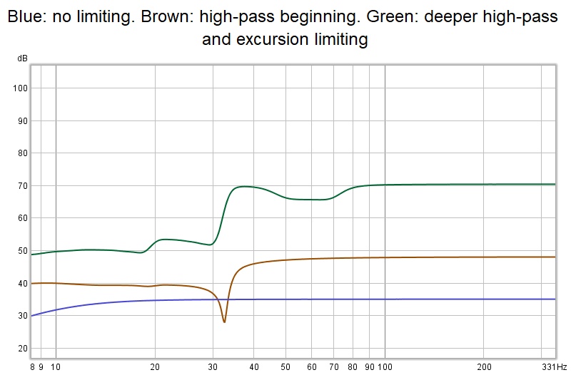

Hi all, don't want to keep kicking a dead horse regarding why I don't see impulse and step as good tools to use for low frequency tuning.
But I've been working on something I think you might find interesting and kinda illustrates the lack of usefulness with those tools for low frequency work.
Anyway, the project has been to see if I could make a frequency dependent limiter that could act as both a high-pass filter, and a 'parametric' excursion limiter.
An excursion limiter that only engages smoothly in a specific range as drive level increases. So no traditional filters....
Reason for the project has been to get maximum output of Faital Pro 18FH500, avoiding over excursion and THD..

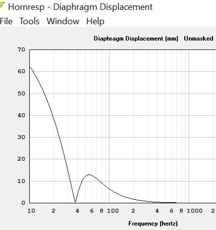

First pic below is Hornresp's Displacement screen for the driver at rated AES power in the bass-reflex box I built.
X-max is 9.3mm. You can see excursion above that between 45Hz and 75Hz at full power.
First REW screen shows a few stages of limiting kicking in...
1. none at low level, 2.high-pass substitute engaging as level increases, and 3. both high-pass and over-excursion-range fully in.

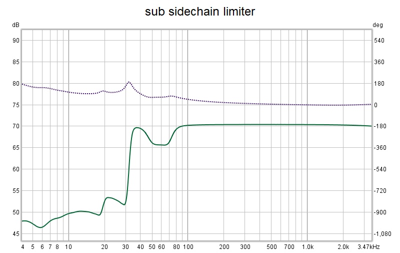

2nd REW screen is just SPL along with phase when the limiter is fully engaged.

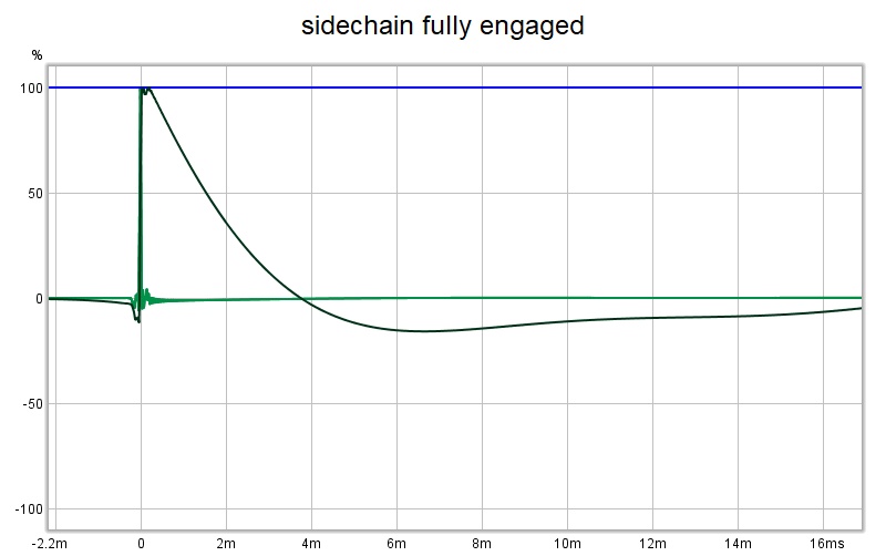

3rd REW is impulse and step of previous SPL/phase.
Guys imo, this represents a lot of monkeying with bottom end response, and very little information provided by impulse or step of the altered response....

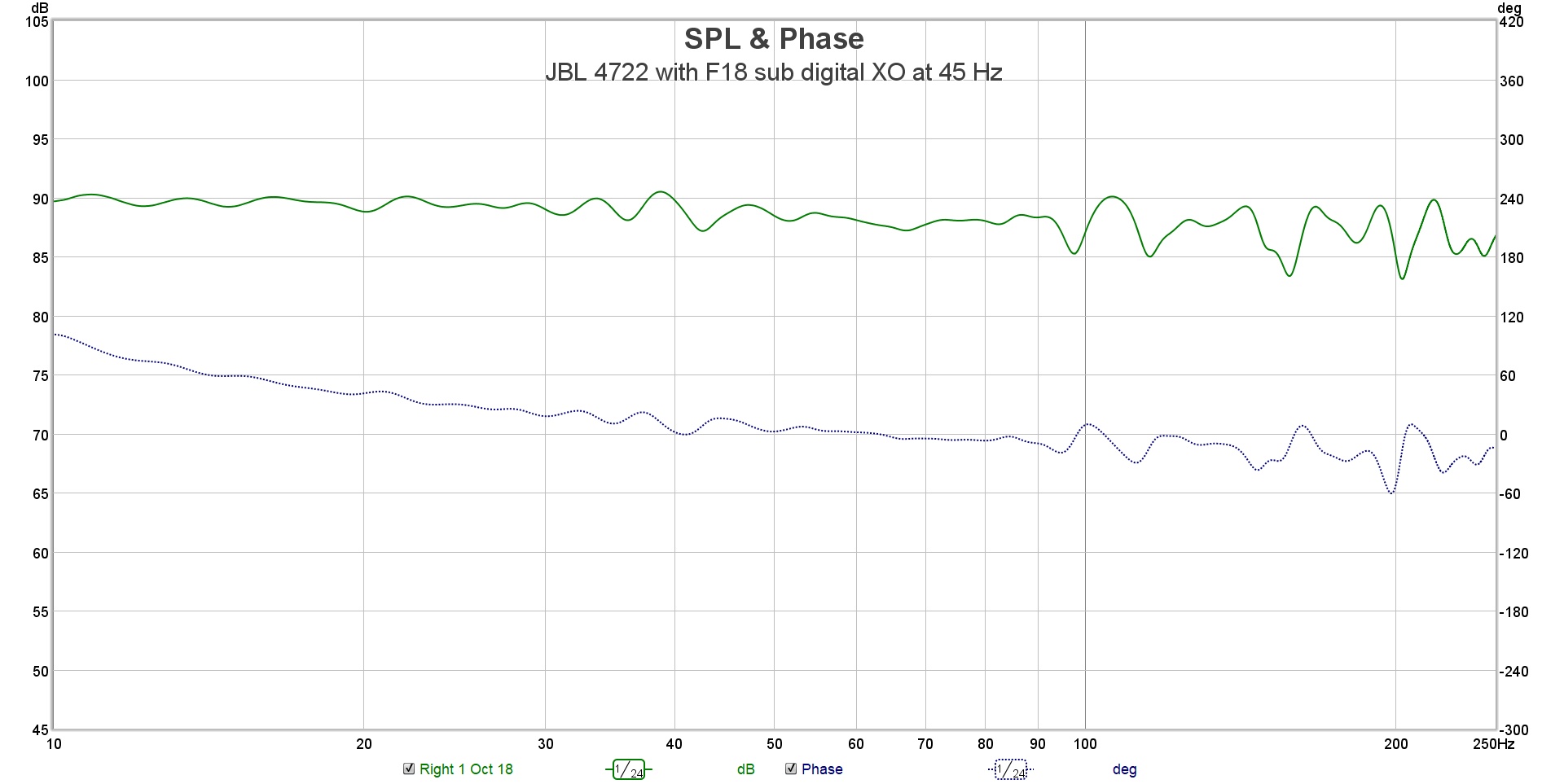

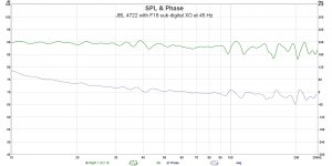

@Mark, maybe we are saying the same thing? Or am I missing something? Attached is the amplitude and phase response of my system in the low end measured at the LP that correlates to the step response I posted earlier.
Hi Mitch, I very much think we are saying the same thing.....how impulse and step are favored by highs and mids.….
In my last post I was trying to display how convoluted the low end can get and still have a near perfect impulse and step...
And in all honesty, maybe show off a little too 😱......at how I've got a sidechain limiter to replace a hpf and do frequency dependent limiting ...it's been a lot of headbanging work …..for what i'm not so sure lol
