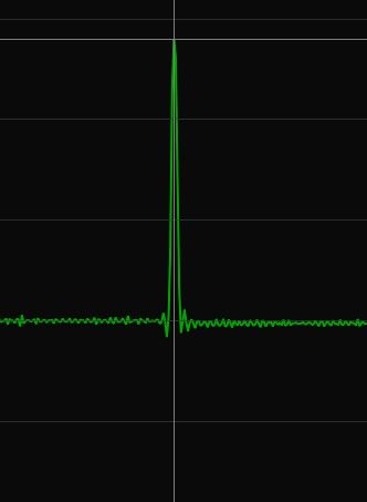

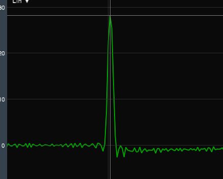

All the ripples are from using a couple of daisy chained sound cards running at different sample rates.
Already had the setup in place working on another project, and was able to make the quick and nasty impulse set.
A gentle low pass at the upper top of the freq range cleans em up.
It's more evidence on why I think impulses are good for confirmation only...they are too fickle to inconsequential items, like adding a mild 20kHz lpf just now to get rid of digital gobblygook.
Step is better, but still hard to read, and in the end.....
what knobs apart from mag and phase(time) do you have to fix step with? 😉

Those step responses are not the best way to analyse Q for a bass system in my view. More for DAC filter ringing... Either you accept a resonance i.e. a Q > 0,5 or a forced, unnatural over-damped system Q<0,5 or whats called a critically damped system Q=0,5. It should be a theoretical/technical choice for a system parameter based on your technical insight and preference.
I don't disagree with your conclusions, only your data. An impulse high passed at 40 Hz must not have any average level, i.e. no DC. Hence the impulse must ring down below zero for as much energy as it is above. Your plots don't show that. Also they are symmetric. For IIR filters they cannot be symmetric. A loudspeaker is IIR, not FIR.
And finally, what good is an impulse response of a woofer in a free field anyways? The room will change everything making the characteristics of the woofer virtually irrelevant. The room and the source cannot be separated. Someone else mentioned this before.
Those were IIR high-passes !
The thing in my mind is this.....an impulse plot of any good speaker tends towards a Dirac pulse. Since a Dirac pulse is the sum of all initial samples of every frequency from bottom up...let's say 20-20kHz for ease...and it's the sum of first sample of linearly spaced frequencies...it means an impulse plot is vastly dominated by high freq info.
Dominated so much so that even high passing relatively high up, 39 Hz in the examples I posted, still looks symmetrical . Heck, I bet 100Hz high pass looks near perfect...(now I have to go try lol)
Am I thinking straight here in your opinion?
I know folks like to default to 'the room changes everything' and it surely does...but it's not reason to give up on best quasi anechoic we can get...even for bass imo (i'm still not in the multiple sub camp 😉
If I could get a better impulse for a sub outdoors I would...if the impulse had any real meaning...
Yes, now I agree. Perhaps 40 Hz is too low for your example to do an accurate filter. There are LF limitations to digital filters and bit depth.
But yes, I agree that visually the impulse is dominated by the HFs.
If you want to see the actual arrival times of the LFs, then LP filter the data and then fill the resulting impulse with a HF sine wave. The FFT sidebands of this tone will indicate if one or more peaks exist and the location of the sidebands will give the timing. Not very clean, but doable and more visually obvious. The same thing can be done numerically of course (cepstrum, etc.), but that is more problematic.

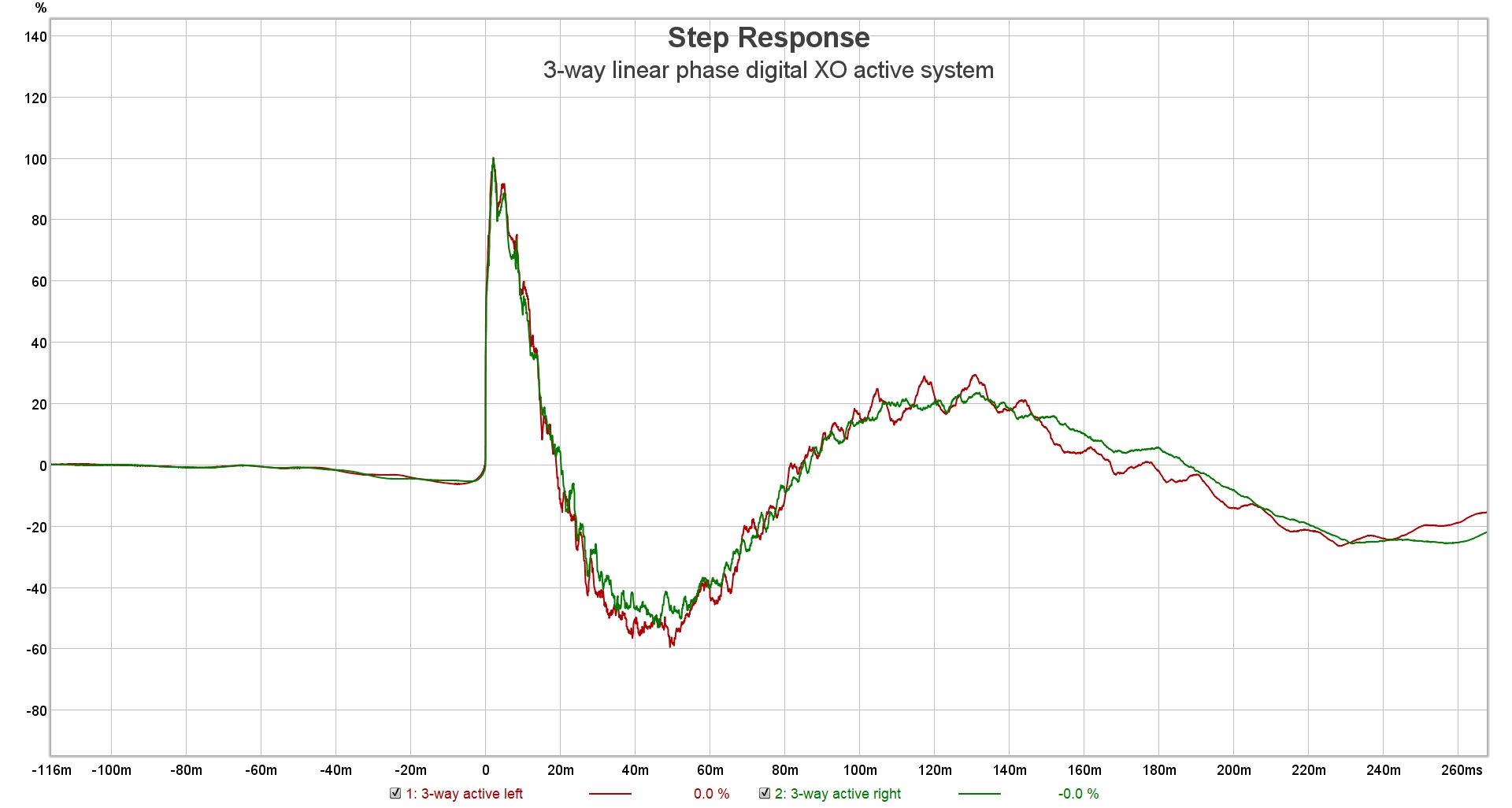

Similar to mlee, I ran some tests on phase audibility using commercial DSP software to flatten the phase on a pair of speakers with passive XO. I could not really tell an audible difference with the FIR filter in or out of the signal path.
However, when I time aligned the drivers with a linear phase digital XO, that did make an audible difference (subtle) versus the passive XO with no time alignment, but phase corrected. The difference I heard was an increase in the depth of field. Sort of 2D versus 3D presentation. It is a characteristic I hear in other time aligned speakers like the D&D 8c and Kii THREE's.

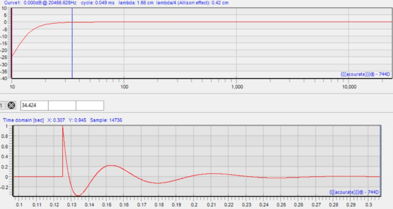

Wrt speakers and impulse response. Folks should know that an impulse response display (really) favors high frequencies. Relative to the high frequencies, a midrange impulse response is about 1/10th the amplitude and the woofer 1/100 the amplitude as compared to the tweeter on the same grapgh. So looking at an impulse response of a full range speaker system does not reveal much as the midrange and woofer contribution is completely obscured by the tweeter pulse.
So when talking speakers and timing, a step response is a more appropriate display as it is more or less equal across the frequency range. Stereophile has comments on this as does Rod Elliott.
What does an ideal speaker step response look like? Pretty easy to do in any filter design tool. Assume an "ideal" frequency response from 20 Hz to 20 kHz with some rolloff below 20 Hz depending on speaker box alignment (i.e. ported, sealed, whatever). Here is an example with a 4th order Butterworth rolloff at 15 Hz.
The top is frequency response and the bottom step response of the same filter modelling an ideal speaker. The vertical step implies all frequencies arriving at the same time. After the right triangle (as the step does not go to DC), you will get various "tails" depending on the speaker/box low frequency roll off. Basically ideal minimum phase response.
Thanks for the information mitchba! Yes the step response should illustrate what we are speaking of a little better, makes sense.
Just to clarify, my setup was "time aligned" 2-way active setup implemented with IIR XOVER. Then I applied a FIR filter on top of that to linearise phase response. I did not redo the XOVER using FIR filters. Not sure the result would show any difference for me.
