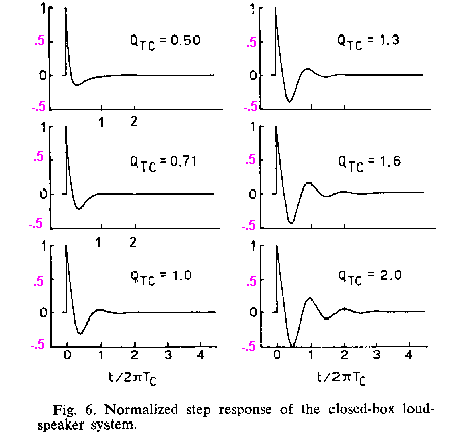

I wonder if a slightly lower Q would make sense in light of a heavier cone. A Q=1 for an 18" probably isn't the same as a 4" driver?
without the perfect response pictured what does it all mean. The perfect impulse would have no decay or attenuation would it not?

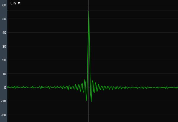

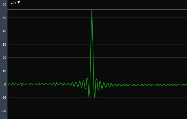

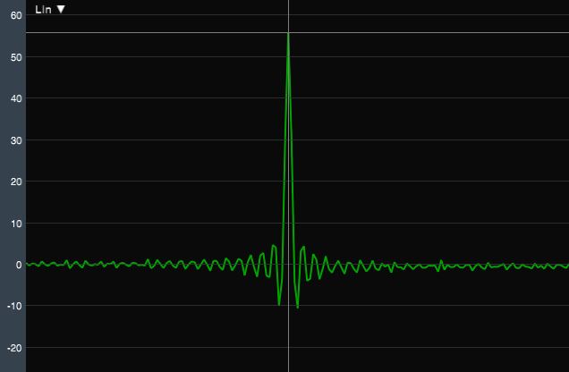

Hi Charles, here's why I can't see any value to using an impulse to determine which Q is best down low. Below are electrical impulses:
First full range, then high-passed at 39.3Hz at Q's of 0.5, 0.707, and 1.
It takes better eyes and discernment than mine to see any differences, not even between full range and high passed!
Bottom line imo, is that the bottom end of the spectrum contributes so little to an impulse plot, it's why bother looking.
Looking at bandwidth filtered impulse plots down low can help, but even then I find measurement programs have difficulty with repeatable measurements, or even finding consistent timings.
Given mag and phase are so much easier to discern, and the only things we can really adjust anyway...!!
...and are the components that end up making a good impulse/step when it's all said and done....
….well, I keep coming back to why bother with impulse other than to check it for confirmation of a good tuning.
But to each their own...just my 2 cents...
