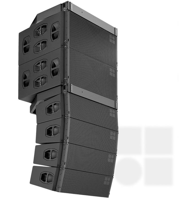

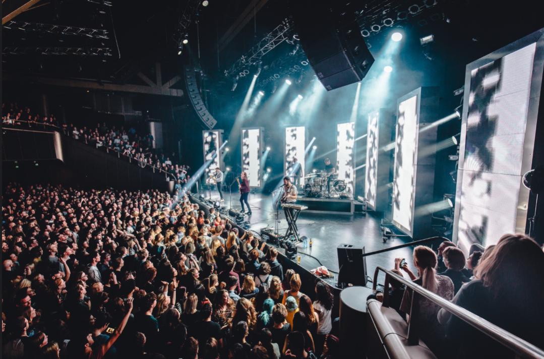

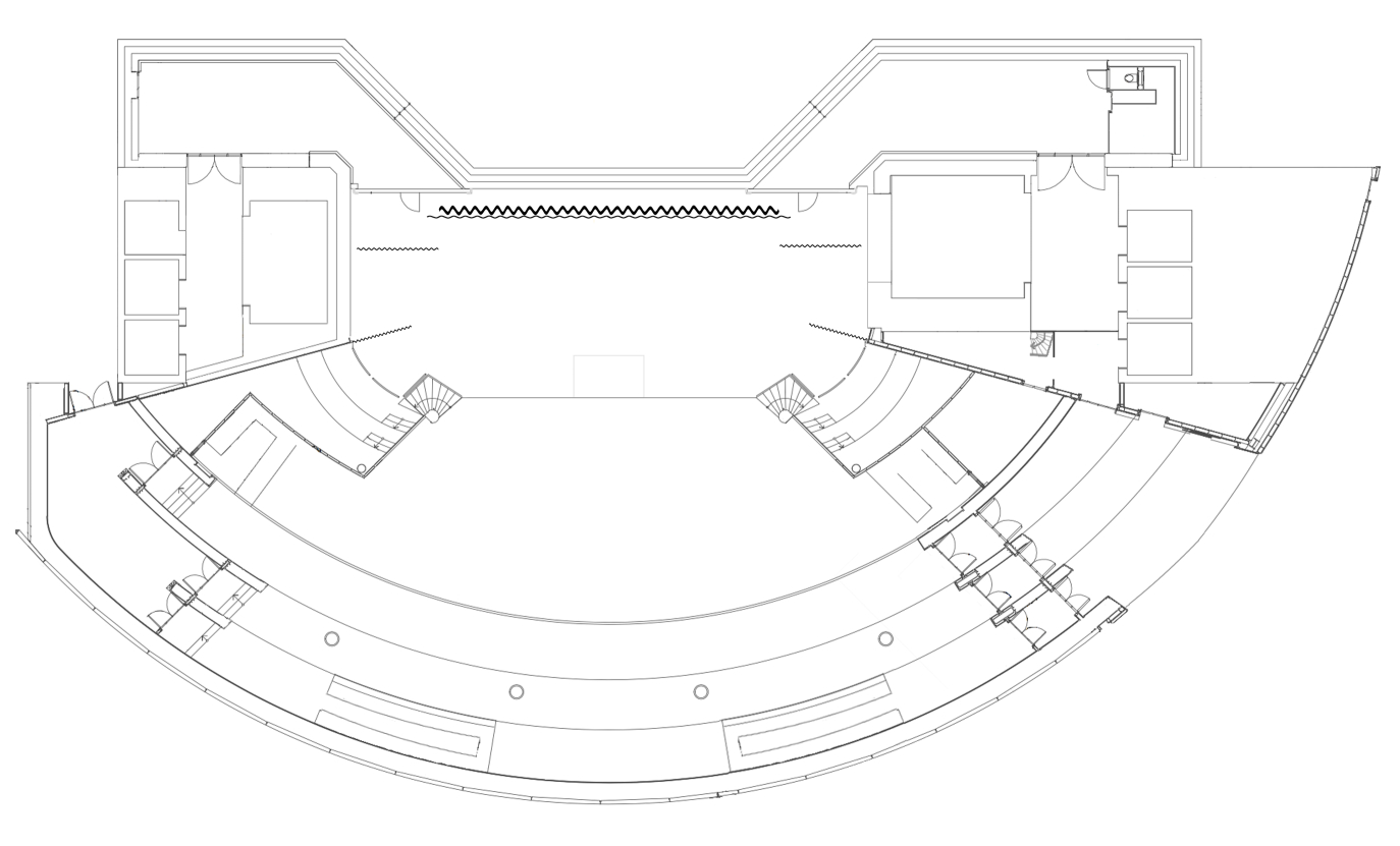

Speaking of perception, last weekend I visited an event at one of the best concert halls in my country as regards to room acoustics and sound reinforcement.
Some data (excluding stage dimensions):
Hall:
Purpose: Live music & dance.
Capacity: Standing = approx. 1900-2000, seated = approx. 700
Dimensions:
Hall: approx ≈ 50m wide x 25m deep.
Control:
D&B R1 Software
2 Lake - LM44 Digital audio processor
PA:
20x d&b audiotechnik J-12
8x d&b audiotechnik V-8
12x d&b audiotechnik J-Sub
2x d&b audiotechnik T-10
2x d&b audiotechnik V7P
13x d&b audiotechnik D80 amps
Main PA:
10x J-12 flown per side
6x J-Sub Under stage per side
Outfill:
4x V-8 flown per side
Infill:
1x V7p per side stacked on stage
Speakers amplified by d&b audiotechnik D80 Amplifiers
For this hall, line arrays of l'Acoustics and Adamson were tested before it was decided on d&b.
The size of this room is more or less comparable to the theater featuring the Danley Jericho J1s + array of tapped horn subs, I reviewed previously.
In itself it's quite amazing the output of those 2 Jericho J1's is equivalent to a considerable amount of (expensive) line array modules.
But that's not all. Whereas line arrays may sometimes be preferred for live sound, due to beam steering and other available technologies - in this case d&b Array Processing, I much prefer the point source nature of the Danleys for electronic music.
Line arrays won't provide the "holistic intimicy" of the Danleys. It's the clear window (in)to the production(room)-trick that only point source systems seem to pull off.
Don't let me be misunderstood, d&b audiotechnik gear is top notch and I bet many visitors would actually prefer it to the Danley system. Most people, spoiled by soundbars and homepods, are unable to differentiate between point source and arrayed cabs. Instead they judge by SPL across the room and the general nature of the system > harshness, amount of bass etc.
In the same building there's another, even larger concert hall as well as a smaller (club)room. The latter is also fitted with d&b gear (tops with subs). My friends and I prefer this room to the bigger hall for electronic music.
