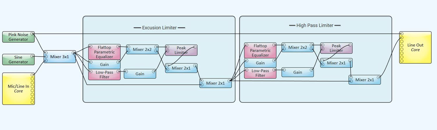

So, I've been skimming some of the multi-band compressor and dynamic-EQ products you guys mentioned, and I still don't know exactly what to call what I've put together.
I guess it seems closer to a dynamic-EQ, than a multi-band compressor if for no other reason than it's only operating on one band.

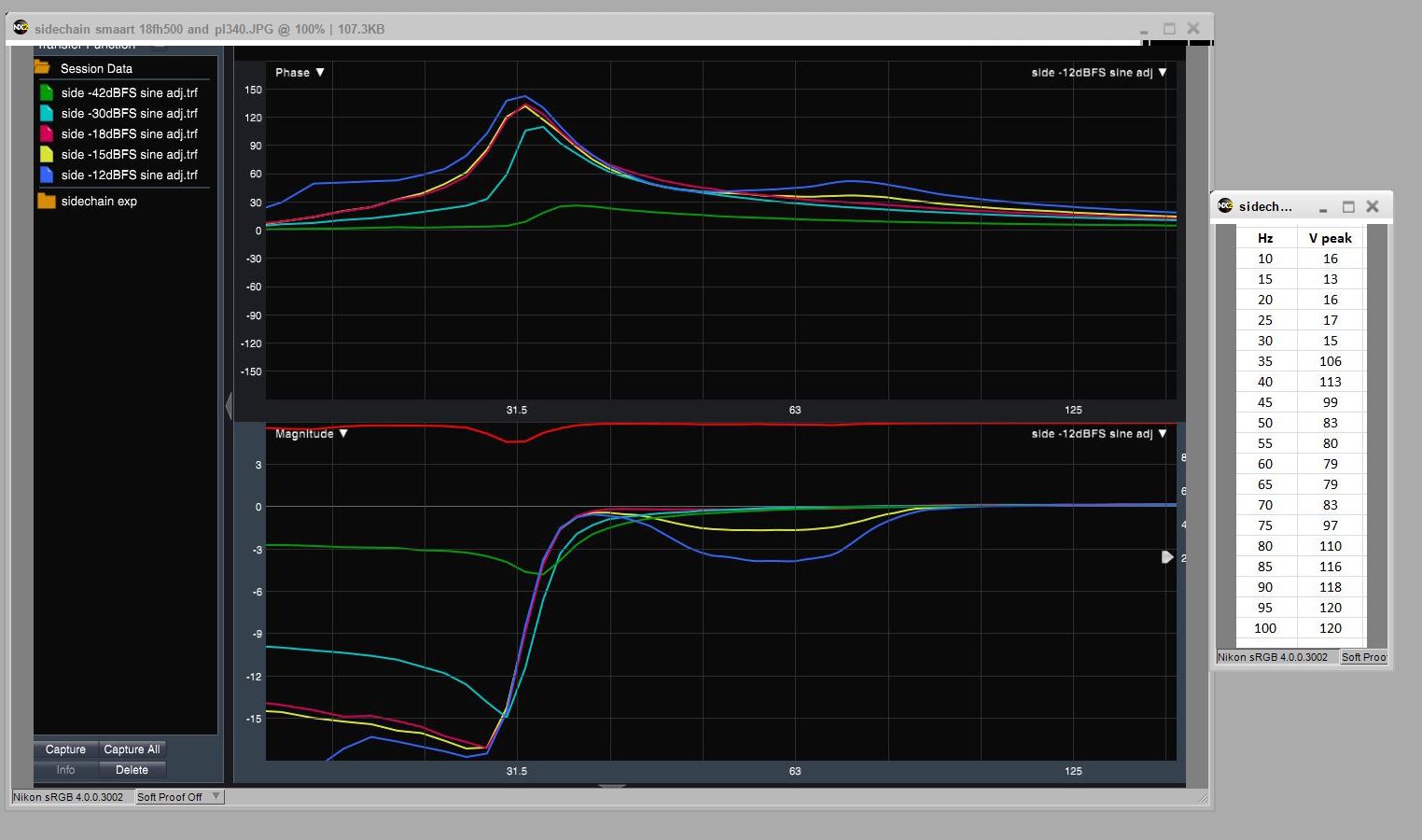

The difference between my limiter and dynamic-EQ appears to be that dynamic-EQ effects response around a signal operating at a relatively steady overall level where peaks stay just below 0dBFS,
whereas my limiter/hpf effects response on overall levels that vary greatly, as shown below.
Attached transfer plot shows some various levels, along with a chart of maximum peak voltage output from the sub amp.
Second pict is the limiter's component schematic. If it makes sense to anyone as to what it would be called conventionally, pls lemme know. 🙂
I once built an analog excursion limiter/dynamic EQ using a Sallen-Key highpass with a high Q.
By electronically controlling the resistor that is going from the non-inverting OP input to ground it was possible to have a filter that is tuneable from low cutoff /high Q to high cutoff/low Q. I used an OTA for the controllable resistor. J-FETs would also be possible and of course LDRs (almost forbidden nowadays unfortunately).
The steering signal came from a level detector behind a notched 2nd order lowpass that approximated the transfer function of the cone excursion.
A circuit like that was used by KLH in the late seventies - early eighties but its highpass filter was a little more complicated than mine.
