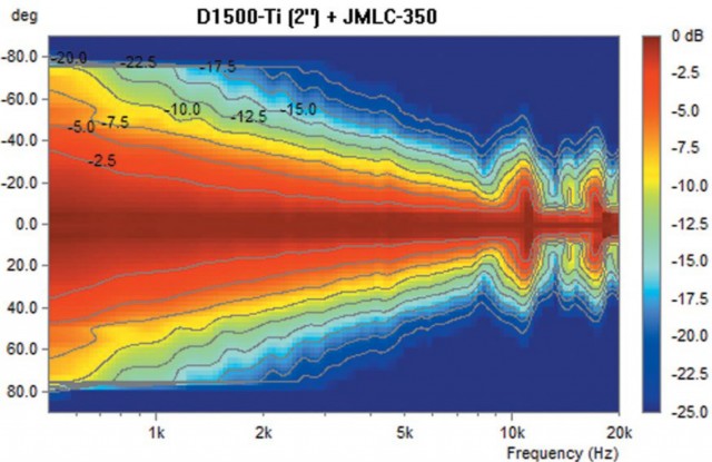

Spending a few moments reading the off axis response and correlating how many dB down at what frequency gives a clue as to what happens when one moves their head inches off axis at a distance. Then you purchase the horn...
There is considerable scientific research from Dr. Toole and Olive that shows repeatable subjective listener preference for a loudspeaker with smooth on and off axis response. i.e. constant directivity. I am in agreement with this research and mirrors my own experience.
Regardless of how narrow directvitiy the horn is, the room is going to have an impact as one hears a combination of direct sound, early reflections and later reflections. My home listening room is a RFZ with early reflections -15 dB down from the direct sound over the first 40ms of sound travel in the the room. But the room still contributes to the overall sound even with my 90 x 50 CD waveguide XO'd a 630 Hz.
A horn with frequency dependent directivity is going to contribute different levels of room sound and will sound "colored" This is in addition to moving ones head off axis by inches and hearing a different tonal response due to the frequency dependant polar response. One cannot eq directvity to fix it. Here is an example polar response comparison to illustrate:

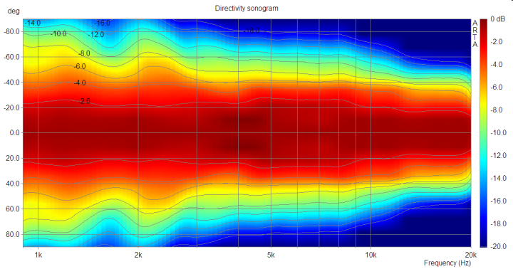

Power transfer: the same kind of plots than the second polar map on latest Mitchba's post (something from the constant directivity camp).
More or less what Earl Geddes avocate for in the different papers i've read. To be honest i think a bit of beaming in the highest frquency range seems to not bother me this much and so i think Dave Smith's comment in the article i linked previously sums it up to me.
In Earl Geddes works there is polar maps example of typical 2 or three ways with the 'waistbending' effect clearly apparent. The narrow directivity system i've heard had that kind of issue.
It was obvious to me as i face same problem with my own 3 ways (despite being cone drivers and so 'wide dispersion') and it give a weird response to the room ( reverb even if it doesn't really exist in the room).
About my warning about beaming is that it'll happen at lower freq than more conventional approach well into the critical range. I don't know what it'll sound like.
There might be some balance issues ( with the room) as you'll radiate on small area high energy. How will the room react/ what'll be the outcome?
