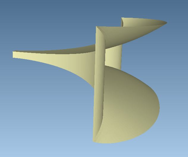

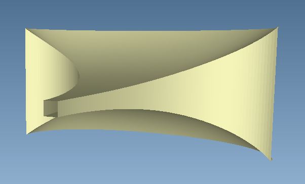

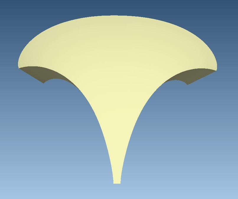

This is my latest creation and a little inspired by the TH4001. it is also intended to be used in a 2-way or 2.5-way system:
View attachment drba_radial_001.zip
Here i used the HVdiff algorithm and the construction wave fronts as horn wall. It will be described in more detail at a certain time on my homepage.

Docali: very nice effort with the Th! Have you done modifications to the original profile?
Thanks. Actually, I do not think that the profiles are related. My approach is based or inspired by JMLC who proposed an algorithm of adding section wise new conical horns to fulfill the underlying expansion function. I programmed this from scratch analytically and do not use any approximation formulas. The code is quite complex - the math not. The construction wave front is numerically integrated by infinitesimal truncated cones. I repeat it: the assumed wave front is a construction wave front! But it should be similar to the wave front you would see with Hornresp.
Once you leave the round form new possibilities open up. So, my previously presented HVdiff algorithm and the progressive expansion T hypex horns can be used. This is only one example what is possible.
What you see in the pictures would be the inlay of the resulting shape and it would be an ideal candidate to do this with wood.

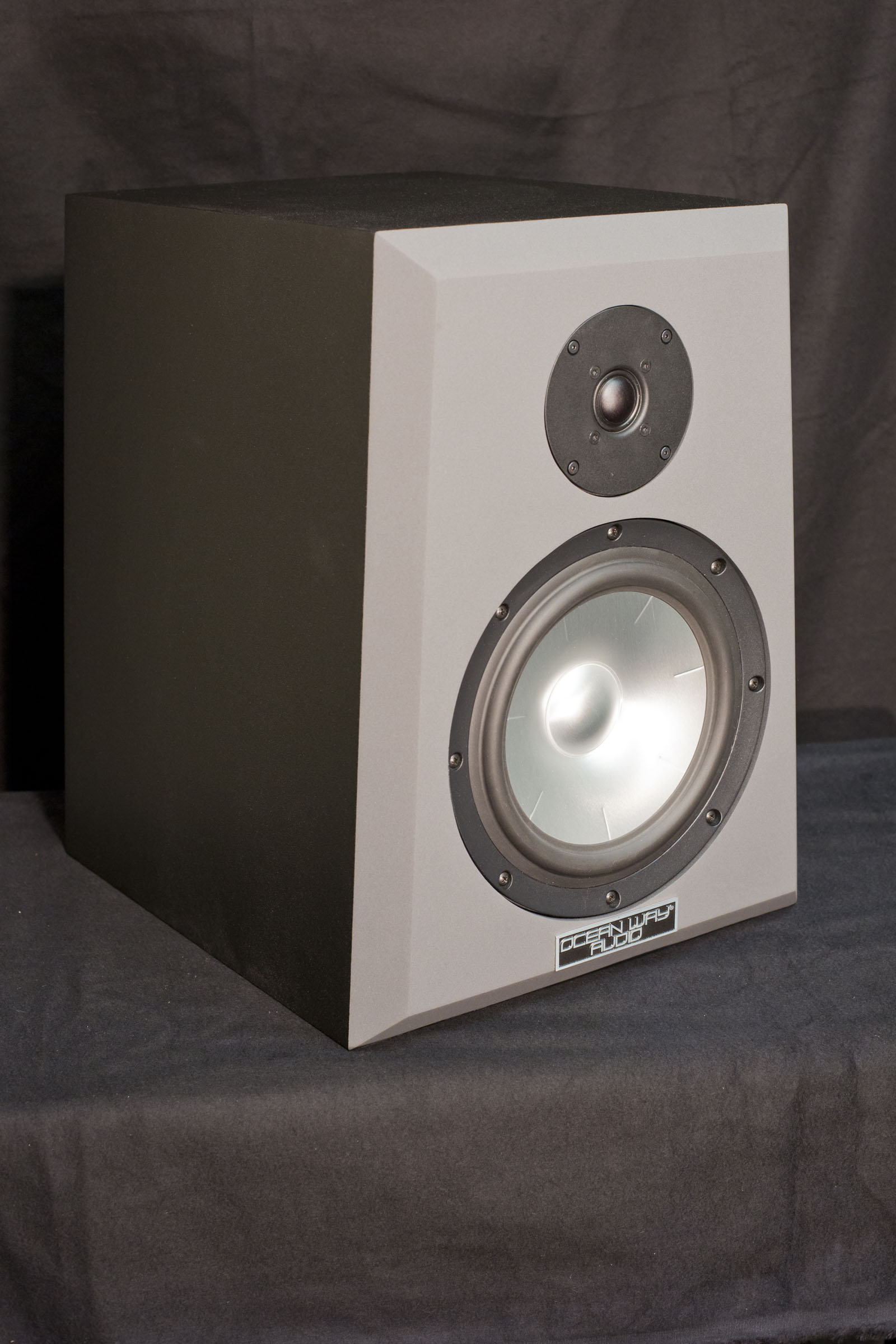

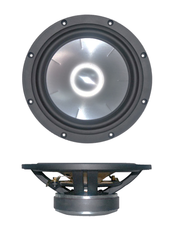

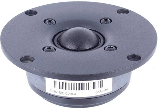

Drivers used in the Pro2A:
- Woofer: SB23NACS45-8
- Tweeter (Presumably): SB Acoustics SB26....., or Scan-Speak, or .....

Ro808, thank you for the link, very interesting. I always like TapeOp's hip articles. The tweeter is most probably to be SEAS Prestige 27TDC. Nothing fancy. 🙂 I have never heard nor seen LC-9A, must be rare speakers.
