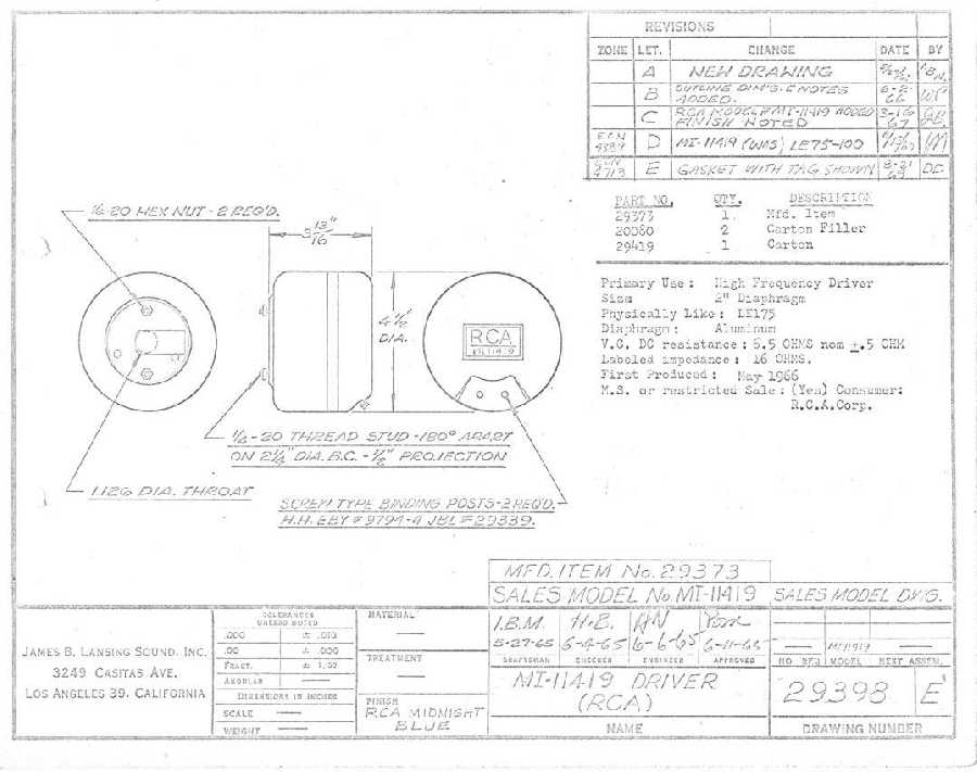

Here is JBL's sales model drawing for the LE175/MI-11419 small format driver they provided to RCA for the LC-9A (courtesy of Steve Schell), as well as images of the MI-11421 15" woofers:

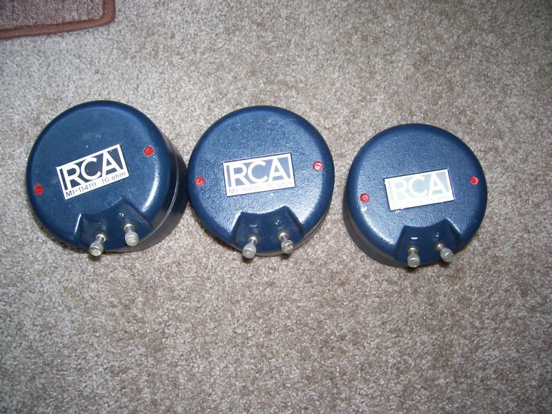

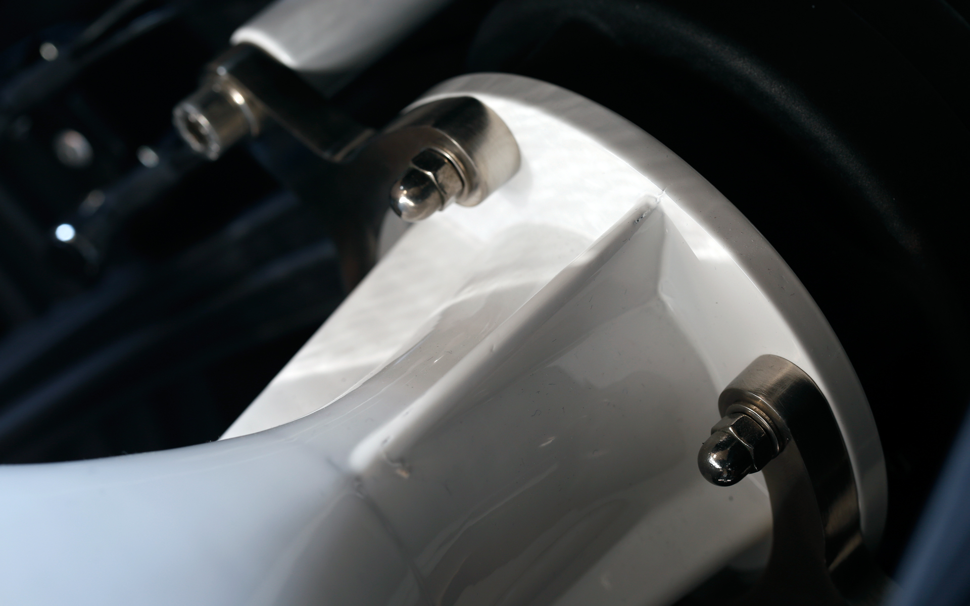

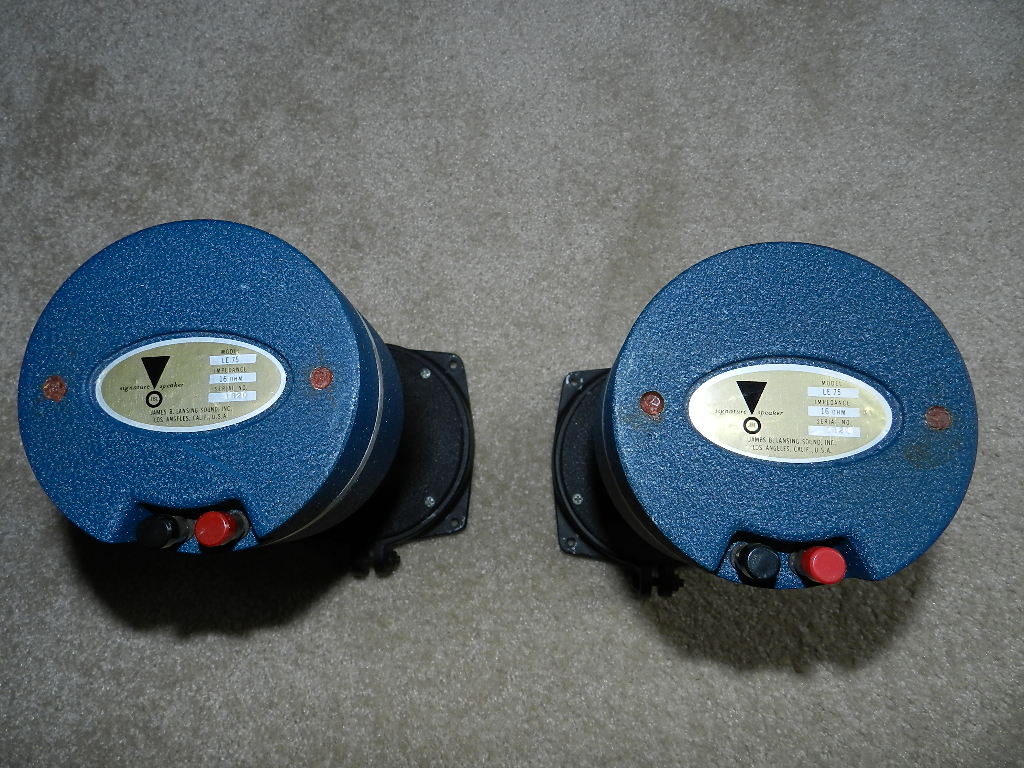

I can't see one thing on the 70 year old leaflet that makes it unattractive.Wait a minute, the paper says 22000Hz!

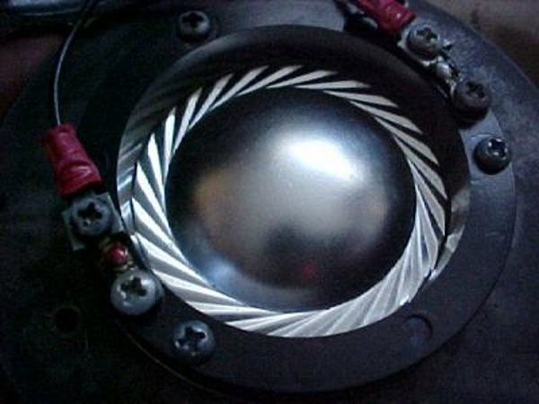

It seems that RCA drivers are with phenolic diaphragm 🙂
It's Aluminum (1st image shows the RCA diaphragm), like the diaphragm in the original JBL LE75 (shown in unusual blue coating and including the red wax seals that are also visible on the RCA drivers shown above).

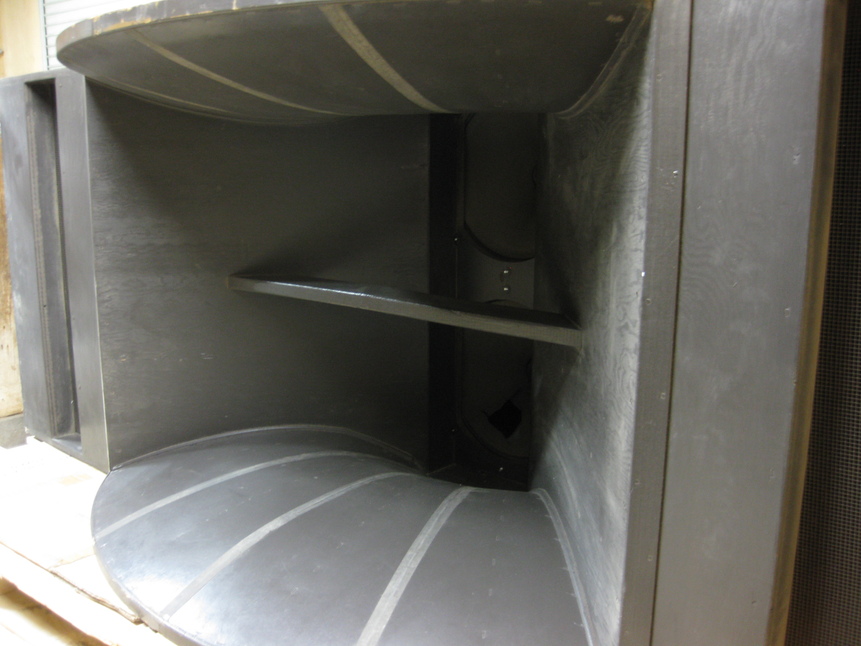

Some background info on radial horns (by Bill Woods, Steve Schell ao.):
In a radial horn two sides are straight while the other two are curved. It is a hybrid horn design that combines the excellent directivity of the conical horn in the horizontal while achieving the low frequency loading of an exponential expansion with the curved sides. Keeping this exponential expansion in mind it can be seen that the straight sides expand so rapidly from the throat that the curved sides need to initially neck down in the vertical axis in order to maintain the desired overall exponential expansion of the cross section.
John Volkmann invented the radial horn in the 1930s, and A.J. May, who developed most of the RCA radial horn products, was his assistant and understudy after 1943. A.J. once explained Mr. Volkmann's rationale for the radial horn to me so elegantly and succinctly that I sorely wish that I had taped the conversation. He said something to the effect that the radial horn was designed to optimize the dispersion vs. frequency in the most important, i.e. horizontal axis, while sacrificing it in the less important vertical axis. The design utilized an exponential flare expansion to maximize the bandwidth of adequate loading for the driver in a given horn size.
A.J. also liked conical (straight sided) horns very much; he referred to them as "plane-sided." Straight horn walls do the best job of maintaining a given dispersion pattern over a wide frequency range, the angle being determined by the included angle between the walls in the axis of interest. A.J. built and tested (and tested, and tested...) a wide variety of experimental conical as well as radial horns in the late 1940s and early 1950s. He really liked the way that a conical horn could achieve any desired horizontal and vertical pattern by selecting the proper angles of the walls. RCA never produced conical horns from this work though, as A.J. found that they were too large physically for their useful bandwidth compared to the exponential horns. The relative lack of low frequency loading from the rapidly expanding throat section resulted in a horn with too little low end in a given size compared to an exponential horn. The radial horns were considered a good compromise between size and directivity, and were widely used by RCA and many other companies.
I am not sure why the LC-9 uses a curved profile on only one side of the bass horn, though I assume that A.J. achieved the desired expansion without further complicating an already difficult to build loudspeaker. Some of his other designs like the MI-9462 (Ubangi) bass cabinet have curved flares on two sides.
The radial horn also strikes me as elegant conceptually for another reason. The classic exponential horn is calculated on the expansion of a plane wave. We can assume that in the real world the wavefront will bulge outward in the center as it travels down the horn, as this is the nature of wavefronts that progress over an expanding area. This bulging will give the wavefront a greater surface area than a plane of the same exterior dimensions. If this is indeed the case then the horn actually expands too quickly for the calculated cutoff frequency. A radial horn is based on a lengthening radius from a hypothetical point where the straight sides would meet. Dividing the length of this arc at a given distance from the throat from the desired cross section at that point in the horn yields the vertical dimension needed to maintain the expansion. So, the radial exponential horn expands in a manner that maintains the correct wavefront area better than most exponential horns.
To achieve a smooth transition in a conical horn at the mouth it is generally expanded a second time, for about 10% of the horns length. In a conical radial horns this curve is only on the top and bottom plane of the horn, swept in an arc. The sidewalls remain flat. In this way, you are able to “squeeze” more energy at the desired directivity over a simple 4 planed horn of the same directivity pattern.

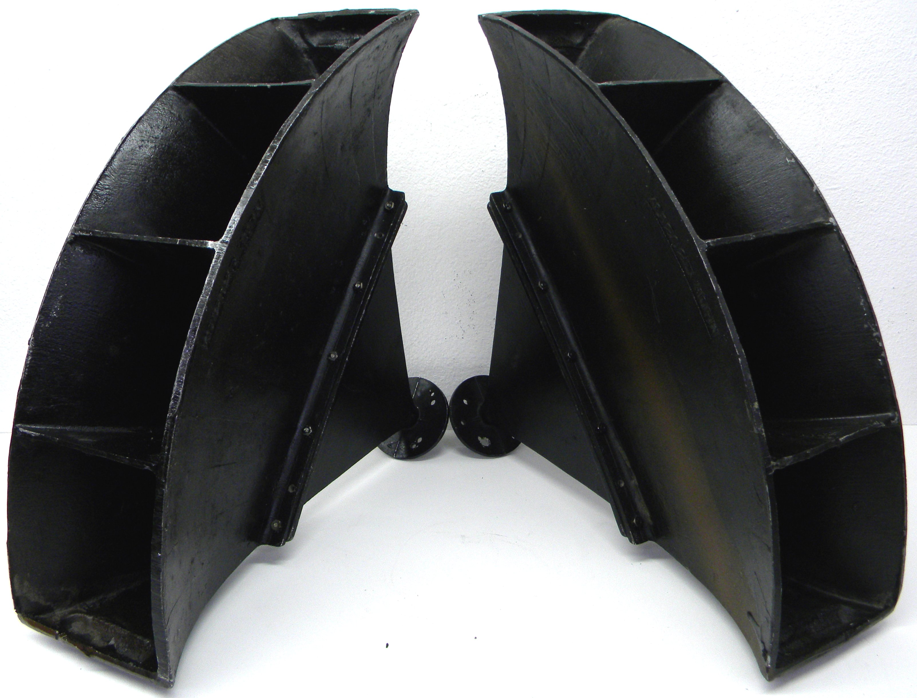

The speed bump is the result of following an exponential flare profile. When you squeeze the horn into a radial horizontal format, the mathematical function forces this bump in the geometry.
AJ made many prototypes without the bump, as it appeared a smooth transition would work better. He was right. He told me a lot of work went to that LC9 horn.
Later Keele at JBL realized in his big polynomial radials, you could do the same thing.
Because of the smooth flare profile in the RCA horn, it is superior to the Altec design.
This horn can also be done in a conical radial format, as used in some Yorkville products.
Radial horns have a smoother response curve than other types of horns, but the phase is upset due to the twisting the air must do traverse the horn. There is nothing wrong with this as you get free EQ by the horn - they go out quite far in response with good output.
The Western Electric KS12025 and a Peavey horn made some time ago share these characteristics. It is interesting to note the WE horn used a 5/8” throat to control some of the “bump“ problems.
To expand a bit on the "speed bump", it results from maintaining an exponential expansion while having two straight walls that define the horizontal pattern. The throat section expands so quickly due to this that the vertical dimension has to neck down initially to maintain the exponential expansion.

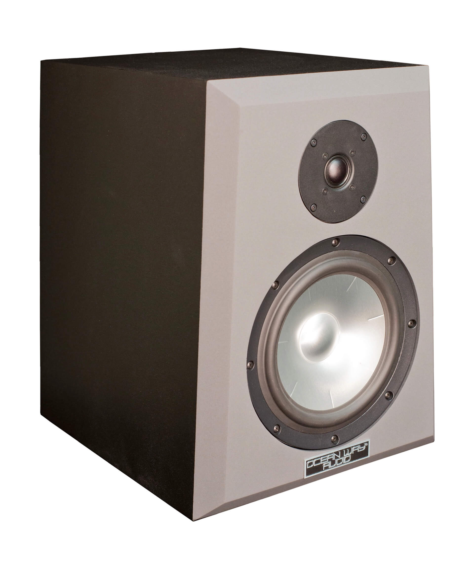

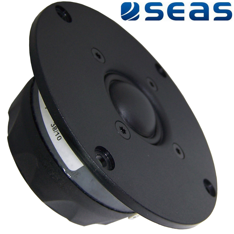

The tweeter is most probably to be SEAS Prestige 27TDC. Nothing fancy. 🙂
Well spotted!

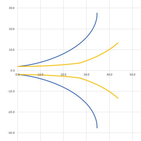

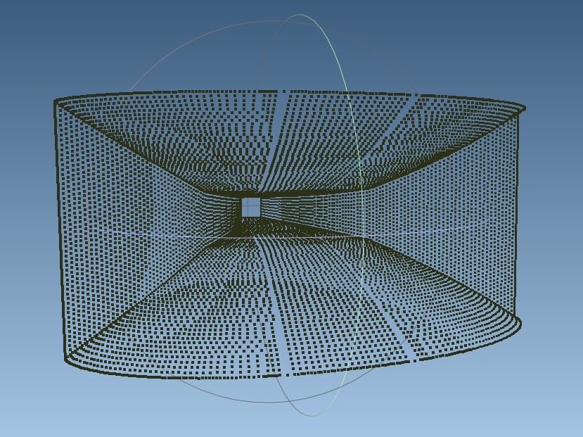

The radial type of horns are very interesting! I have incorporated an offset in my program to show the different profile transitions:
When fins are existent then the vertical profile begins to expand faster exactly at the end of the fins. The sum of the cross sectional area of all sections between the fins and the walls should give the desired surface expansion. At the end of the fins an only conical expansion would result. Therefore, the vertical profile expands from here. Leaving the fins changes the game considerably and the first flat vertical conical section looks more like a slot waveguide in order to form the wave front and not like a horn.
This example may not give proper results because of missing fins.

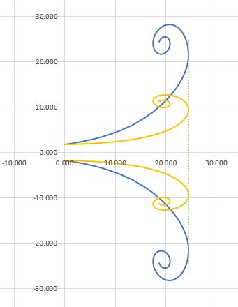

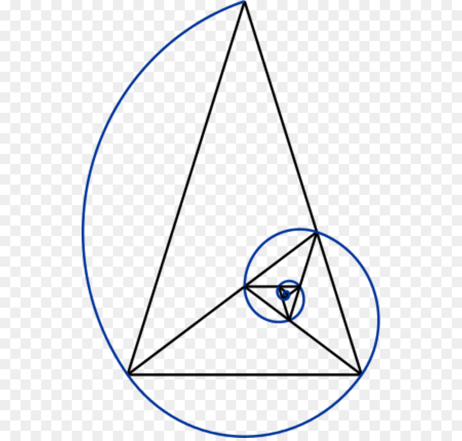

I wonder what a horn with a golden ratio expansion would look like.
Possibly similar to Joseph Crowe's Exponential Spiral horns.
There are probably only a few people on this planet who are able to generate such horns in a strictly mathematical manner.
I can think of only 3 (including you) and it wouldn't surprise me if yours turn out to be mathematically the most elegant/puristic.
Thanks!
Writing the math on paper is one thing but programming is much more complicated.
Did you mean real spiral functions? I have done the most interesting: hyperbolic, Sici, Cornu. Sprirals for horn profiles work very well! Don and I simulated them and all work properly. I personally liked the Sici profile most:
Some documents for your inspiralation 😀
