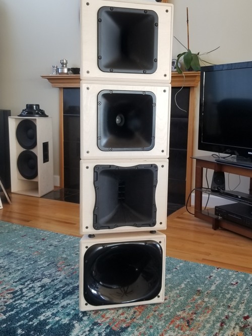

Those guys seem to use the NSD1480N with the titanium nitride coated dome, which implies the XR1464 is the obvious 18Sound horn considering the specified 60x40°.
The horn looks similar to upper horn in this stack (posted elsewhere by a guy named Mark > 100?).

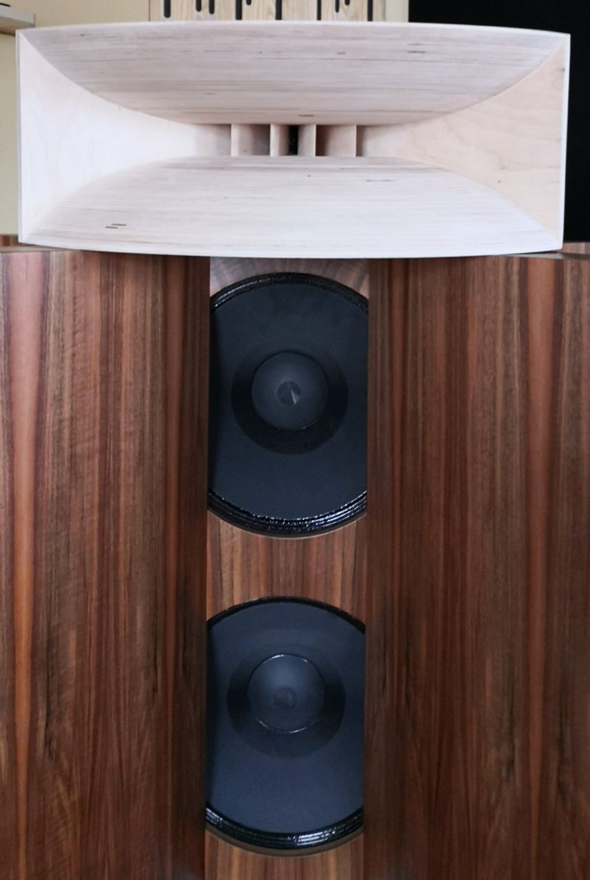

In the sense of this thread, but a 2.5 way system to support the upper woofer in the open baffle. The lower woofer supports only in the lowest octaves. Btw these are von Langa A1500.
Since a long time I already had in mind to evaluate the TAD TH4001 horns. Additionally, it is good to have some reference dispersion horns for my own horn studies. These horns measure very good. You can hardly see much directivity changes. This combos works quite nicely up to HF and sounds also nice. There is one open question for me, if 90 degrees horizontal is needed for a small listening room.
An advantage of these radial horns is that they have vertically a small footprint and the centers of sound origin between the two main sound sources are not much away from each other.

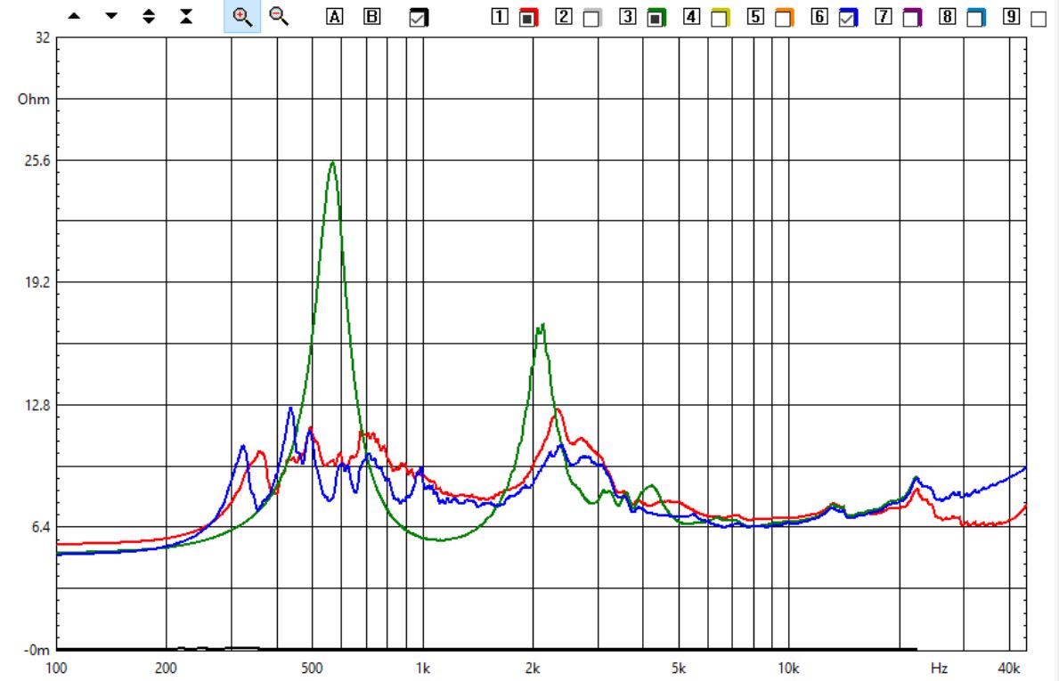

Very interesting are the impedance changes caused by different horns:
green = free air
blue = Selenium 40x20 long
red = TH4001
The Selenium seems to damp the middle peak better and loads a little lower. But is was mounted with a nearly 5cm long adapter from 2" to 1.5".
The TH4001 seems to load up to the highest frequencies. I am curious what will do the longer adapter with a much smoother transition from round to rectangular.

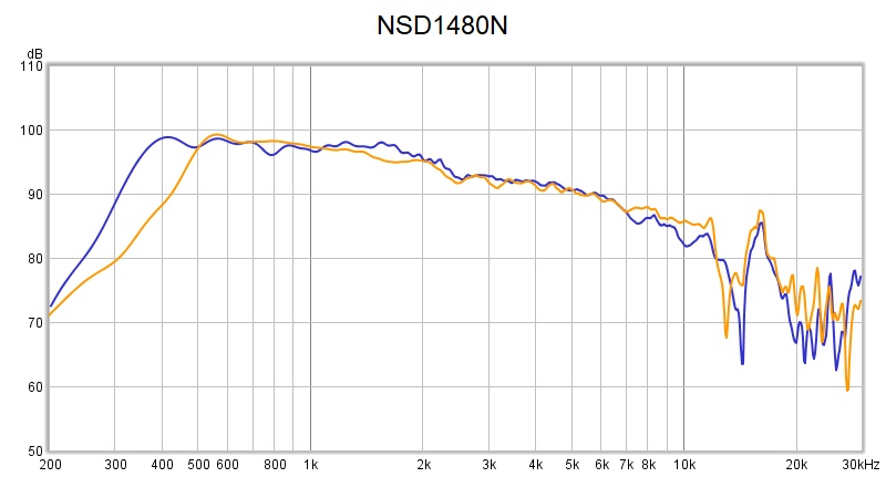

Very interesting is to see the better loading of the TH4001. I have a test driver for this 18s NSD1480N. It has a pronounced hole between 10k and 20k.
The TH4001 (blue) loads considerably lower for this driver!

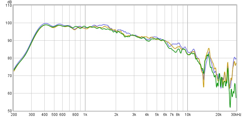

Then i measured the FR near mouth by curving the microphone around the mouth. I was very surprised that you can hardly see much difference up to HF.

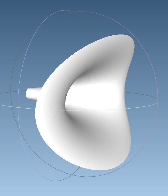

For a calculator it is no problem to make any size but in reality
This should load in the range you asked for. fo a more detailed version you need to provide throat diameter and stretch ratio.
You are right, it goes with a 4594HE (1.4in). Im not sure I know how to work with stretch ratio :S
