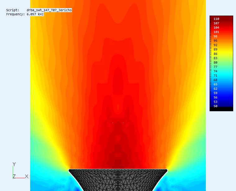

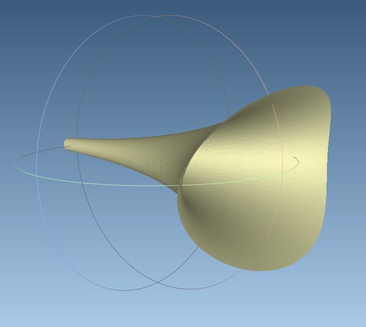

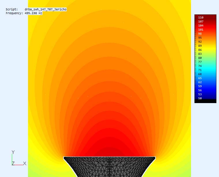

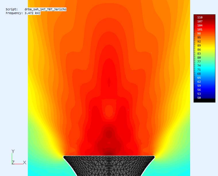

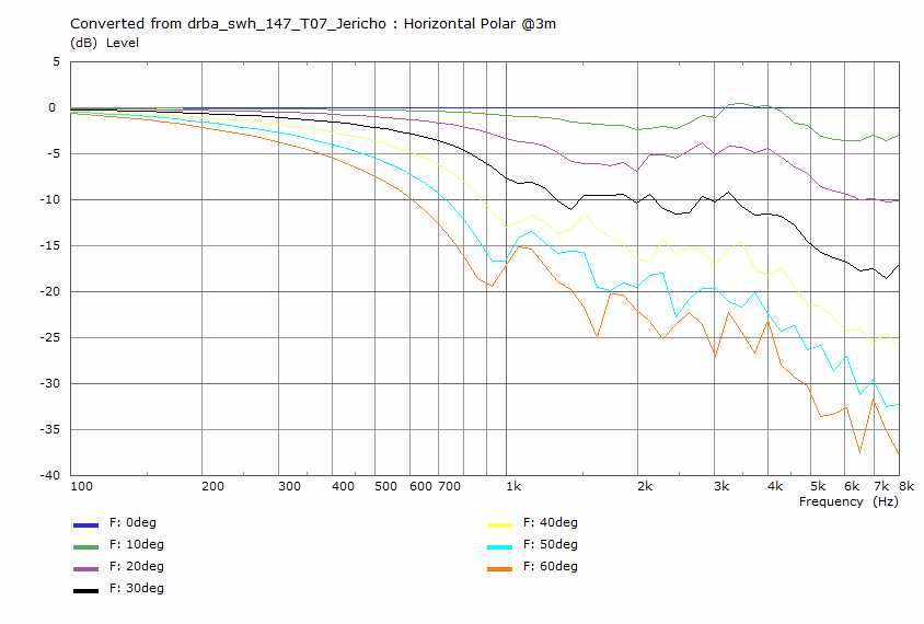

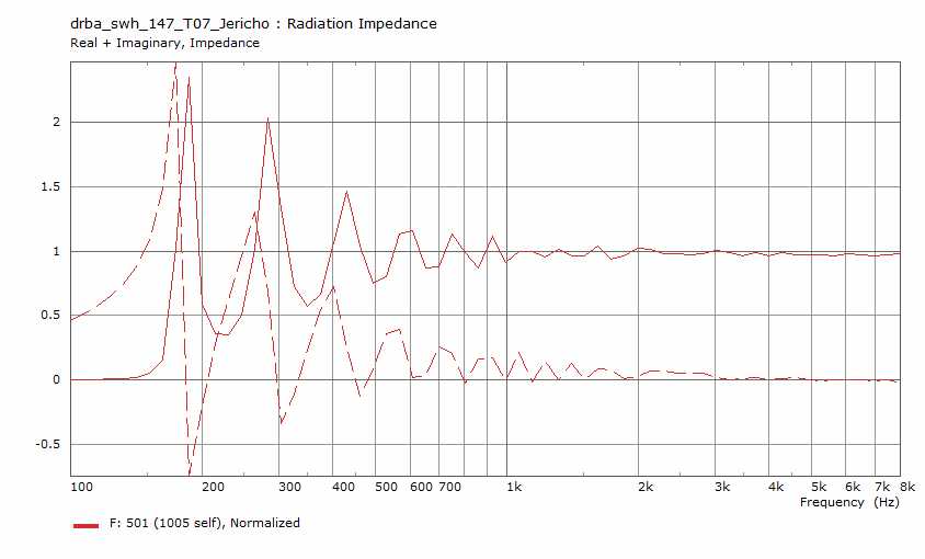

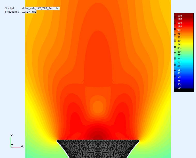

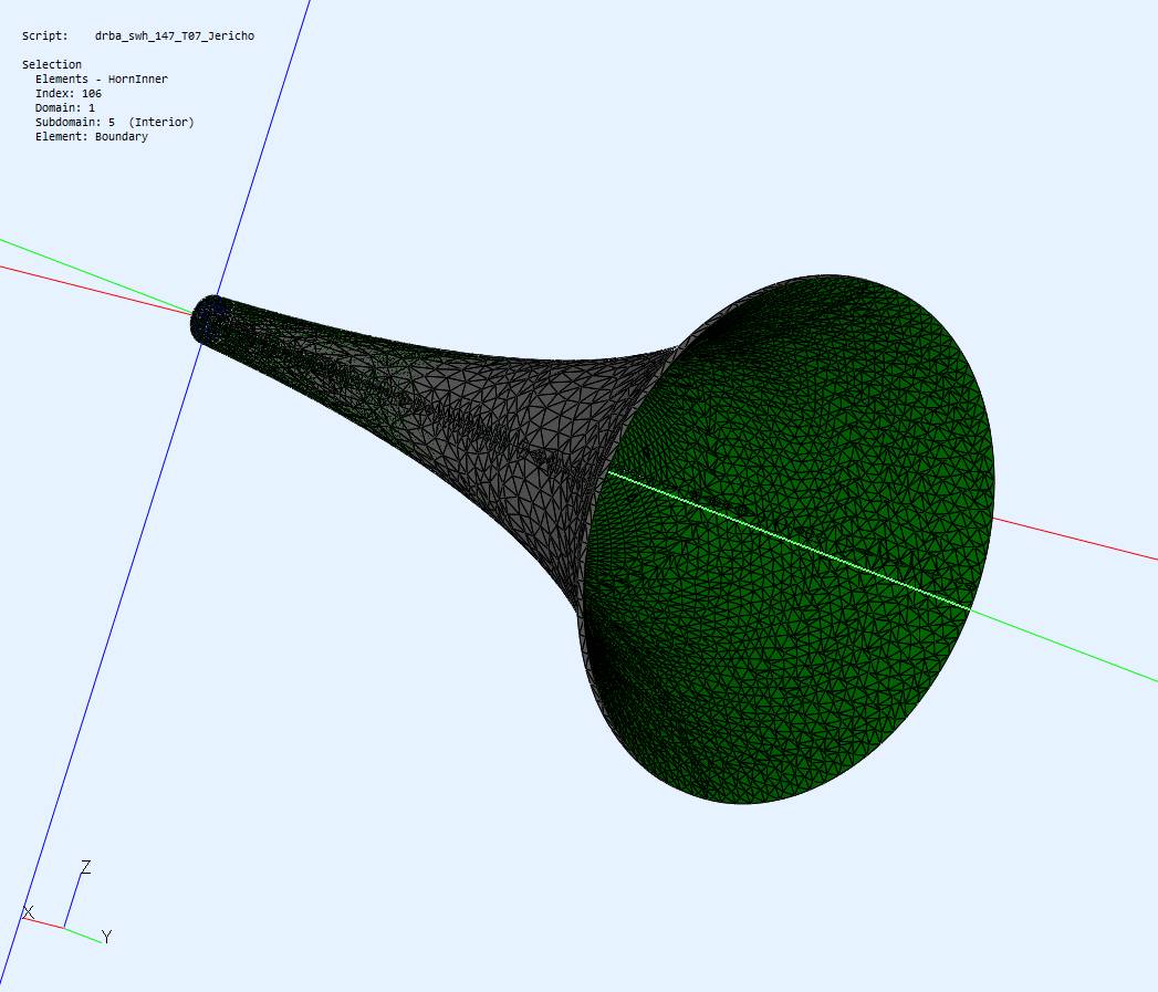

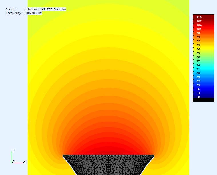

drba_swh_147_T07_Jericho - revisited
A few posts back there was a "jericho" horn provided by @docali that loaded very low but had a few issues. Speculation was it might be possible to "clean up" some of the diffraction and impedance issues.
These are the simulation results for that horn before modifications. The green surface is provided as the inner horn surface and will be identical in both.

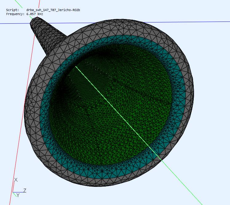

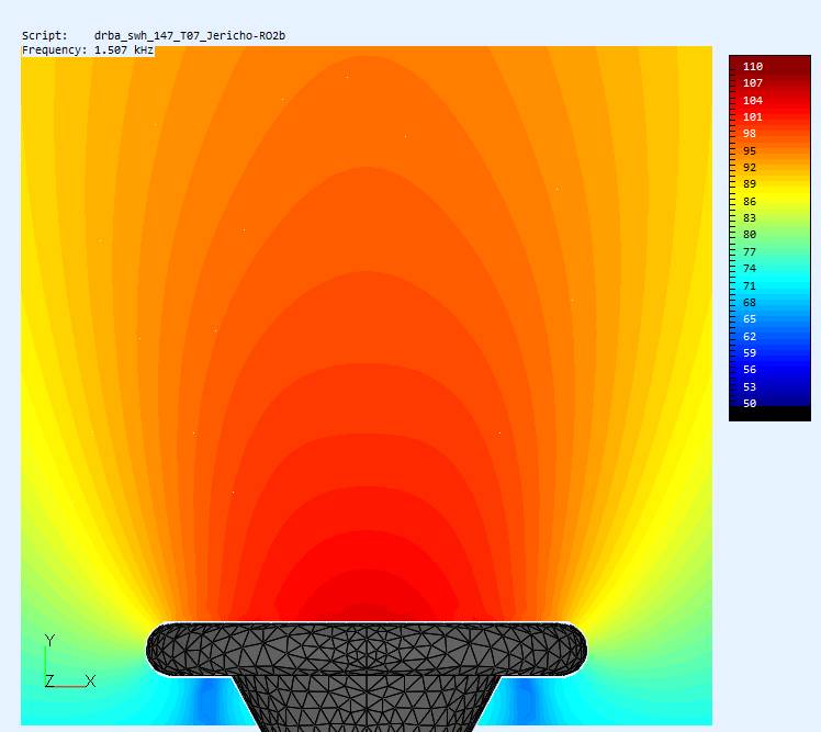

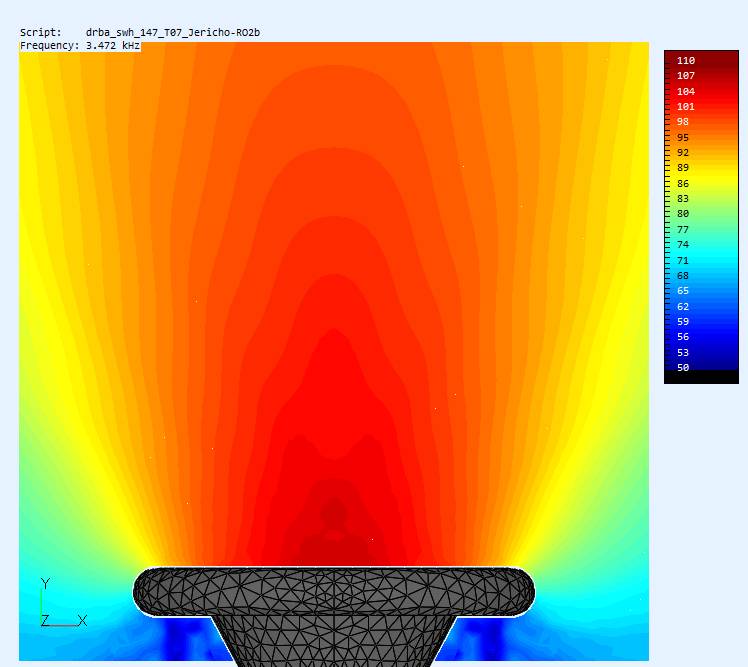

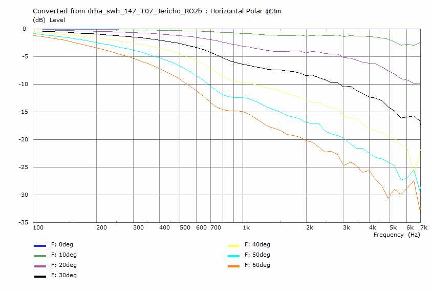

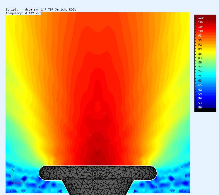

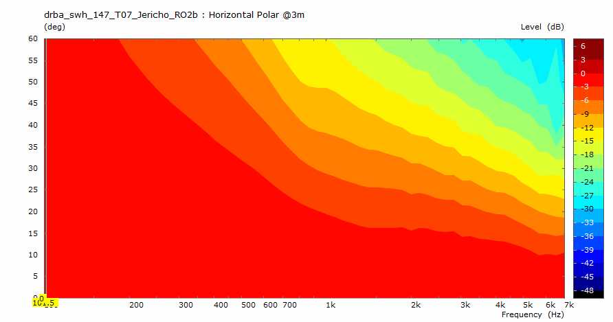

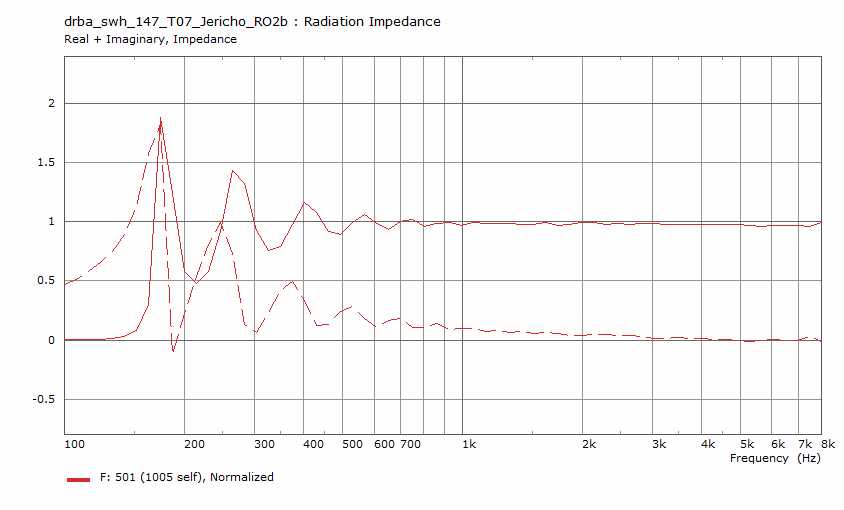

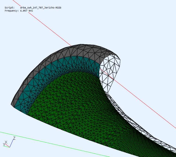

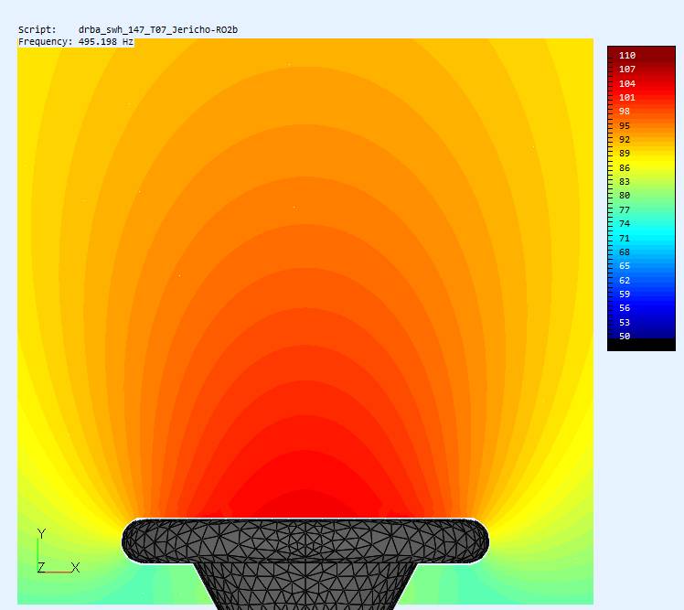

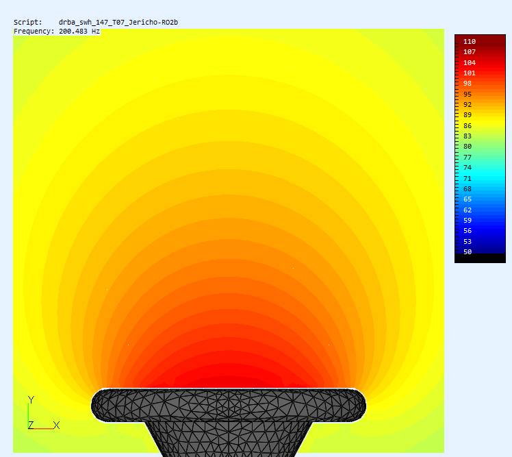

drba_swh_147_T07_Jericho - modified
This is "jericho" after some modifications.
The green surface is exactly the same as before. The teal surface is an additional curve#1 to take the mouth exit from 45deg to 90deg. The grey continuation is curve #2 to create the roll over. The same scale is used in the pre/post graphs.
Making the mouth larger improves the impedance match and the round over reduces the diffraction.

I also suspect (speculate?) that a slightly elliptic shaped round over, added to the jericho's circular mouth, may help reduce the impedance oscillation further.
