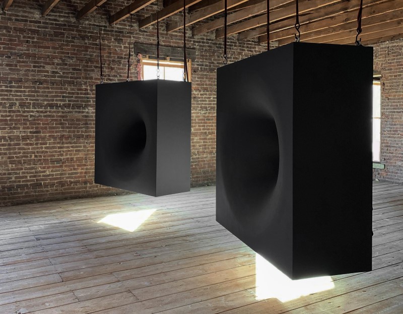

@Cowanaudio...I want to see you make a synergy out of that awesome horn you showed your're working on for the dcx464 🙂
It's already been done. 😎
Four 12s and a DCX464 makes for a potent high density box. Crossover is below 300Hz, the DCX is happy with that in a big WG at lower than stadium levels.

Oh wow. That sounds cool. Did you make it?
My design.

@Cowanaudio, still admiring your hanging speakers. Did you place the mids for loading per the patent or forego this, the waveguide appears to have a wide angle making it seem difficult.
That WG is around 60 degrees. Mid ports are elongated. I don't follow the patents, I prototype and come to my own conclusions.

Damn. You don't f*ck around. Awesome work.
Impressive work!
