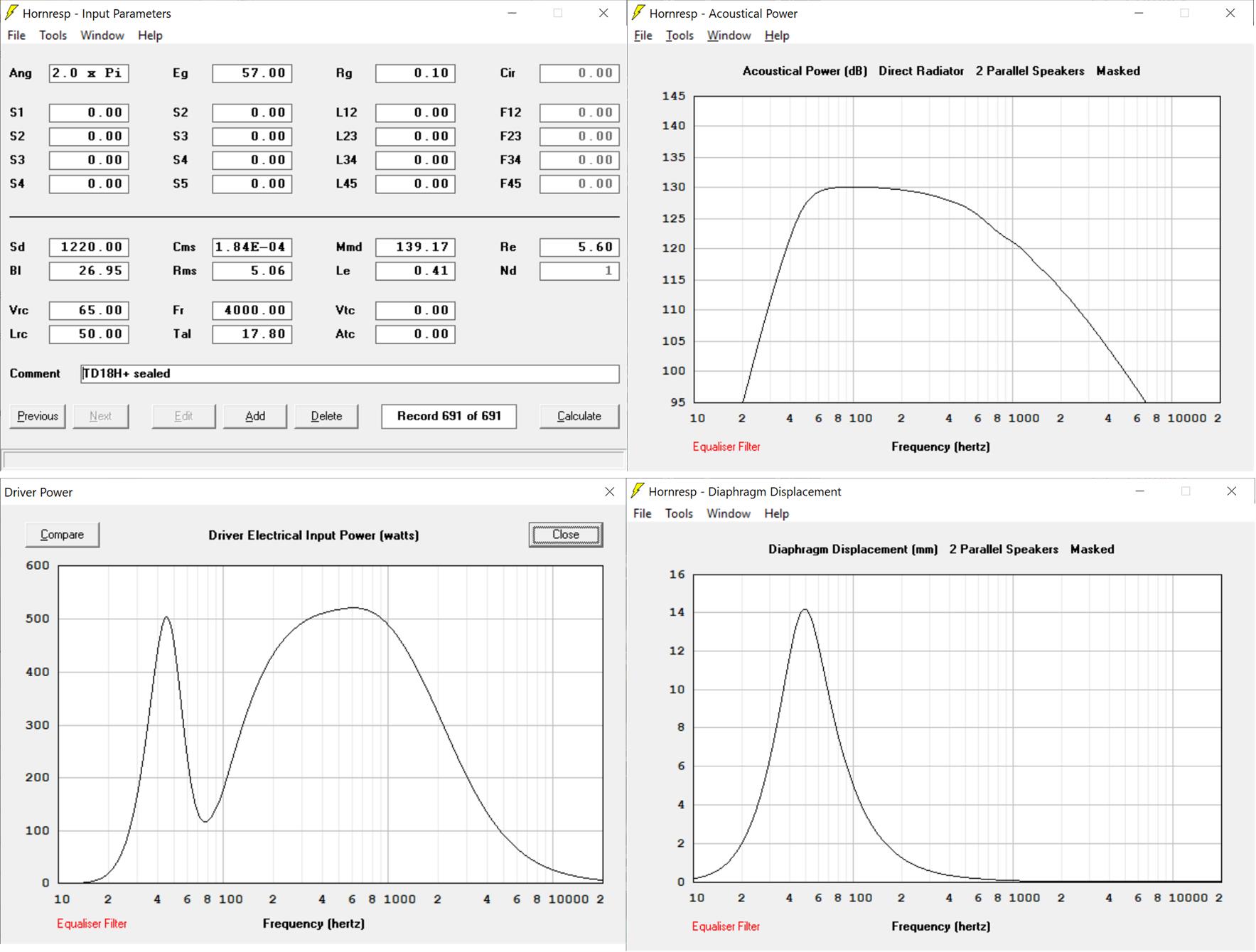

Maybe you want to trade Horn Resp formulas? I am only going by what I can come up with in Hornresp. I configurate until I get a response that I like....it was seeming that I could fit a TL in a 10cuft space for the 18"...The TL construction solves a lot of enclosure issues, hard to not want it. A slightly smaller TL for the 15" tuned to the crossover at 100hz?
Did you try to sim a br cab in horresp? I haven't yet.
10 cu ft would be just about acceptable 😉
Horn resp. (input) for TD15M-8 and TD18H+ :

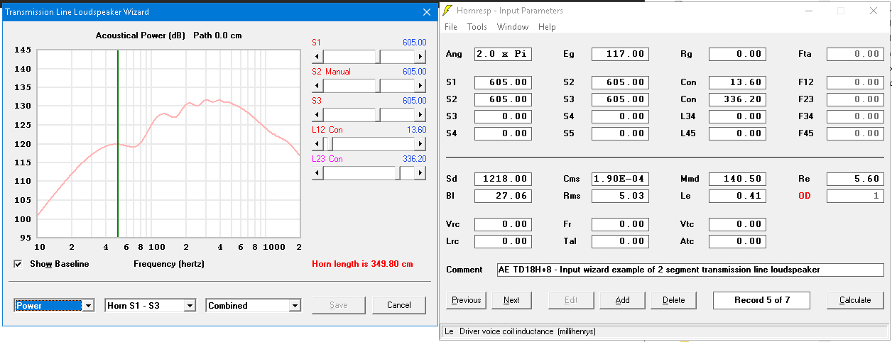

I have done this already yes! I've talked to some people on a forum dedicated to TL building, a person told me his technique, it is a process, but eventually you'll get it right. Mainly the application of the filling, is what I'm talking about, and from what I've read, a TL is forgiving to thiele specs. I wonna try it, if size permits.
😀 a lot of people seems to ignore the baffle diffraction and the sound propagation lobes on this site.
Beautiful.
Are you referring to the "flower in a pot" designs?
If you can rely on an experienced "big brother" during the design and construction phase, it might save you lots of time and hassle.
Don't get me wrong, the end result may well be worth the extra effort.
So, I think, if I were to take this, fold it, the resonance moves around to different areas...Then its your job to fold it in a way that doesn't compound resonant notes and are close as possible to the tuning note, once partially assembled you would measure it and fill accordingly until desired affect.

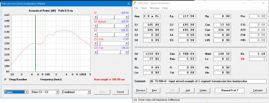

There is a folded TL calculator but it doesn't model Fr.
GM I thought this was your area.
If you'd rather spend money on drivers than cabinetry, you could use two TD18s per side in simple sealed cabinets With a little EQ you get this response at the excursion and power limits:
Two 18's side by side would be a fair match for the horns you are looking at. At in home levels, you can use more Linkwitz transform boost and not need subs

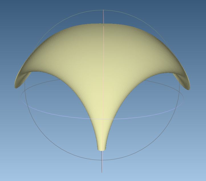

Maybe these horns would become too big for camplo with respect to mouth size but I like the new possibilities by using different progressive expansion expressions for horizontal and vertical profiles (HVdiff):
View attachment drba_jmlc250_hvdiff_rb180.zip
These shapes have an underlying super ellipse exponent of 2.5.
