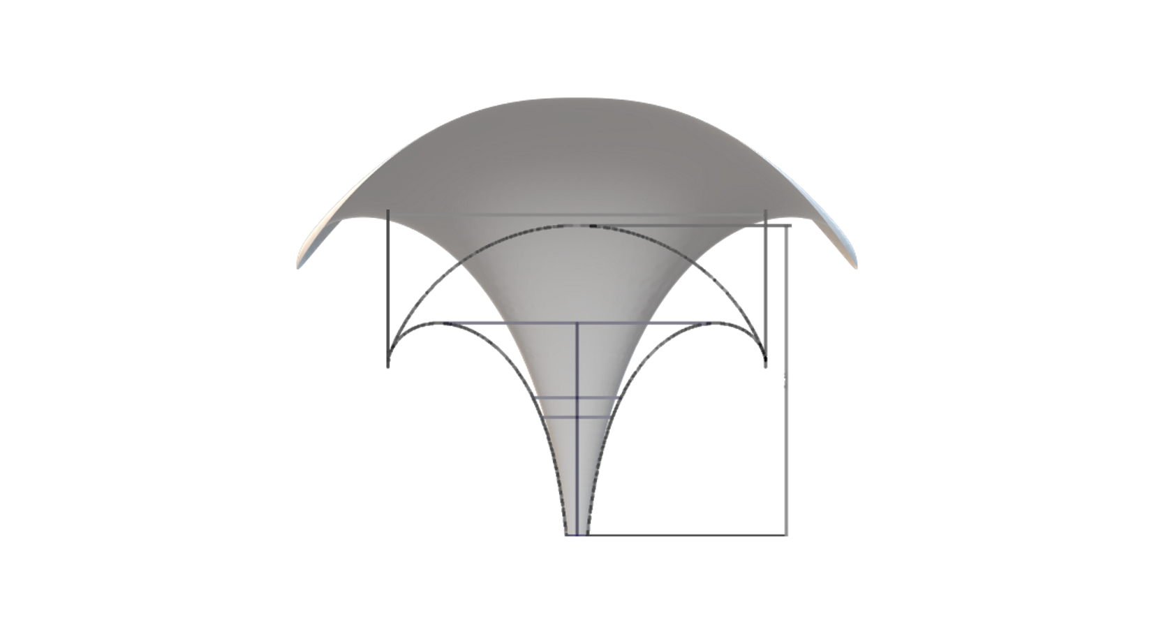

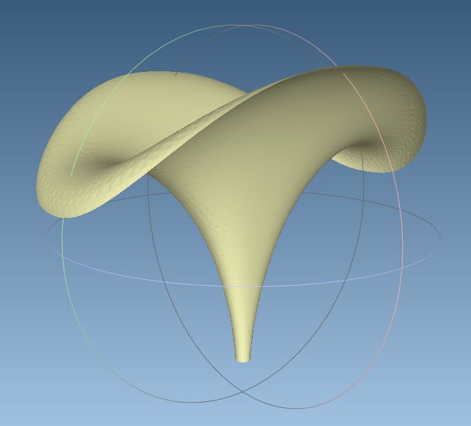

Here is another try to hit camplos requirements. It is complete different approach with an algorith inspired by JMLC and using diffenrent progressive expansion T functions for horizontal and vertical:
View attachment 797385 View attachment 797386
As you know =) these dimensions are satisfactory. This is easily the perfect horn for me to cross at 300hz, in theory. Maybe when Don gets a chance, he can run sims.
Devils Advocate.....without breaking the 300hz or lower request. Is this the horn you would choose? Why or why not. The drba_Shark_RA_45_PE_PRJ @ drba_Jericho_45_PE (pg 449) are not exactly miles away from ideal...is there anything that we haven't tried that is worth the effort, like the round overs on the lip. The original Jericho is really close, but suffers from the diffraction, would the radius on the lip fix the diffraction on the lip here too?

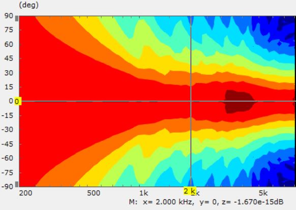

I've been looking at the polars of the first Jericho....I mean for a "work" horn this might, work. =/ It wouldn't be for casual listening, but for studio purpose. I was hoping he could get rid of the hot spot below 5khz but all in all, this might not be a horrible horn for a one man show...I dunno...I am trying to let go my dream of the 200hz crossover. 300hz isn't so far off....if the frequency response isn't great for the Hvdiff I should probably look at a round horn. I think this horn will have a FR better than the iwata. Gj Docali!

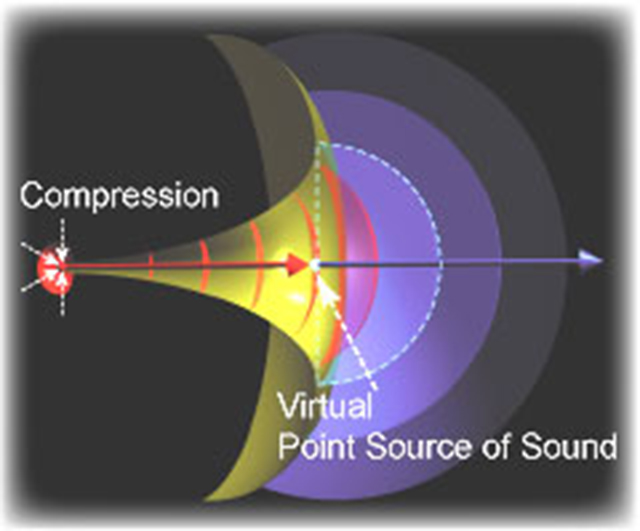

I found a picture depicting what I was trying to describe in the spiel I gave on how a horn works, and the pressure front that is created by horn loading. Its like the horn is a wide band tuned pipe causing the signals, source size, to increase to that of or near the diameter of the horn.

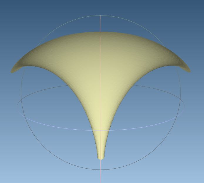

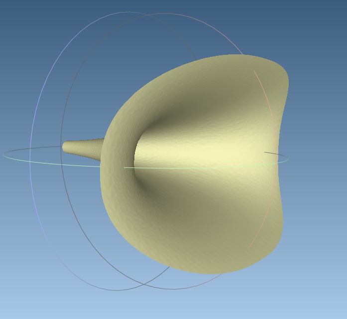

What we see here is a version as before but with more roll-back and super ellipse exponent.
View attachment drba_jmlc_hvdiff_rb2.zip
This horn should show a better observation field but also a considerably larger mouth.

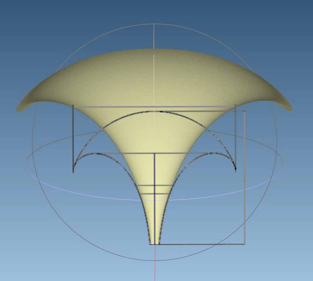

This picture is quite similar to the spherical wave horn approach with constant construction vector length.

I have already started to discuss edge diffraction issues with Don. These terminated mouth horns could be improved to a certain degree. As we see that a generous roll-back improve things much we could add something like a mini roll-back or lip to a terminated mouth horn like this here:
Consistent Modification of the Spherical Wave Horn – Sphericalhorns
This could be added by CAD software.

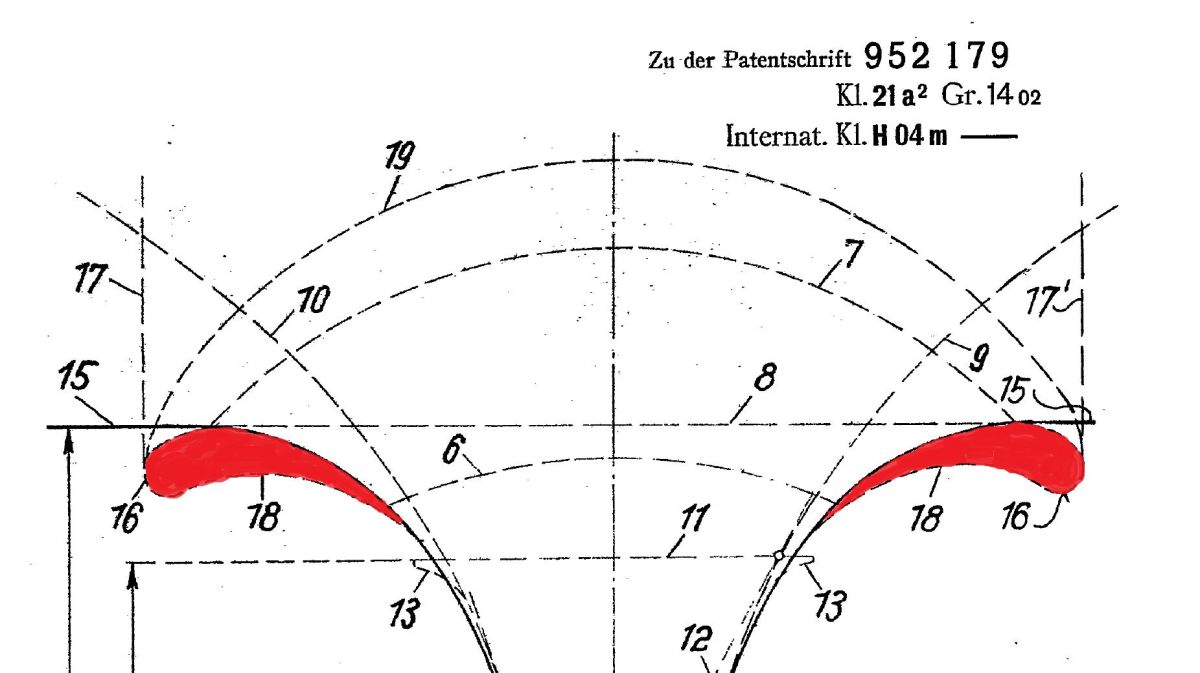

docali's drba_jmlf_hcdiff_rb2, overlaid with the Iwata profile is a near 100% fit at the throat > verified at pixel level.
The difference between the rollback of the drba and the Iwata is more or less similar to the red-colored area in the patent image posted by docali.

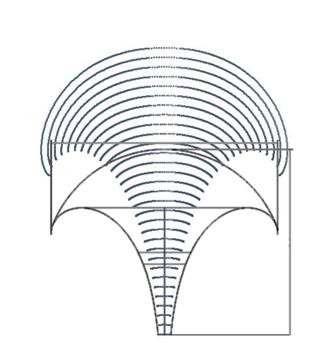

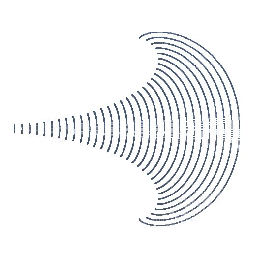

Btw, these are the corresponding construction wave-fronts:
Indeed, it's funny how the throats line up, everytime I drop the Iwata overlay on top of your horns (without any further adjustments after the initial scaling).
I suppose those are the projected "vertical" wavefronts, as "observed" from the side of horn?
It's obvious the expansion is limited compared to the earlier "top-views".

These are the horizontal expansion. The wave-fronts itself are circular for the calculation. Only one cut plane is shown in 2D.
That one cut plane is the horizontal?
Do you mean it's the cross-section of the horizontal expansion, and therefore the wavefronts in #4535 are actually "observed" from the (cross-sectional) right side of the horn, as suggested by its position?
