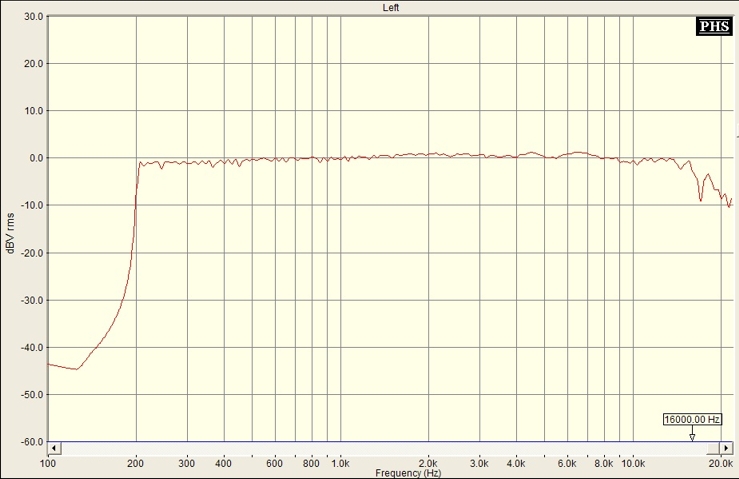

Pretty impressive frequency response of a field coil compression driver with Aluminum diaphragm.
Measurements taken at the throat of the driver, without horn, 1/24 octave spectra with a 16 Ohms diaphragm at 1 Watt (4.0 Volts RMS) sweep sinusoidal signal from 200Hz to 22,000Hz.
That can't be real. There has to be a roll off above the mass break point of the diaphragm. Just like you would see in a plane wave tube measurement.

Those curves look too good to be true, yet I don't think these are beyond what's possible.
At almost $6000 each it should outperform just about any similar sized driver.
I.e. the response of a S2 (without distortion figures) is also very impressive and better than 90% of the pro audio stuff.
The same goes for WE and some RCA drivers.
The plots are probably normalized and the green curve clearly shows mass break(up) at 4 and >8k.

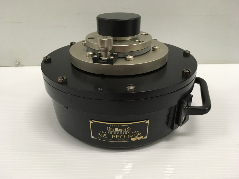

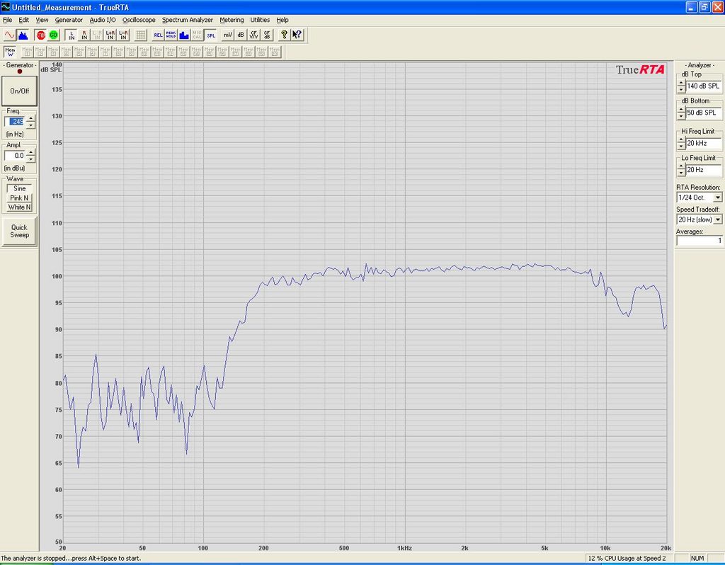

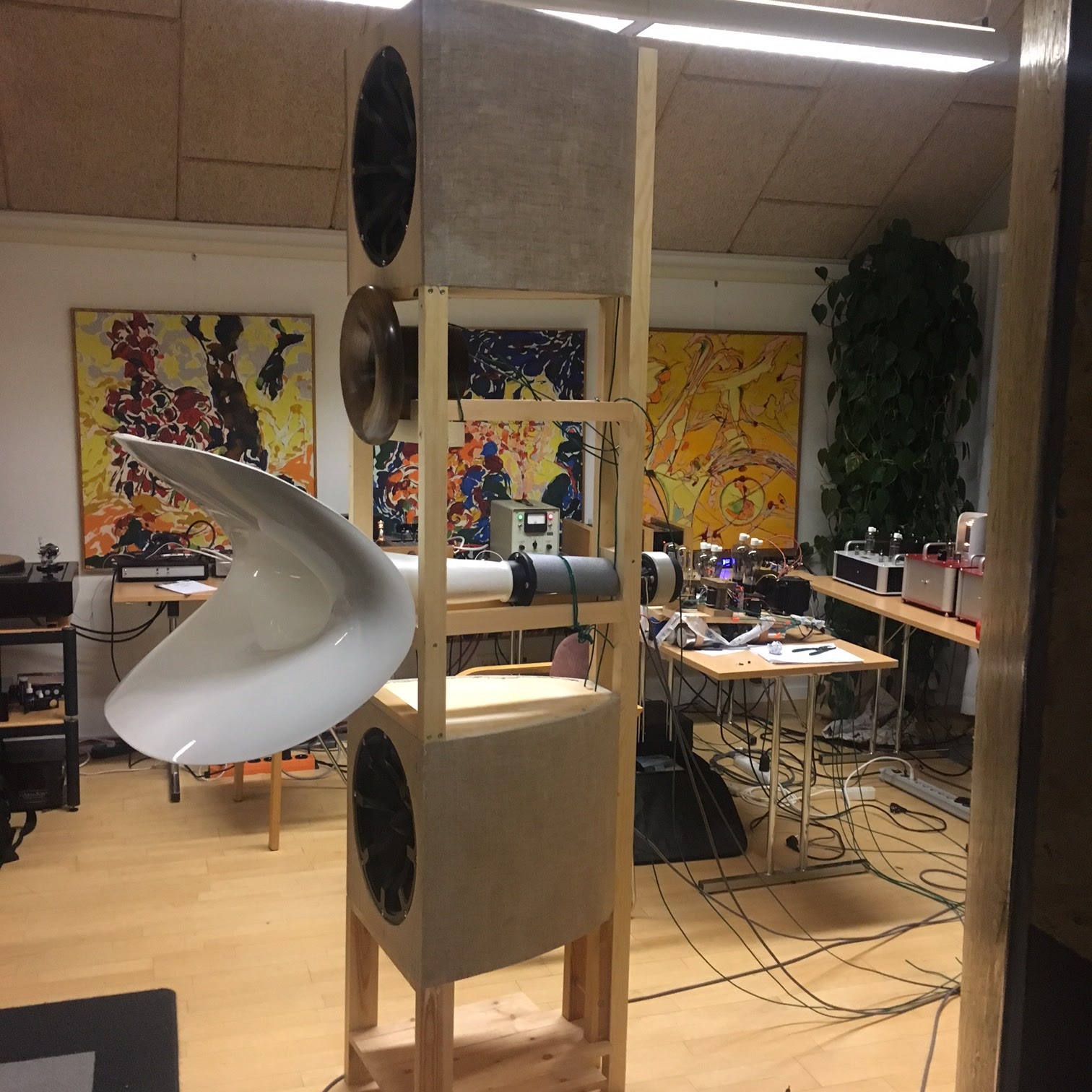

Line Magnetic LM-555 (WE-555 clone) with 20uF cap in series on AH160 JMLC horn, mic 0.75m back on centre line.
  • LM555 (with 20uF cap in series) on AH160 JMLC horn, mic 0.75m back on centre line.jpg

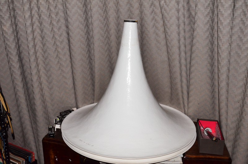

Interesting pic. I'm not dropping hints, I like your horn better Doc and Don!
I am aiming for S2 like performance then Ro808?
I guess you do. Even though many S2 addicts (Romy et al.) argue not to use it >6000hz, I know of at least one high-end loudspeaker manufacturer who told me it's fine up to 17k.
I hold this guy's opinion the highest regard.
At the same time we have to bear in mind that a S2 is not an Axi2050.

Why are the units in the graph dbv for an acoustic measurement?? You can't defy physics,
