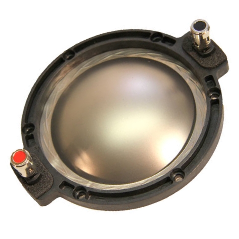

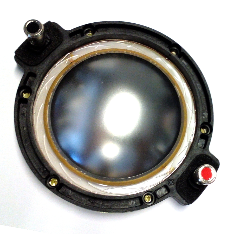

A couple of posts ago, I referred to the older B&C 3" drivers such as the B&C DE75-8, DE75TN, DE750-8, DE750TN, DE82,DE82TN, DE85, DE85TN, as well as the EAW, Nexo, Yorkville etc. branded counterparts.
2 interchangeable diaphragms are available for these drivers, the MMD3AM (Mylar surround):
or the MMD3ATN (Titanium surround):
Because of the steep prices of these (contrary to some modern diaphragms of i.e Faital Pro), there's an abundance of cheap aftermarket diaphragms available. These clones are getting better each year. I've read some reports of people who actually preferred clones to the originals.
As a domestic user, it's highly unlikely you'll ever blow a diaphragm, but what if you saw one these?
