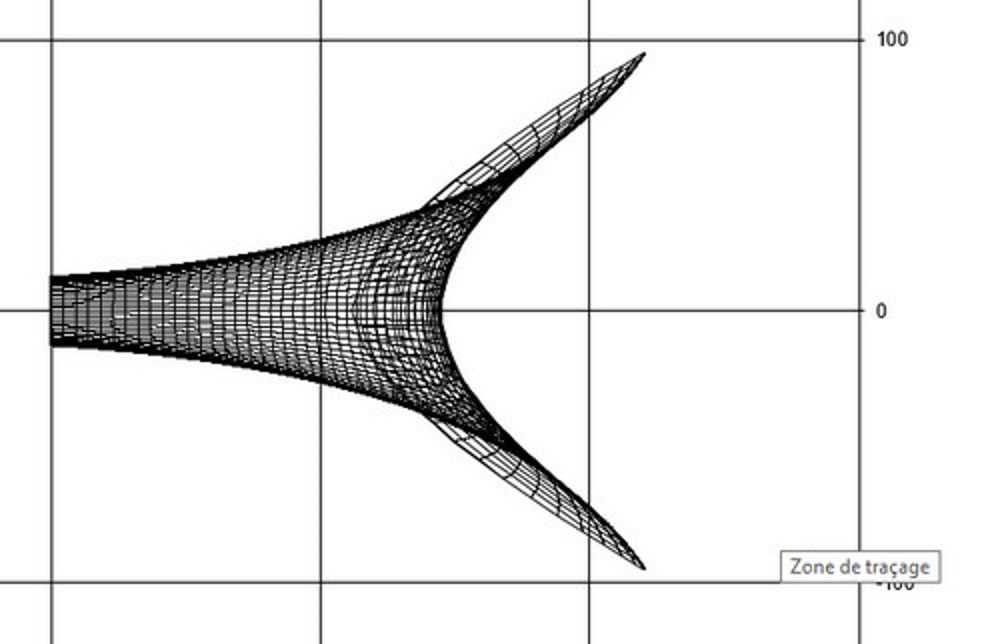

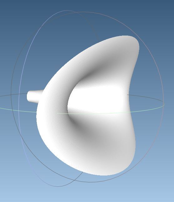

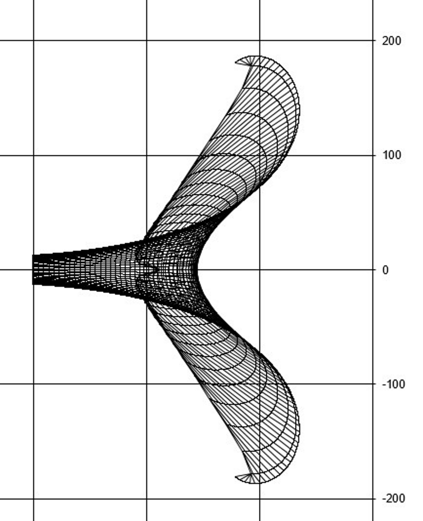

The construction is amazing. The way it looks as though the HF horn was carved into the same single piece of wood as the mid.Like this?
Maybe he could use the version with roll-back but with projection. The projection itself reduces the mouth diffraction effects.
Here two versions with increasing T and different stereographic projection applied and slightly lower cur-off:
View attachment 795647 View attachment 795648
Btw, with progressive expansion T the cut-off value has less meaning but it still determines the construction vector.
Any version if you cross @ 650?
JMLC horns with the spiral (270°) rollback are different from the IWATA and E-JMLC.
Originally, the JMLC Quasi IWATA horns have a 180° "opening" (rollback).
All (commercially) produced IWATA JMLC horns have a truncated mouth in order to reduce the height.

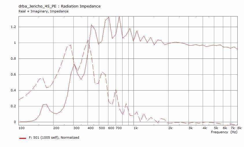

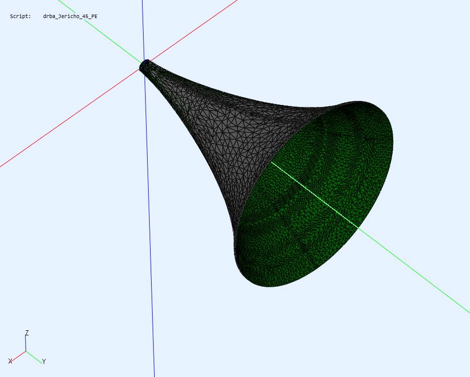

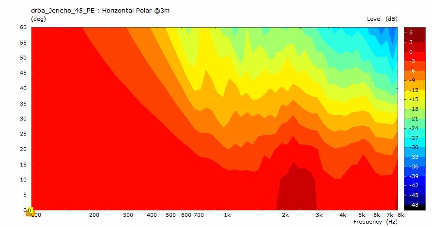

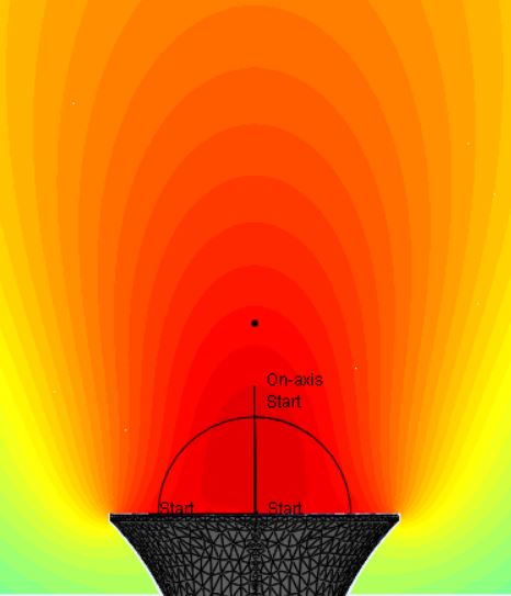

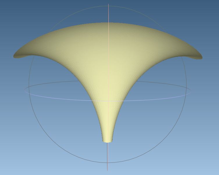

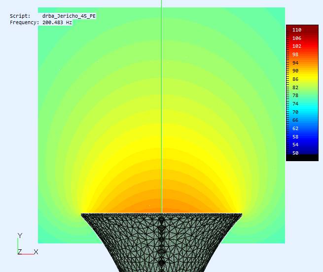

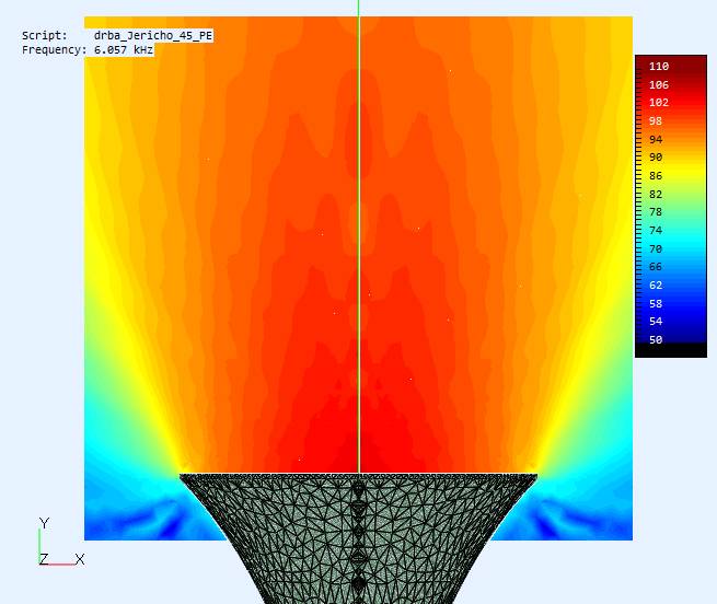

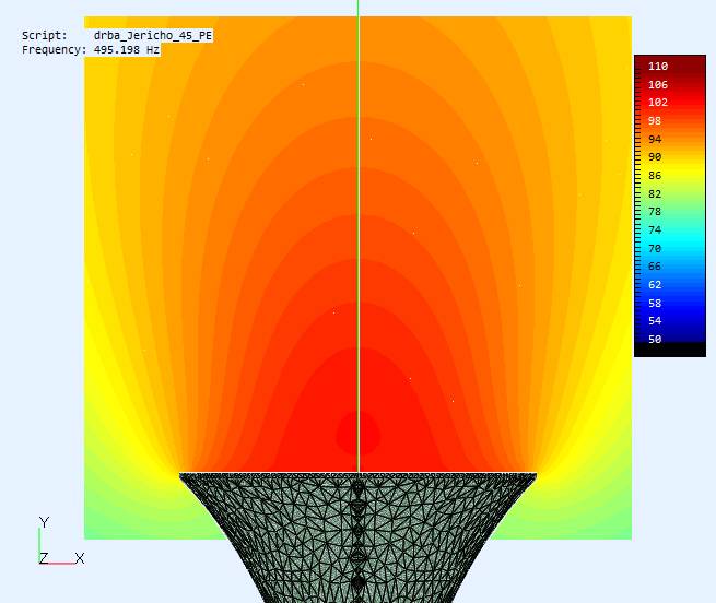

drba_Jericho_45_PE - Simulation

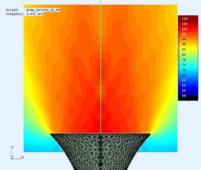

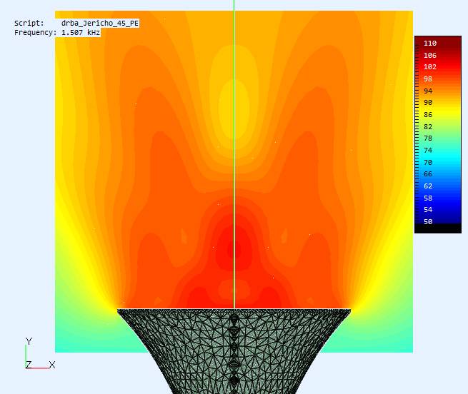

This horn has a very sharp edge at the mouth that is causing diffraction and reflections. It may go low enough but I think the mouth termination needs improvement.

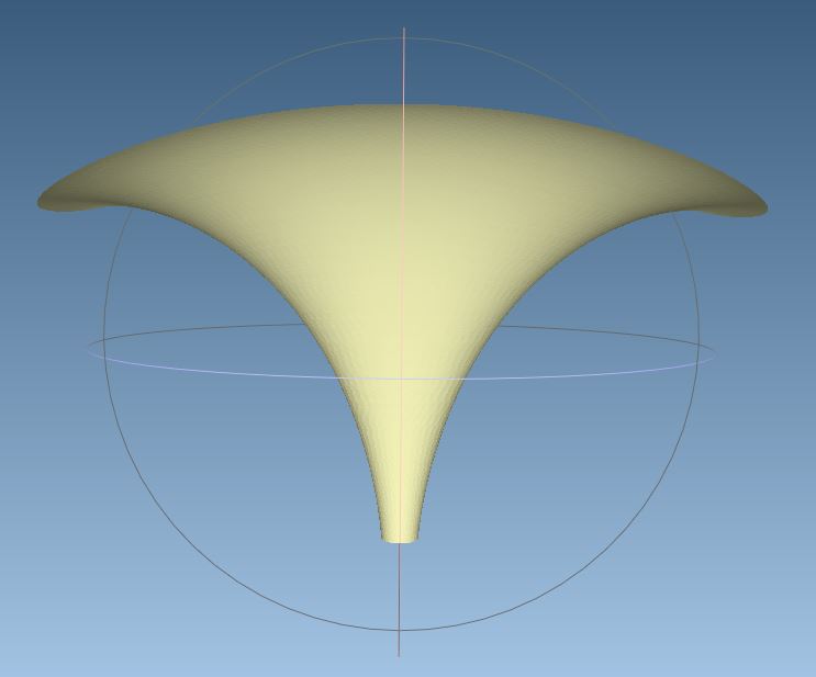

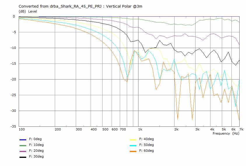

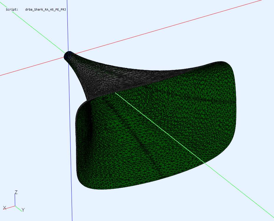

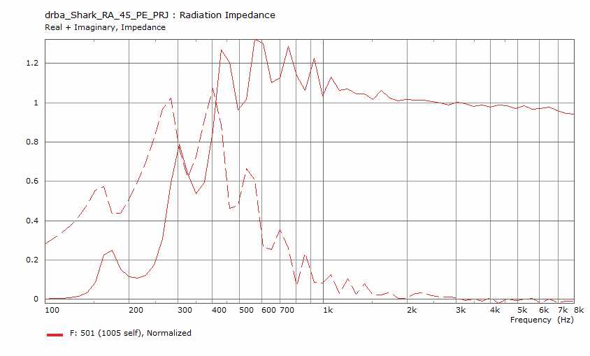

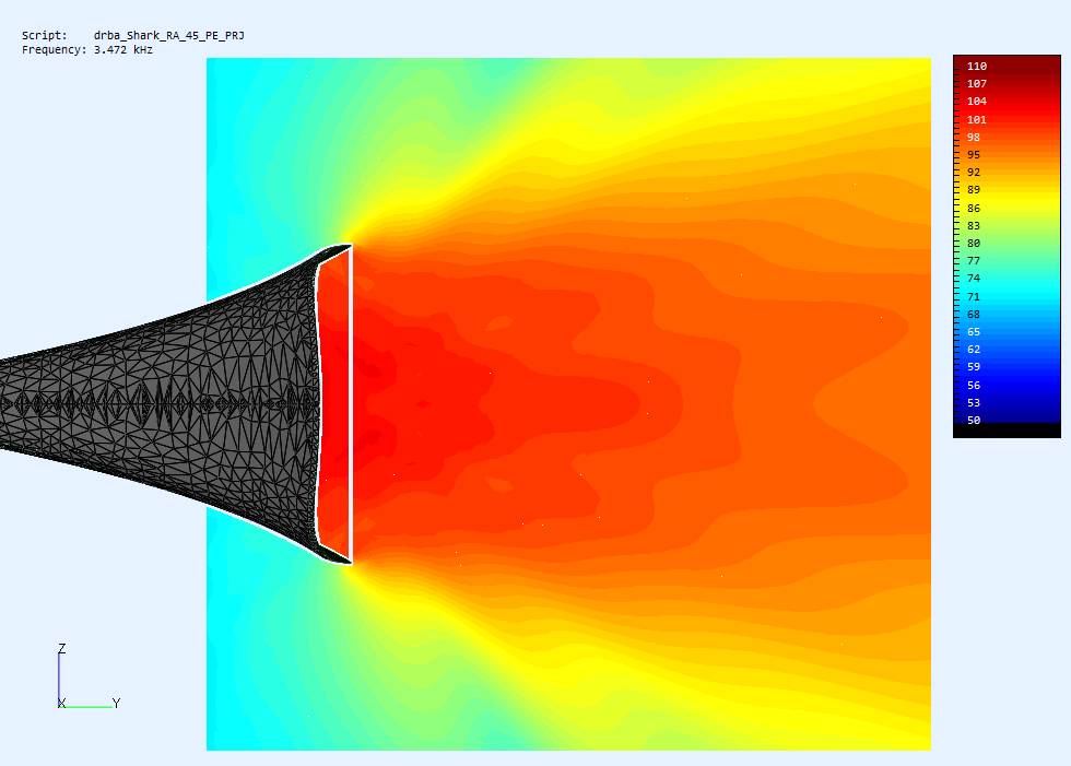

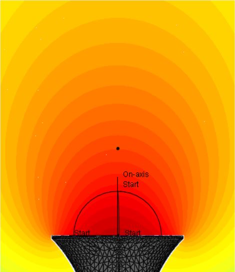

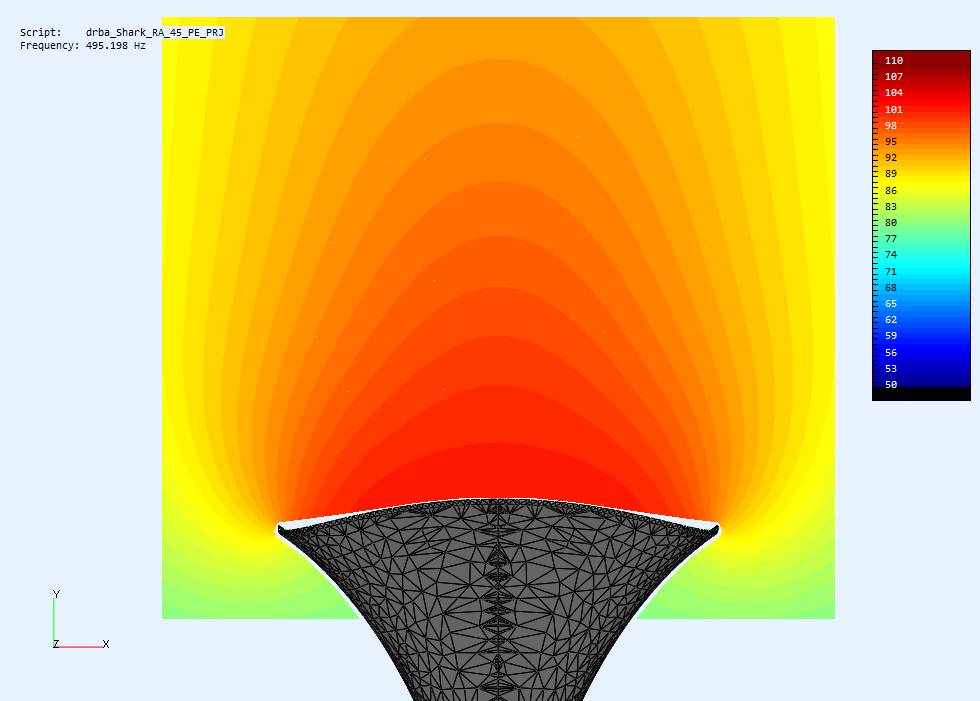

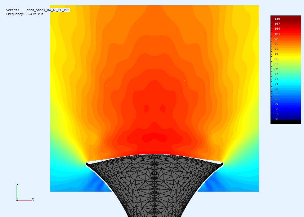

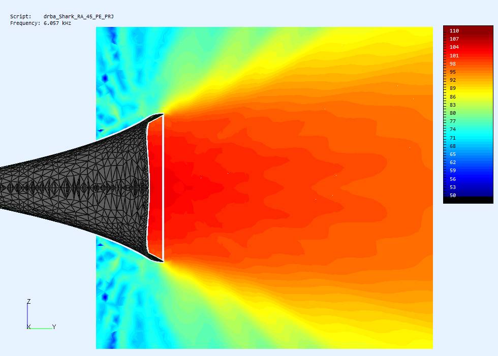

drba_Shark_RA_45_PE_PRJ - Simulation Results
Similar issues with the mouth termination.

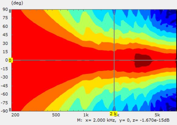

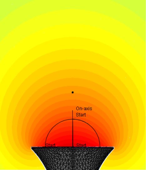

.. and the observation fields

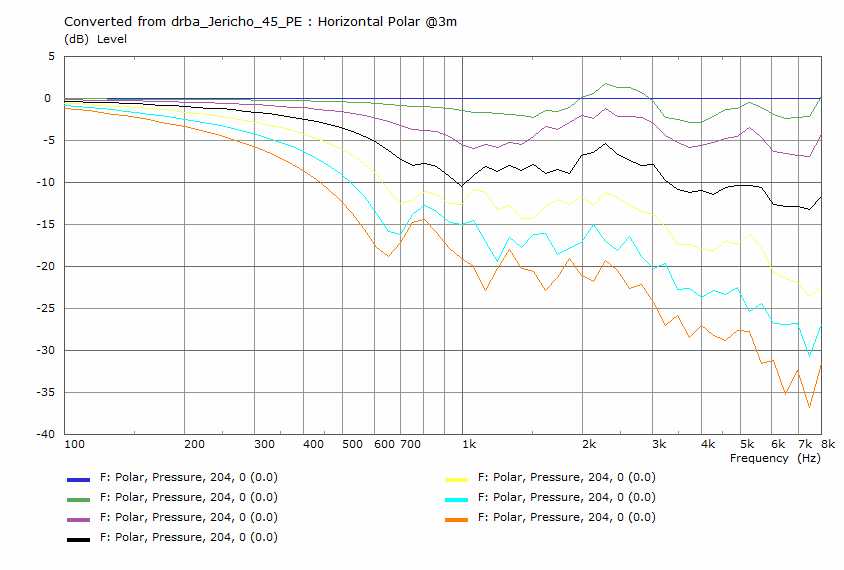

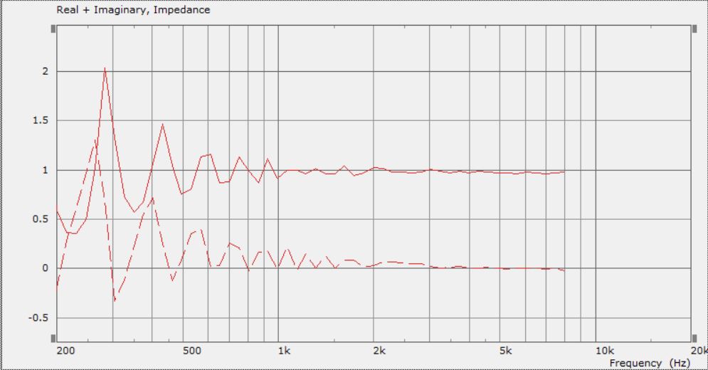

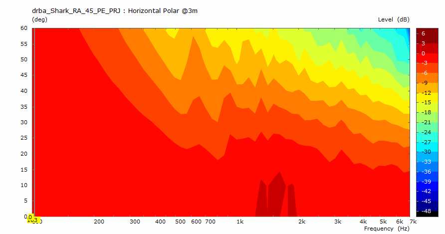

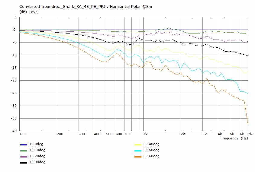

Don, do you agree the ripples seem to flatten once the wavelengths are smaller than the mouth circumference, >1k?
Once again, thank you for the efforts!
Yes, but the horn is starting to beam at that point. I think adding a small round over would help this issue. I've seen that improve lots of simulation results.
No problem to run a few sims. I'm interested in how this progresses.
Added - are you suggesting the mouth is too small to support the lower freq?
All these truncated horns are a compromise. For the last two just simulated the parameters were maybe pushed too hard to get a larger mouth.

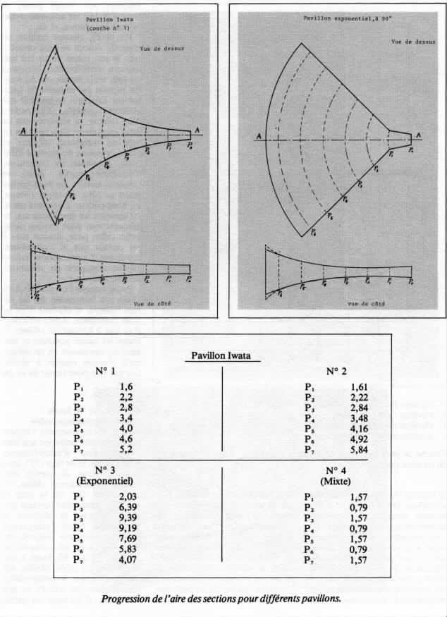

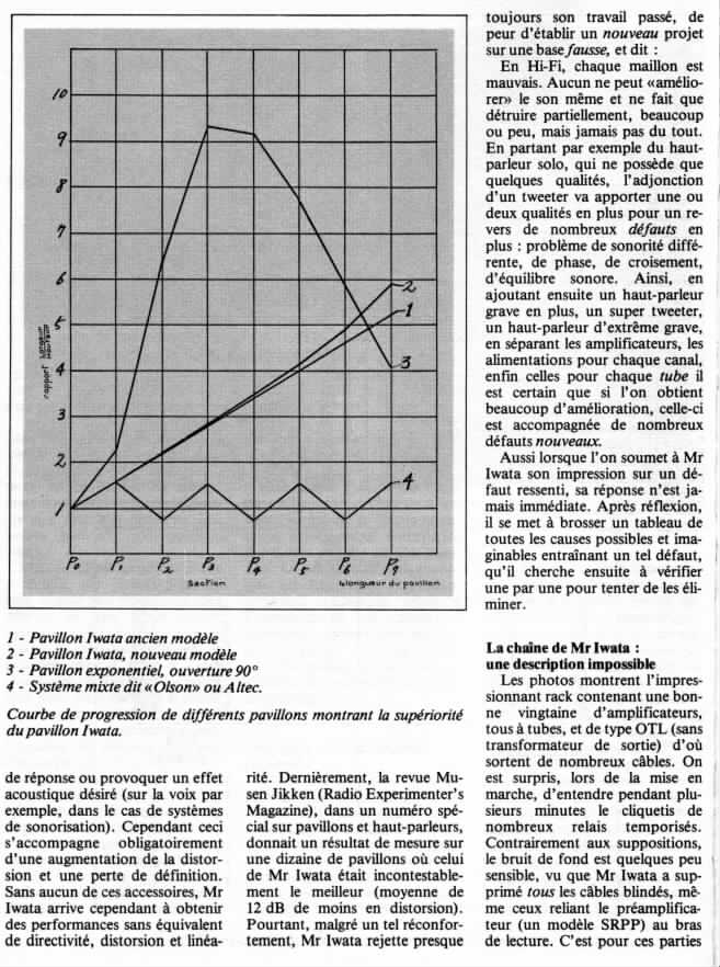

The mouth round-overs are interesting. FWIW, the original Iwata horns - the ones he used at home - had a unique termination. The edges were slotted. Ro808 will know what I mean.
At the mouth edge Mr Iwata broke up the surface into slats with progressively wider gaps as the curve moved out. It was meant to allow a progressive transition from hard surface to soft termination. Or perhaps from high impedance to low impedance. The idea came from his work on reducing shock wave at the mouths of the high speed train tunnels.

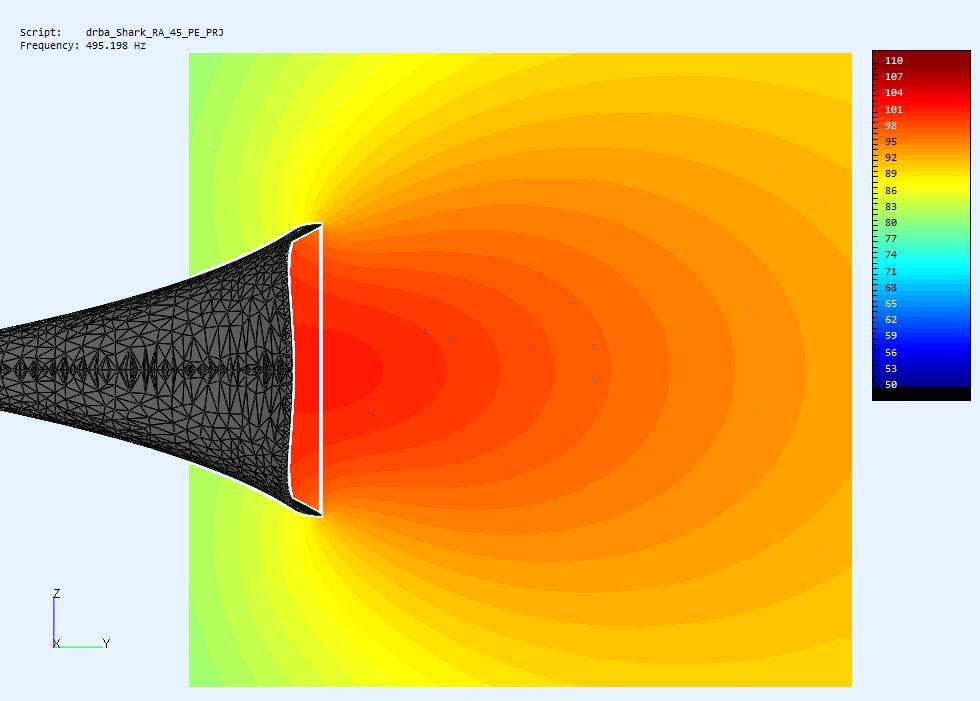

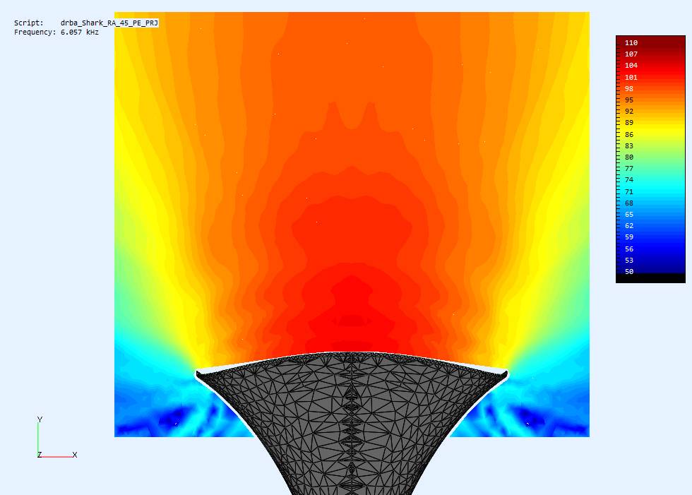

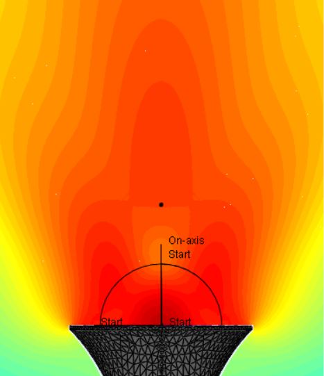

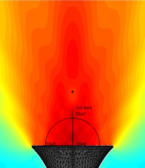

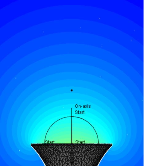

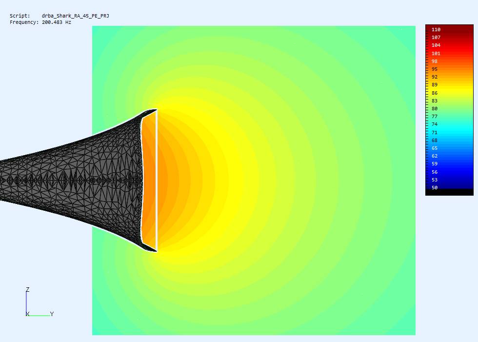

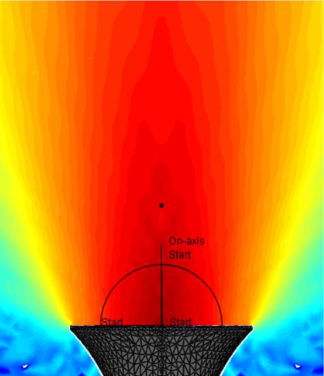

Ok, just the hot results from the Sim for the 45 deg termination mouth horn:
The LF performance show some ripples but this seems to be normal for such a type. It should load very low. The oberservation spectrum views are not as nice as for the roll-back horns but this horn is a compromise. I expected even more artifacts because of the sudden mouth termination.
View attachment 795327 View attachment 795328 View attachment 795329 View attachment 795330
View attachment 795331 View attachment 795332 View attachment 795333
So this horn is the only one that can support 200 so far? I guess you wouldn’t need max output at 200hz if it’s being crossed since it would be down because of the xover... I asked before exactly what are pictures depicting outside of directivity, I’m pretty sure the colors represent levels of transfer function vs distance and position, for example the red area in the 200hz suggest that if you are past a certain distance that range will start to fall off.

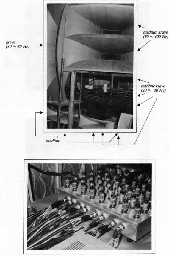

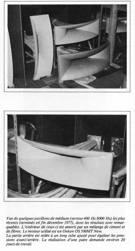

That's a coincidence, because I was just looking into Onken SC500 and Le Dauphin, which are sectoral horns. The Onken was also used by mr. Sato at the time of Jean Hiraga's visit.
And yes, Mr. Iwata used vaines for his (sub)horns, as described and pictured in the attached article from the French magazine l'Audiophile. The original long midhorns are also shown.
The Japanese masters improved upon many of the classic horns by applying sophisticated damping methods.
