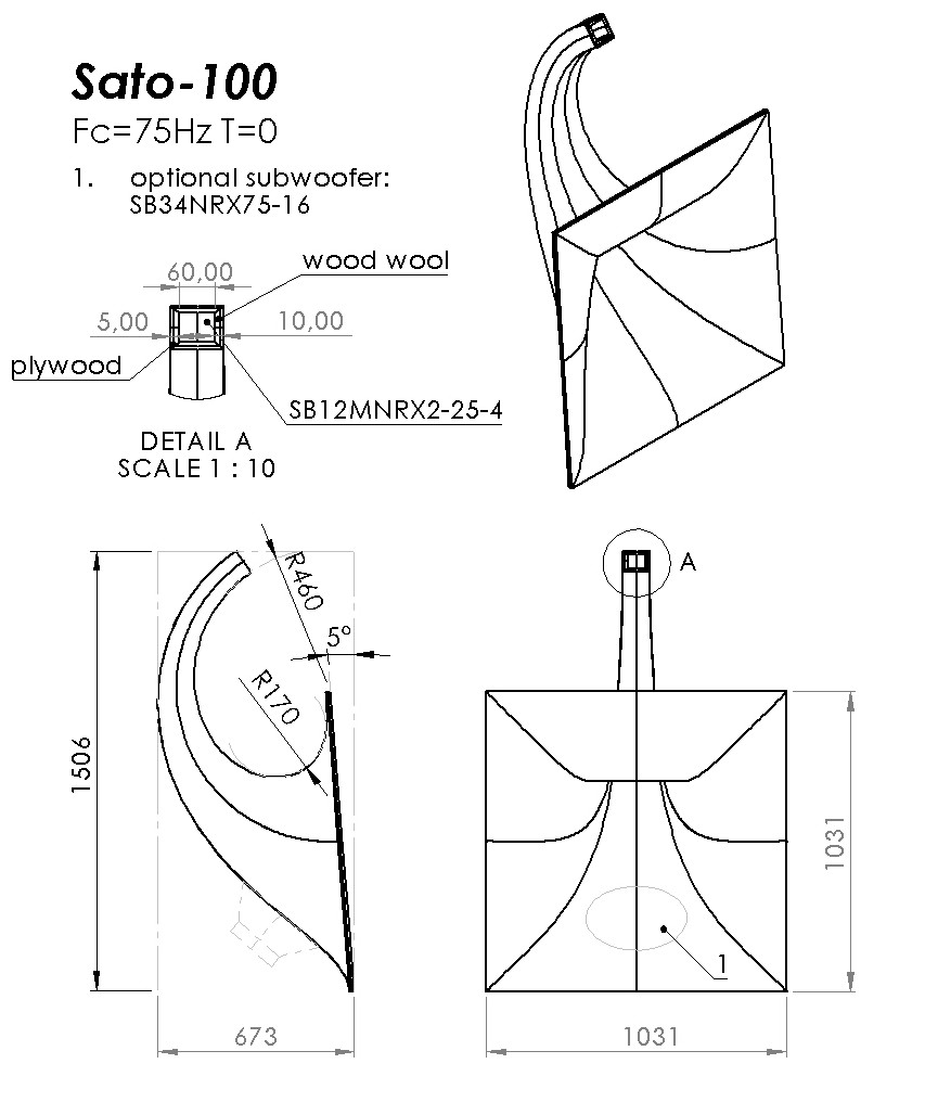

These horns are nice, they are starting to remind of my favorite looking horn, the jmlc iwata. The iwata style mouth can be integrated into other horns, are you able to do this in light of the recent horns you’ve shown? I really like this one, along with the first 2 Jericho 45 models. The latest ones with projections are great too.

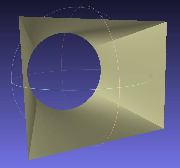

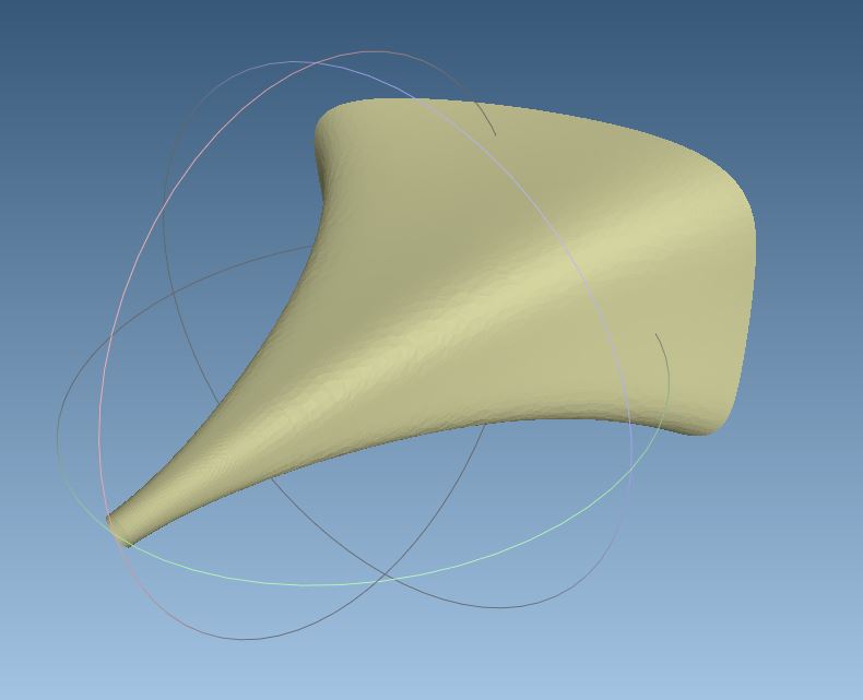

I like horns of these type. I own myself a pair of TH4001, they measure very good and load very low. IMHO, especially for this horn I think the adapter is too short and intended for very wide dispersion. Therefore, I wrote a small VBA macro to export point cloud for such adapters round->rectangular. This was a bit tricky to transition between the two shapes by preserving the edges correctly:

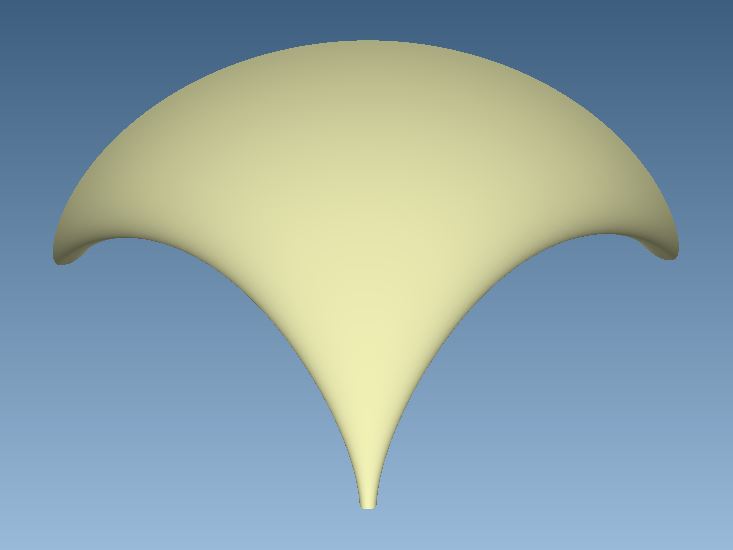

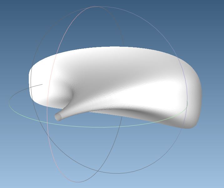

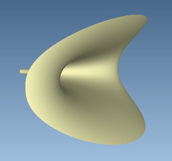

I assume that you have something similar to PACMAN in mind? The form is the result of stretching and the amount of stereographic projection applied:
View attachment 796186 View attachment 796188

I suggest that you read my article about stereographic projection:
A Normalized Stereographic Projection for Spherical Horns – Sphericalhorns
Then you might understand better what is going on. Put a circle on a sphere and it fits perfectly. So, for a circle the projection does nothing. But put an allipse on a sphere then you have to bend it to fit on the surface. The more stretching is applied the more curved the mouth will be. Where the mouth diameter is small (vertical) the length of the wall is longer and should provide a little bit more loading here. If you want equal loading then you need a round mouth. Btw, the last round horn shown is running currently as simulation...

I was just thinking Docali, the shape I’m thinking is a rectangular eclipse, auto tech has a good example IWATA-200 - Horns by Auto-Tech
The JMLC-Iwata horn is a product you can buy now. Why not stick with this?
I can only do drba horns following the math described on my webpage

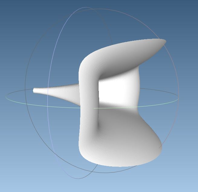

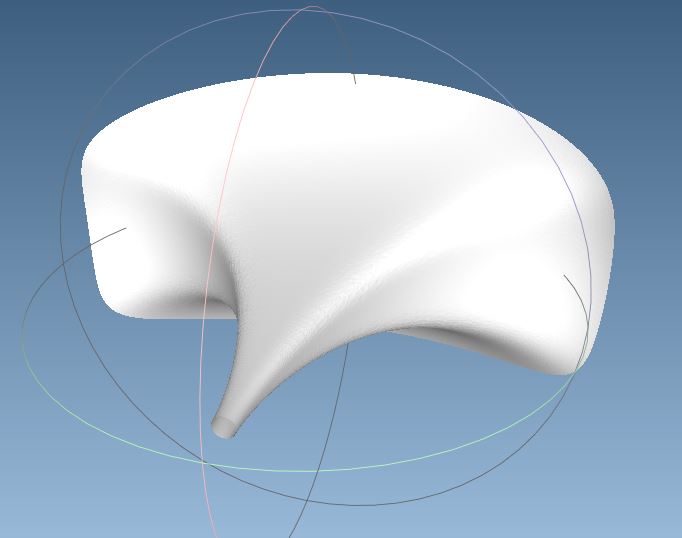

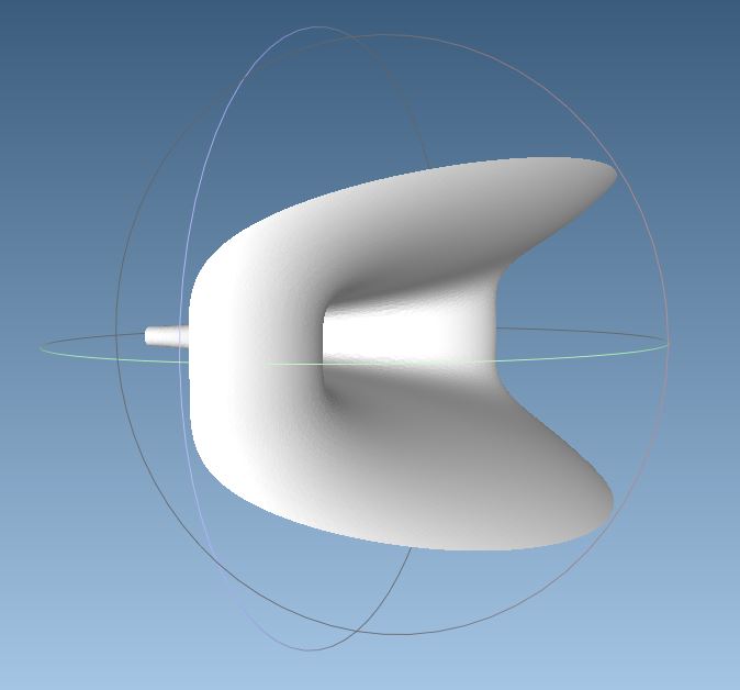

What comes nearest to your requirements could be increasing the Lamé exponent. Some call it super ellipse but with an exponent of 6:
View attachment drba_SWH_SE6P_PET-05-10-25.zip
It can be pushed to the extremes to favour the horizontal listening plane:
View attachment 796476 View attachment 796477
Looks similar to EV9040A:
