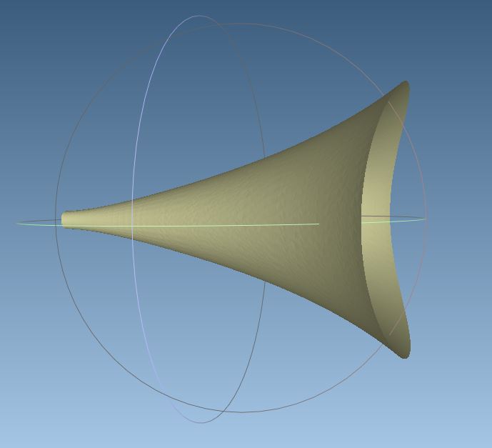

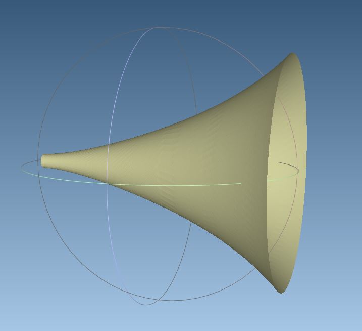

As camplo showed some affection to the Jericho 45 here is another horn of similar type but with progressive T which should have slightly less beaming. The length is about 90cm:
View attachment drba_Jericho_45_PE.zip

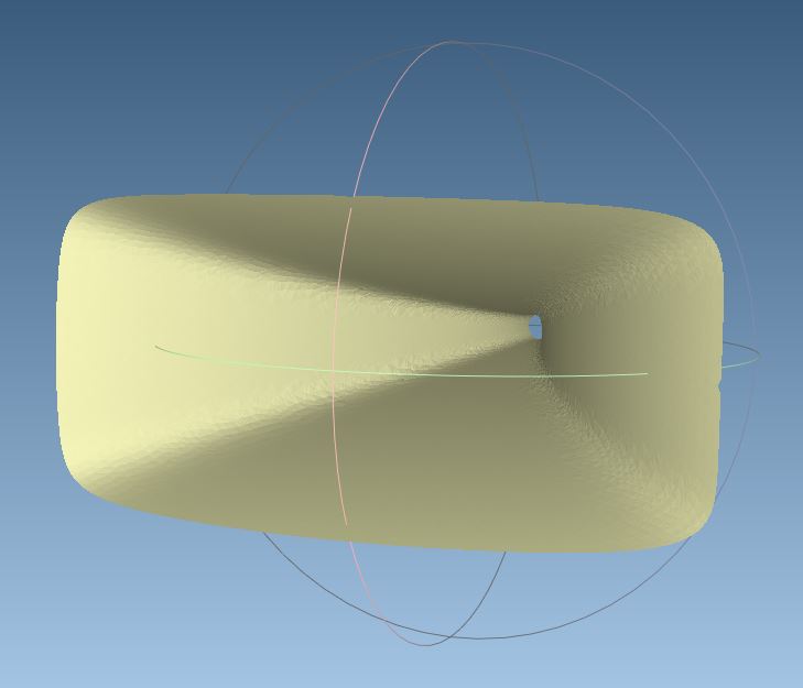

And here the model shark with slight stretching and projection applied
View attachment drba_Shark_45_PE_PRJ.zip

Can these feature a round-over? Especially that last one?
The roll-back causes the horn to become huuuge!
View attachment drba_Shark_SE_45_PE_PRJ_rb.zip

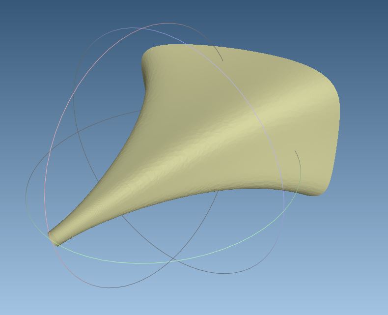

...and for you an even more horizontal focused horn. I like this 45 degs termination horns as they can become very long (good loading) and are space efficient mouth wise. The stereographic projection should help to reduce mouth diffraction.
View attachment drba_Shark_RA_45_PE_PRJ_mk2.zip
