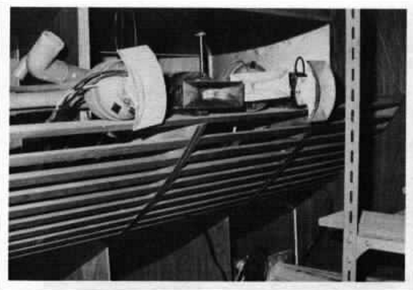

The mouth round-overs are interesting. FWIW, the original Iwata horns - the ones he used at home - had a unique termination. The edges were slotted. Ro808 will know what I mean.
At the mouth edge Mr Iwata broke up the surface into slats with progressively wider gaps as the curve moved out. It was meant to allow a progressive transition from hard surface to soft termination. Or perhaps from high impedance to low impedance. The idea came from his work on reducing shock wave at the mouths of the high speed train tunnels.
That is a very interesting idea, thanks. Do you remember if the slots were axial or radial?

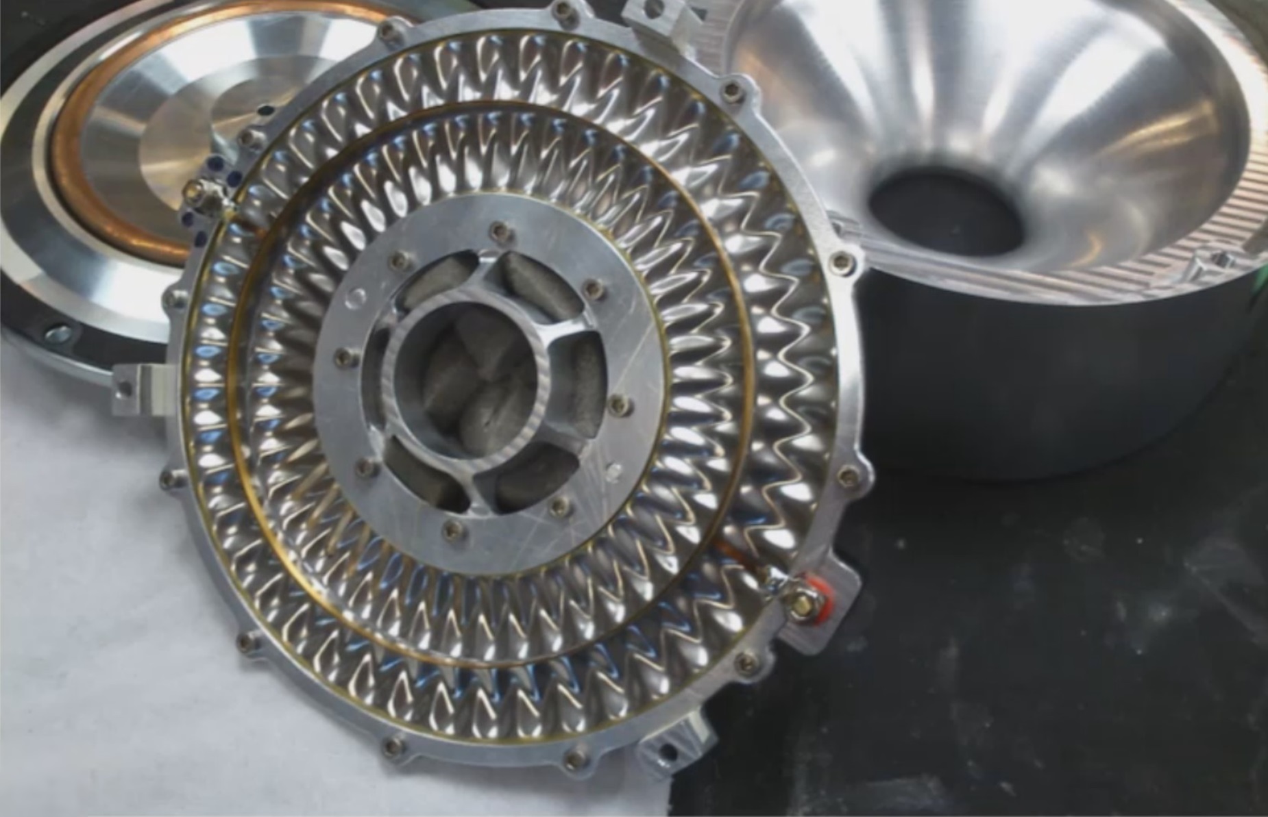

Ro, I'm interested in the diaphragm pleating. Wouldn't there be extra stress at the folds that will eventually cause them to tear? I suspect it doesn't need to be this elaborate to reduce the simple breakup modes but maybe it should be, to provide axisymmetry and reduce stress?
The diaphragm isn't a regular dome, but a circumferentially, AxiPeriodic, annular diaphragm and therefore the voicecoil is located in the middle.
The underside looks like this:
Thanks for showing me why I'll never open it......until they come out with a aluminum or beryllium replacement diaphragm..... =/
There are horizontally mounted slats (with increased spacing) and the actual 'vents' (vertical), each with different proportions.
Iwata used 36!!! drivers for each channel of his bass horn.
This man was a true genius. He developed more than 180 different horn types and over 400 different horns (weighing up to 800kg each)
He was remarkably gifted in mathematics/physics and rejected most of the existing theories and works of Olson, Klipsch et al.
A Quote:
"For his PhD thesis, Jack Oclee-Brown published research showing just how the inherent modes of vibration in a compression driver diaphragm are prone to coupling with the acoustic modes in the driver cavity, producing all manner of unwanted resonances in the output—research that was also only possible using computer-based analysis of the underlying physics at work in compression drivers. The research concluded that an annular, or ring-shaped diaphragm, could suppress these resonances if carefully designed. Mark Dodd, our head of Group Research, came up with the idea of a periodically symmetrical, corrugated ring diaphragm, which would combine strength with modal suppression.
All these avenues of research combine in the Axi2050, which employs a single voice coil and the thin, annular, gently curved 175 mm-diameter titanium diaphragm designed by Dodd and Oclee-Brown, together with a multiple-aperture phase plug. After five years of research, the precise nature of the three-dimensional corrugation and its rotational symmetry about the newly named ‘axiperiodic’ diaphragm was finalized using modeling techniques to reduce the modal resonances in the driver to an absolute minimum, and the gentle curvature ensured that the first breakup mode is very high for a five-inch diaphragm.
Furthermore, because the titanium diaphragm is thin and very low in mass, it is sensitive enough to accurately reproduce frequencies up to 20 kHz, but at the same time sufficiently resilient and large in diameter to reproduce frequencies down to 300 Hz, at high SPLs if required. The large diameter also conferred another benefit: The compliance of the driver changes little with large excursions at low frequencies, which keeps low-frequency distortion (to which human hearing is particularly sensitive) at a minimum. Finally, the wideband response meant one driver could cover the entire MF/HF range, doing away with the need for a mid-to-high-frequency crossover—another of our design team’s aims."

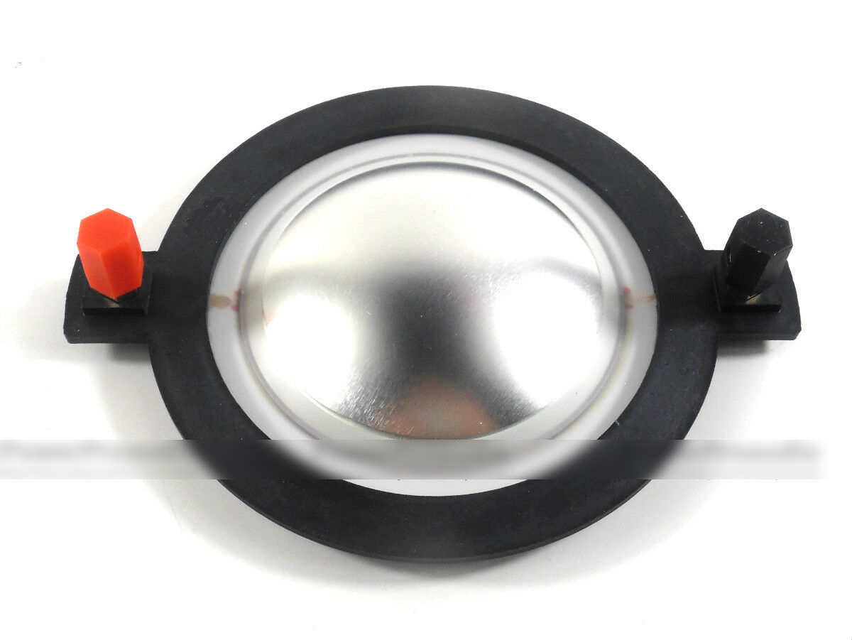

A couple of posts ago, I referred to the older B&C 3" drivers such as the B&C DE75-8, DE75TN, DE750-8, DE750TN, DE82,DE82TN, DE85, DE85TN, as well as the EAW, Nexo, Yorkville etc. branded counterparts.
2 interchangeable diaphragms are available for these drivers, the MMD3AM (Mylar surround):
or the MMD3ATN (Titanium surround):
Because of the steep prices of these (contrary to some modern diaphragms of i.e Faital Pro), there's an abundance of cheap aftermarket diaphragms available. These clones are getting better each year. I've read some reports of people who actually preferred clones to the originals.

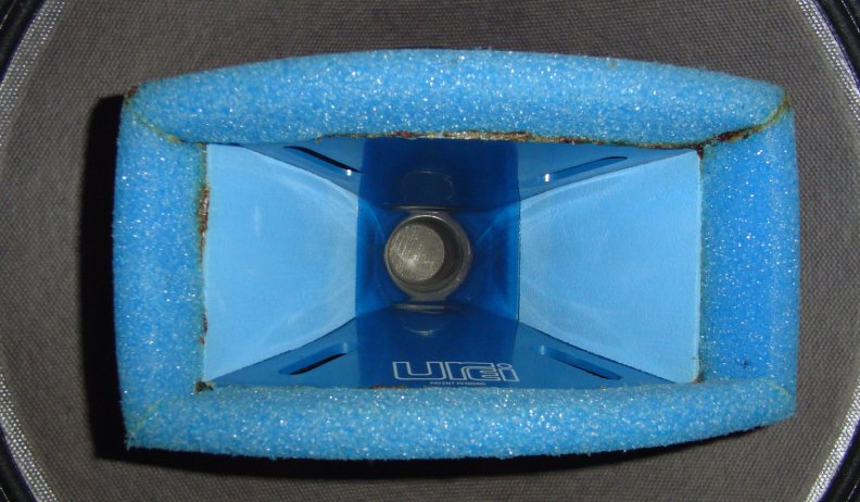

I have used soft termination at the horn mouth that had easily measurable improvements - audible too, but not "night and day." Always keeping Mr Iwata's slotted horns in mind I've tried going from a dense to a loose soft edge.Thanks. I wonder if that concept could be adapted for MF horns. Maybe not slots, but some other geometry like holes.
But I didn't pursue that enough to know if it really helped.
Urie Horn Slots Foam edge and denser foam panels inside.
Rob
According to the Urei-813B Specsheet:
"The Series 8 monitors have the patented high frequency horn, with its diffraction buffer for correct acoustic impedance matching and smooth out-of-bandresponse, and the shadow slots which eliminate the midrange shadowing common to conventional coaxial loudspeaker horns."
At Audioasylum someone stated the slots in the Urei horns function as a kind of physical notch-filter. A notch-filter aka high Q band-stop filter, which makes sense.

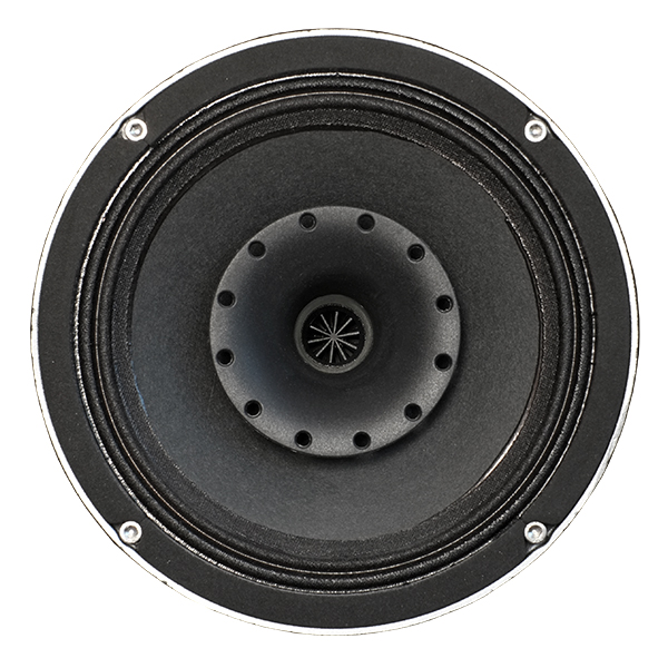

Earlier in this thread, the 8" Sica Coaxial (8 C 2 CP) was mentioned. The horn of this unit is perforated to improve coupling with the woofer.

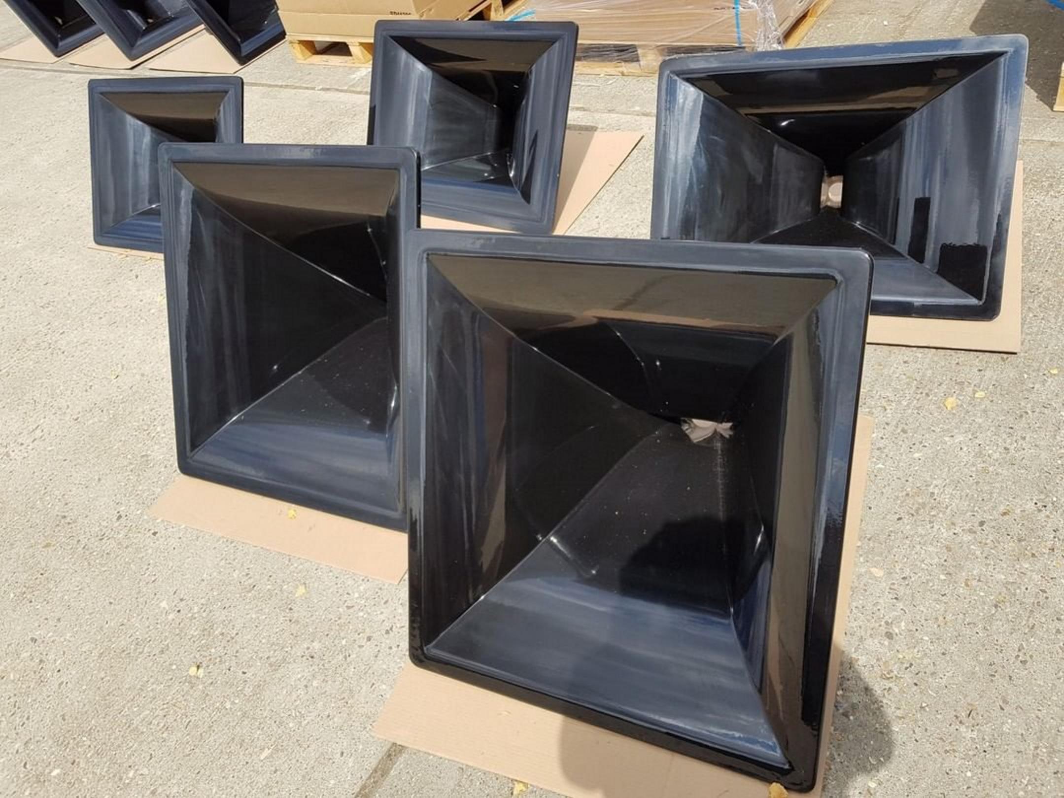

The Axi horns taken outside.
The pinched, but otherwise fairly smooth slots are clearly visible.

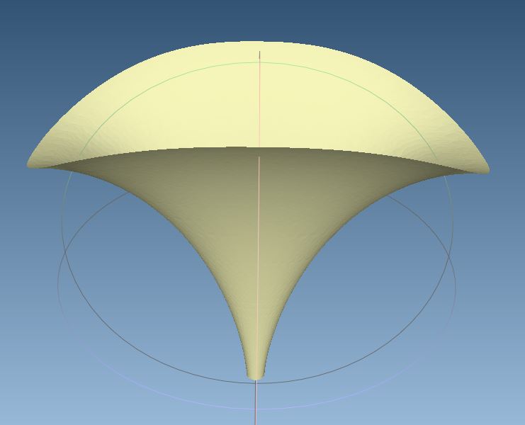

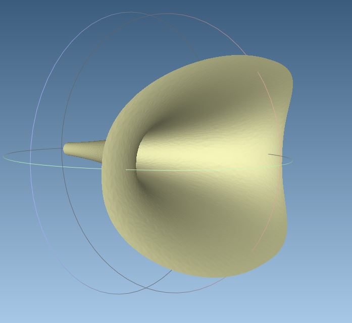

Here is another try to hit camplos requirements. It is complete different approach with an algorith inspired by JMLC and using diffenrent progressive expansion T functions for horizontal and vertical:
View attachment drba_jmlc_hvdiff.zip
