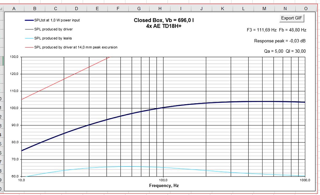

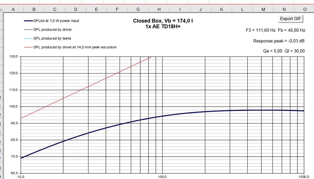

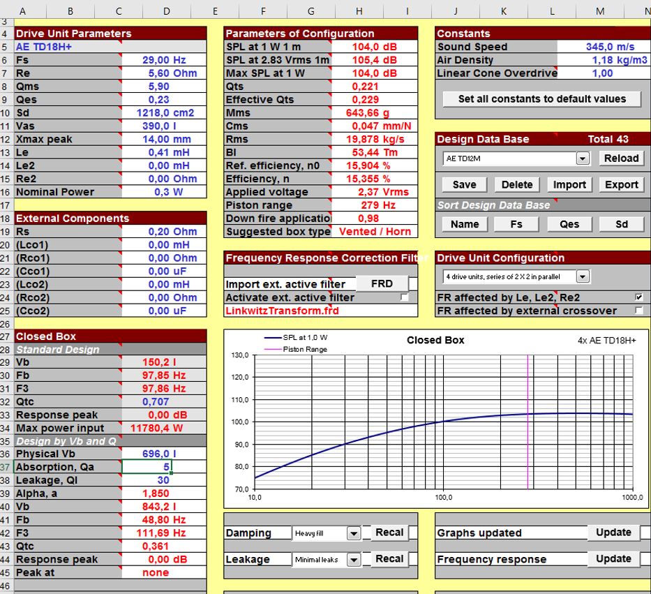

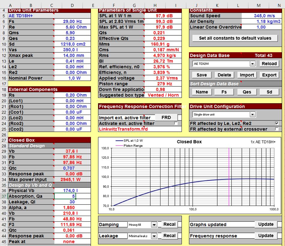

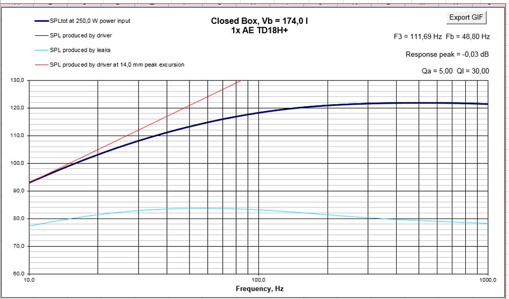

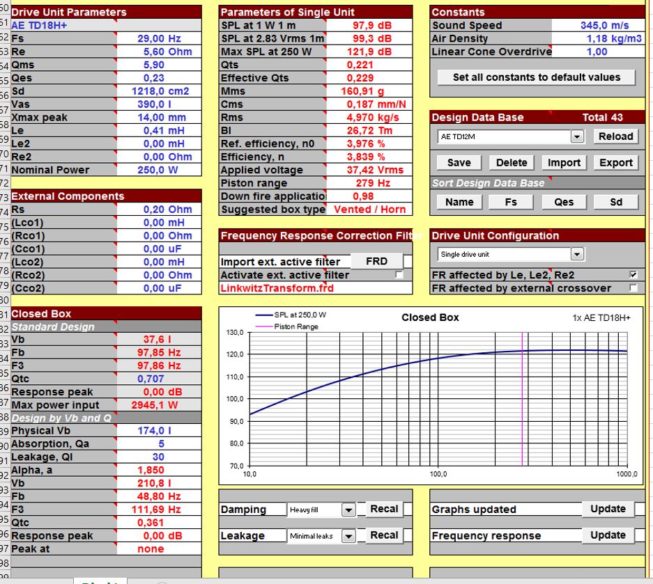

@Camplo and AE TD18 H+: Some background: My room is a concrete bunker, walls, floor and ceiling 22-50 cm concrete ( 8,7”-19,7”) with roughly half of it below ground level. Good thing: Good sound isolation. Bad thing: It will contain a lot af bass = looong decay time and terrible room modes to tame. Size is 7,86 x 4,19 x2,20 m between concrete surfaces. (25,8’ x 13,7’ x 7,2’) with a lowest room mode at around 21,9 Hz theoretically.
If the TD18 H+ will be OK for you and reach down ”low enough at high SPL” may depend on you room. I planned (well at least I tried) taking my particuar circumstances in consideration. With a Qtc at ”usual” 0,707 in a concrete room my worries were about boomy bass, impossible to fix with reasonable amounts of absorbtion. So I went for a very low simulated Qtc (0,36) and sealed speakers in large boxes 174 L/element, 6,1 ft³. As sealed they should start to fall at around 12 dB/octave wth F3 at around 112 Hz and box resonsnce at around 48 Hz. My thougths were that placement and room gain should make up for quite a bit of that and below the lowest room mode around 20 Hz, rooms enters its pressure mode so SPL should increase again down into the infras. The 4 subs are placed at ¼ distance versus both width and height to even out width and height modes, leaving ”only” length modes as problematic to deal with.
If your room is totally different. -like a large living room with open planning, ”flimsy stud walls” with single sheets of drywall on each side, lots of windows and doors etc, it is a different ball game. It may not matter much if you use potent sub element(s) with very low tuning, the bass may just escape right out from the room and you are left with the direct sound ”only” with no / little help from room gain. Next post; some room measurements from today.
