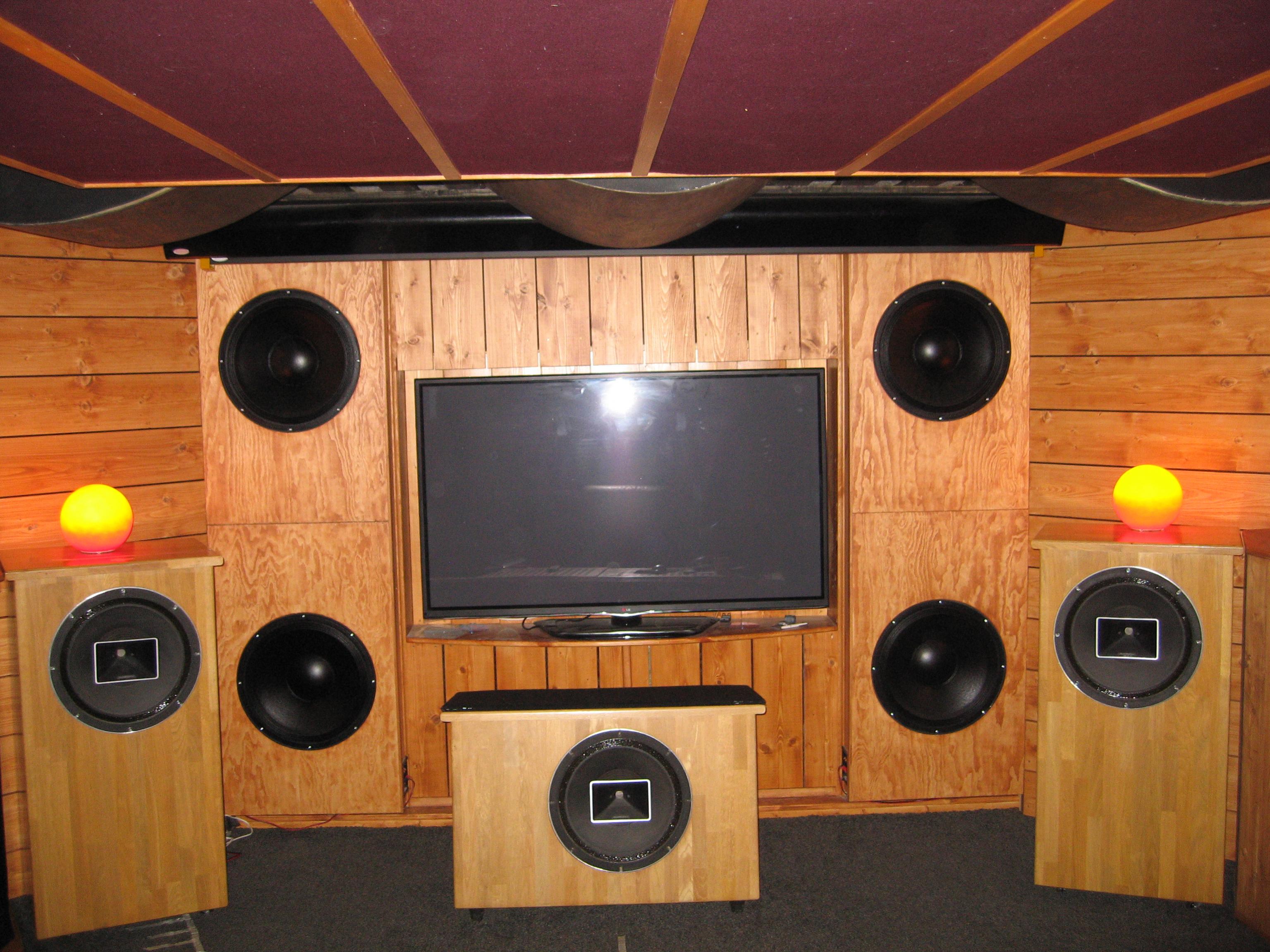

A picture of the front of the room as it used to be with Altec 604-8K as LCR main speakers and AE's 4xPB18+ as subs (Same as TD18 H+ but with dust cap instead of phase plug.) The Altecs are now replaced with AE's TD12M + Beyma TPL 150 H. The superchunks have been rebuilt into "doghouses for the new smaller boxes giving a kind of flush mount with 86 cm baffle width.

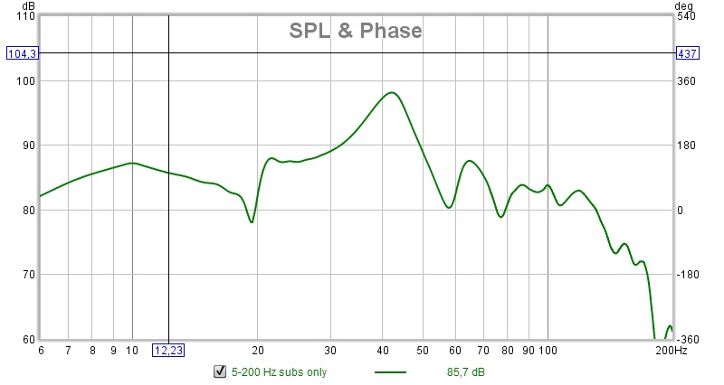

Boxes are fixed to the concrete front wall, cannot be moved. The 4 8 ohm sub drivers are connected in parallell and then in series giving 8 ohm for 1 channel to the amp. Crossover in AV pre amp was set at 80 Hz.

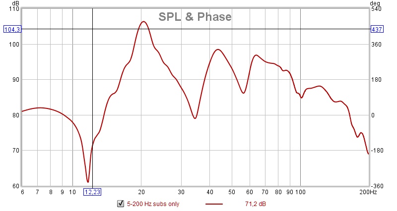

Measurement 1: REW sweep from 5-200 Hz, the voltage out from the power amp during the sweep varies a bit but goes up to a max of 1,70 V, so less than 1 W total in output. Mic position 1 m from concrete wall centred at room width and height. 1,3 m diagonally to each sub driver.

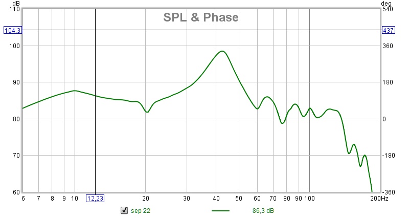

Measurement 2: At LP 372 cm from front wall at height 90 cm, about 358 cm diagonal to sub drivers. An expected 40 Hz peak from 2nd length mode.

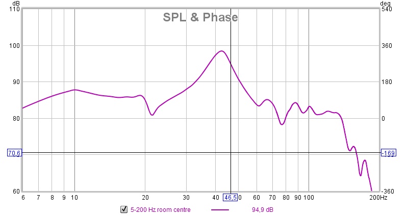

Measurement 3: At physical room centre 393 cm from front wall at 90 cm height, 377 to 381 cm diagonal to sub drivers. Theoretically this spot should show the lowest SPL for the lowest room mode at around 21,9 Hz versus the room length of 7,86 m. More or less only the direct sound from the subs, no gain or dip for about 21,8 Hz. 2 nd length mode a prominent peak as expected.
Measurement 4: Slightly in front of physical mid length = 383 cm, +10 / 4". Measurement for 20 Hz improves a bit. Why = ? . Could be because of resisitive and limp mass absorbers functiuons a bit even that low or room leakages.

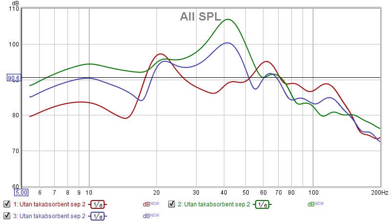

Picture 5: 3 measurements with front subs in phase with subs at backwall. (Subs at backwall = 4 x of AE's SPB 15), and out of phase and only front subs. When I later connect an active filter, the backwall subs will be connected out of phase and with a delay versus the front subs. Room modes up to 120 Hz should the be evened out. Theoretically ...
All in all, AE's PB 18+ or TD 18 H+ has no problems to play very low frequncies at high SPL in "the right room". It seems I made the right choice with a concrete room to go for a low Qtc of 0,36 and high F3 at around 112 Hz for the subs as room gain gives a huge peak 1 m away from a wall. Close to room centre SPL around 20 Hz is substantial even if if is supposed to be in a frequency dip. The SPL picks up again under about 20 Hz down to 10 Hz. I suspect the pre amp and power amp starts to fall off below 10 Hz otherwise the SPL should be maintained even lower in frequency. As mains the 18" can be played above 200 Hz, it plays quite well up to about 1200 Hz, then it falls off sharply.

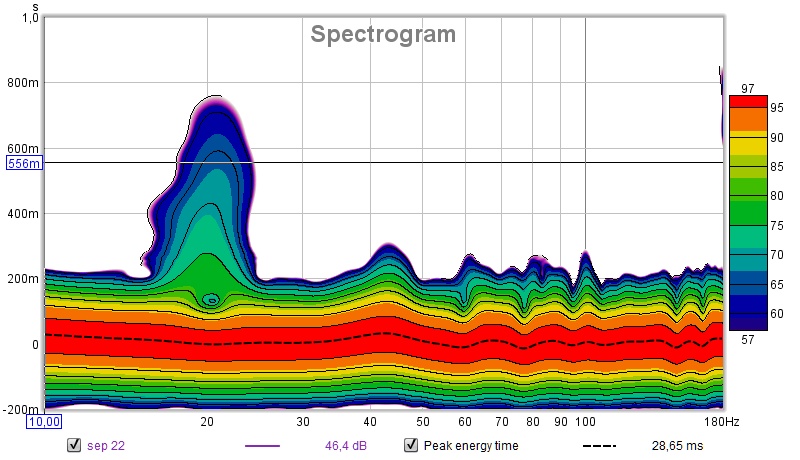

And a spectrogram from measurement 4. I see a decay with fairly even and low figures in ms for typical room modes as more important than a straight line frequency response curve. The first 5 length modes are clearly visible, it looks looong though for 20 Hz.

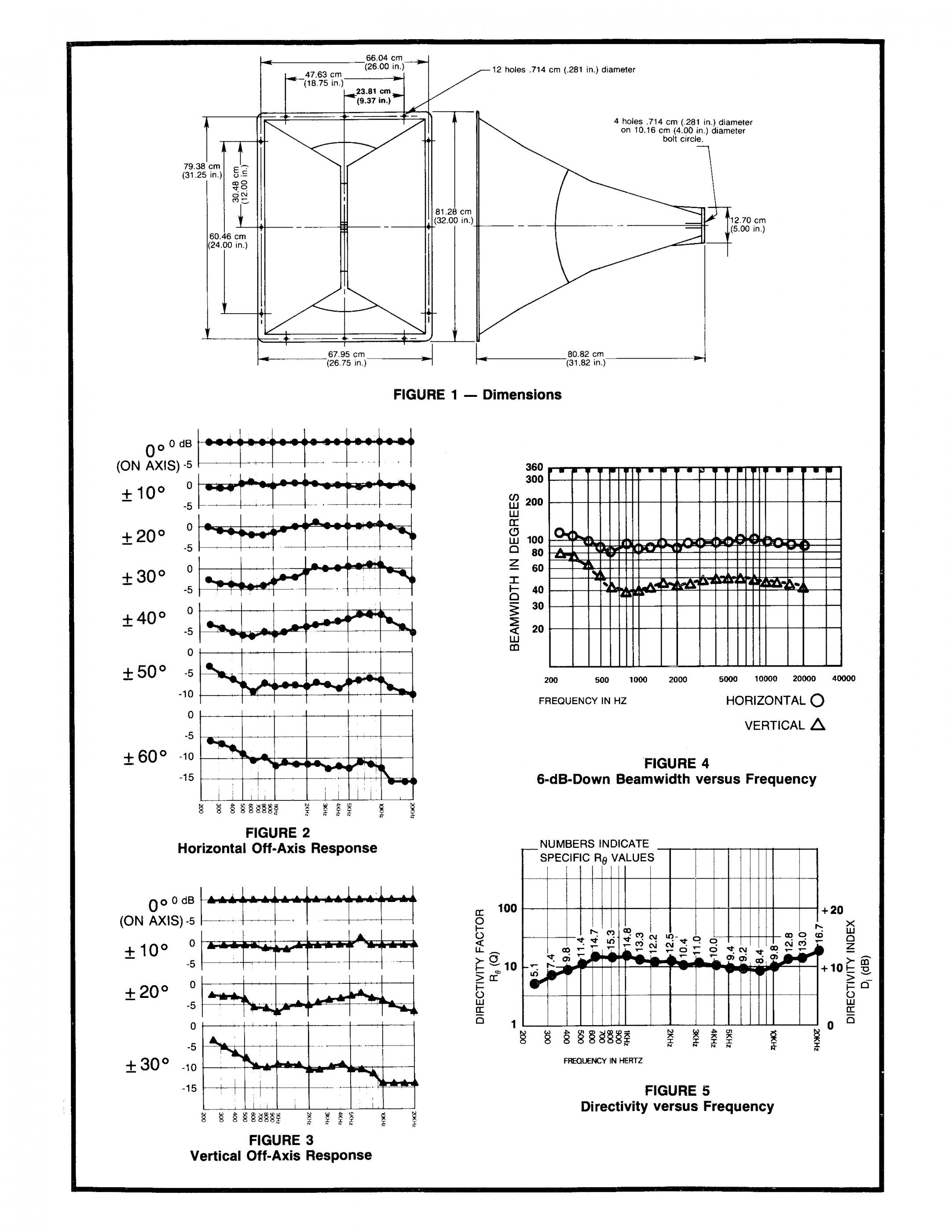

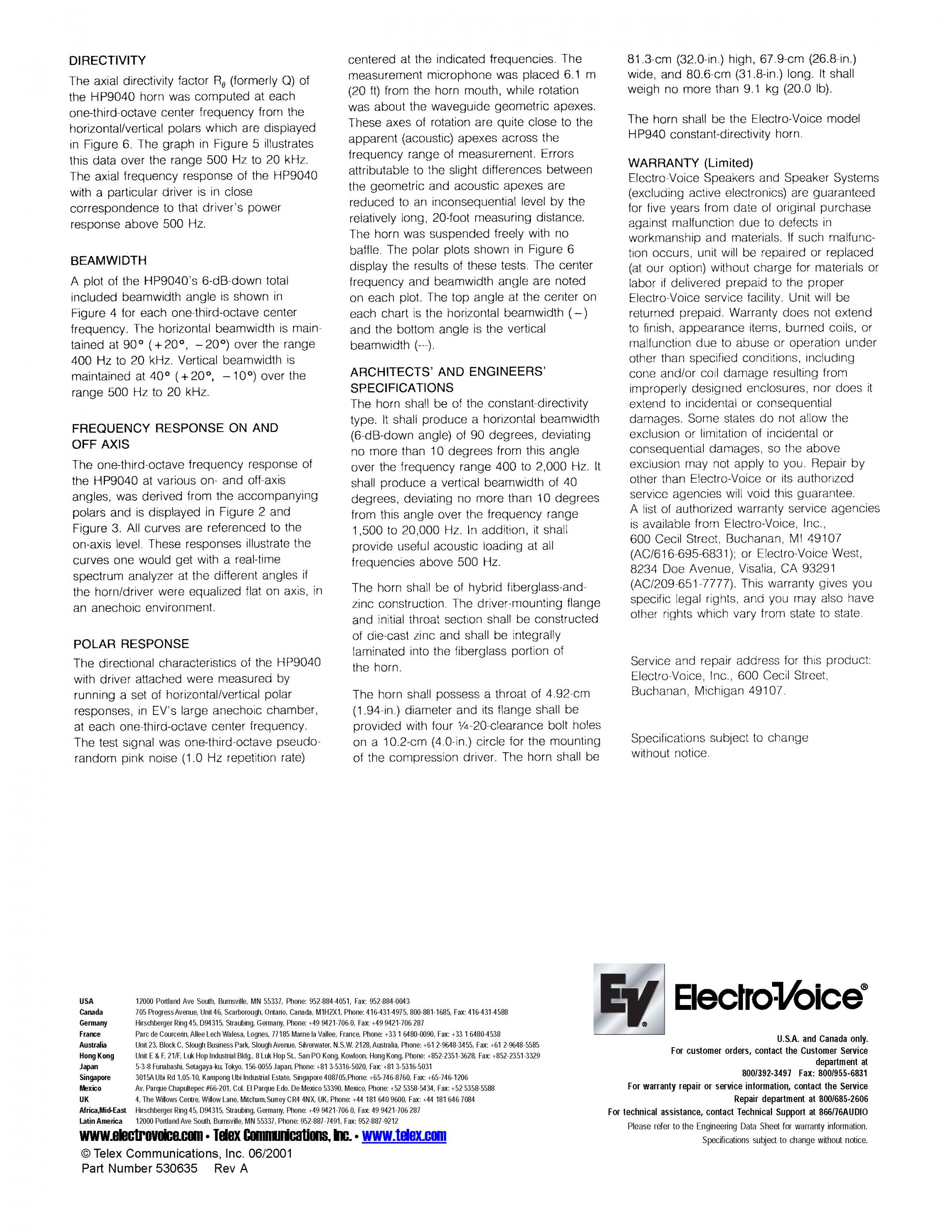

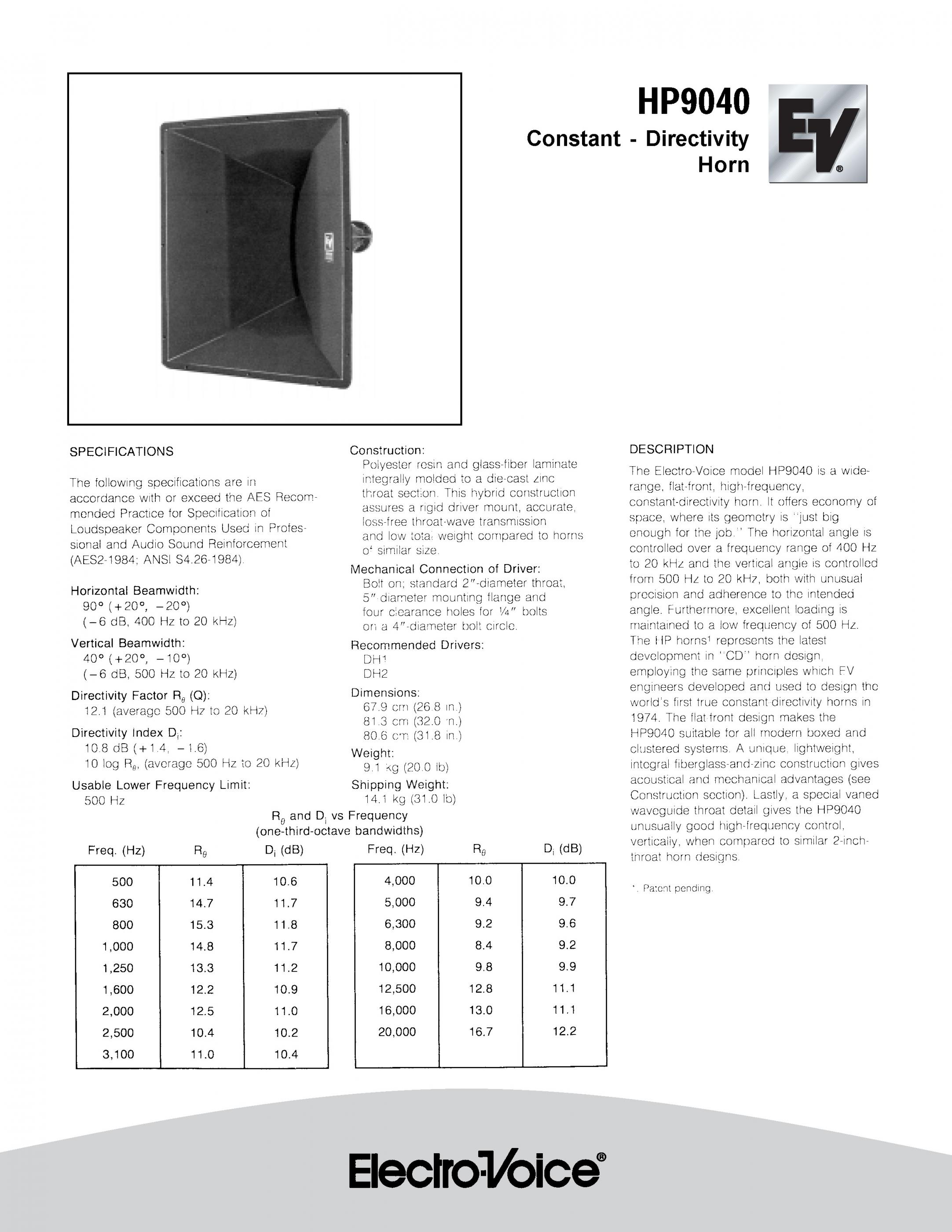

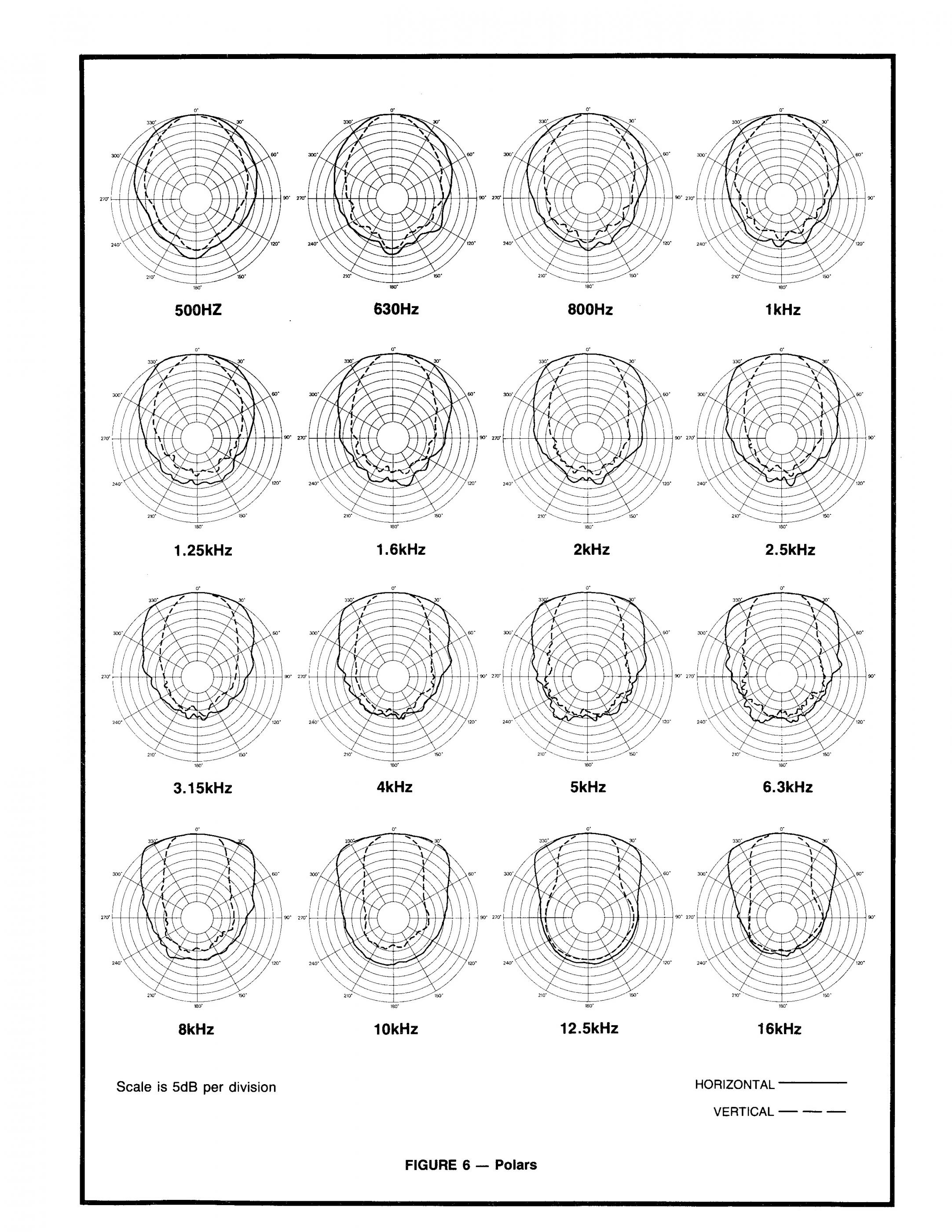

Some Romanian guys use the Axi2050 with these EV HP9040 horns:
If you want to cross <500Hz and play at high SPL, the Axi2050 would definitely beat the 951BePB.
I am sure at 300Hz and >115dB, the Beryllium diaphragm won't last long.
Björn Kolbrek stated, he wouldn't hesitate to use the Axi2050 at, or even below 200Hz behind a proper horn at home.
The Axi2050 is (only) about $500 each, if you could order these through an OEM.

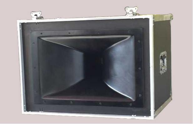

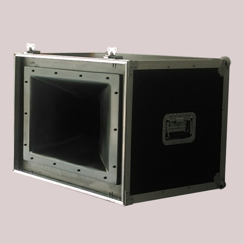

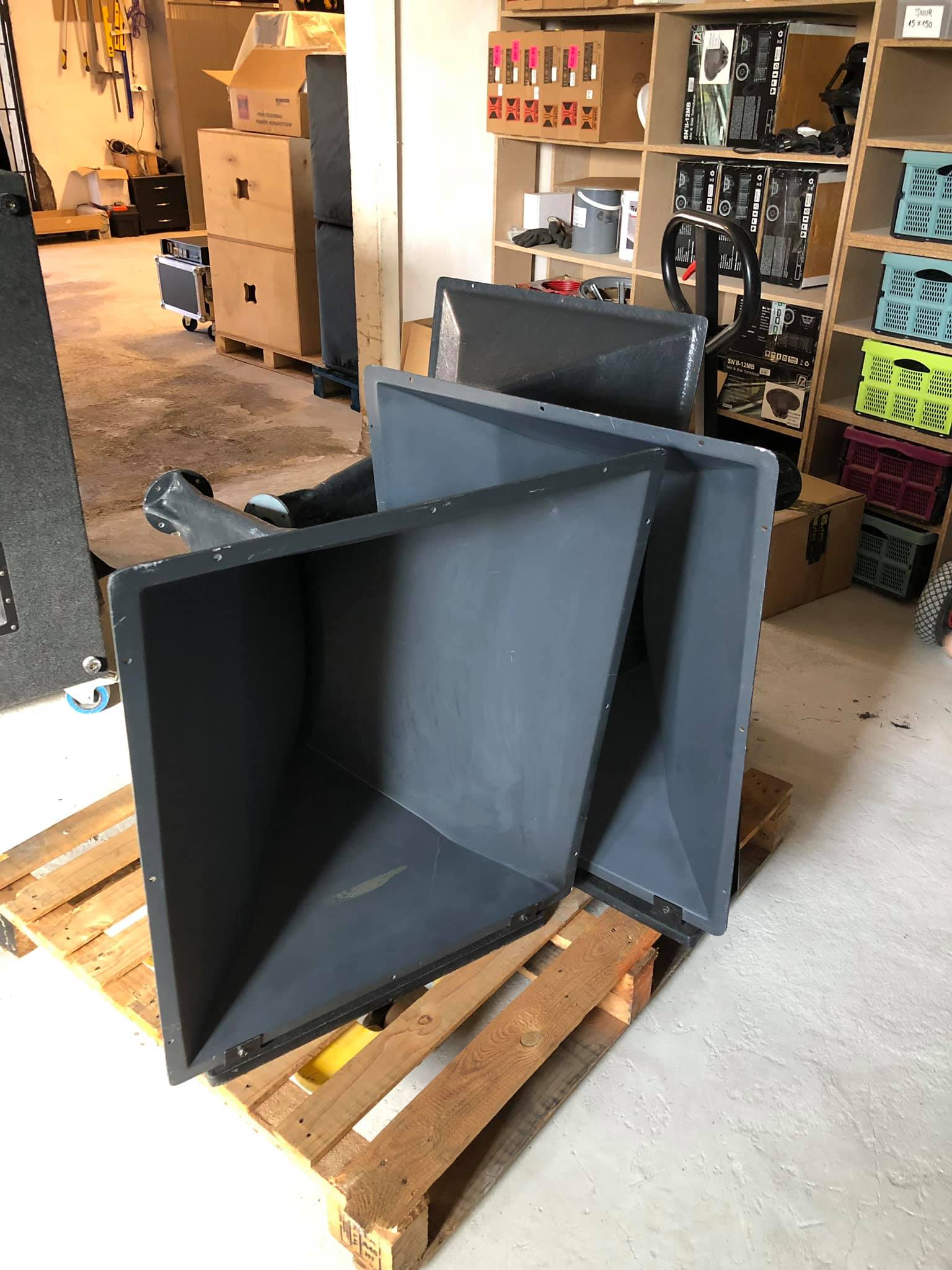

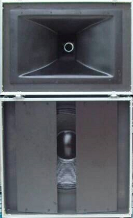

It looks crappy, but the concept makes sense; Chinese (supposed to be) 300Hz horn (about 60cm width x 40cm height) + 18".
Utilizing the Axi2050 and TD18H+, such a configuration would meet all criteria of this thread.

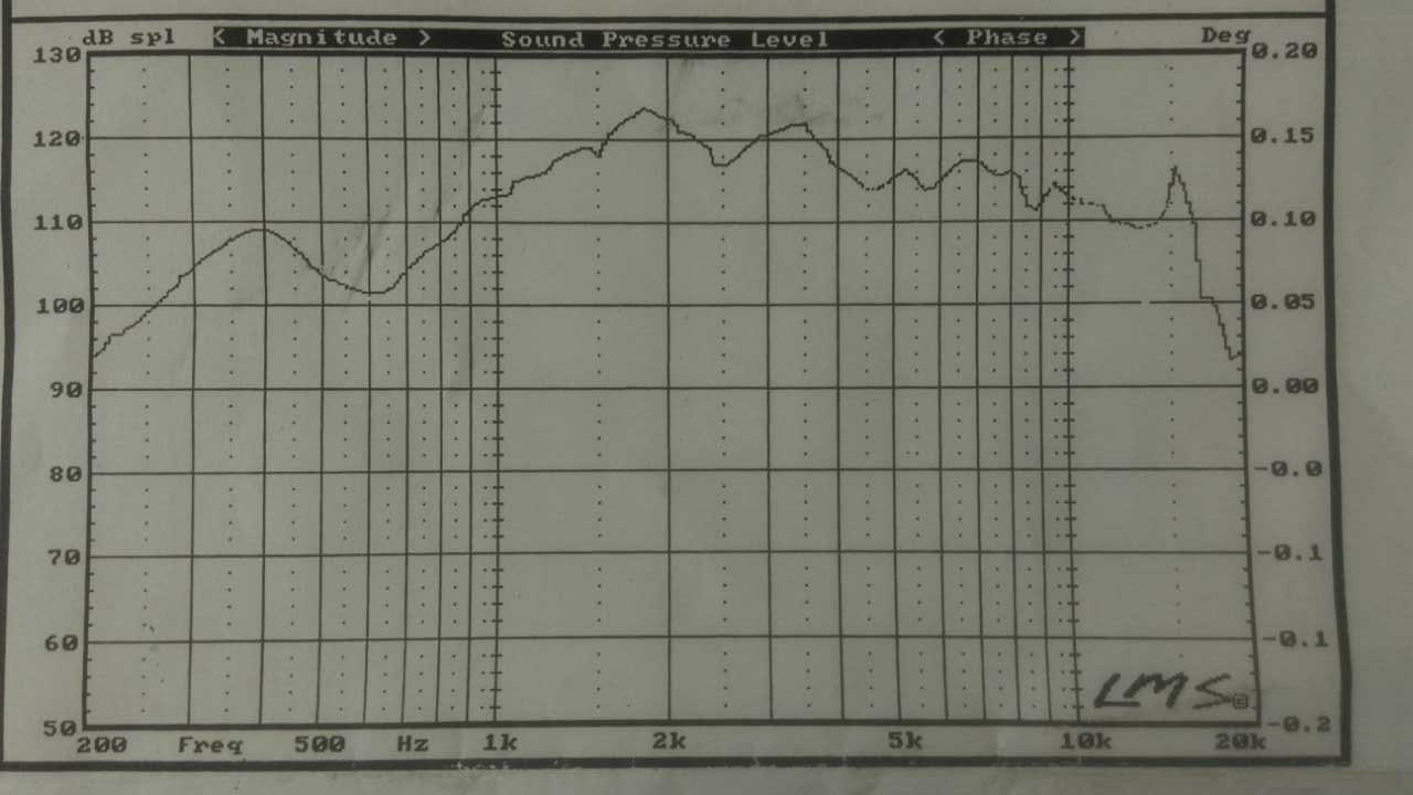

FWIW, some additional images of the separate horntop and even a response plot (driver unknown).
I guess the 18" shown is a B&C - isn't it ?
regards
Charles
The cone resembles the cones of some B&C drivers, but it's probably a clone.

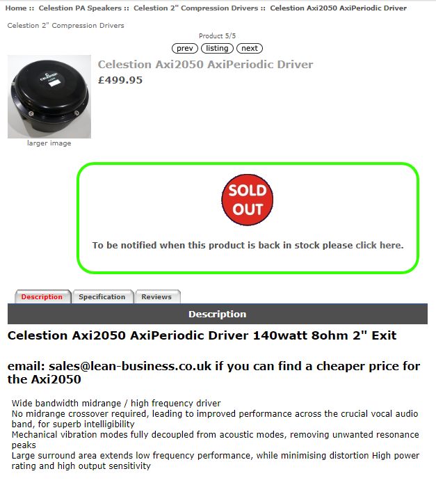

500 each?! I see some 950GBP per side in the UK!
Any pointers from EU shops?
You won't find the Axi2050 at 500 each anymore, at least not in the shops.
This was the pre-launch price:
