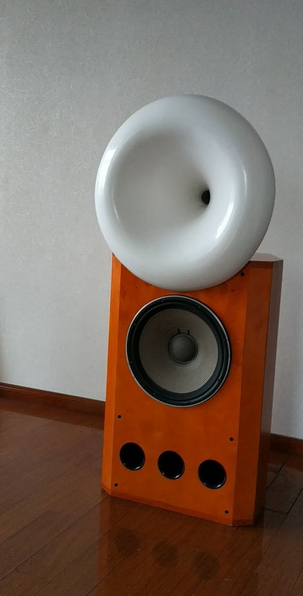

Sony SUP based two-way, electronic crossover @ 560Hz.
Horn is JMLC 250Hz.
