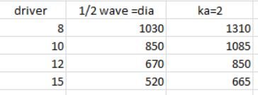

One thing that keeps bugging me when we are looking at matching directivity between cone and horn, is shouldn't we also be considering the pistonic range of the cone?
I've heard two different rules of thumb for when a driver leaves piston mode, and turns to breakup mode.
First is when driver diameter = 1/2 wavelength.
And second is when ka = 2. (ka being circumference/wavelength)
Both of these use dimensions not counting the surround.
Does this matter to folks?
Below is a quick chart showing the frequencies the two rules of thumb give for a few driver sizes. I used typical sd's for the given driver sizes, to get diameters for the calculations.
Except that a real woofer is wider in directivity than a flat piston, I have to say that this "matters" greatly to me. The response of a woofer at its upper range of operation usually differs significantly from theory. That is why I contend that one must not actually measure this response, but also tailor the X-over to what one actually has in practice. Theory works great a great deal of the time, but you have to know when a (simplified) theory works and when it doesn't. For examples and rough calculation the piston model works OK, but for real world precision design, it is well off the mark.
