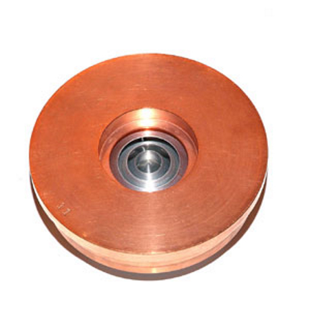

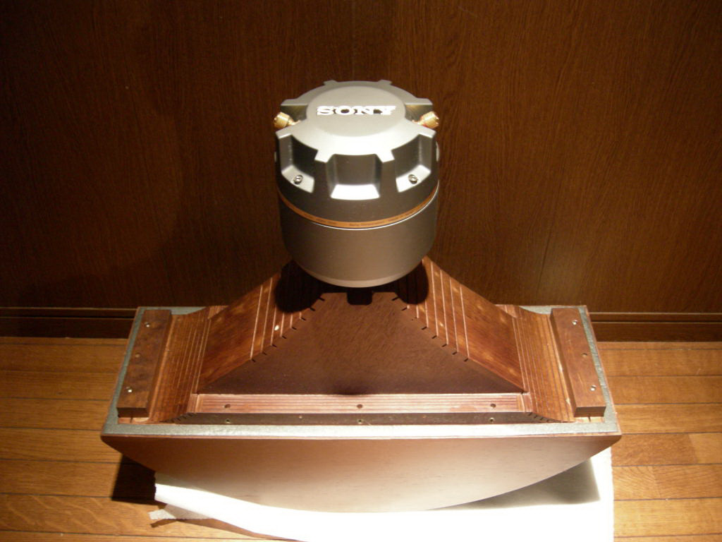

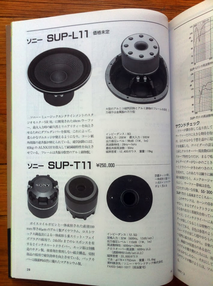

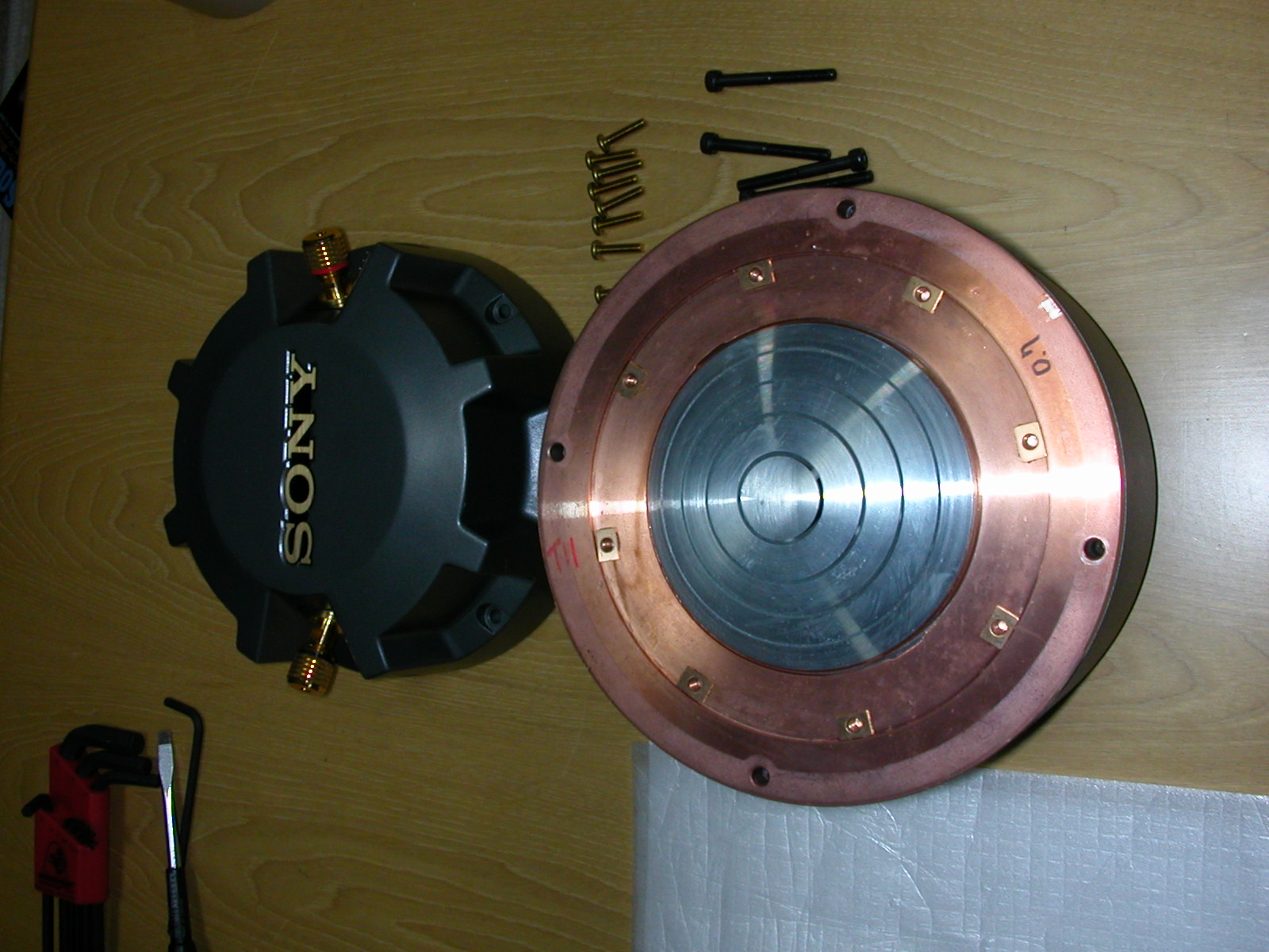

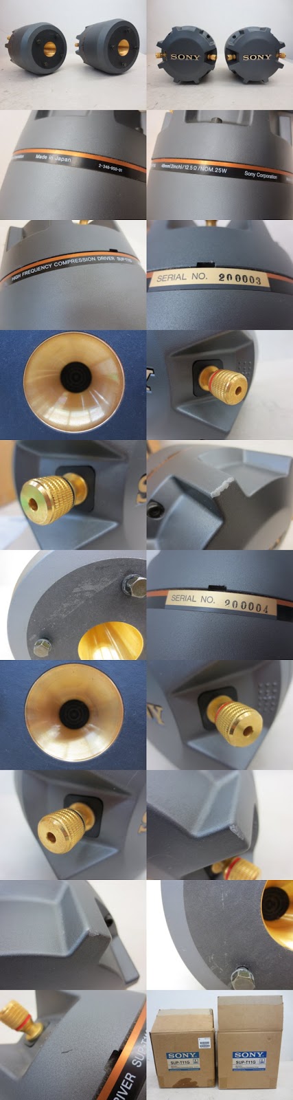

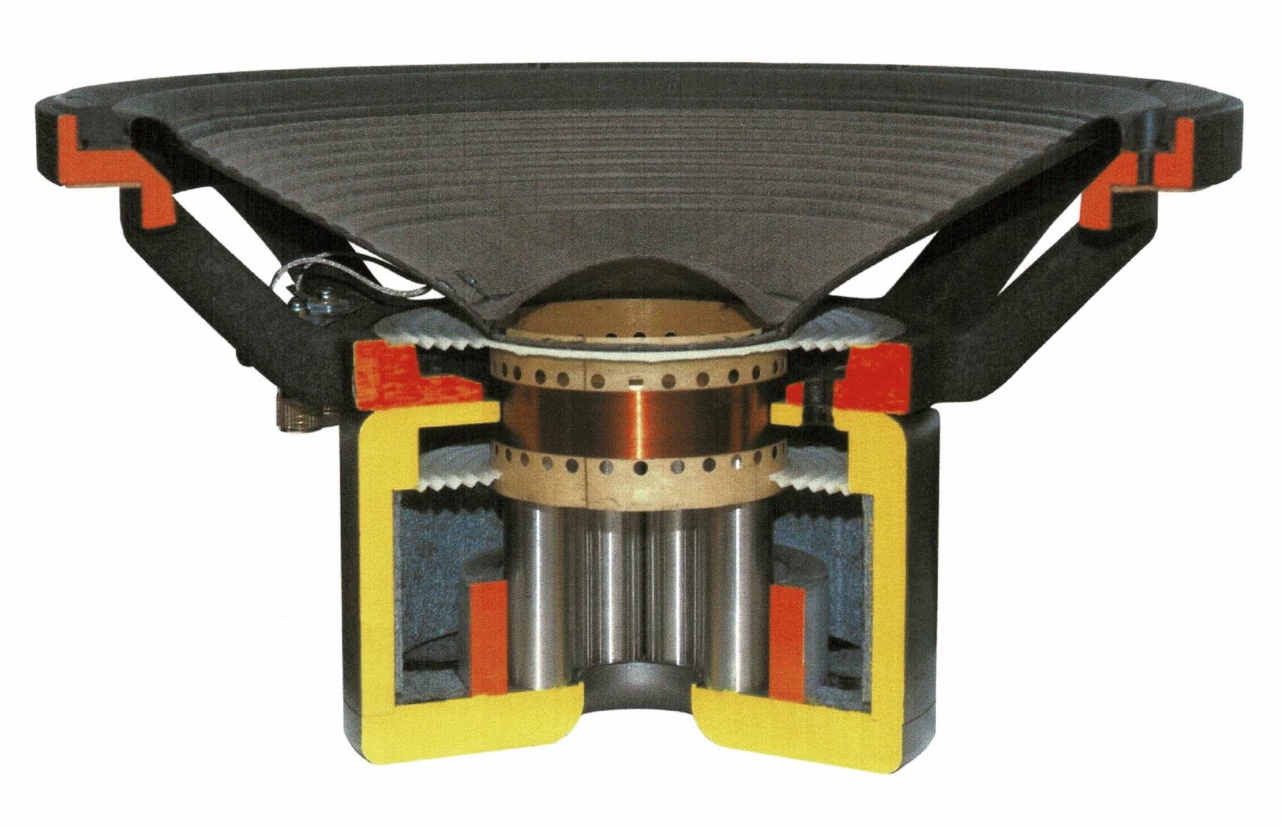

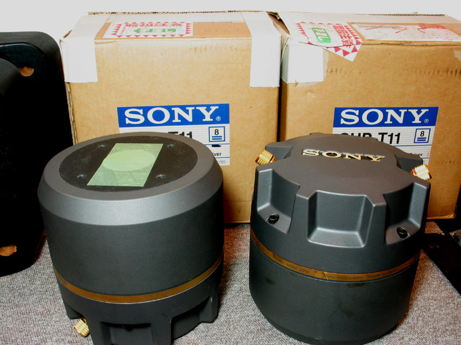

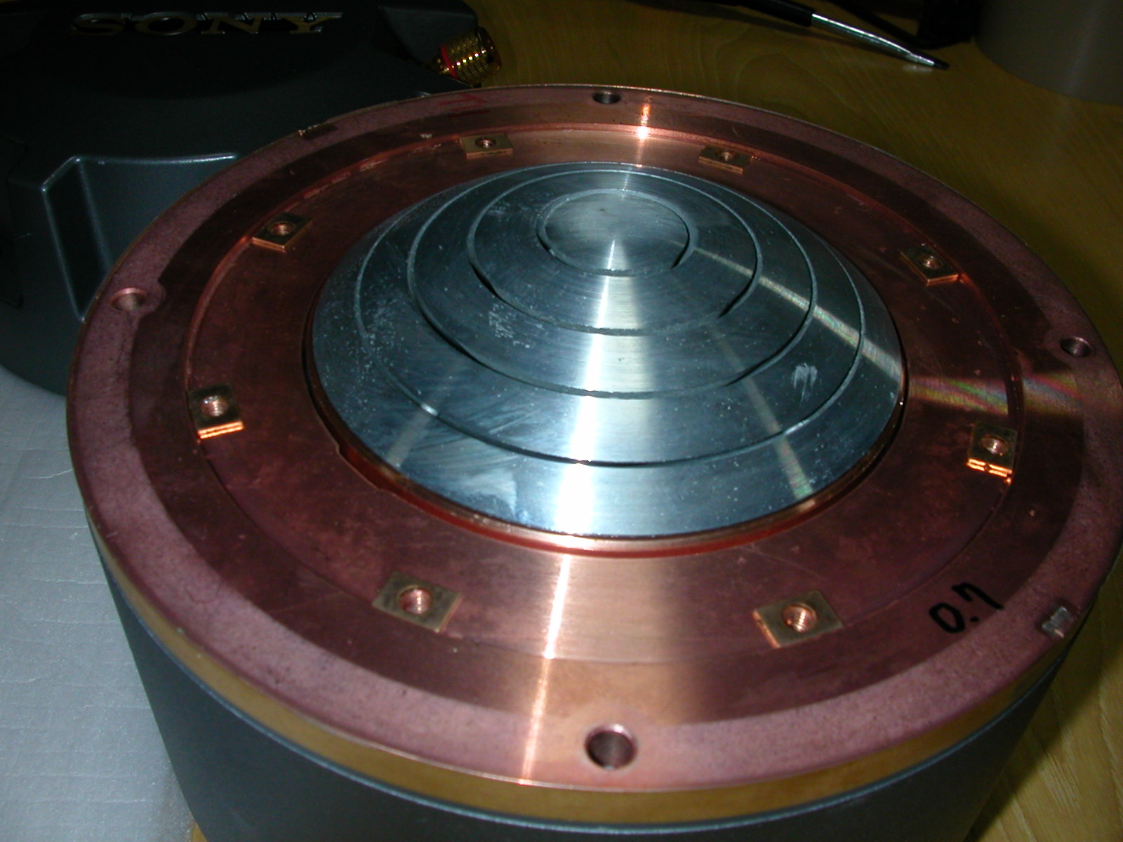

No, that's not what I am saying 😉

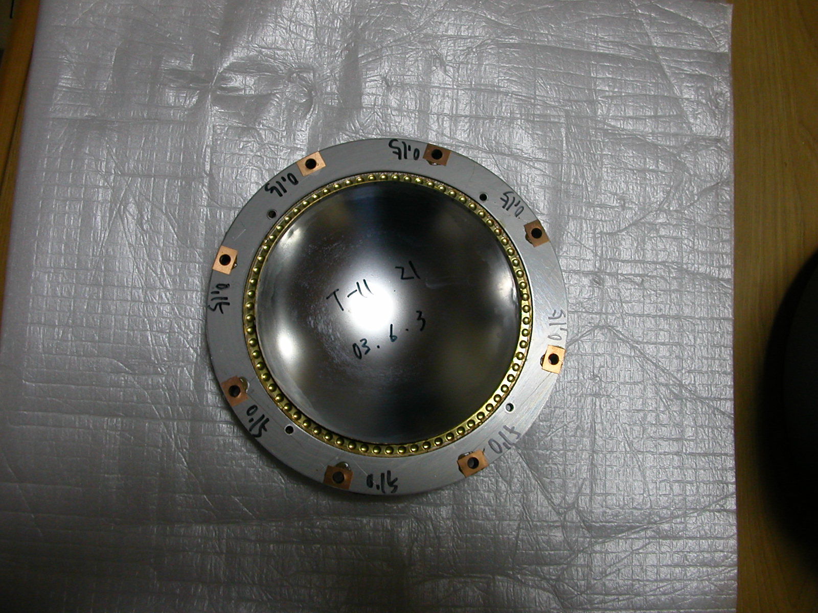

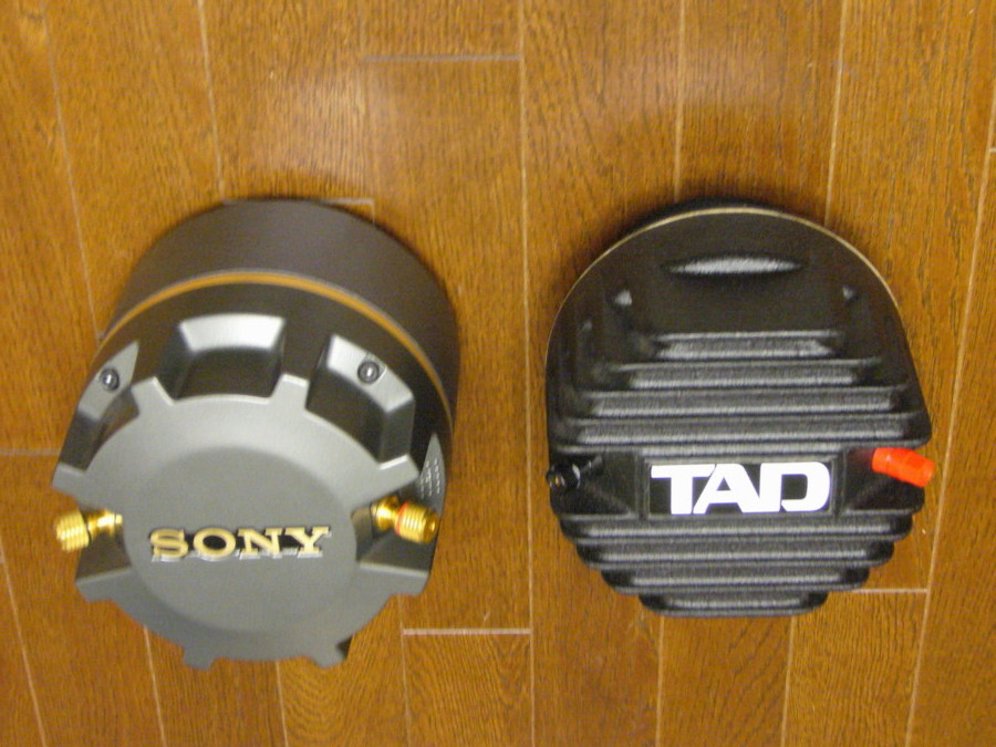

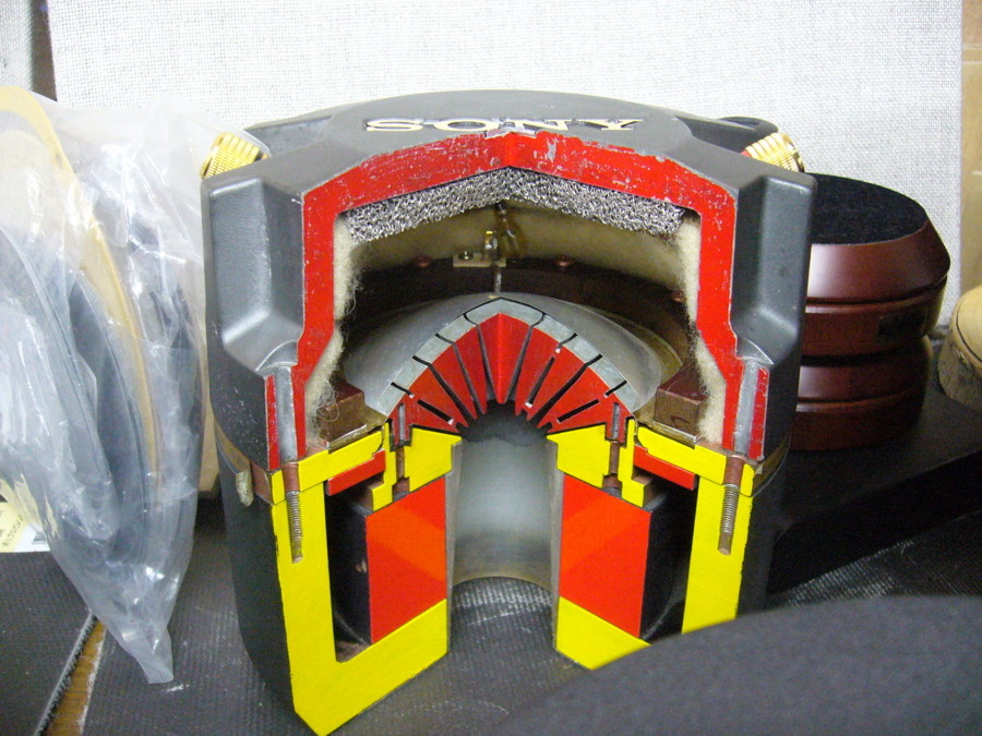

In fact, there's a very small company that made (or still makes) the SUP-T11.
Sony never produced any of their PA drivers and horns in house, instead they bought custom products from third party manufacturers, like McCauley.
The Sony SUP T-11 for comparison:

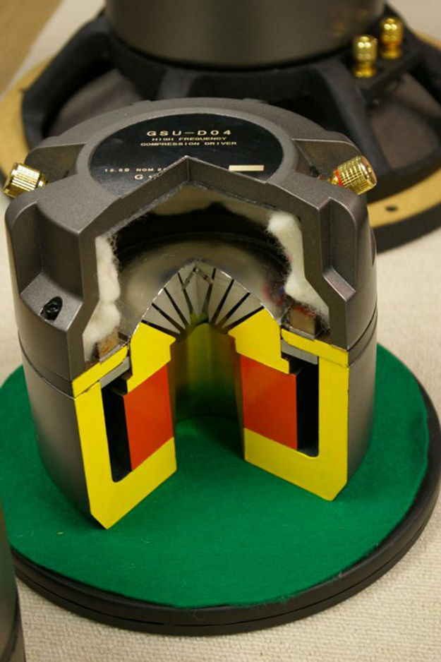

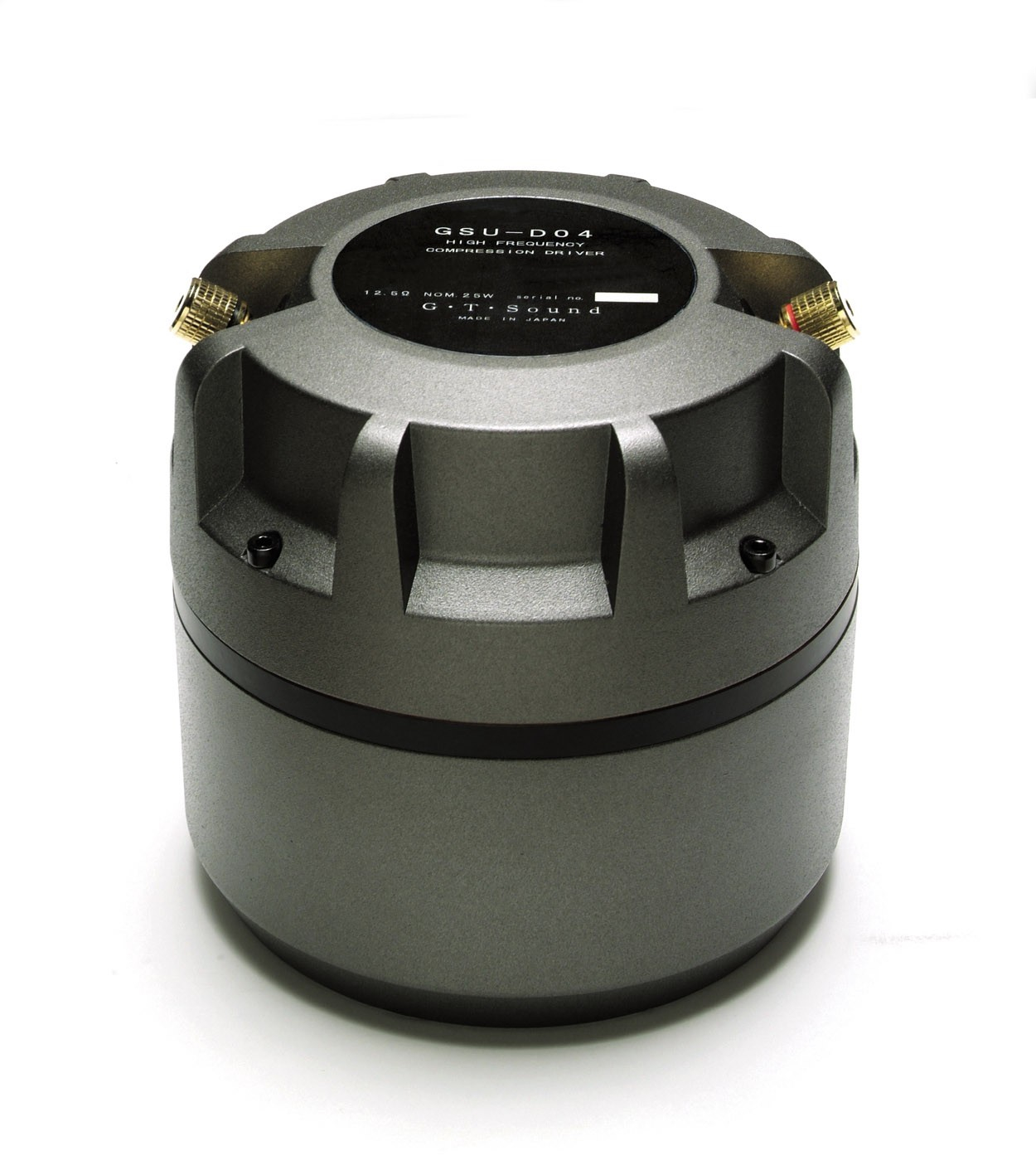

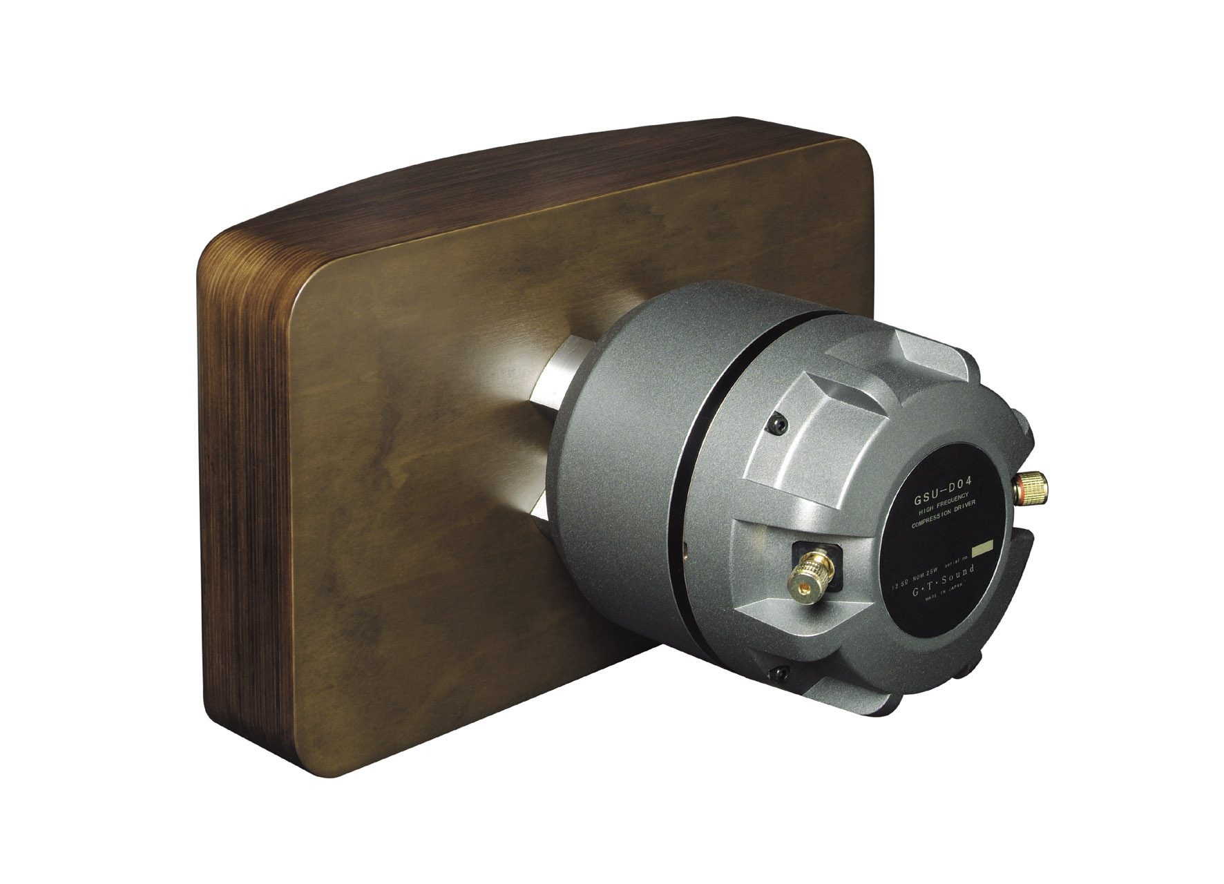

These guys should be able to help you out.

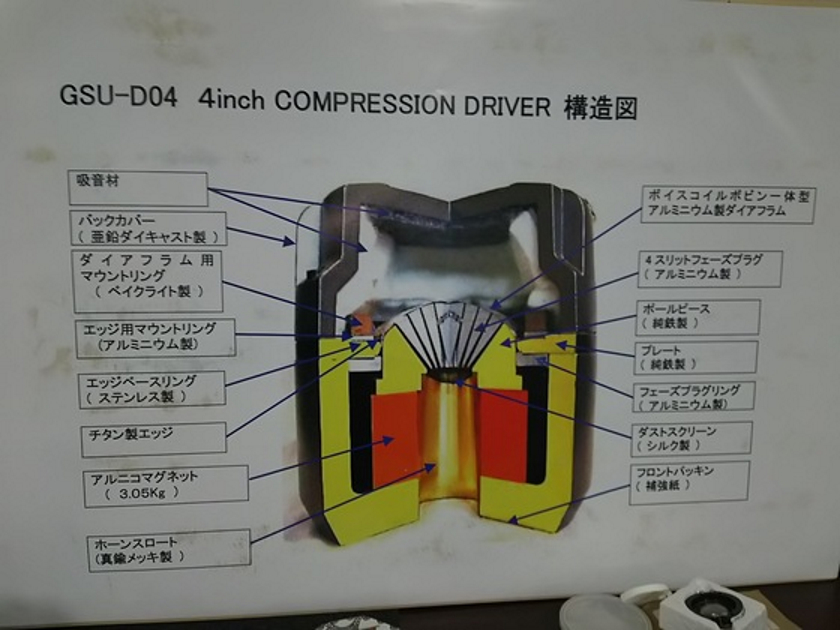

Specs:
DRIVER GSU-D04
It reproduces flatly up to 24kHz by super-light diaphragm. A tweeter and a super tweeter are unnecessary.
Thickness 35μm aluminum diaphragm and the voice coil is electric welded.(no glue) →Light weight vibration system. It is almost flat up to 24kHz. Even a minute signal reproduces plainly.
Adopted pure brass throat with gold plating → The throat has huge effect on sound quality. By making it in pure brass it is able to create a clear sound.
Adopt strong alnico magnet (weight: 3.1Kg) →High magnetic induction of 20,000 gauss.

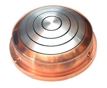

Phase plug is assembled without any glue. All machined out structure →Low distortion and improvement in low frequency and magnetic efficiency.
Adopt edge wise wind up voice coil →superior in conductivity and line mount pure aluminum stute wire for excellent reliability and linear.
Adopt aluminum machined out phase plug →By its multiplex structure it produces solid structure and beautiful finish with low distortion.
Back cover is made from zinc which has high vibration absorption character →Lowers Back Chamber's resonance and natural sound with no coloration.
Precise parts, production quality control, measurement and adjustment →All products are matched→Left and right channels sound uniforms→Low distortion.
Official impedance: 12.5Ω
[Horn throat] diameter: 49.2mm
Voice coil diameter: 101mm
Bandwidth: 500-24,000Hz
Recommended crossover frequency: More than 500Hz
Ratings input: 25W
Output sound pressure level: 110dB/W/m
Magnetic induction: 20,000 Gausses
Externals size (outside diameter × height): 178×175mm
Mass: 18kg

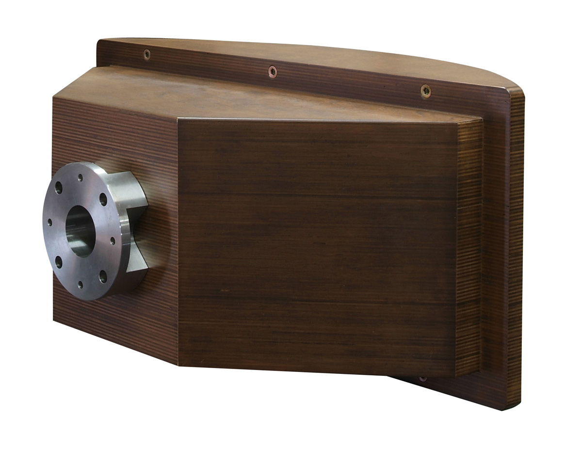

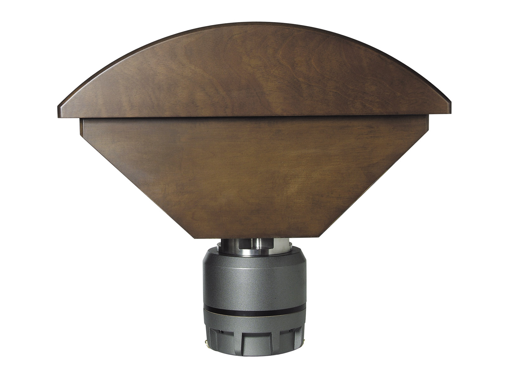

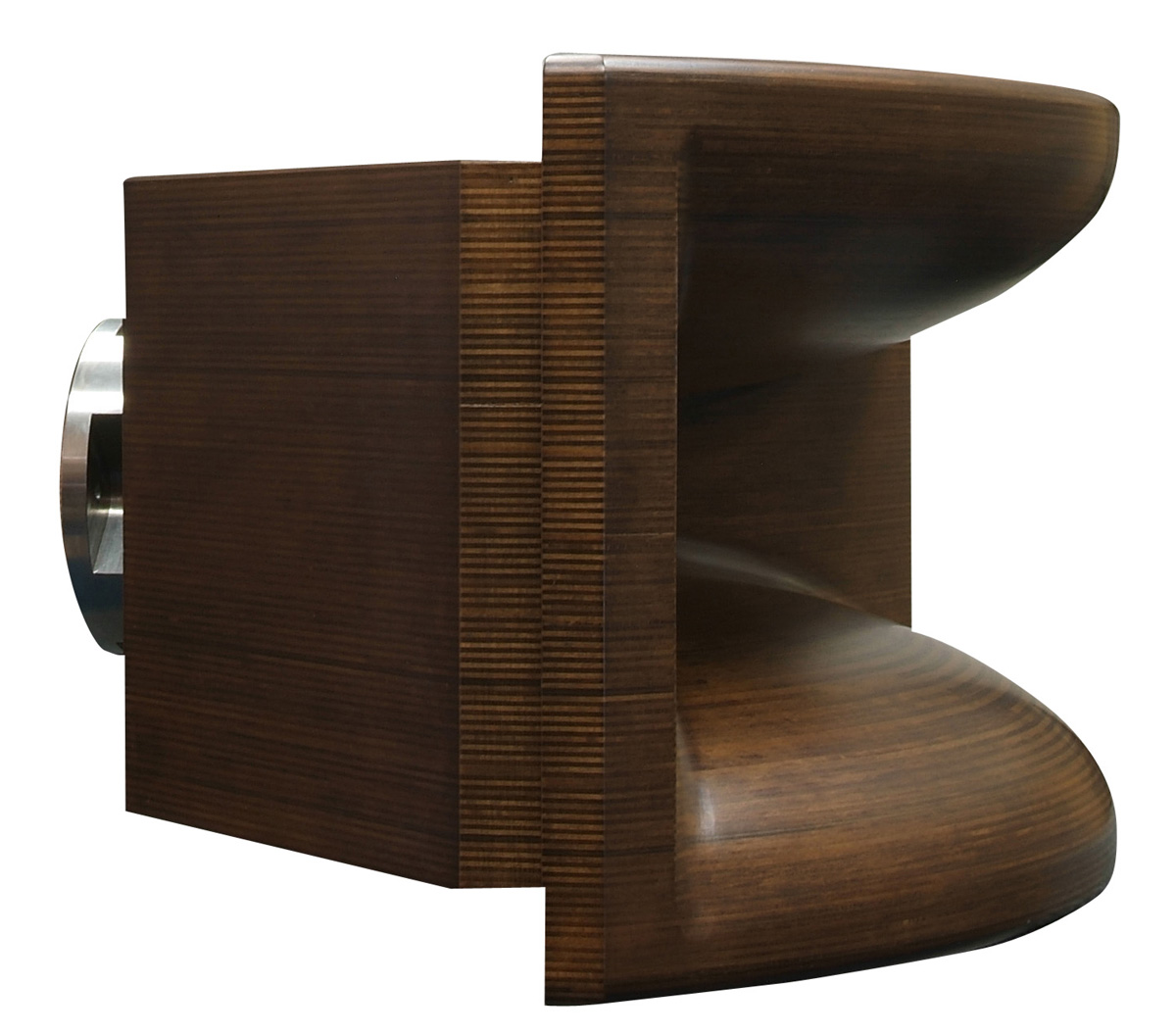

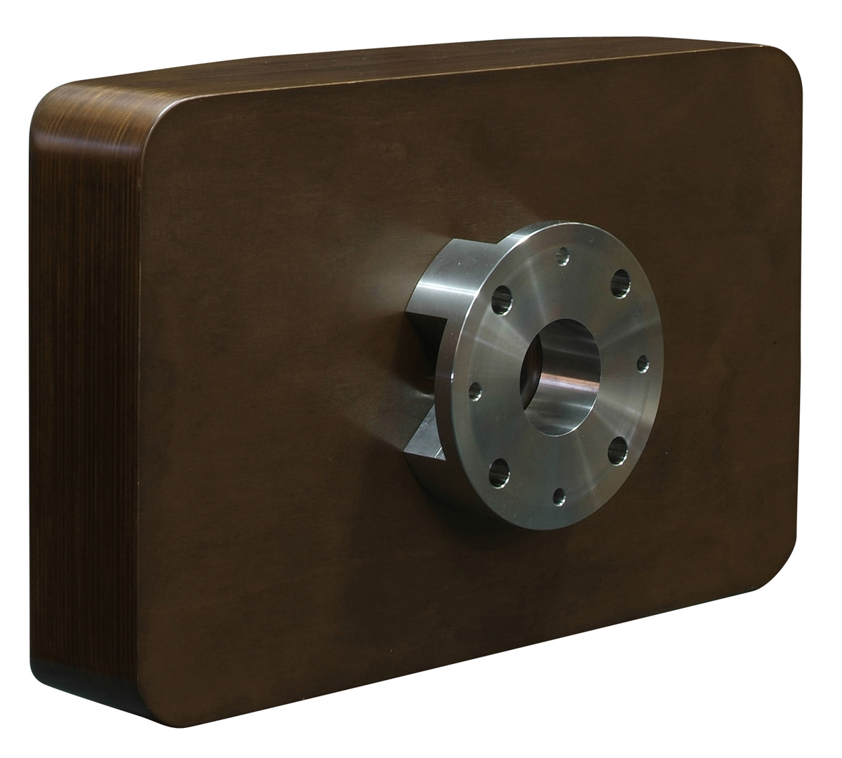

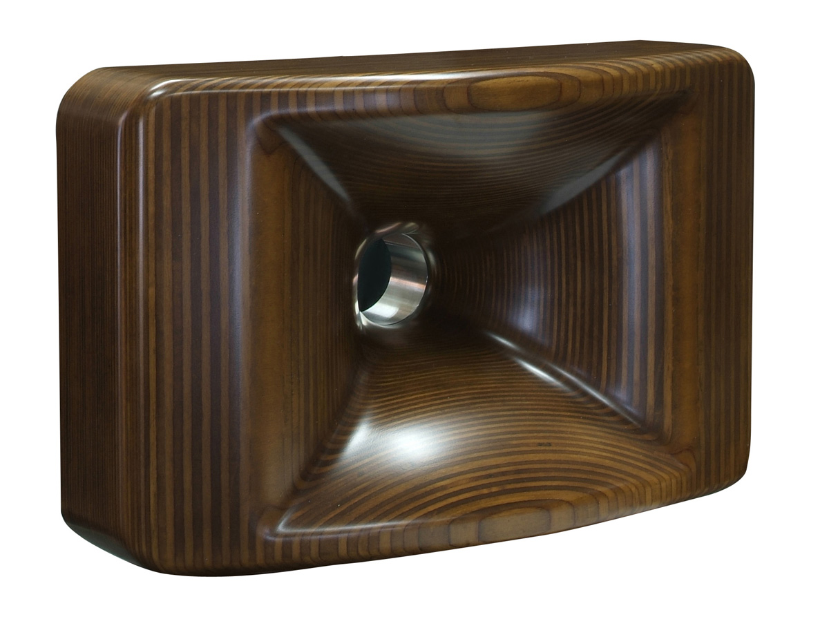

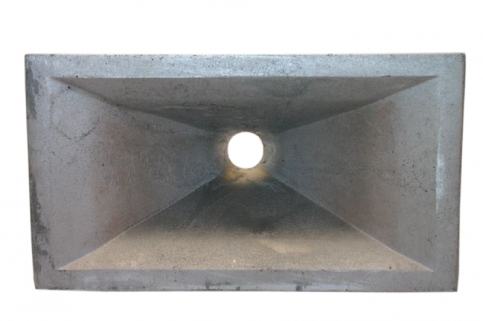

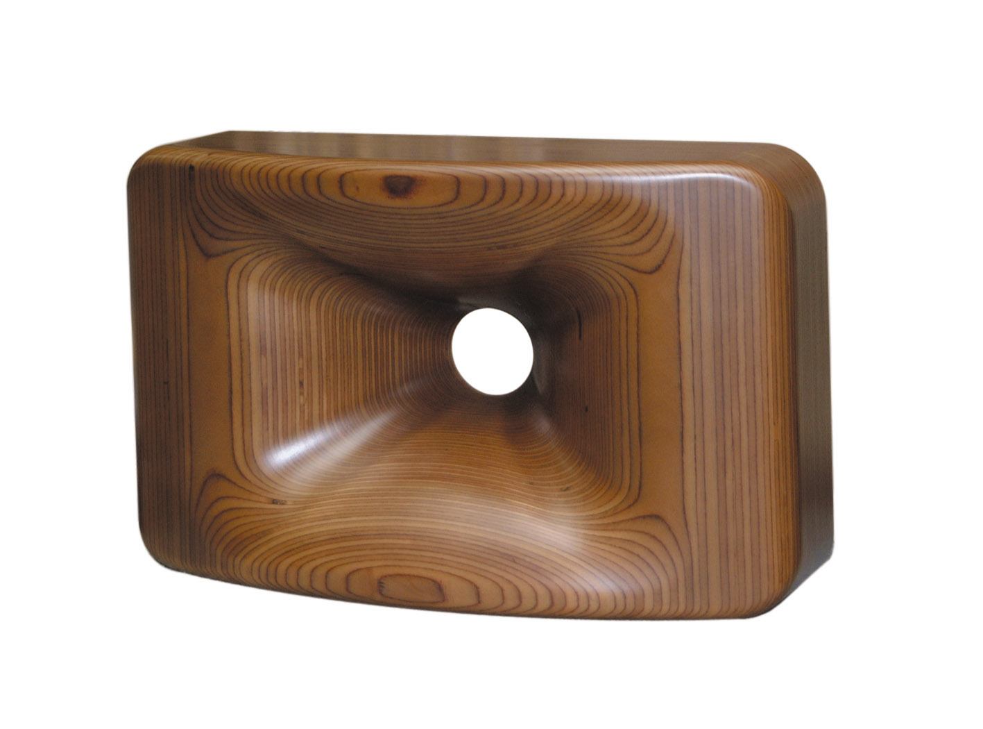

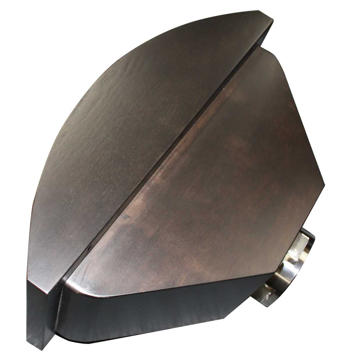

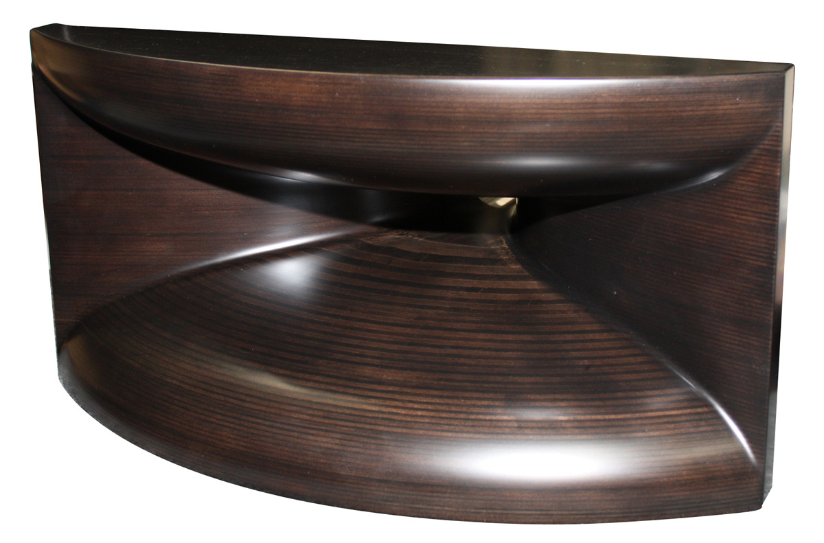

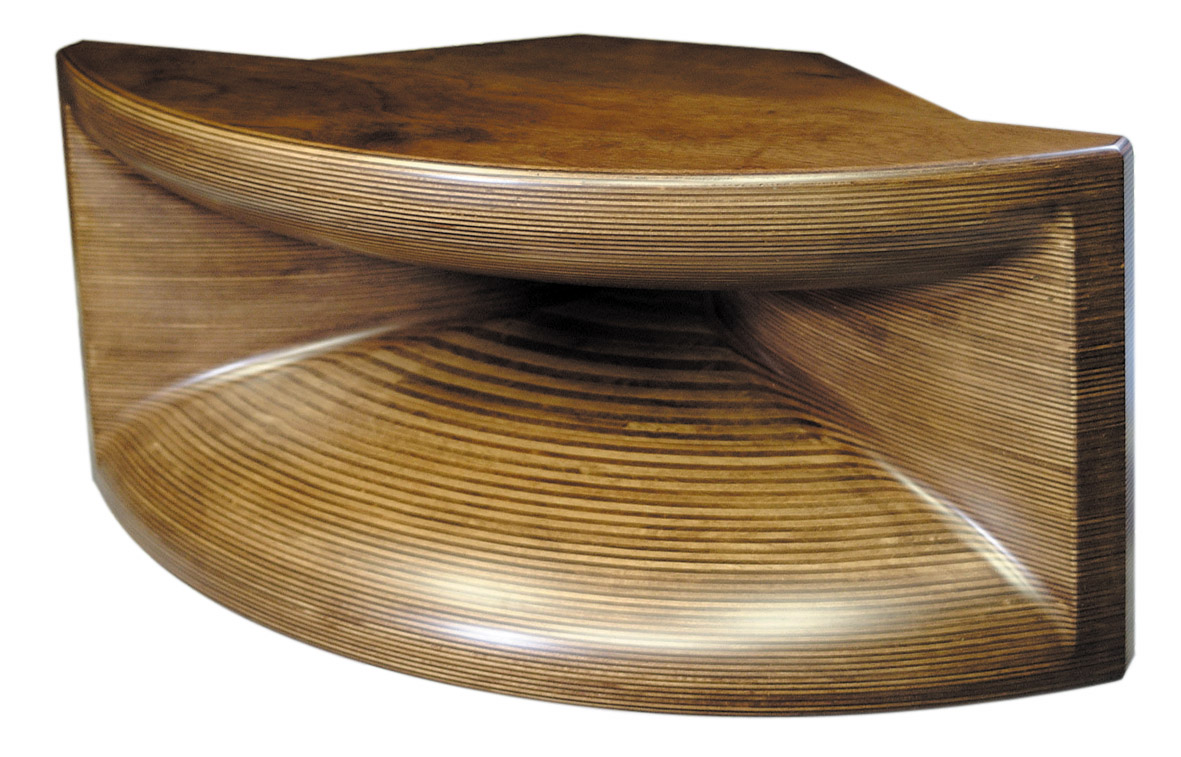

They also make some of the horns that were used in Sony SEM and PA loudspeakers, as well as a few other designs.

The GSU-D04 is undoubtedly a very capable driver, but presumably also very expensive.
20 years ago, its performance was pretty unique. Nowadays, I would definitely consider the Axi2050 first.
A Faital HF201 is also an excellent 2" driver for a whole lot less.
Are those GSU-D04 currently available? Price?
1. yes.
2. ..boutique production from Japan, if you have to ask you probably can't afford it. 😱
GT SOUND?FAQ
GT SOUND DRIVER GSU-D04
In 2006 the GSU-D04 cost about 504.000 Yen, which is about € 4214, or $ 4648 today.
So, far more expensive than even the TAD TD4002.
Here's some additional background info on the driver (horrible translation):
"As for the connection between SONY and GT Sound, I thought that “GT Sound” was the manufacturer of SONY unit until I visited, but the representative Mr. Goto was originally an audio player from an audio shop. ・ "SUP-T11G", the successor to Sony's "SUP-T11", is a driver that he made a specially designed for Sony with a 35mm thin diaphragm for consumer use. Even after SONY stopped unit sales The improvement of the phase plug, the back chaffin, and the material of the slot were improved to become GT Sound “GSU-D04”, and the content of the improvement was rational in acoustic engineering, such as eliminating resonance thoroughly. However, the thoroughness is similar to the company's woofer “GSU-W16” although there are structural differences.
About the difference between SONY (SUP-T11) and GT Sound “GSU-D04”
1. Change the material of the phase plug from resin to metal (copper)
2. Change the phase plug to 4 slits, and from the vibration version The lengths of the compression paths were evenly aligned.
3. Changed the driver's horn slot from resin to stainless steel.
4. Changed the back cabinet material from magnesium alloy to aluminum alloy.
5. Change the shape of the edge of the vibration plate

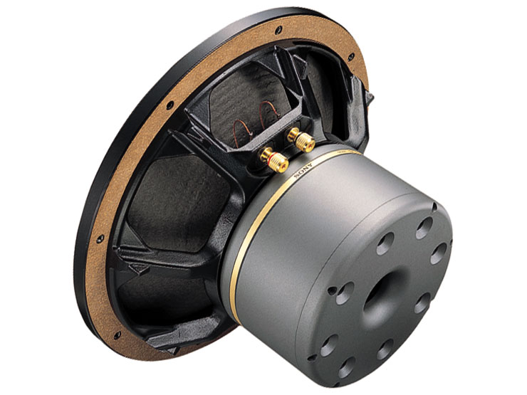

About the difference between SONY (SUP-L11) and GT Sound “GSU-W16”
1. Change the voice coil's bobbin from aluminum to paper
2. Change the voice coil from aluminum to copper
3. Change the material of the center cap of the magnet.
4. Unevenly change the thickness of the rib to prevent the split vibration of the cone paper.
I think the main changes that memorize the shape of the center cap are as above, but at the production stage It was said that the characteristics were measured in an anechoic chamber one by one, with an emphasis on aligning the characteristics by minimizing the error of the noise.
In any case, it seems that the real background is that the audio mania was so high that the specifications that had been ordered by SONY were commercialized, and the withdrawal of SONY put it in the position of direct production of speaker systems. It is.
I have built an original specification speaker system with the Advanced4350A concept with the aim of becoming a speaker that exceeds that, with my main focus on audio as the main speaker, but the final demand is It is common.
However, there is a sense of music, sympathy for product ownership and brand, sympathy for the media, insight into audio equipment and acoustic engineering, economic power, housing environment, family understanding, and interaction with people who love audio. It is interesting that there are differences in various approaches and ways of enjoying (some people suffer) depending on differences.
In the process of pursuing the ultimate audio reproduction art, Mr. Goto of “GT Sound” has kept his uncompromising attitude, and the speaker system developed by investing private property has been raised to a great degree of perfection, and it is just praised. Deserve.
It is a speaker system that visitors of this blog should listen to with their own sensibilities, but if it is not an audio file that has undergone trial and error in the creation of the sound of the speaker as such, it may not be possible to understand the true awesomeness I think.
In terms of product value, the performance is quite cheap, but since it is not a mass-produced product, the audio files that can be purchased in terms of cost will be limited, but there will continue to be excellent products in GT Sound. I hope the section will continue and hope to find another opportunity to visit."

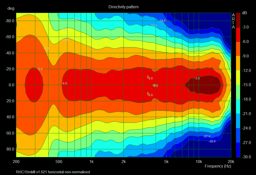

A guy, who also cooperated with mabat on the STH/ATH project, reworked the throat section of a 2" Aluminum horn - similar to the ZXPC 10x18.
Driver used is an older 2" B&C.

Compression drivers - pair of GSU-WD04 1,428,000yen (approx 11424euro)

Horns - pair of GH-301A (made of laminated maple wood) 1,386,000yen (approx 11088euro)
Horns - pair of GH-301B (made of laminated birch wood) 1,008,000yen (approx 8064euro)
Horns - pair of GH-501A (made of laminated maple wood) 588,000yen (approx 4704euro)
Horns - pair of GH-501B (made of laminated birch wood) 462,000yen (approx 3696euro)

I cannot disagree with you more strongly. I have done research into the perception of diffraction and I can assure you that our conclusions do not support your opinion.
Horn diffraction can range from highly diffracted to almost none. That's why horns sound so different. Diffraction, IMO, is the single most important factor to sound quality. Almost to the exclusion of all else.
