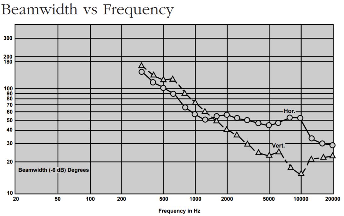

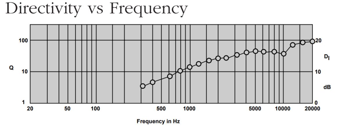

I had the 2380 clones in this Cornscala. I really liked the SQ of the D405 mid driver. Getting back to the 2386:

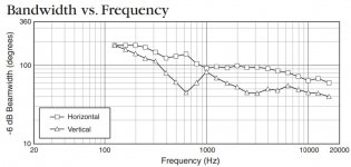

Wow, DI 10 at 800 Hz and climbing to DI 20 at 20 kHz.
Contrast that to JBL 2384, a 90 x 50 pattern.
I find the JBL 2384 90 x 50 pattern already too narrow and looking for more of a 100 x 100 CD pattern. I can't imagine the narrow beamwidth of a 40 x 20 pattern of the 2386 in a near field living room scenario. The 2386 is a long throw horn designed for stadiums and arenas...

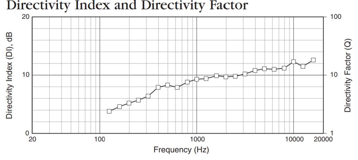

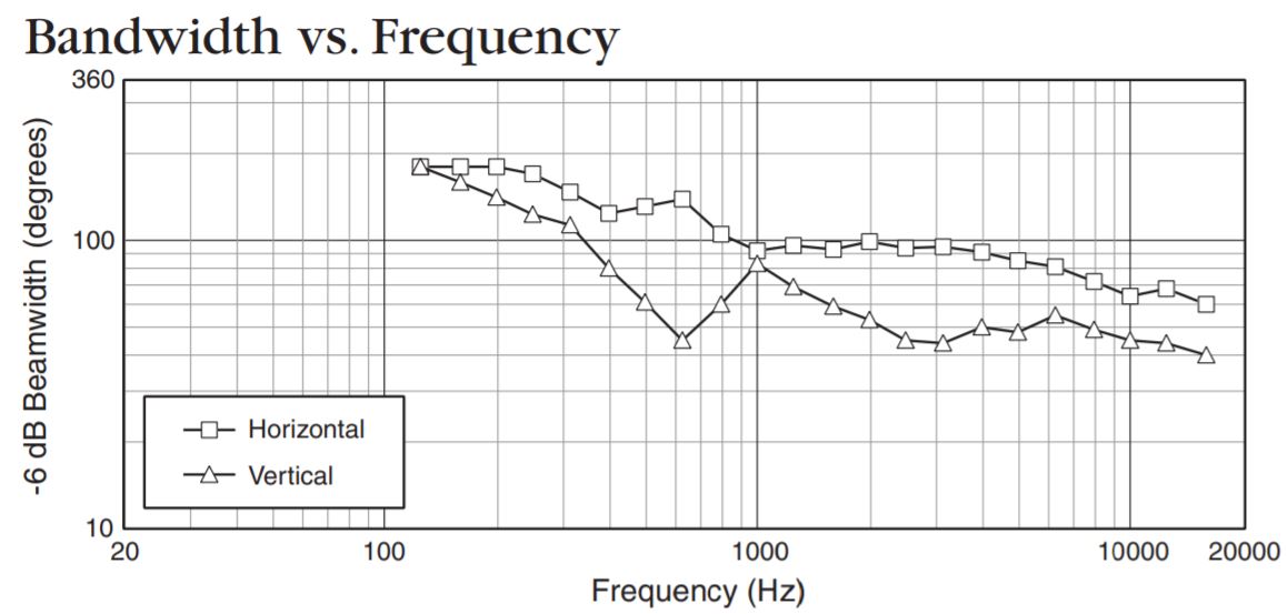

But that's not just the 2384 is it?
Looks like the whole 4722 - and the dip in vertical beamwidth around 600 Hz is the interaction of the horn with the stacked woofers.
Or so I suspect, I have an idea about how to better optimise this, do you have any data on the 2384 alone?
Best wishes
David
Well I guess this is the dreaded waistbanding. From the pictures on the Speaker Exchange website I would quess the vertical opening to be around 12" which would equal Lambda/2 around 600 Hz.
In the horizontal plane it is less pronounced due to the fact that the vertical (i.e. left and right) edges are less sharp and the width is not constant over the whole height (PT waveguide). But there is still a slight depression a little lower in the diagram, although nothing to worry about.
Regards
Charles
Regards
Charles
...this is the dreaded waistband...
Hi Charles
Yes, horns can waistband but I suspect here the problem is made worse by the vertically stacked woofers in the 4722.
That is what I would like to confirm with Mitch.
He has a 2384 and I hope he has data for the horn alone.
In the horizontal plane it is less pronounced due to the fact...But there is still...a little lower...
You mean the small dip at 400 Hz?
This is below crossover so I think not horn related, maybe some minor contribution.
I think the lack of a waistband in the horizontal plane shows that with careful mouth transition there is minimal problem.
Hence my suspicion that the vertical waistband is, at least in part, woofer interaction.
But you are correct, the smaller available roundover in the vertical plane would increases the horn contribution.
Hi Mitch,
40 x 20 is certainly a problem in any system, but 100 x 100 is wider than I think optimal, even in a small room. I would love to be able to use a narrower 70 x 70 device, but there isn't a feasible woofer that can do that except at >> 1 kHz. Hence 90 x 90 seems to be the highest DI that I found feasible to build cost effectively.

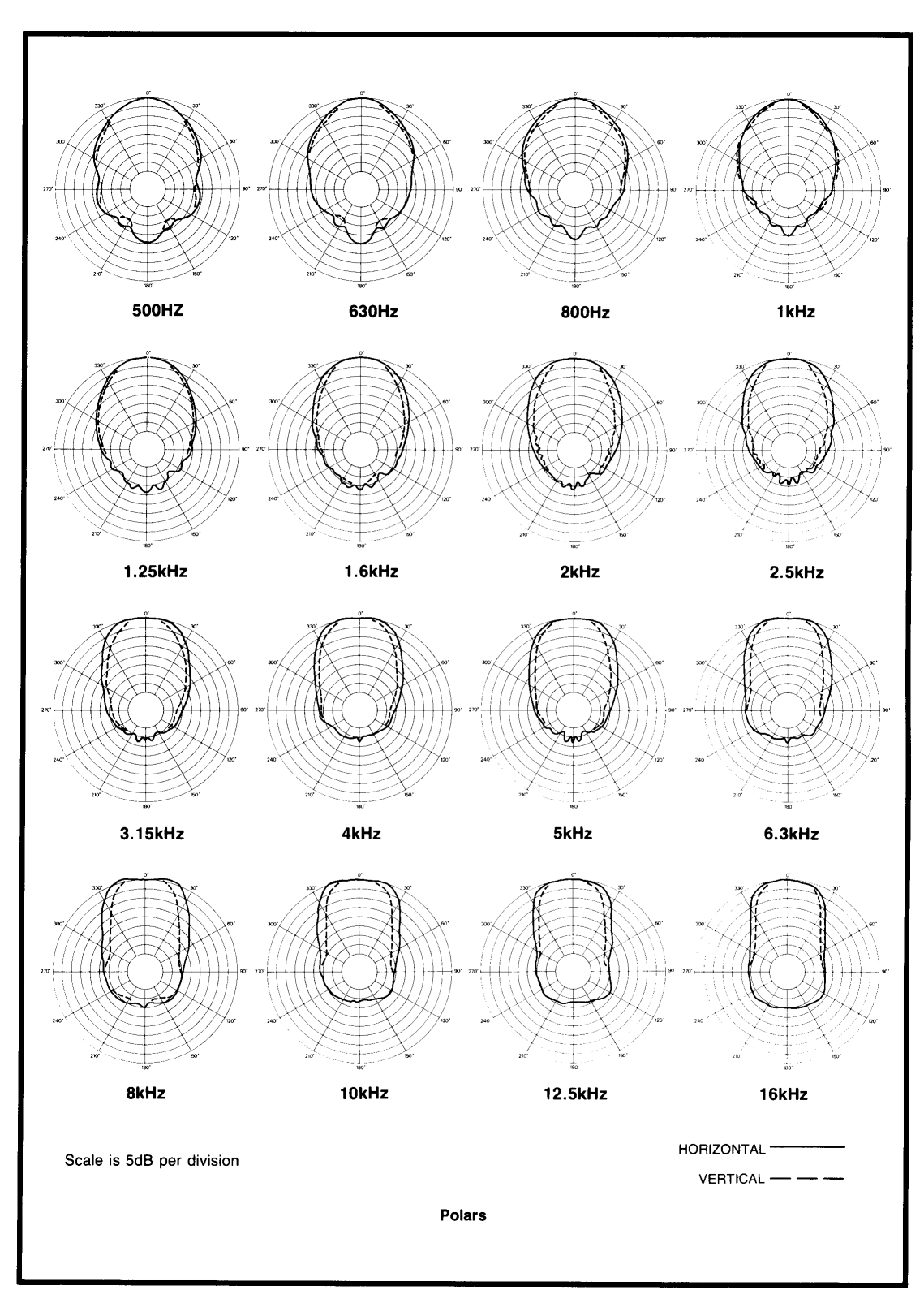

Is this the 2386 polar?
Joined 2006
A guy, who also cooperated with mabat on the STH/ATH project, reworked the throat section of a 2" Aluminum horn - similar to the ZXPC 10x18.
Driver used is an older 2" B&C.
Possible that you could show me where this information came from? Thanks! 🙂
No, it's of a large format diffraction horn.
