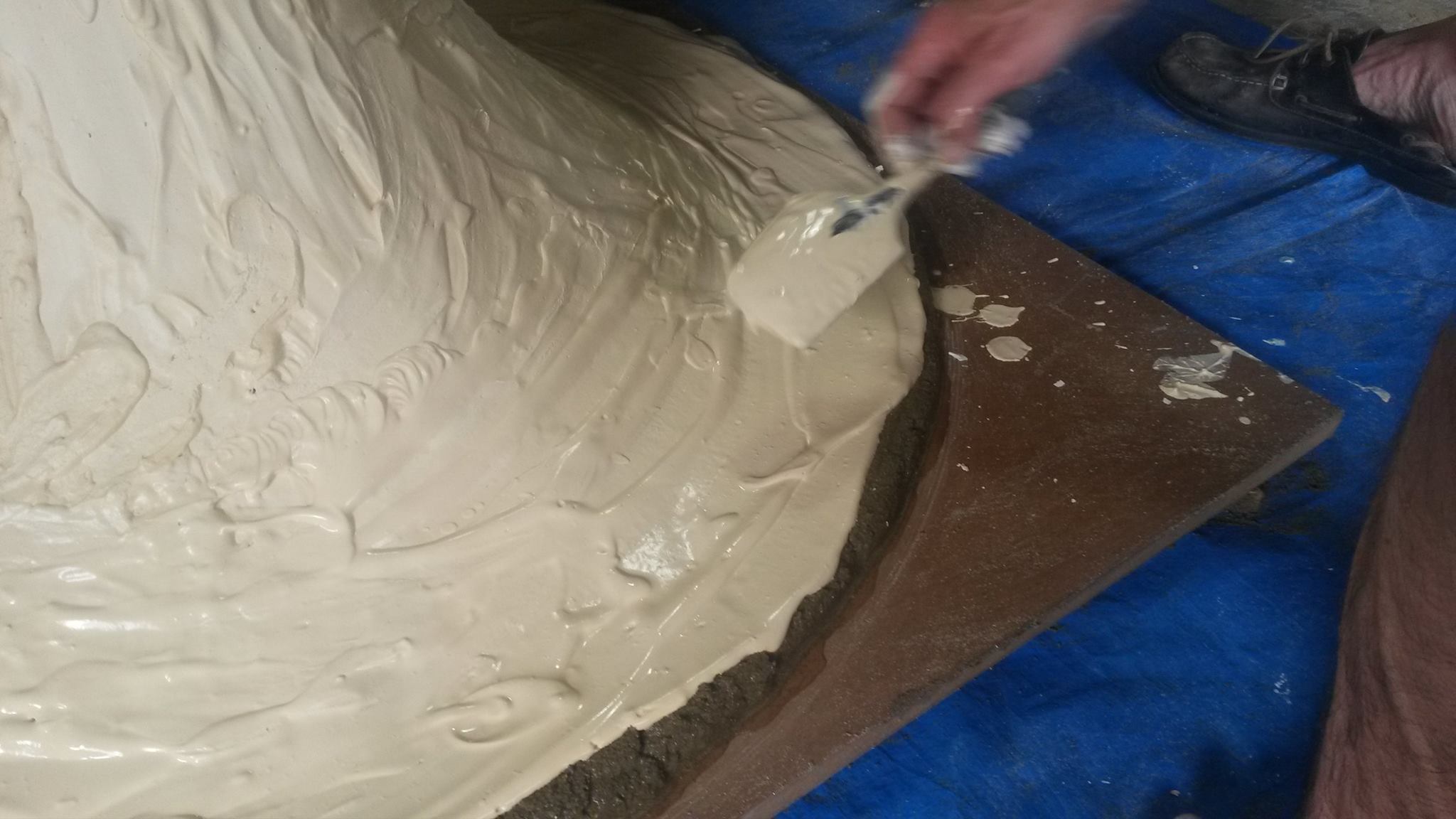

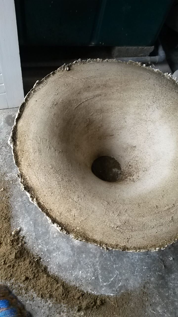

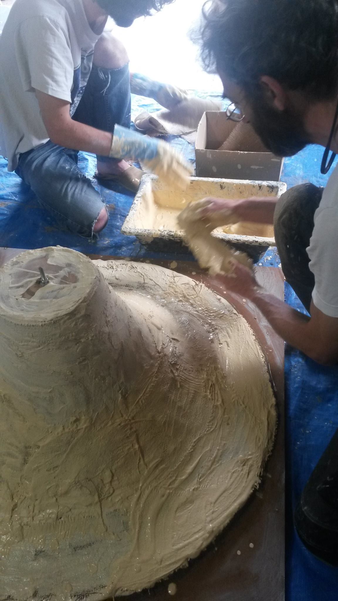

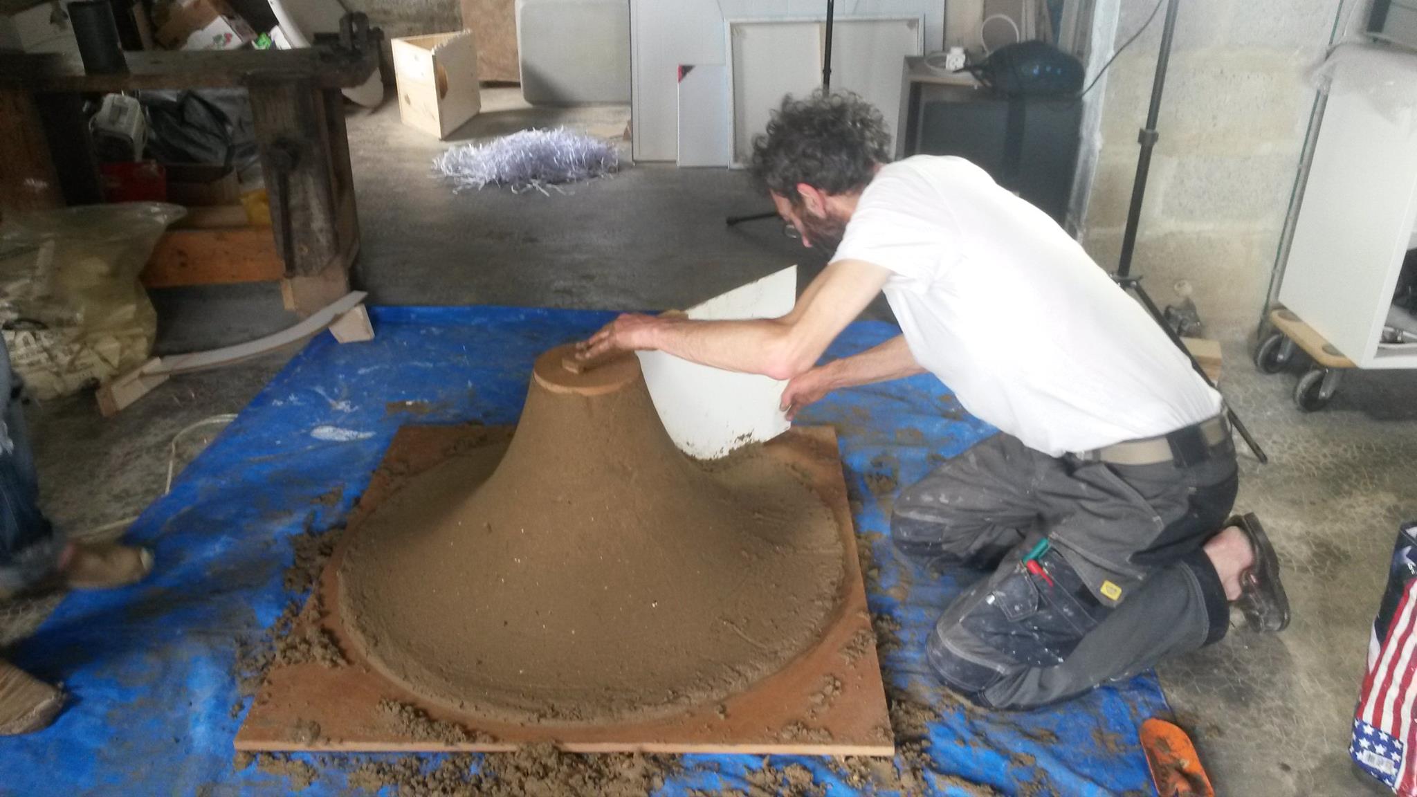

vc08, thank you for posting.

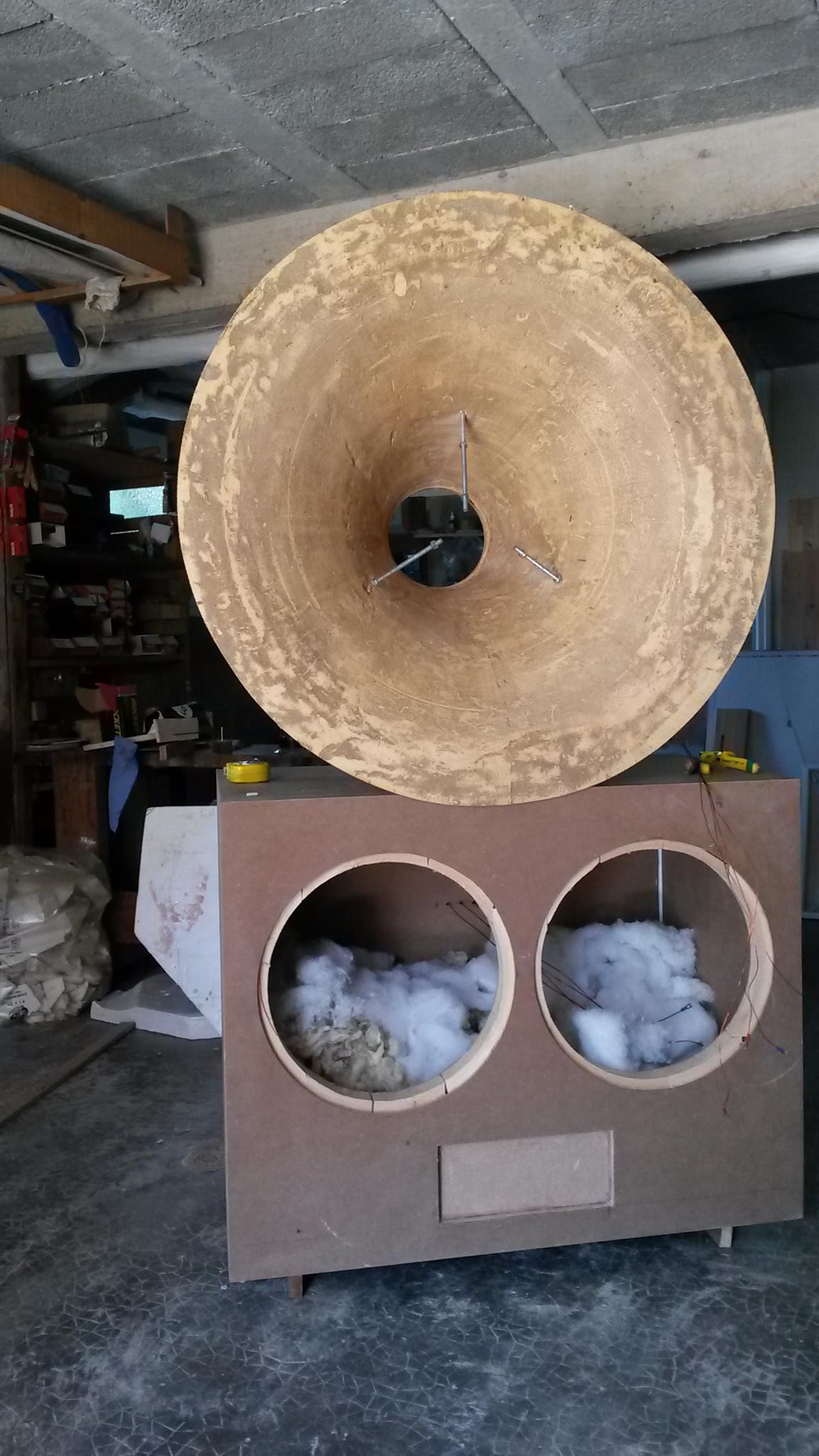

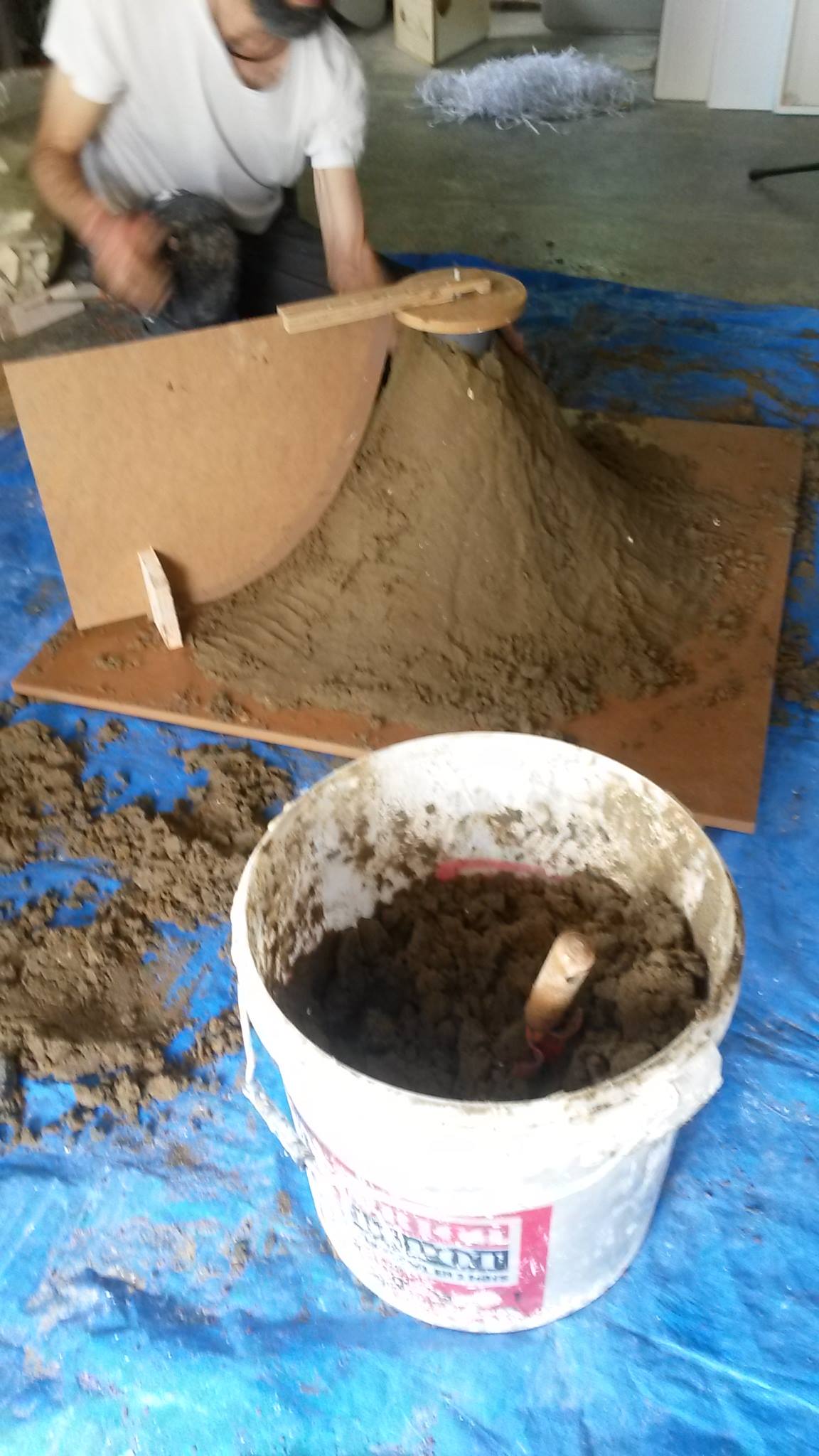

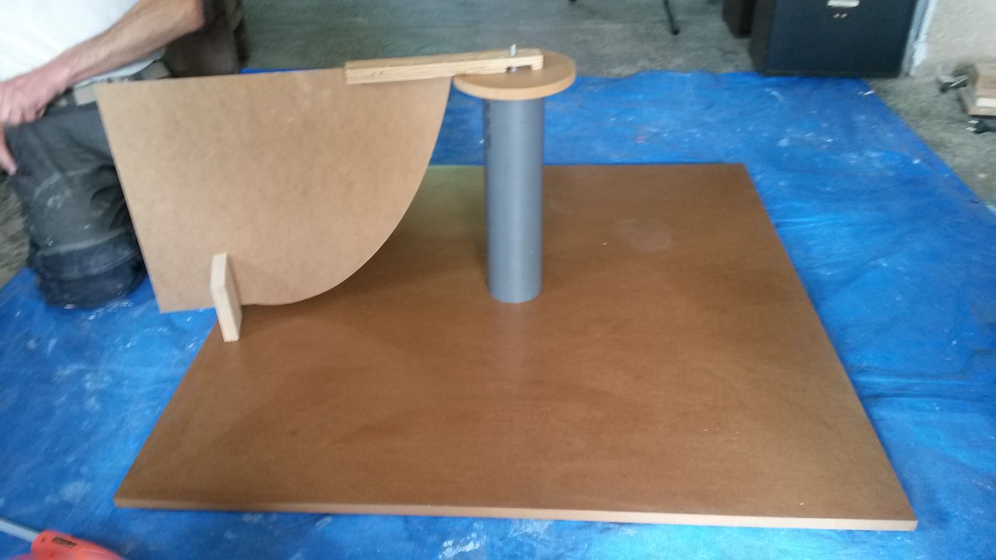

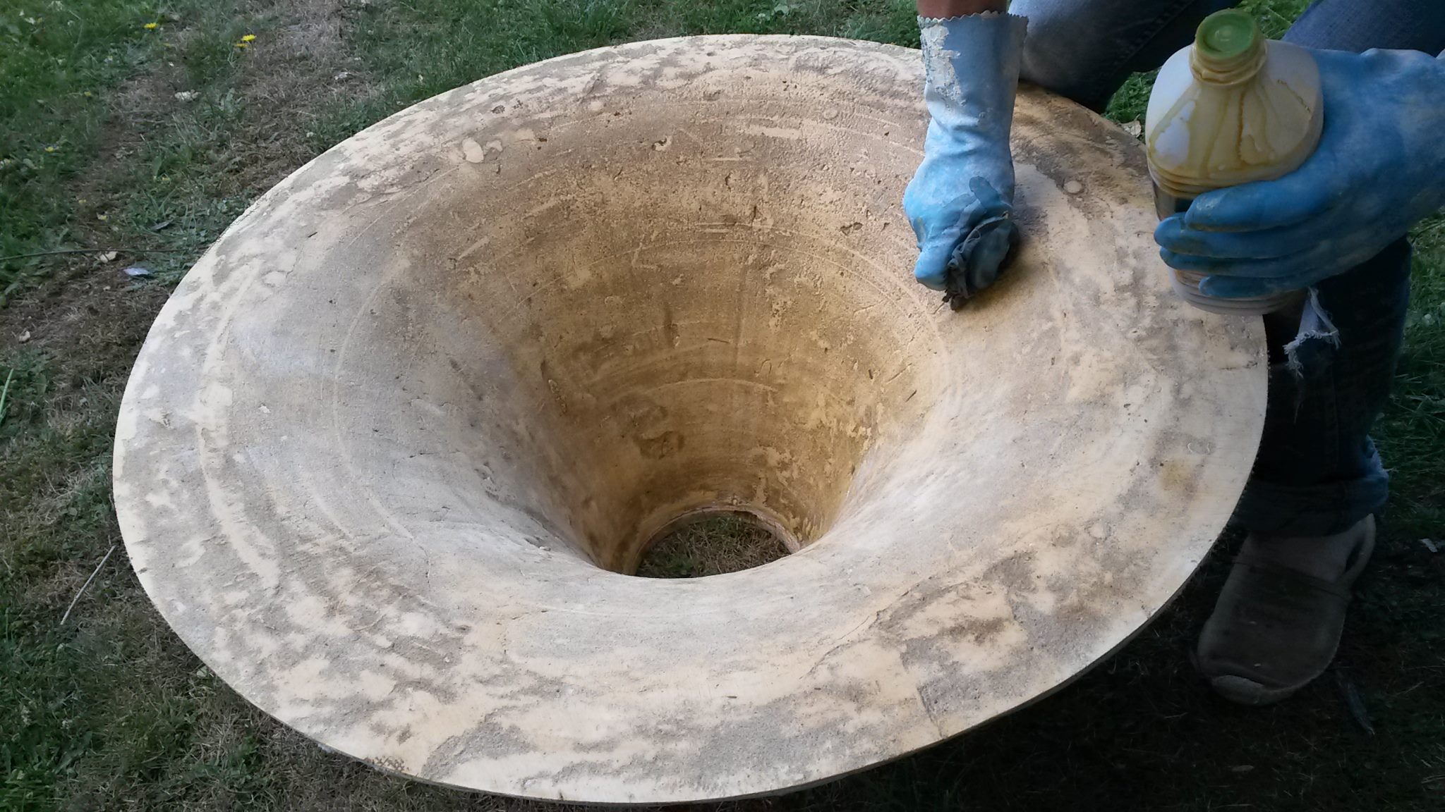

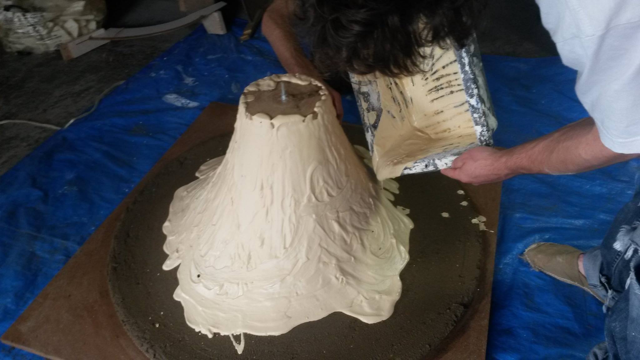

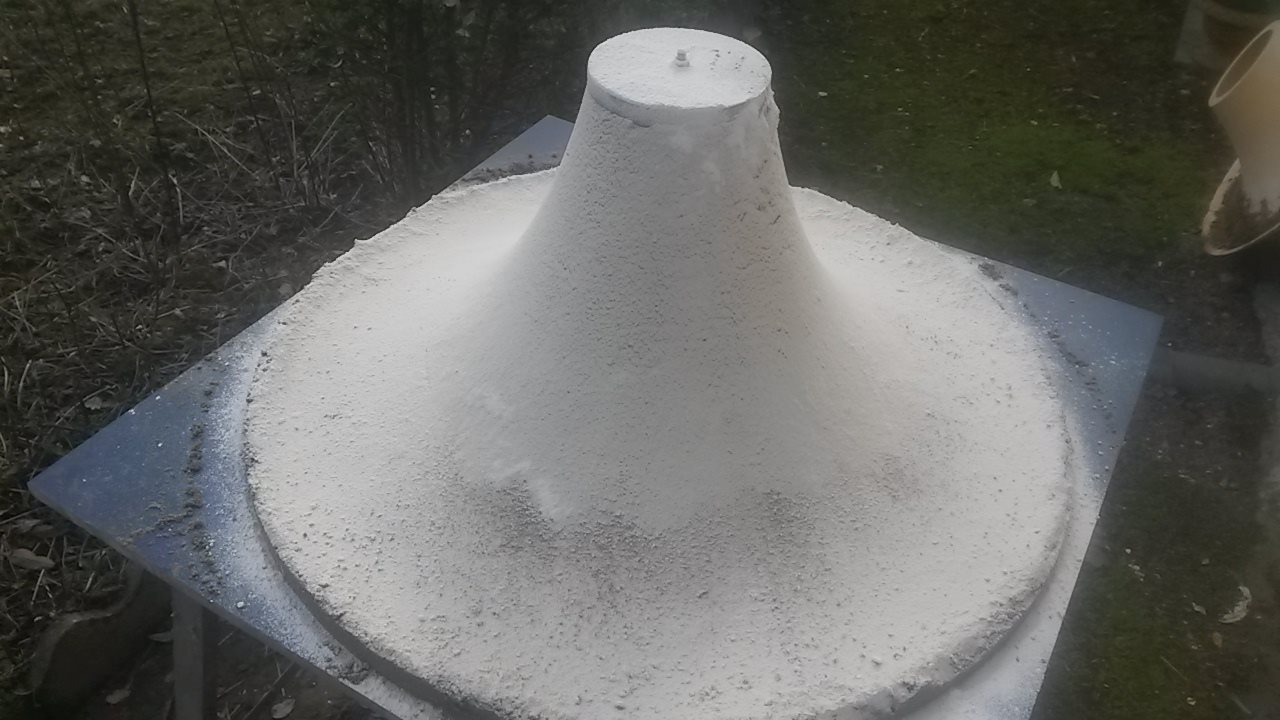

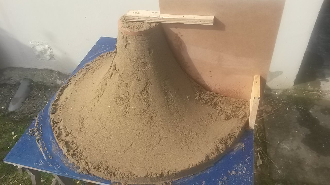

camplo, here are some pictures of Marco Henry's construction method.
He applies gypsum to a mold for the Grande Castine horns, but has also used other materials.

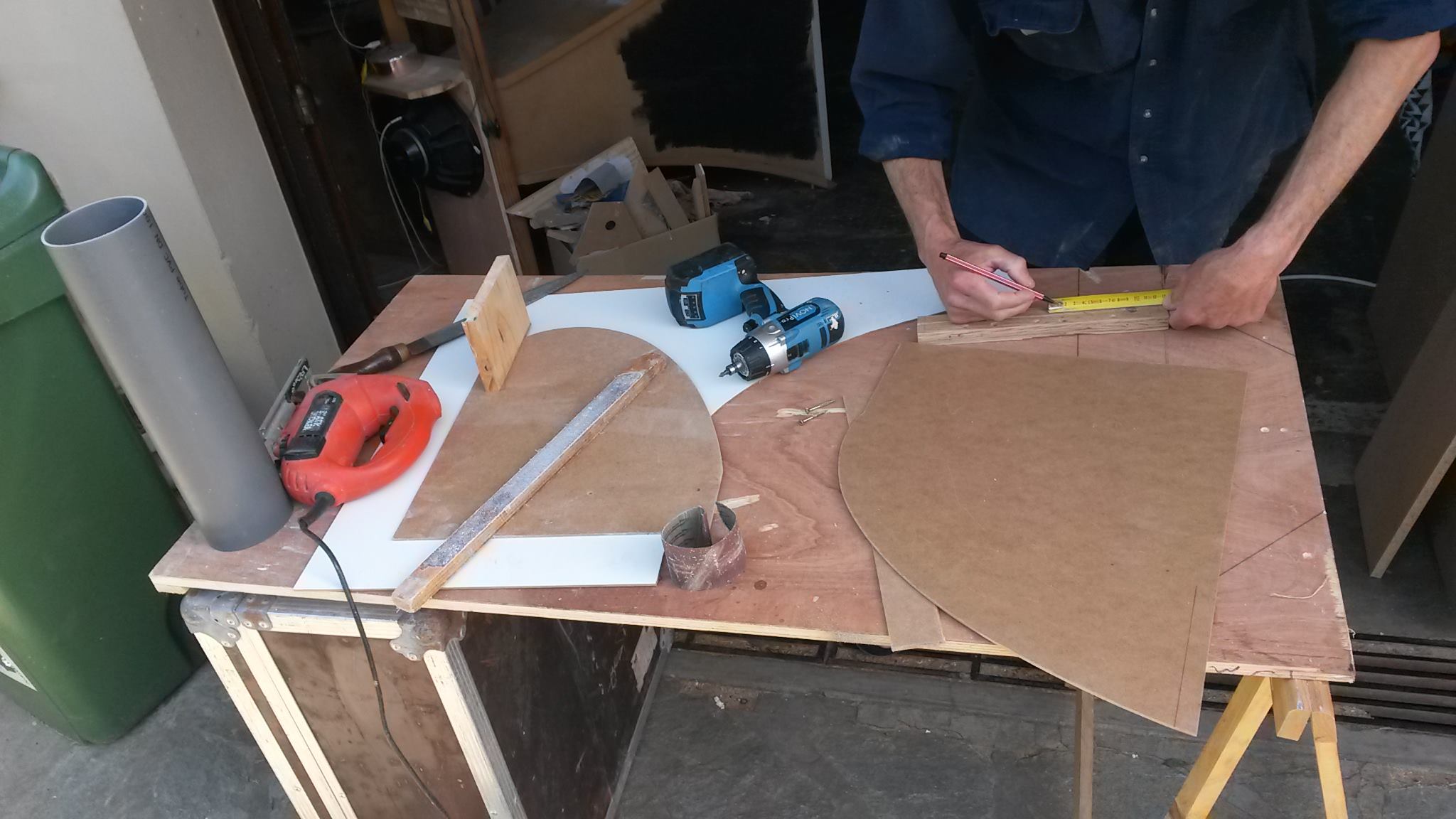

Some more:

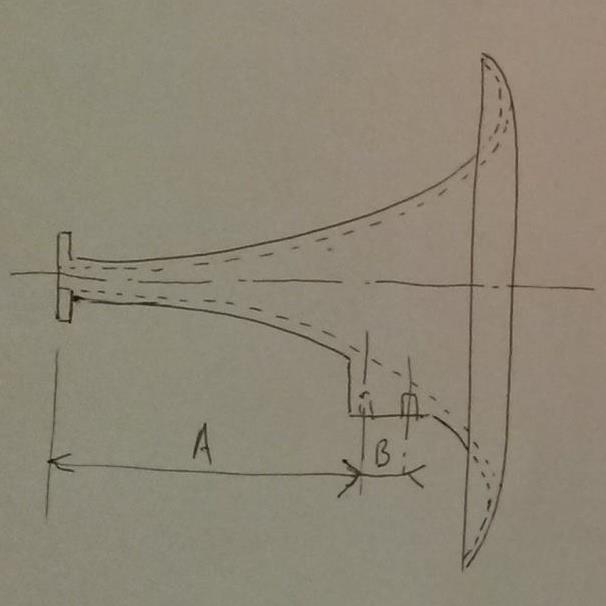

Hmm, a quick check on horn depth………………………
A late friend of mine (djk) said……………..
“ "Quarter Wave/Beranek texts"
The horn needs to be 1/2W for smooth treble, not 1/4W.
Most important graphs (Olson). 5.10 shows mouth size, 5.11 shows depth.”
