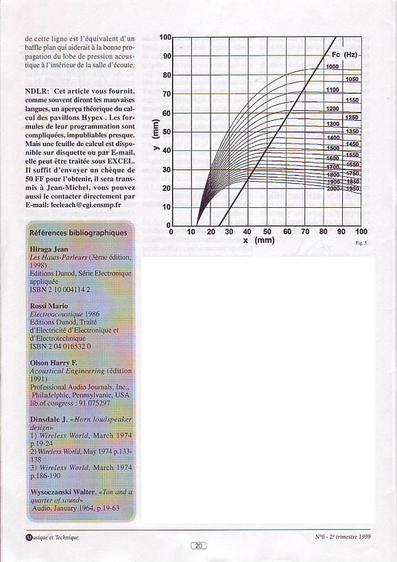

For those interested and able to read some French, here's the original article in which JMLC describes his horns.
The method for calculating the "Le Cléac'h" horns was presented in issue 6 of the "Musique et Technique" magazine (2nd quarter 1999) in an article entitled "Design of HYPEX Acoustic horns".
The origin of this method lies in the fact that it makes no assumptions about the shape of the wavefront.
The article by Jean-Michel Le Cléac'h exposes only the principle of the method without detailing the calculations but this description is sufficient to find the equations that allow to calculate the profile. Details of these equations can be found in Pavilion JMLC.pdf .
Several companies offer Le Cléac'h horns. The image below shows the JMLC-350 manufactured by the Polish company Auto-Tech. As can be seen the roll back of the profile is close to 360 degrees which allows to take full advantage of the quality of this type of horn.

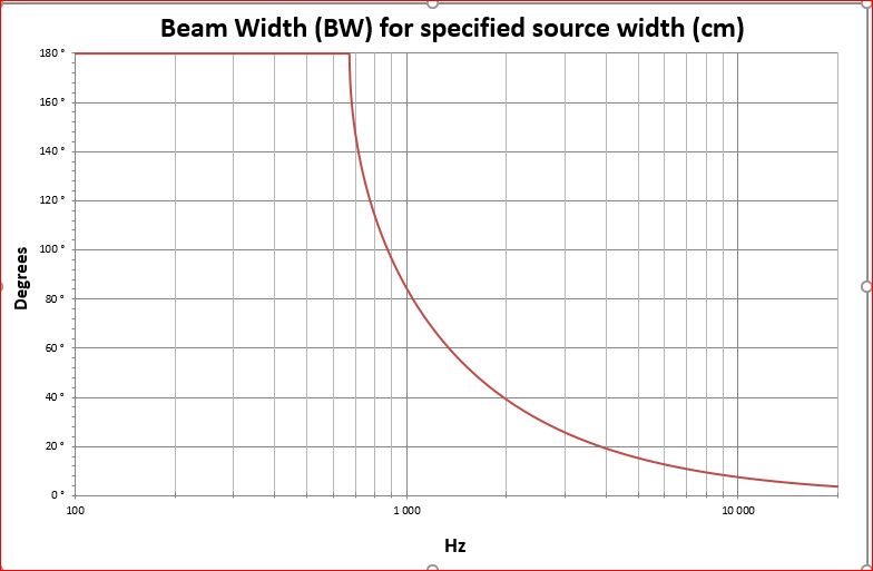

I am no guru when it comes to "pairing" various drivers, choice of filters etc but as TD 18H+ has been mentioned, I measured its actual cone diameter on the ones I have. Cone Ø is 360 mm excluding the surround, with surround 405 mm.
If one goes on theory, beaming and beamwidth from that cone diameter and want to pair it with a horn with horisontal dispersion X degrees, it should be about:
Beamwidth 70 deg <=> about 1170 Hz
Beamwidth 80 deg <=> about 1044 Hz
Beamwidth 90 deg <=> about 950 Hz
Beamwidth 100 deg <=>about 875 Hz
Beamwidth 110 deg <=>about 819 Hz
Beamwidth 120 deg <=>about 775 Hz
From memory and some old measurements the TD 18 H+ fell off very sharply at around 1200 Hz but seemed to be quite decent below that. (I don't know really if I have those measurements saved or if they are on a dead hard disc.)

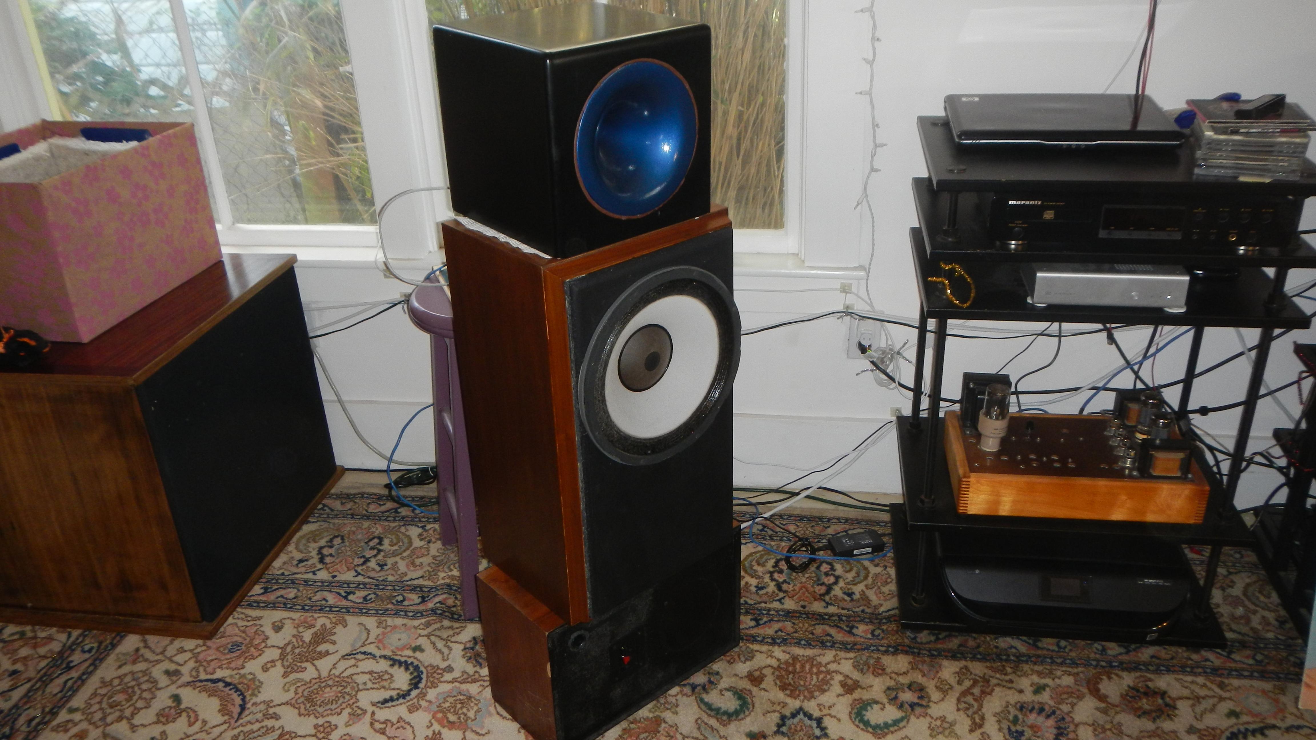

Prototype #1 of a speaker inspired by this thread. Top box is an Edgarhorn 650hz "salad bowl" tractrix horn with an Altec Lansing 902 CD in a Parts Express cube. Bottom box is an old repurposed speaker box with an Altec/GPA 414-8c woofer. The box is about 1.1 cubic feet net. The crossover is a Marchand active 24db/oct set at 1200 hz. I also use a passive speaker level circuit to raise the highest frequencies. Obviously, the crossover is not optimized.
And the horn will likely be replaced. With what, I don't know yet. So far, it sounds excellent. I sit only about 10 feet from the speakers, but there is no hint of separate sources, and the imaging is outstanding. As expected, the balance changes when I stand up or move forward. Subwoofer in the corner is a Dayton 15" (don't remember which) and a plate amp in a box made out of solid Padauk by a friend. Any suggestions for a passive crossover and different horn for this combination would be appreciated.
