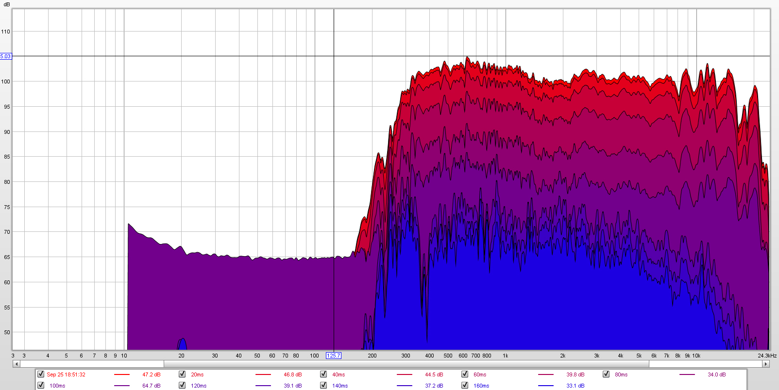

I wonder how low in frequency the Axi2050 can maintain SPL, even in an ideally matched horn? The Celestion measurement into the SEOS-30 (Minimal frequency from 300 Hz), shows SPL drops under 600Hz...... but the Axi2050 plays to 300hz within spec so 200hz isn't a crazy stretch....
The drop is due to the SEOS-30, which doesn't provide much loading below 600Hz.
You'd probably get away with using the driver from 400Hz behind the SEOS, but 600Hz is about the minimum loading frequency of this 90x60° waveguide.
I am pretty sure that even with a hypothetical SEOS-100 you won't see a huge difference in the plot.
Only a very narrow OS waveguide, for example 30x30°, would (probably) load the driver at a lower frequency. That horn should also be quite deep.

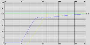

I was told it during my Altec Plant visit in '68 and AFAIK is only mentioned on pg. 76 of this book by two Altec engineers and even then a bit 'cryptic' to the casual DIYer, especially before T/S: How To Build Speaker Enclosures By Alexix Badmaieff & Don Davis : Free Download, Borrow, and Streaming : Internet Archive
As for other 'golden' 😉 reflex alignments, there's a few, but nobody uses them since T/S designer programs became widely available. A couple of exceptions I never see mentioned around here anymore is WP's Pi Align, a great prosound, corner loaded or just all around high SQ alignment that AFAIK he still uses for his kits/builds and Keele's? extended bass shelf [EBS] alignment [AKA Altec's X-Bass].
Note that the 'PiAlign' link auto downloads a zip file with some old driver specs, some stuff I don't remember and an .exe program to calculate it: Pi Speaker Forum - Various alignments - Wayne Parham, August 22, 2002 at 23:03:47
EBS/X-bass design routine: Calculating an EBS alignment
All that said, regardless of the alignment or how much damping used in the cab, it's always a good plan to critically damp the vent using an impulse test to get that last [little] bit of any cab/vent resonances for best overall SQ/lowest practical group delay.
