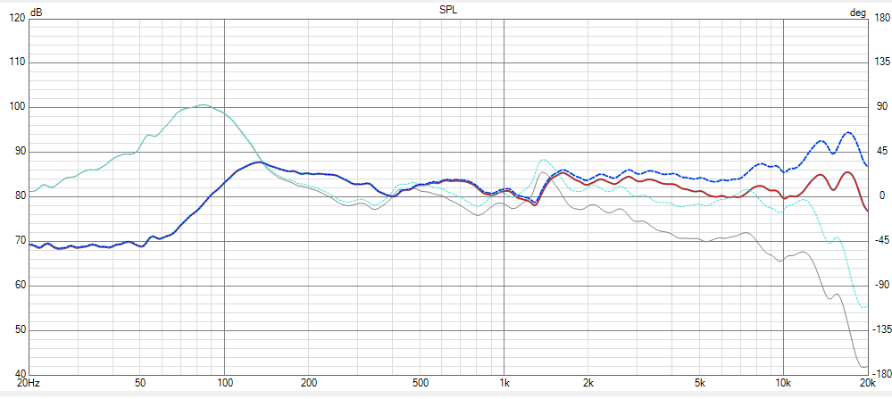

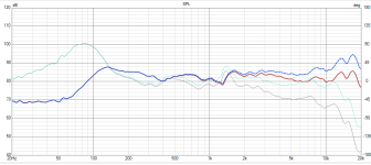

Resistor? Did you mean 0.22mH inductor? I kept this as a future update as I had to move to a new project and then completely forgot.
Blue - Bare wire
Red - 0.22mh inductor in series

The extra impedance in series (however it's achieved -- it could be with a tube amplifier or current drive for that matter) reduces intermodulation distortion, which would be doubly important to manage with wide-range drivers. So when people use "high THD" tube amps together with FR drivers, there are reasons for it.
AFAICT, a bad sound associated with break-up modes is likely uncontrolled distortion, not actual ringing as such.

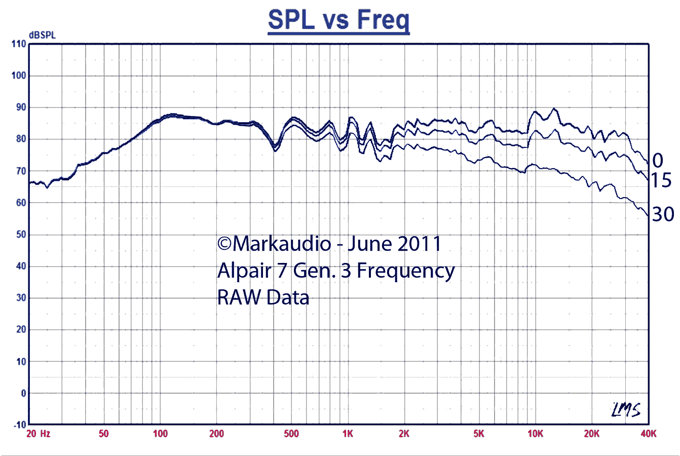

well imo the beaming isnt that bad, every driver beams to some degree and the alpair 7 doesnt seem "that much" worse, and i would argue that its not bad in a pc setup (it might be even better because of less reflections)
i would definitely run full range drivers on axis and reduce the highs with my target/house curve (linear slope towards 20khz) as needed
