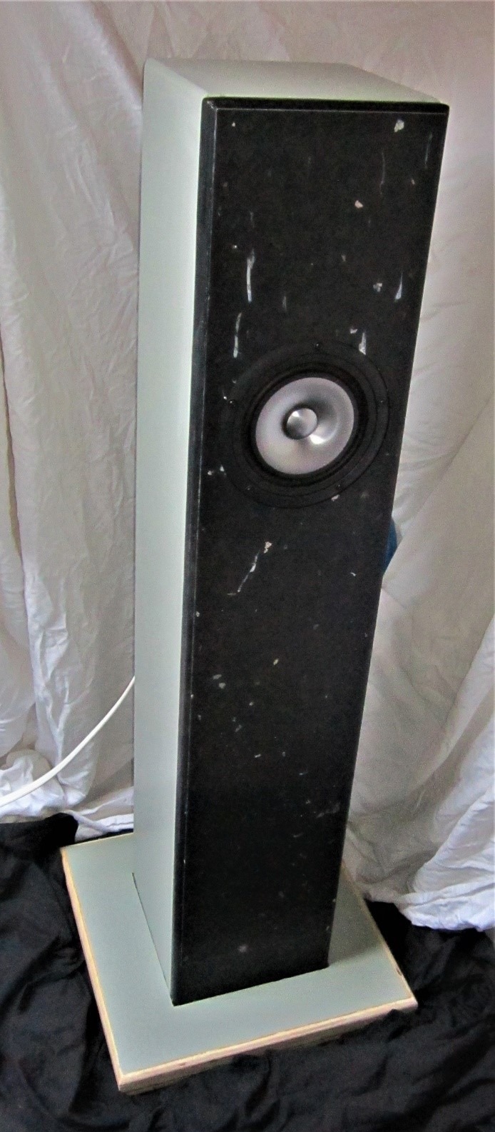

Subjective listener warning!! I have just swapped a pair of alpair11ms for maop11's - & after 40+ hours of running-in the maop's I'd say its been the most significantly positive change of listening experience I've had. In mltl cabinet (~38 ltrs) they offer a healthy lower register, so no need for a sub. I now feel like I'm embedded 'with' the music as opposed to being a remote observer/listener (if that makes sense?).i choose the alpair 11ms because i saw a comparison video on youtube comparing 8 different full range drivers and the pluvia 7.2hd kinda stood out for of the bunch, and it seems alpair series is a notch up from the pluvia series... im also considering the maop series of markaudio, if the driver is really good im kinda willing to spend 200€ per driver
Attic room, sloping ceiling, 10' wide by maybe 13' ... speakers are approx 7' in front of me, about 7' apart. slightly toed in. The cabinets stand just shy of 4' with driver centres at 3', i.e. directly facing me when I sit at my desk.
I'm no techy wiz or audio-brain, so I can't offer much else except to say they've been a revelation for my tired ears.
Bought here: https://kjfaudio.com/product/maop-11/... Now offered at £278/pair; I had to add 20% vat in the UK

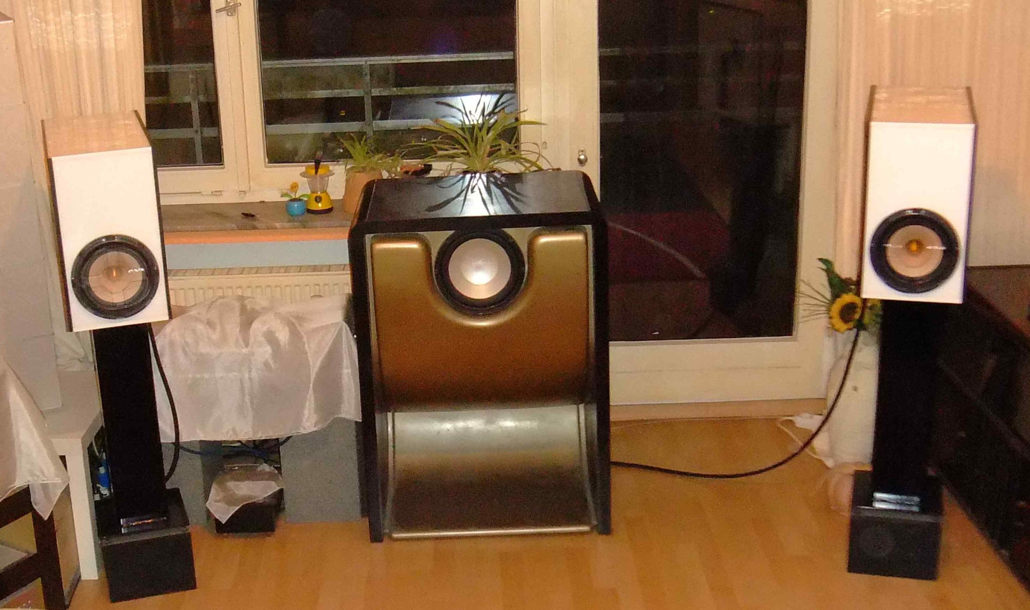

I had 3 pairs of speakers before I made FHXL with Alpair 11MS. Sonus Faber Signum - sold, Monitor Audio Gold 100 - packed back in the box and stashed in closet, Acoustic Energy Aelite 1 - in son system for now. All very good loudspeakers but with FH in main system I dont really need them any more.
