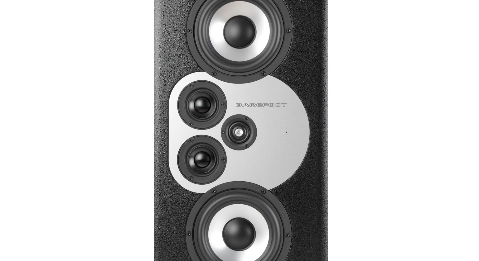

Notice Barefoot is using this driver as their midranges in their now world famous monitoring system……it’s active DSP of course and I suspect it playing up pretty high for the SPL they’re reporting and the close co location of the grouped drivers….likely 8-10khz region. There’s some pretty famous mix and mastering engineers that have claimed this system to be the finest loudspeaker……ever.

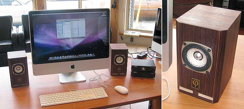

Lots & lots of options. These showed us the potential. Outstanding, and you can do even better today.

what driver/speaker is this? i saw some more with this "spot" design but couldnt figure out what they areLots & lots of options. These showed us the potential. Outstanding, and you can do even better today.
oh i havent heared of this brand till now, i keep the peerless definitely in mind ... im just so unsure of what to do 😀 i dont like compromises lolNotice Barefoot is using this driver as their midranges in their now world famous monitoring system……it’s active DSP of course and I suspect it playing up pretty high for the SPL they’re reporting and the close co location of the grouped drivers….likely 8-10khz region. There’s some pretty famous mix and mastering engineers that have claimed this system to be the finest loudspeaker……ever.
