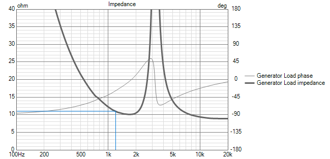

And if i put a 400.000 ohms resistor in VituixCAD, and move the voltage source it looks like this. (have i understand it right?)

Yeah as TNT already wrote its resonance in the driver, physical property of the driver. You can and should manipulate the response in crossover to make the frequency response of the system nice. There are probably many ways to do this, including some variations of the low pass filter or perhaps additional shelving filter or a notch filter, perhaps something else.Yes, it shows also a little without xoverparts.
If you wish to play with the "advanced impedance manipulation" this would be one spot to do it The resonance is kind of an amplifier in the acoustic domain and any current through voice coil around the resonant frequency is emitted (amplified) acoustically by the resonance, including distortion current due to the driver motor non-linearities. Ideally you'd want to make the filter so that it reduces current through the voice coil, a filter that is in series with the driver. Such filter would reduce any current through voice coil at the resonance including any distortion generated by the resonance, or any other distortion current generated in the driver motor like hysteresis. Filter scheme with greatest series impedance would be the lowest distortion alternative. Some other filter could could do the same equalization of frequency response but instead increasing the series impedance for the driver it could lower it, like a shunt circuit which would route some amplifier current past the driver.
Simplest examples of the two are series notch (in parallel with the driver) and a parallel notch (in series with the driver). Series notch (in parallel) would probably show up as higher distortion in acoustic domain than a parallel notch (in series with the driver) because of difference in the series impedance, difference in distortion current.
You can "see" which has lower distortion by checking the impedance from drivers perspective, the filter that has highest impedance around the 1-3kHz would have least distortion current, least acoustic distortion. I'm not sure if a notch is best way to do it, perhaps others know simpler solutions to make the frequency response happen.

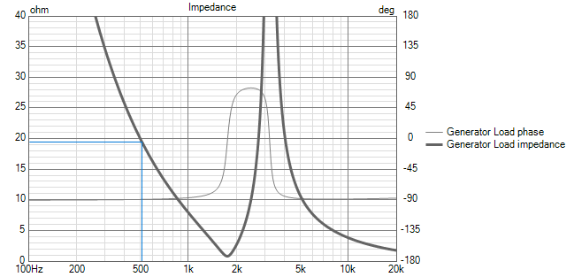

Ahh, i missunderstand....output impedance on my amp is 0,08 ohm and rose very slightly, to 0.11 ohm at 20kHz (Steroephile mesaurement notes)
If i put 0,08 ohm at voltage source it shows this
And when i short the tweeter like this, 0,9 ohm at 1700 hz

Hi,Ahh, i missunderstand....output impedance on my amp is 0,08 ohm and rose very slightly, to 0.11 ohm at 20kHz (Steroephile mesaurement notes)
yeah not sure if AMT benefits any of if. The Audax woofers with the impedance blip could so try having the generator in series with the woofers.

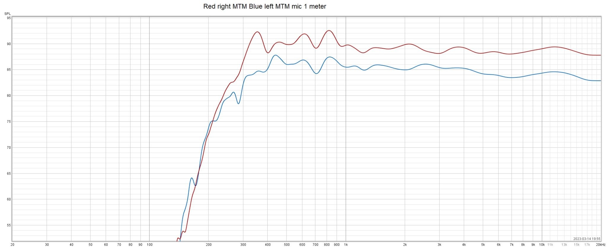

Use REW and my laptop, but don't understand exactly how I mesaure impedande in REW....Seems complicated.
But i will make 1 meter mesaurements with calibrated mic in the auctual room, and post it here tomorrow.
Use active filter for both woofers and MTM, woofers get "everything" under 340 hz, and MTM "everything" over 340 hz with a passive filter crossed at 2K.
Woofers and MTM each has a stereo amplifier, one for left right MTM and one for left/right woofers...both Krell

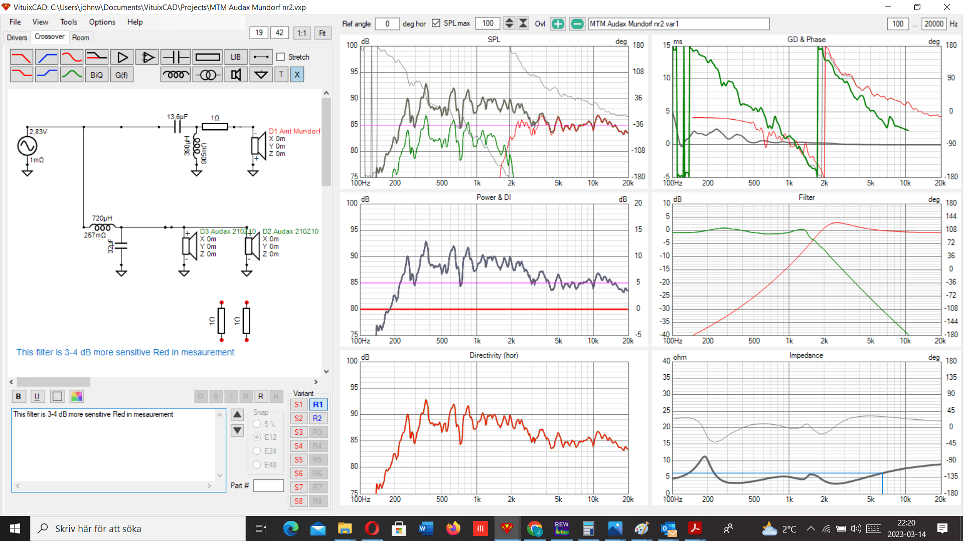

For now i have trained to "try understand" passive filter designing, and what changes where regarding to komponent and placement.
And have worked on 2 different MTM filters buy mesaurements, and use a bad responemesaurement and manufacturer's impedance.
Curves in VituixCAD do not fit well with my SPL Trace file, but have been some "benchmarks", even if vituixCAD looks like **** it mesaures decently.
Strangely, it makes a whole 3-4 dB difference on mesaurements over the hole frequency range
