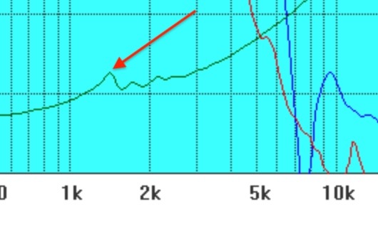

like high Q resonances (like the one in the Audax) and directivity
Can you explain what tells you high Q resonanses in my Audax HM210Z10 ?
Something in the mesaurement ?, specs ?
And why it is "bad" ?
Regards John
Your filter may be high Q, the capacitor is large and the inductor is small, it may be taking in more energy at resonance than needed.i have the same small irregularity both on respons and impedace.

The Q value of a resonance can be said to express how sharp the "peak" is. So a very pointy / sharp peak is a high Q resonance as opposed to a soft wide bulge in the frequency response is a resonance with low Q. Your little blipp at 1k is more of the first kind.Can you explain what tells you high Q resonanses in my Audax HM210Z10 ?
Regards John
High Q resonance are "ringy", like a bell. They sound bad and require equally sharp filters to mitigate - sharp filters are hard to design and implement. Low Q resonances more change the tone/timbre of the "party" and are much easier to EQ and thus, tame.
So when looking for bad things in a spl or impedance trace, big broad deviations from a flat, horizontal trace are "OK" but sharp, thin ones should be avoided.

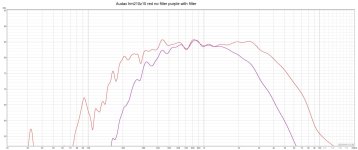

If you look at my mesaurements without passive filter and with passive filter, do you still thought it was "high Q resonanses" at 1k ?
Its more hard to seems to fix the the irregularities at 750 hz.
Regards John
Thank you for explaining AllenB
Are you refering to both filters ?
Or combination 11,6uF/ 0,390mH and 0,640mH/17uF, or combination 13,6uF/ 0,390mH and 0,720mH/32uF ?
Regards John

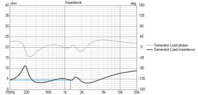

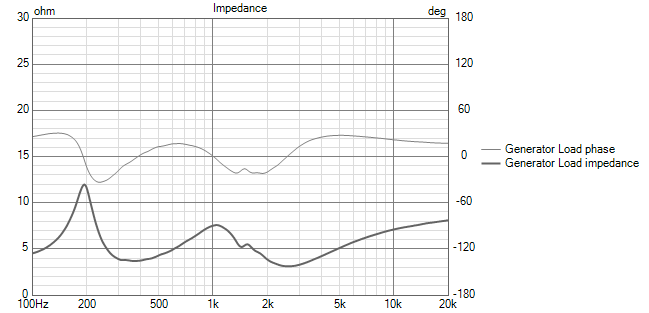

I saw a woofer response in post#13 and a circuit in post#16. The thing with this is the response is up and the impedance was down. So I calculated the frequency then I calculated the Q.
You would need to confirm one way or the other, but that should be simple.

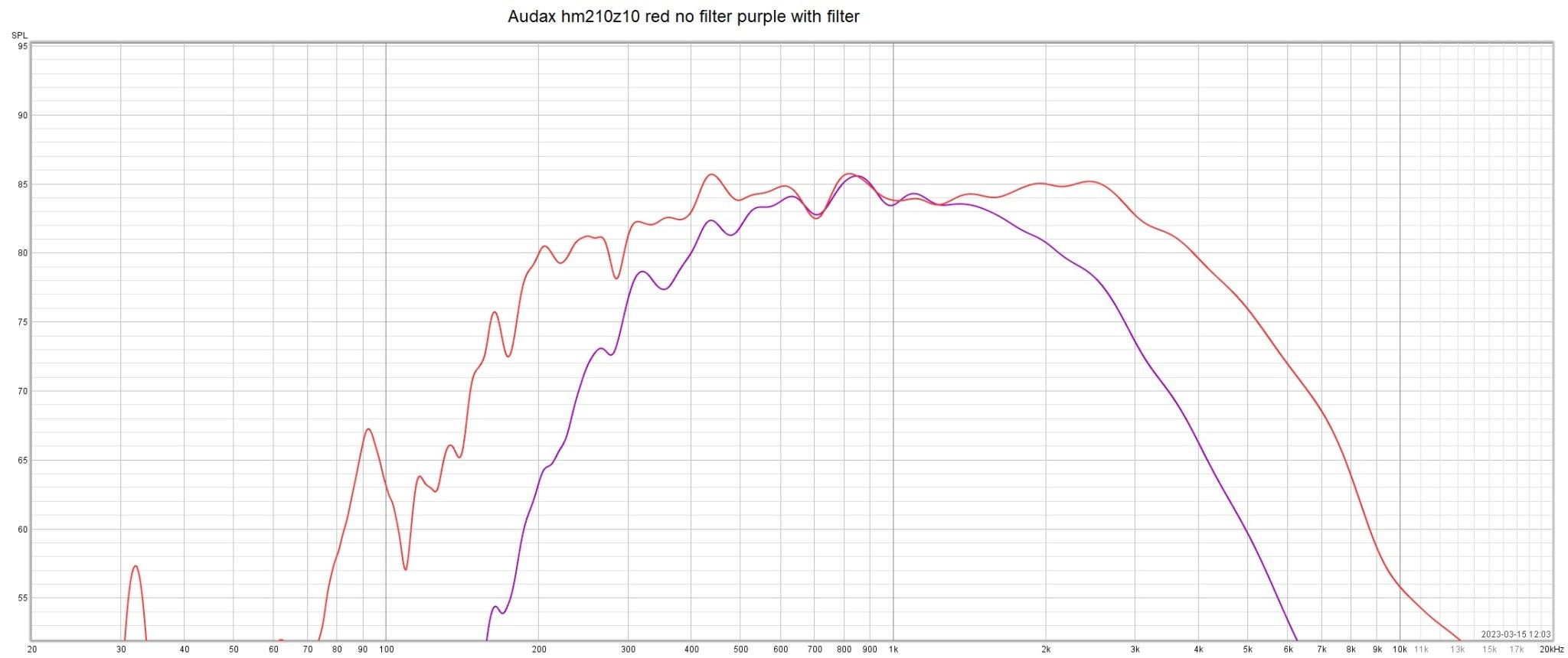

I was solely talking about:
Ahh, you mean that.
Yes it´s hard to get completely awy, but don´t know "how much" that is okey.
This is one filter and you still se the "nick", but it´s more even.
Is it going to be a problem you think ?
And this other filter with 3-4 more dB sensitivity.
Bigger "nick" but don´t know if its to big?
Regards John
Ahh, okey.
#13 was pic from VitiuxCAD whit "normal" filter component placements.
#16 Was when i put the voltage source/amp in serie with the tweeter, and had a 400.000 ohm resistor at amp "placement in VituixCAD
EDIT: Now first i get it.....1+1 is 2 hahaha...You are right AllenB
Regards John

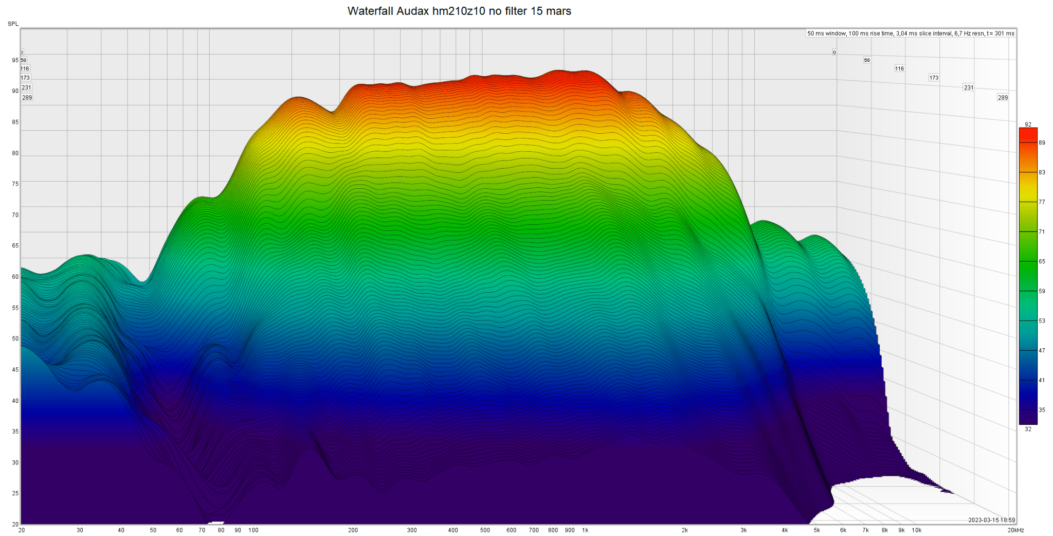

Here is a different view of the 1,5k resonance and the corresponding waterfall.
It looks rather benign on some measurements and others it is quite obvious depending on X/Y axis impedance scaling.
It is not as high Q as the typical breakups in hard cone drivers, like seas excel etc. But it 'rings' for some time as visible in the waterfall, but the amplitude dies down rather fast.
The cone is more damped too then harder cones, but it might be objectionable, depends on the ears that listens.
it's in the natural passband, from your measurements is not much to do about it.

Hi Arez and thank you for your participation.
In today´s mesaurement the waterfall for the Audax HM21010 looks like this.
Regards John
I venture to guess that is not a outdoors measurements with huge space around or a anechoic chamber?
If not your response gating is way too high according to the pic, to get much info from the CSD when it comes to the resonance behavior. you will have a lot of time for artefacts to creep in.
try a gating of 5-10 ms.🙂
