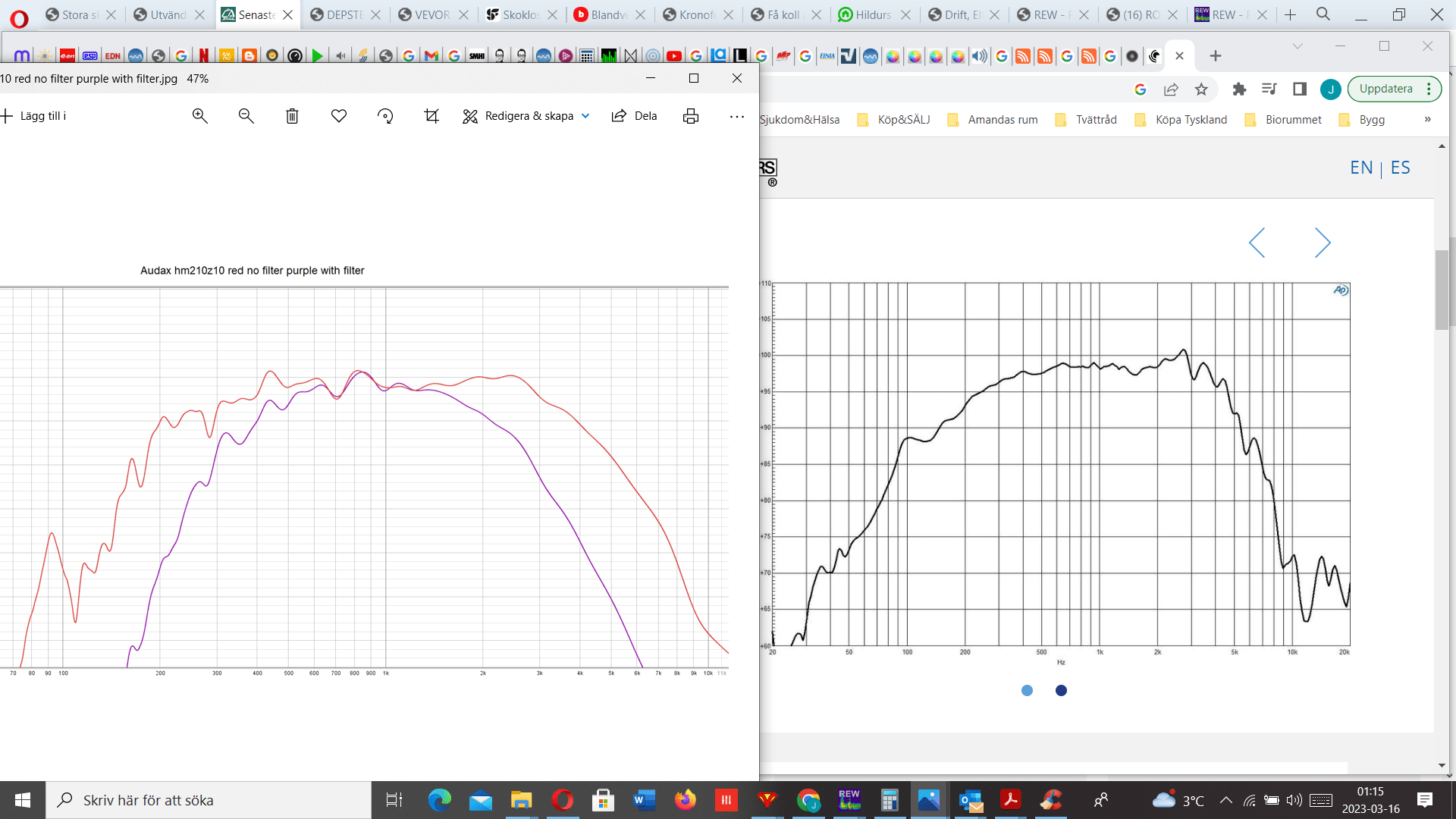

Here is another measurements of the same driver, just note that the CSDs are taken with a 50db scale not 25 as most does.
https://www.dibirama.altervista.org...udax-hm210z10-mid-range-8-8-ohm-240-wmax.html

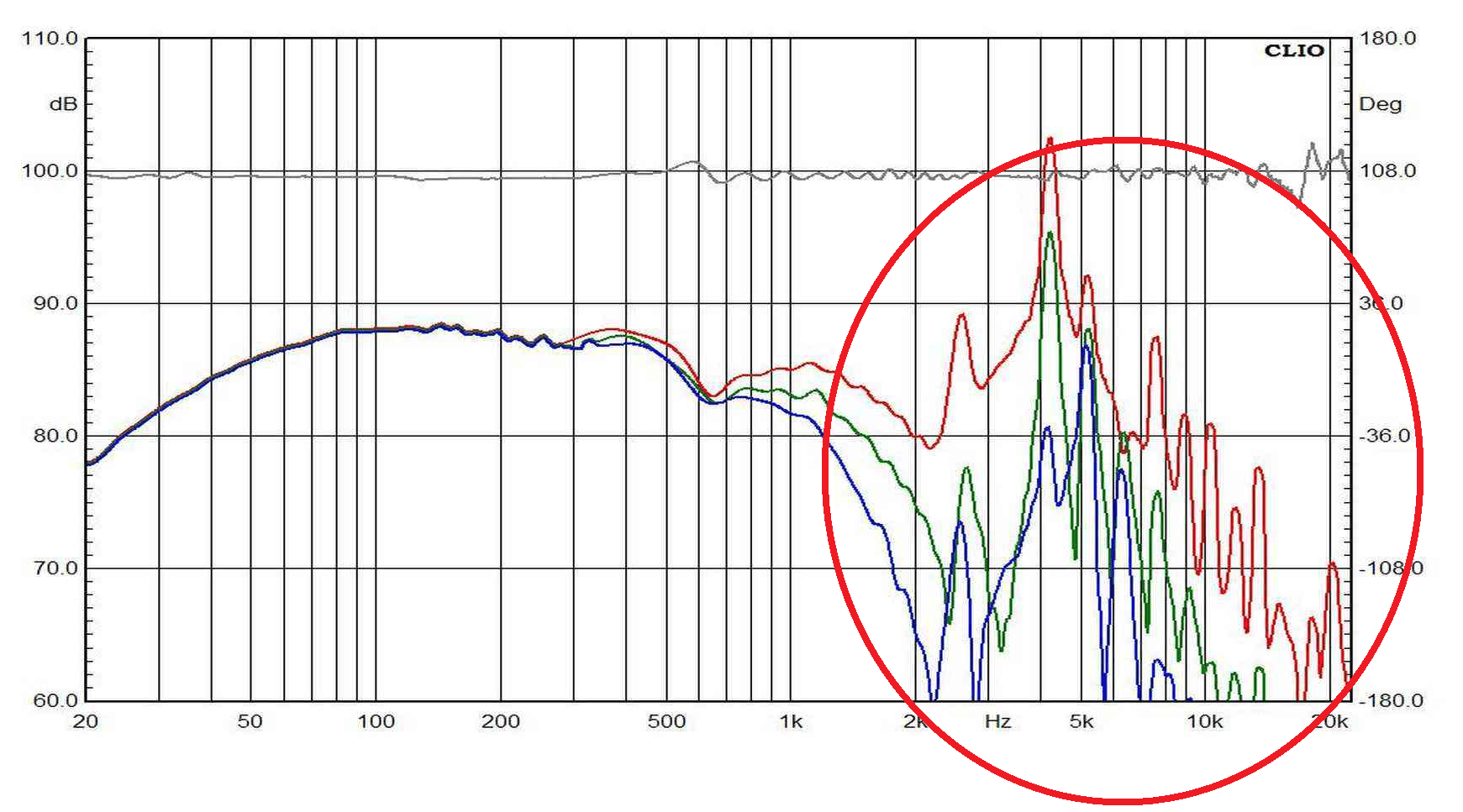

Compare it to this, similar sized Audax which has a more typical high Q resonant behavior like the hard cones drivers, a long ragged tail above 2K that use a long time to die out in amplitude. this peak would likely deserve a notch filter to not be noticeable if used in that bandwidth. Still the amplitude is not as bad as hard cone drivers.

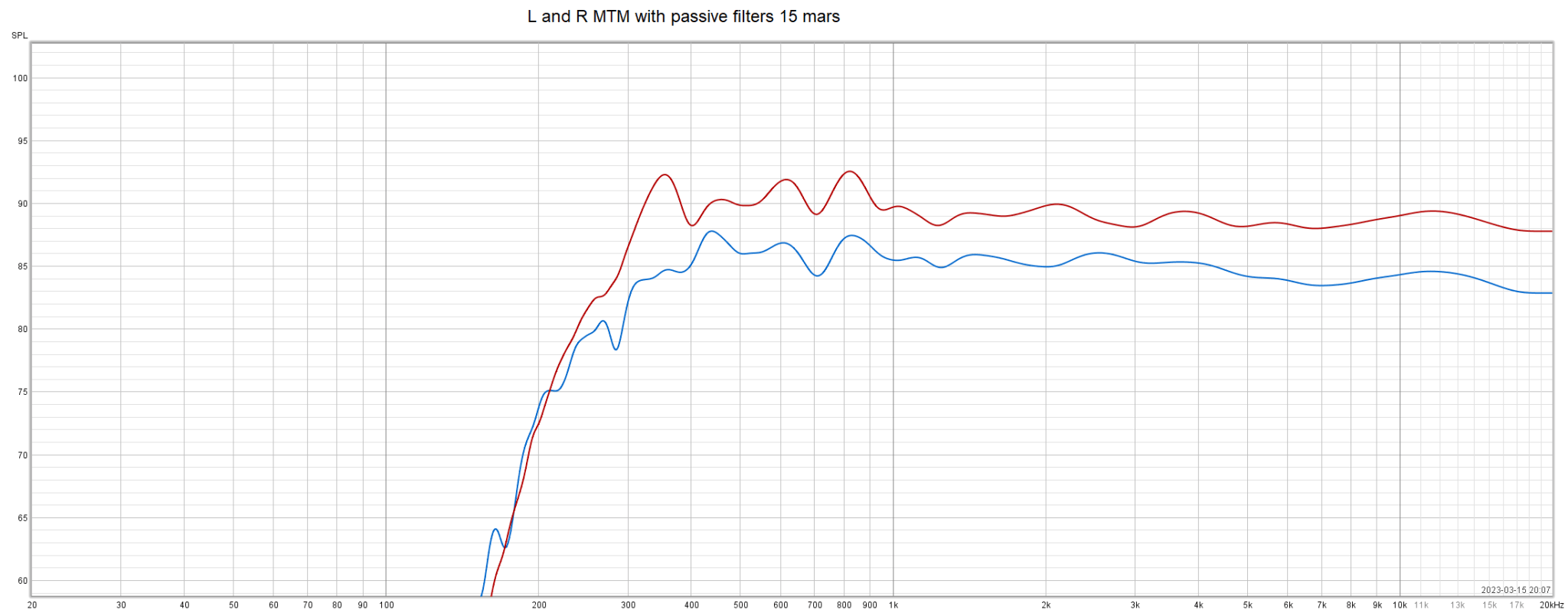

Its 1 Audax HM210Z10 and 1 Mundorf AMT, mesaured in my room from 1 meter ( acoustic timing reference: Timing offset 4ms (1,372m) Whatever that means)
Havent used 2,83 Volt in mesaurements, but use the same signal volyme. ( don´t know how to get exactly 2,83 V)
The last pic is a mesaurement from the Left and Right MTM with the 2 different passive filters, one of them is the autual xover in the VituixCAD fil, even if VituixCAD show a different response. ( Ivé separated them for more easy study)
Do you mean this at The Audax Z10 ?
Or this at the Seas

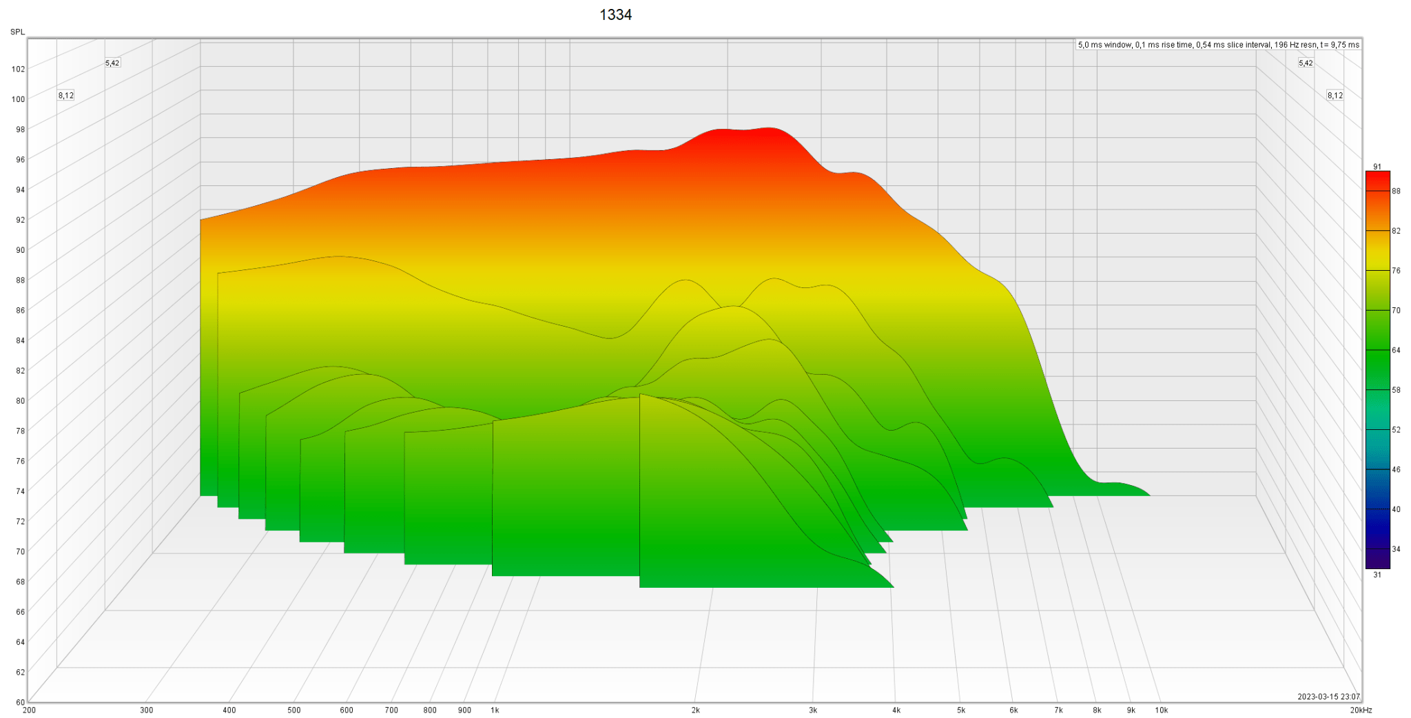

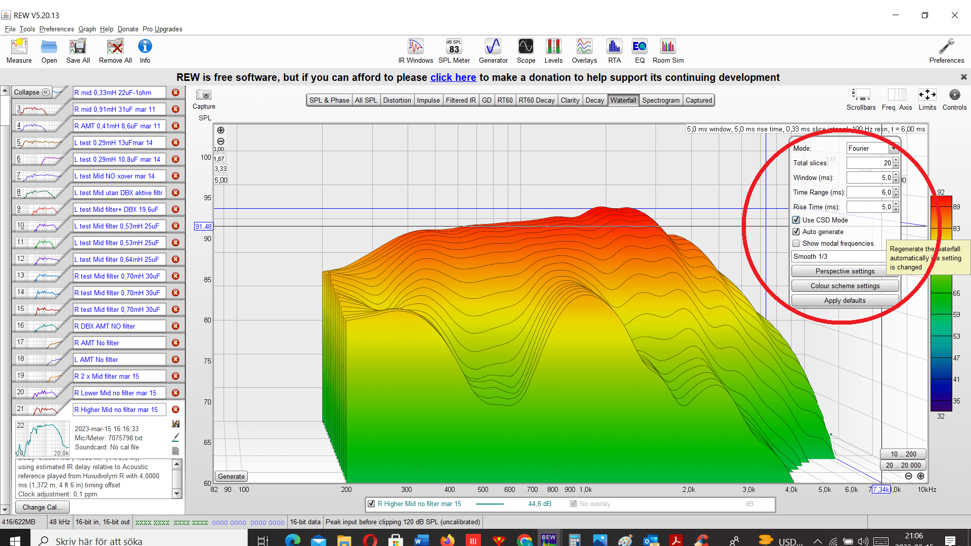

I venture to guess that is not a outdoors measurements with huge space around or a anechoic chamber?
If not your response gating is way too high according to the pic, to get much info from the CSD when it comes to the resonance behavior. you will have a lot of time for artefacts to creep in.
try a gating of 5-10 ms.🙂
I have found the setting for gating i REW, what settings do you recomend? ( Settings in red cirkle)
John
Try lowering rise time to 0,1 ms
Time range can be longer, i use 10 ms.

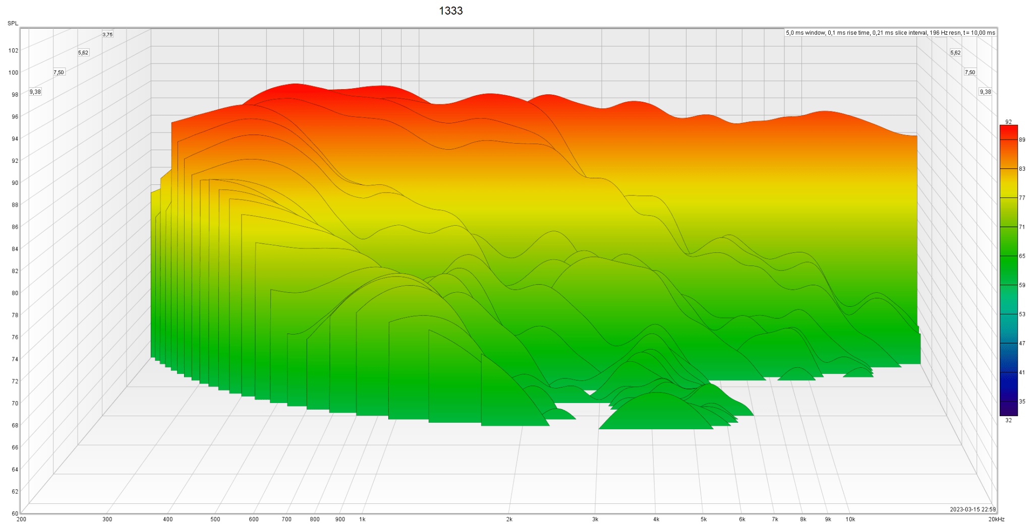

Played a little in REW, and this is rise time 0,1ms, time range 10ms. ( but many other settings is avalible, like total slices and Perspective settings )
But mesaurement is from 1 meter on Left MTM with passive xover how works from 340 hz and up, crossed at ca 2K
And this is only midrange raw in my room without any xovers also from 1 meter ( i cross them at 2K later)
Don´t know if its good or bad.
Regards John

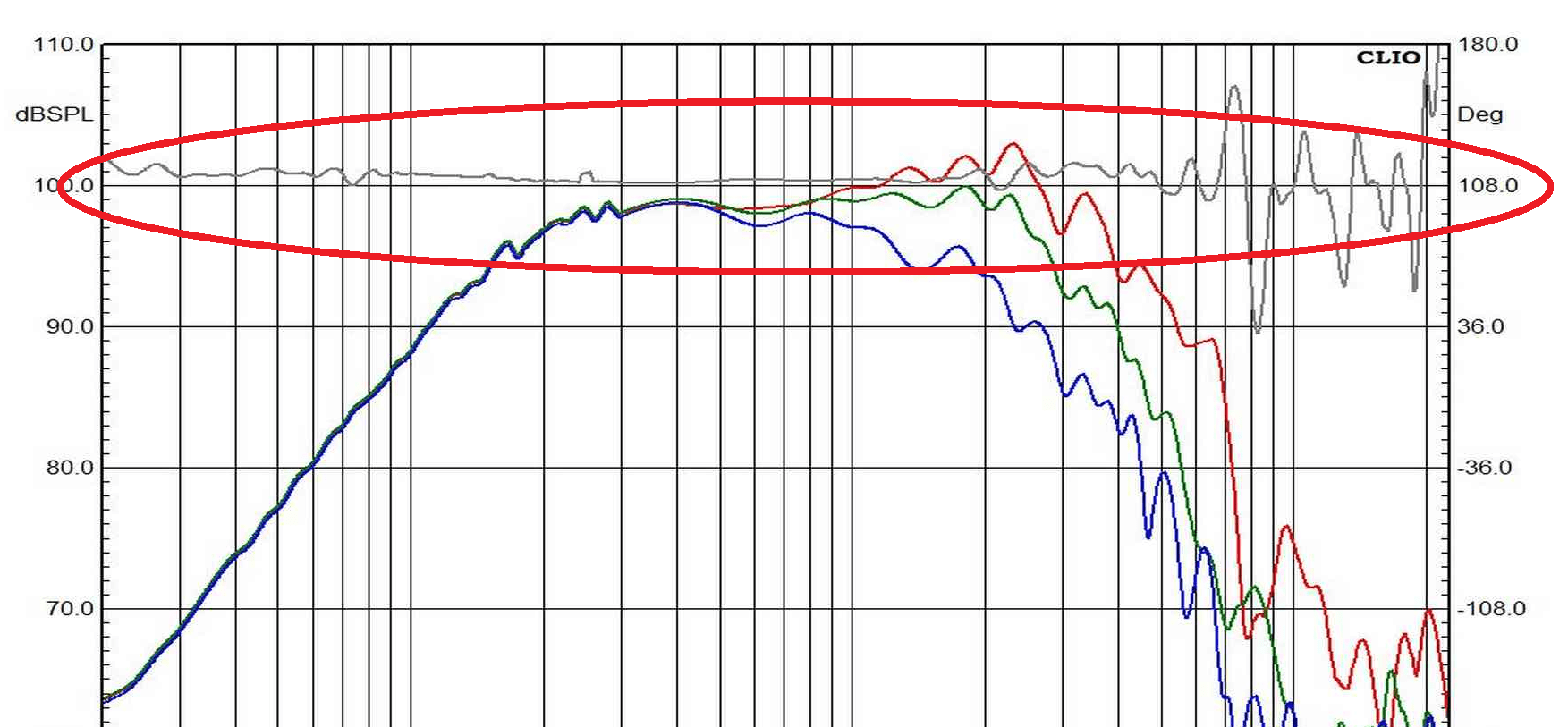

I have experience with that HM210Z10. It has rather bad breakup modes above 2k, which should be avoided if you want a non-fatiquing sound. I have crossed it at 1.5k 2nd order with an elliptical slope. Once the breakup modes are buried under 10 dB compared to average system SPL, you won't really notice them.

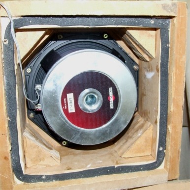

I have looked at 8pe21 many times, and they have some similarities in measurements...Difficult with an octagonal shape only, how did you do a nice mounting?
