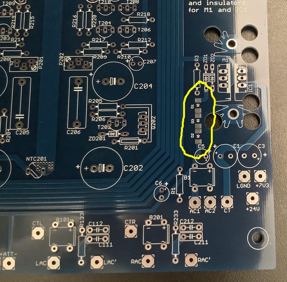

- there is no surface mount part left for you to solder; if you're speaking about 1N4148 in parallel to input relay coils, those are through-hole, leads bent ditto to body, with fingers
- yeah, no need to isolate M1, in your case, since no IC1 needed; you can also use single 24Vac secondary small Donut - no need for centertap
- instead of 220R Pass-approved resistors, feel free to wire two dozens of Blue LEDs, wherever you want

Roger that on no need to isolate M1 when board is used without a remote control. I'll be sure to add blue LEDs as appropriate
All donuts are 10VA:
AN-0124 - 10VA 24V (1 piece)
AN-0115 - 10VA 15V (2 pieces)
I'll be sure to follow placement advice. I'm planning the 3U 400x400mm Pesante chassis with an added inner base plate.
The diodes I am referring to are D1, D3, and D2 adjacent to bottom edge of the heat sink as shown below. It appears they are part of the relay power supply. Without mounting these, it appears the voltage will not reach the relays. Are you saying these are not necessary?
