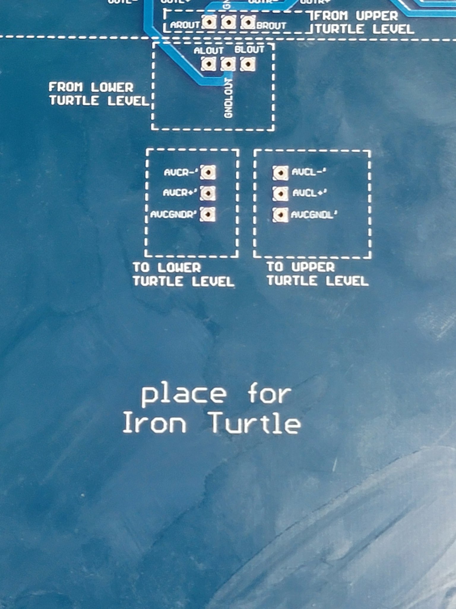

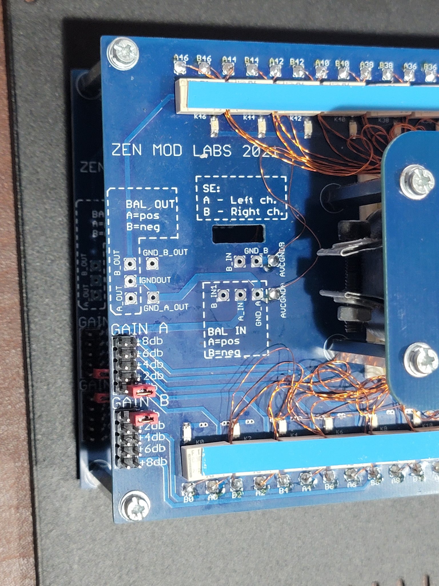

I am ready to connect the turtle to the motherboard, so here is my dumb question of the day.
On the MB there are connections for AVCR-, AVCR+ AND AVCGNDR but on the Turtle there is B_IN1, A_IN AND GND_A. I assume that AVCR- goes to B_IN1, AVCR+ to A_IN and AVCGNDR to GND_A.
TIA
TIA
3 short wires (bare, leftovers of resistor legs or diodes or thin wire) goes straight vertical (no twisting) from MoBo pads framed as "TO LOWER TURTLE LEVEL", to lower deck of Iron Turtle [B_IN1, A_IN, GND_A]
solder them from MoBo bottom and in between two decks of AVC
3 long wires (insulated thin solid core) goes straight (no twisting) from MoBo pads framed as "TO UPPER TURTLE LEVEL", routed through rectangular hole in lower Turtle deck, then slightly leaned to upper deck of Iron Turtle [B_IN1, A_IN, GND_A]
solder them from MoBo bottom and from top of AVC
same logic applies for output sets of wires
thin leftover wires from pads [A_OUT, B_OUT, GNDOUT] from lower deck goes short way straight vertical to [ALOUT, BLOUT, GNDLOUT] on MoBo
long insulated thin solid core wires from pads [A_OUT, B_OUT, GNDOUT] from upper deck goes slightly leaned but straight-no twisting to [AROUT, BROUT, GNDROUT] on MoBo
I know I have several pictures specifically saved for that, but in this moment easier to write than "systematic" search in my pc - can't remember how I called them

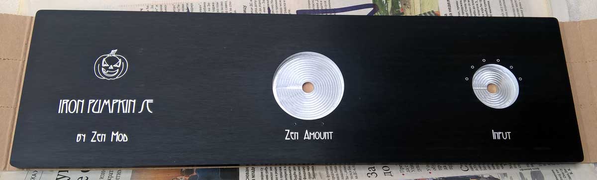

I just placed an order with Antek. Before I place my Modushop order (400x400mm Pesante chassis), do you have a DXF or DWG file with the nice custom engraving for the faceplate that you've previously posted?
