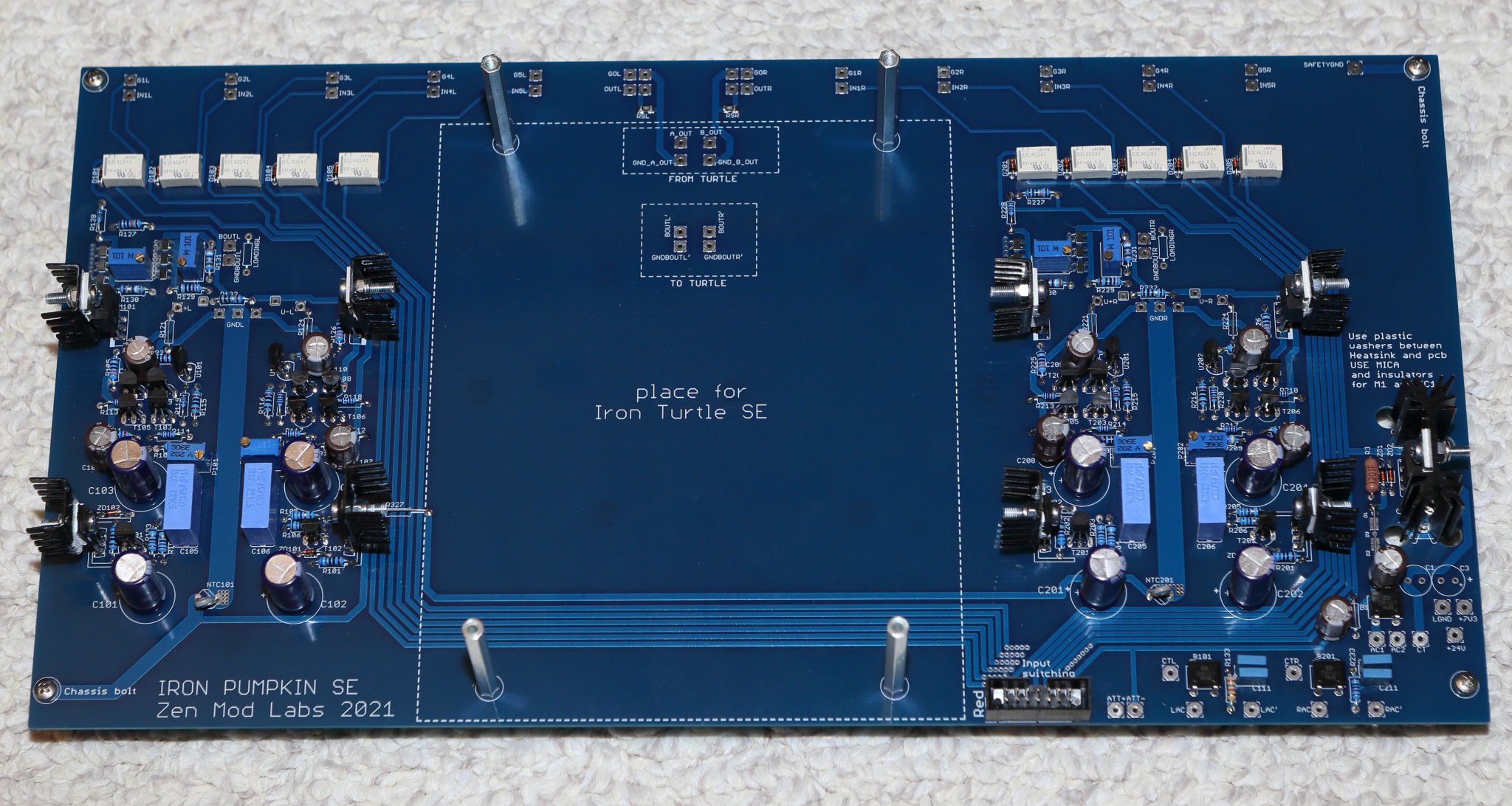

Here it is, all populated. Board is cleaned and solder joints have been inspected. Next steps are to apply power, set bias/offset for each channel, and then check the relay power supply. Have to order the chassis, too.
first set pots in CCS portion of JFet buffers to max, confirm with ohmmeter across parallel 39R resistors
then power up, set rails to 12Vdc +/-
then buffer Iq to 20mV across 1R
then output DC offset with pots in signal part of JFet buffers
then you're good with trimpots

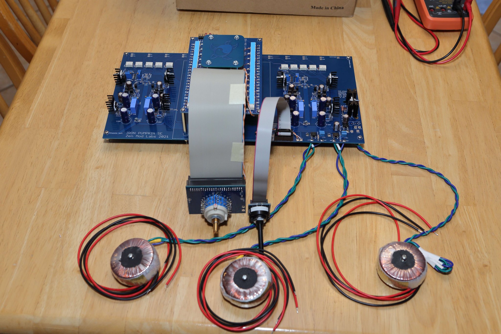

Voltage tests on each channel went well. Got rails dialed in easily - they are nice and stable with no "lag time" between adjusting and making readings. jFet bias was also nice and easy to set at 20mV and seems just as stable as rail voltage. Dial it in, hit the target, and it's done. Then I got offset adjusted down to +or- 0.05mV. Adjusting offset seems very sensitive and seems to want to move around just a little. Overall targets achieved. Haven't powered up the relay section yet.
think mV, not necessarily decimals
if you get it to +/-0.5mV, just leave it and re-check in 10min, re-set if needed and you're done
Pass DIY Addict
Joined 2000

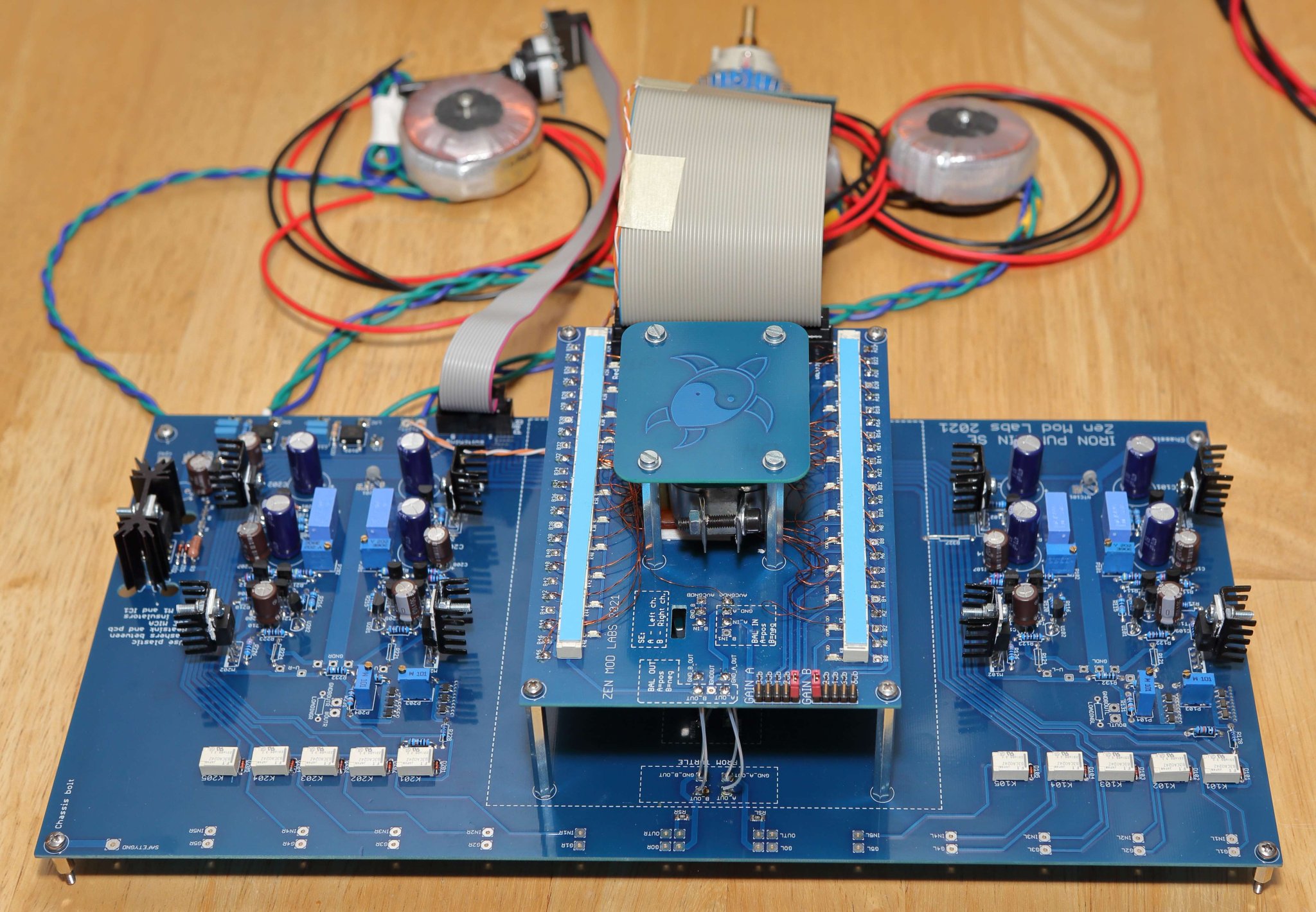

Ha, that’s why I stopped fiddling, I was clearly below 0.2mV so I stopped. Relays for input selection work well, too, their power supply is 23.75v. Next up is connecting the transformers…

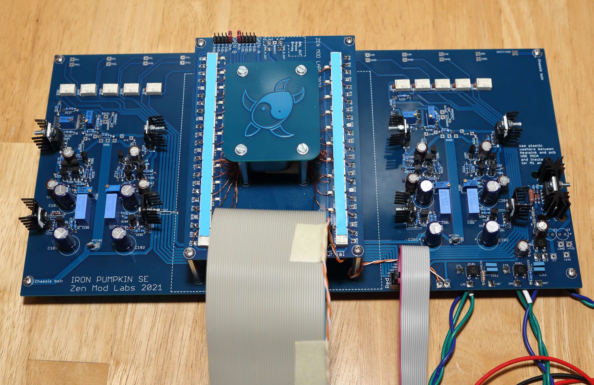

Got all of the assembly completed and everything seems to check out. I like the little red indicator LEDs in the Turtle board, I thought those little critters were resistors. All that I need now is a chassis.
Pass DIY Addict
Joined 2000
I'm honored to receive my first ever "Fugly" from you, Zen! Not sure if it will sing before the chassis arrives - I'll have to see if I have a board to screw things down to prevent mishaps while it's naked... I can't wait to hear it!
