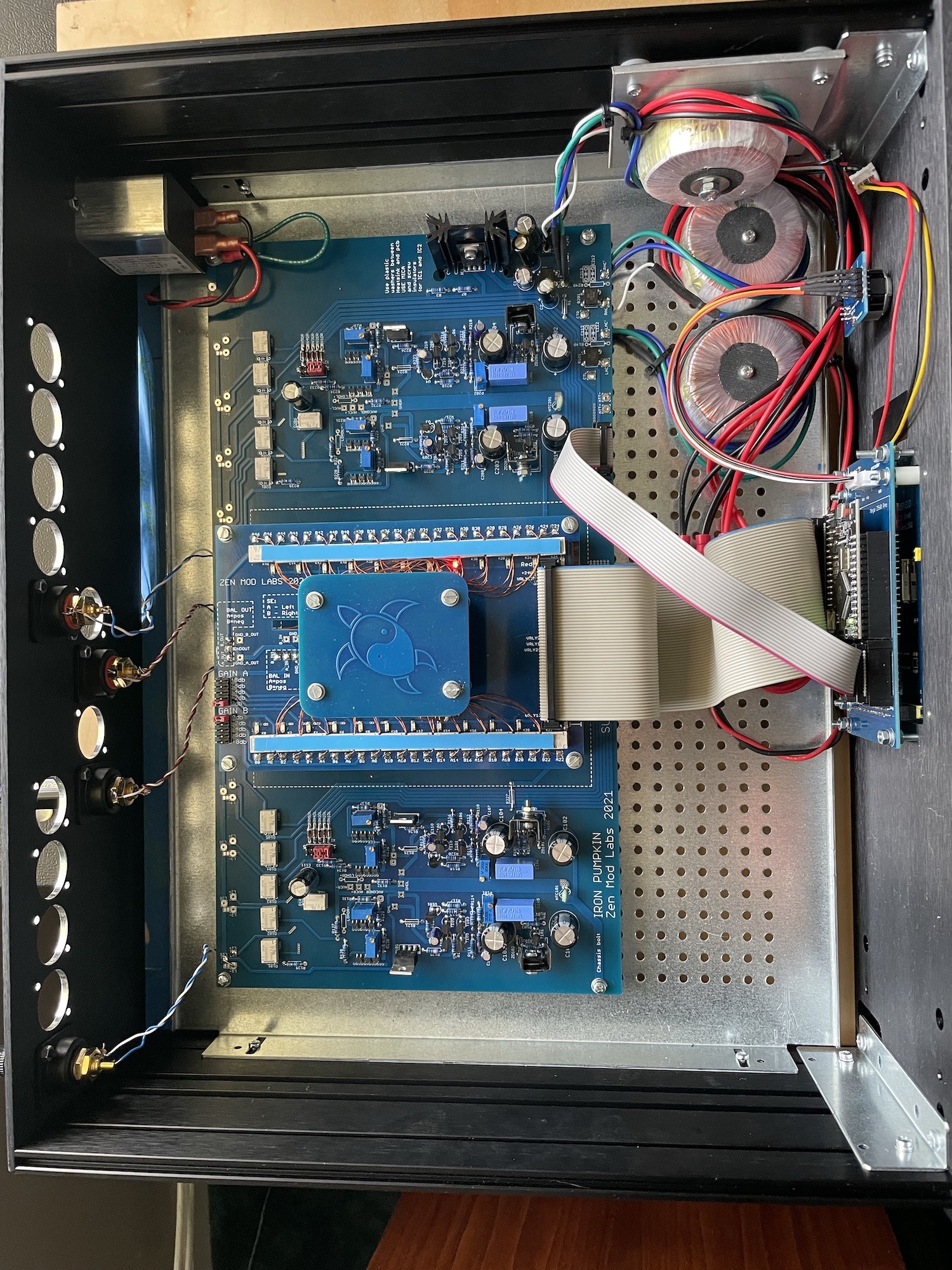

I wrote briefly about my Iron Pumpkin here, but this thread seems like the right place for a picture and additional words.
I’d like to write a few notes about building this thing, because I found it, while rewarding, a little bit stressful. Zen Mod was patient with my questions throughout, but perhaps I can help by attaching a list of all the parts I ordered. I got most stuff from Mouser, but a few things from DigiKey. I
If I had it to do over, I’d:
Because I’d soldered all three transformers directly to the board, fixing my inevitable mistake (soldering every accursed BC transistor in the wrong location) was a much bigger PITA than it might have been otherwise. I suppose the flip side is that if I hadn’t made that mistake, it wouldn’t matter. So there we go.
Setting the power supply is pretty easy. Adjust pots 1 and 2 until you get the right V+/- voltage. If you can’t, well, something’s wrong.
Setting the buffer is a tad more involved, but not difficult.
Then do this:
The logic unit is not powered by either of the flat connections. You’ve gotta wire ground, 5V and 24V from the big board to the display unit. I’m embarrassed by the amount of time it took me to figure this out.
Once that stuff is done, you can wire up inputs, outputs and fire it up. And grab a chair. And rejoice.
- Connect the transformers with some kinda quick connect like Faston 110.
- Build the power supplies, test and adjust them
- Build the buffers and set them*
- Build the logic power supply and test it
- Attach the turtle
- Wire up the logic stuff
- Go bananas
- If you haven’t installed the turtle, great! If you have, remove the gain jumpers. All of them.
- Remove all five SE jumpers INXDR/INXDL
Then do this:
- Measuring across each R131, R137, R231, R237, adjust pots 104, 106, 204, 206 (respectively) to read about 28R
- Power up.
- Adjust pot P104 so that voltage across R132 = 20mV
- Adjust pot P103 so that voltage From AVCR- to AVCRground = 0mv
- Adjust pot P106 so that voltage across R138 = 20mV
- Adjust pot P105 so that voltage from AVCR+ to AVCRground = 0mV
- Do the same thin on the other channel.

and now, after few dayz of acclimatizing ears and brain, what you can tell about your level of foot-tapping?
care to reveal/elaborate about ZM's major ookup in soldering job, Turtle module?
