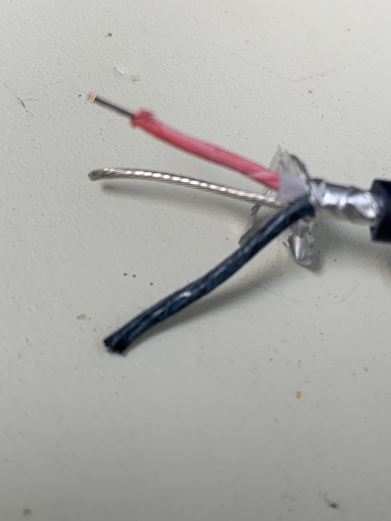

As for the cabling, it is not coax but two wire silver interconnect with drain wire and shield. I'm using the drain wire as gnd. Used this many times before with no issues but will replace wires.
As per my pictures (not the one in this post but the ones in Dropbox), the output is using simple twisted wire triplets for balanced and simple twisted dual wire for unbalanced. However, output from buffers to transformers is the interconnect type wire, which I will change.

The black cable is for negative, red positive and silver wire is the drain wire electrically connected to foil shield, used as gnd.
This is from my cable picture above. This is gauge 20 or 22, not sure. I have some older cable which was used back in the days for P2P in 80’s computer stuff, wire would wrap around chip long socket legs… I believe gauge 30, so very tiny but I don’t know the quality and if the gauge is big enough and good for this purpose….
I already desoldered and XLR inputs and just need to change wire from buffer to transfos.

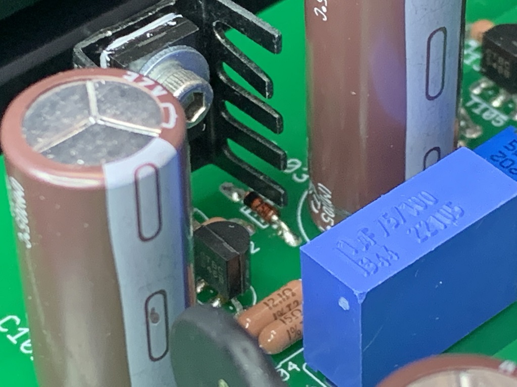

first check both rails on both channels
if anything suspicious - get pictures of gigglywiggly here
good if you get practically flat DC

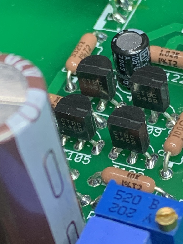

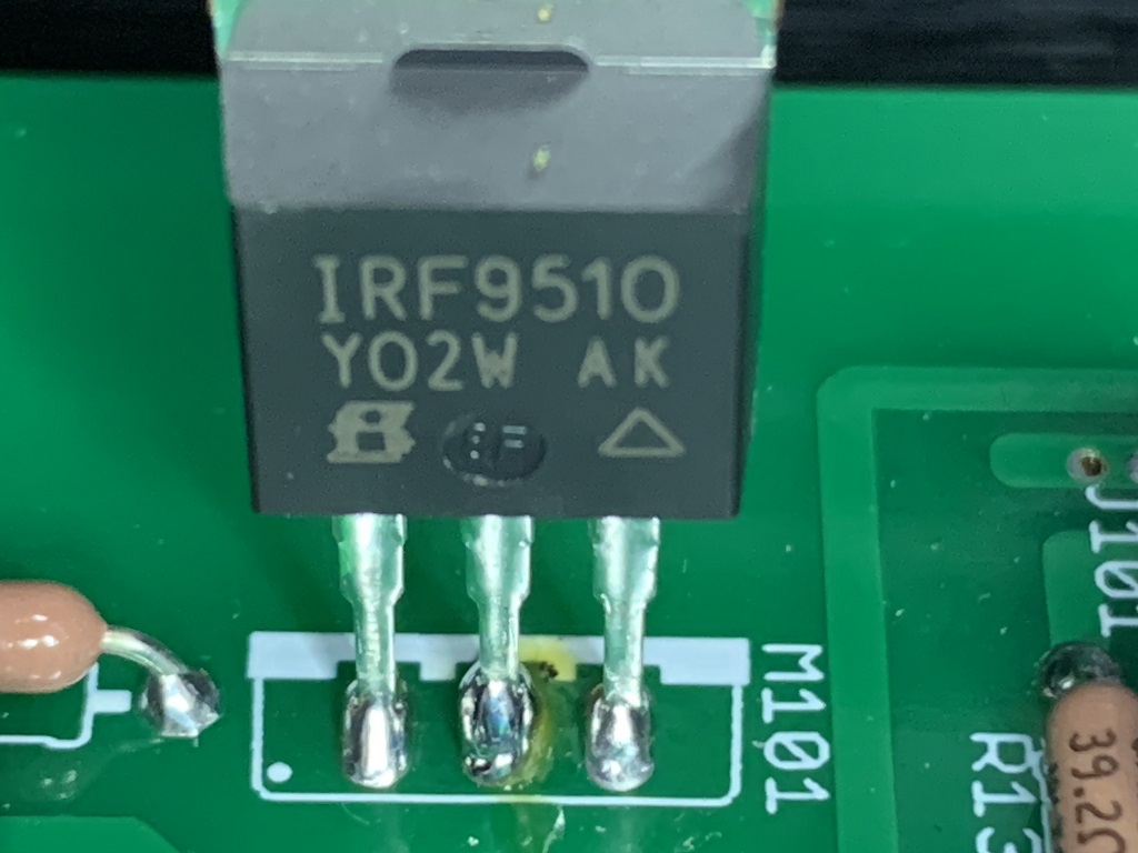

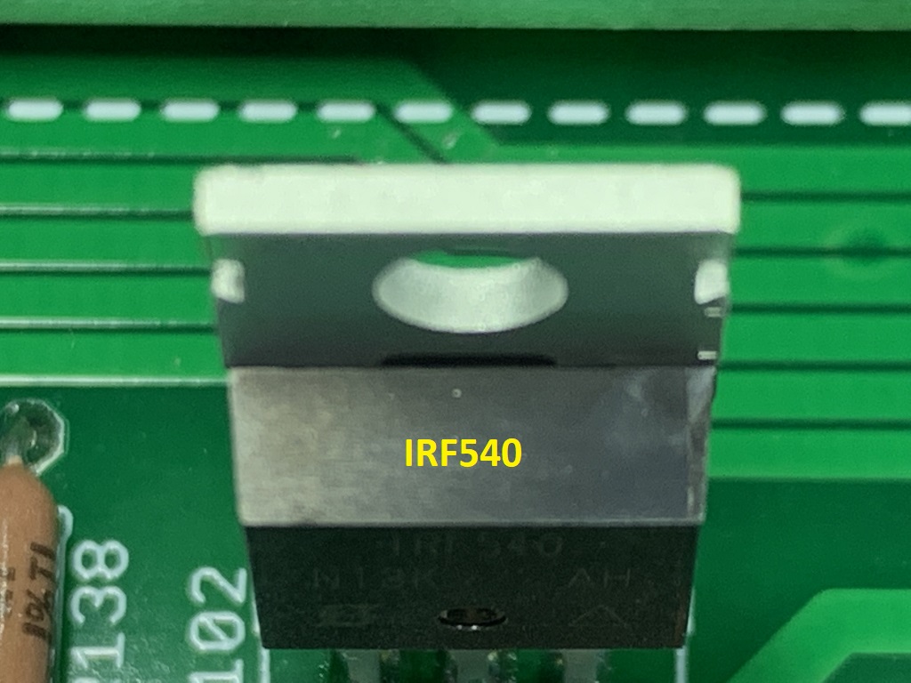

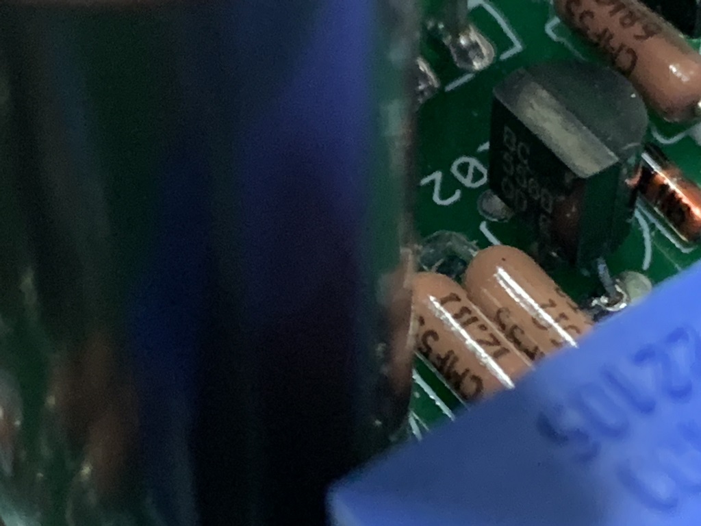

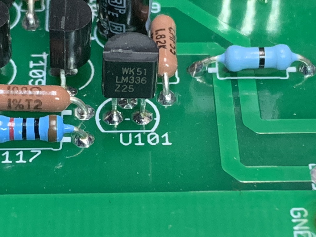

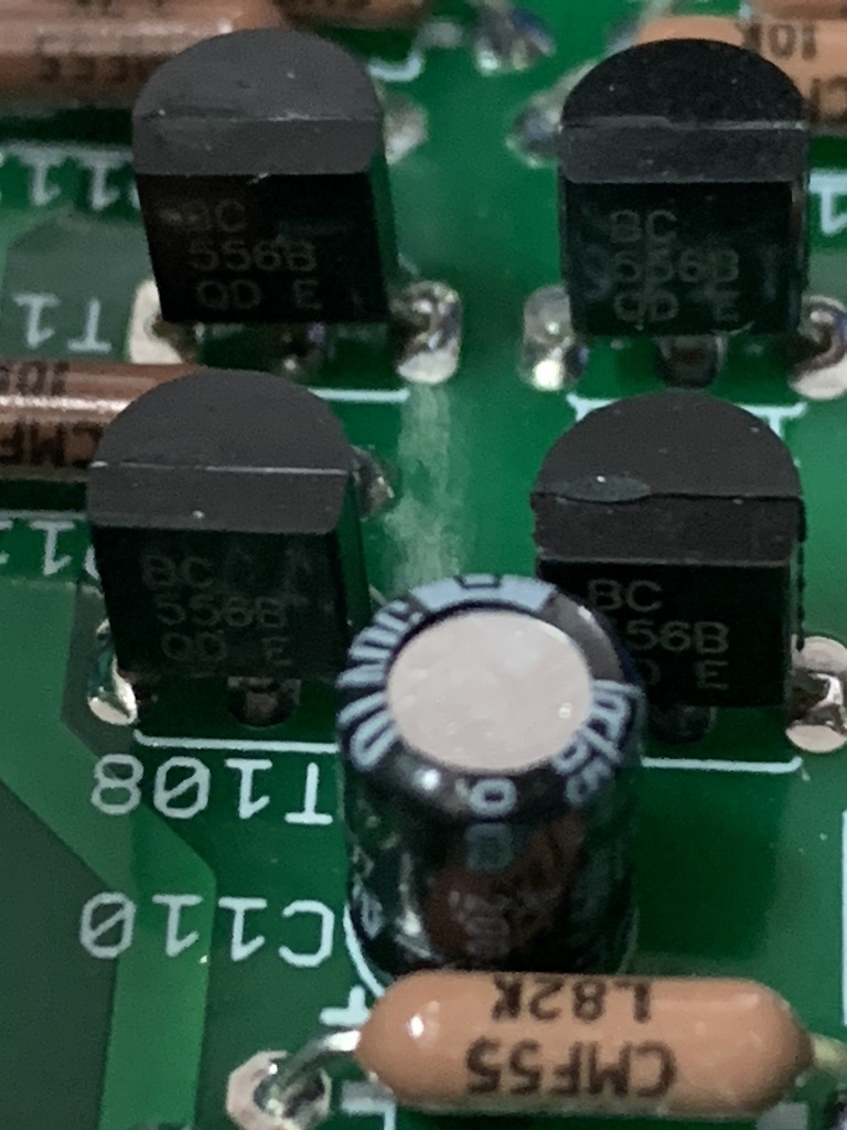

Before I go any further, just want to show you some pictures of the CCS BJTs and Mosfets, just so we know for sure all is good. I was able to grad the part number on them. I followed the silkscreen but don't actually know if they're proper pinout. Do you remember what you sent me if the pinout matches the silkscreen?
Here's for the positive rail :
Negative rail :
Next I'll measure on AC coupling positive and negative rails
Do
Negative rail :
