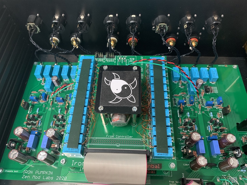

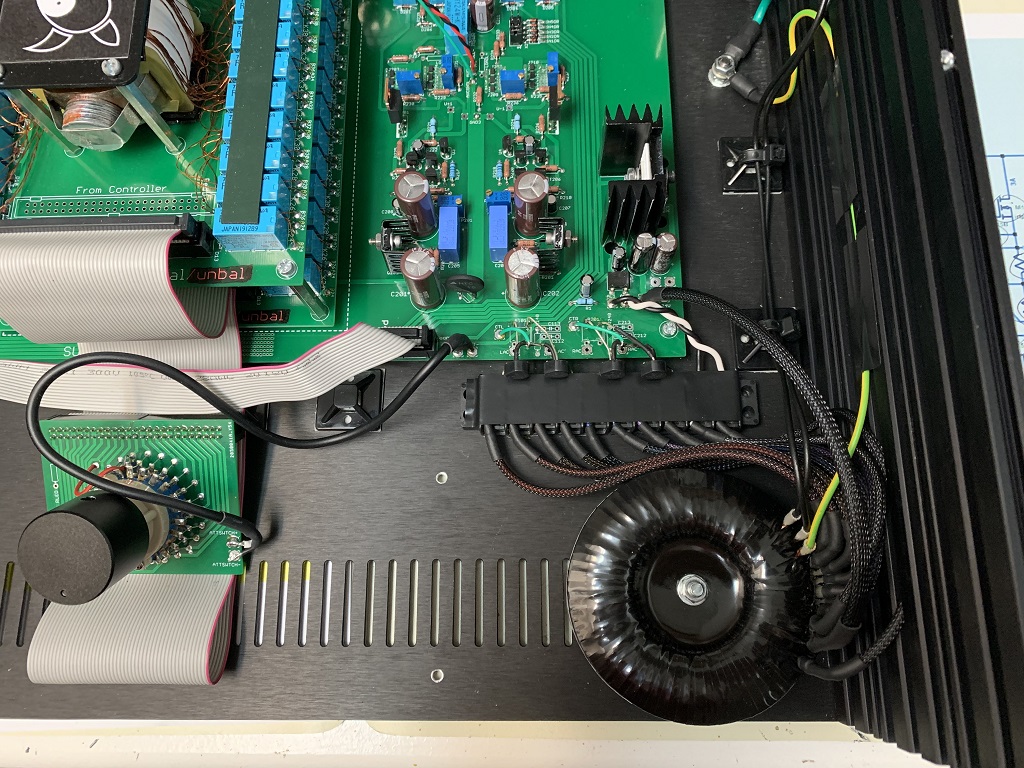

Way to go Do!! Congratulations on your new “quiet” Pumpkin, it’s amazing how important the often overlooked transformer is.
I have all the parts ready to go for the Iron Pre, but maybe I should consider changing course for the Pumpkin instead since the Iron Pre pcb’s are not available.

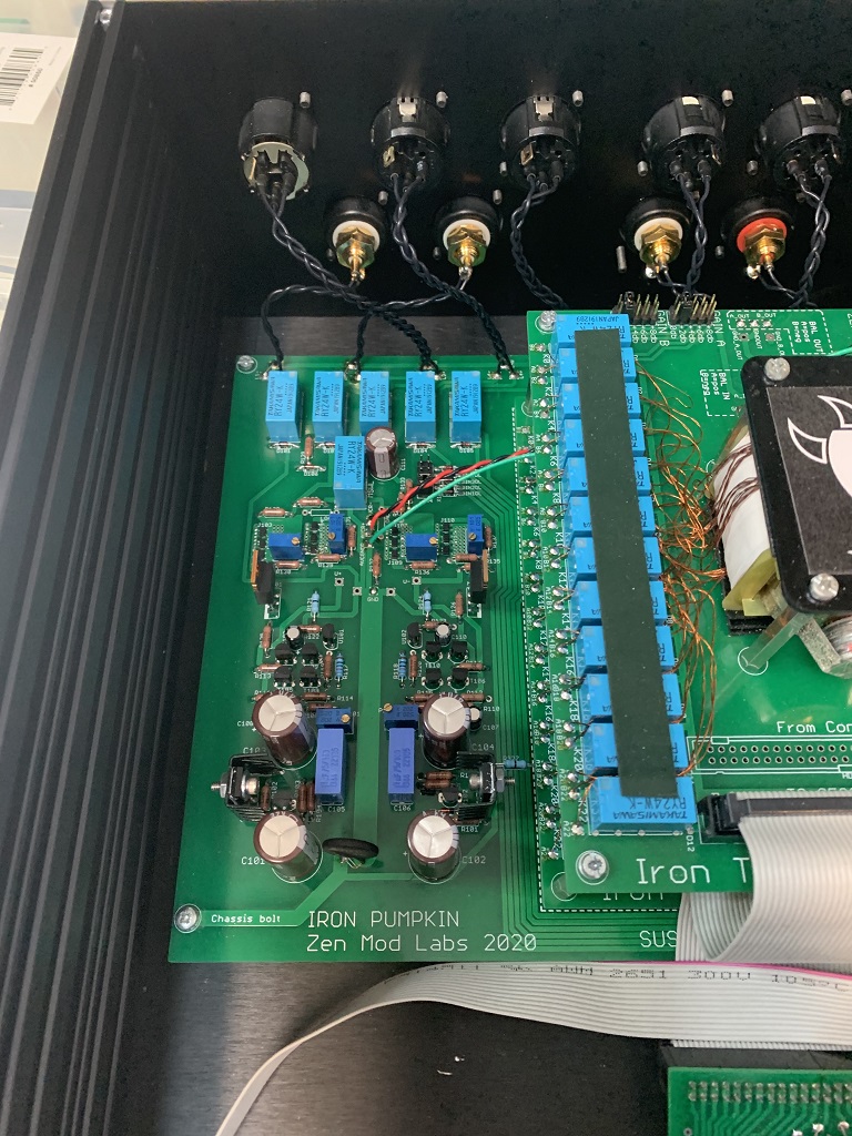

I really thought using R-Core would be so much better because it is a better design, but it is a cheap Chinese design on fleaBay and not a reputable company making them, so there's most likely a lot of corner cuts in the product... I usually buy Toroidy transformers for most of my builds because they're such good quality and price is also very good. I should have done this from the start! Lesson well learned I would say!
This preamp is finally seeing the light after all the hell it went through (customs inspection destruction, transformers, etc...). Now I can finally laugh at all this!

Now that I have it finally working properly, how much for the "lazy old fart" remote control? My relays are 24v. I know some have 12v relays so just want to make sure it’s all good.

in your case, change is simple : make front plate for TFT, mount Logic module (plus IR sensor and rotary encoder) on it, mount it on case, connect wide and narrow flat cable to Motherboard, solder 3 thin wires between MoBo and module; that's it, power On, enjoy
package consisted of :
-assembled Logic module with 3.5" TFT screen, programmed and tested
-IR sensor with cable
-encoder with cable
-fancy Al slab remote control (Apple TV buttons arrangement)
-flat cables for Turtle and for input select
- CAD, pdf and Sketchup files necessary to produce front plate for TFT window (e-mailed)
250E, shipping and Paypal fee included in price
possible even for for first one ..........Vitalica have Iron Pumpkin (bal) first gen, with two channel pcbs
as Logic package was developed later, I also resorted to big Motherboard approach, making physical controls (as you have now - two rotary switches) and logic module absolutely compatible electrically, so matter of choice which controls one will end with
controls in first gen had common Neg Rail (meaning that +Rail for relays is switched) and for Logic module is necessary that +Rail is common, while relay negs are switched
thus we (Vitalica & Moi) needed to make specific changes for all relays in his Turtle ( rotating all diodes parallel to relay coils) and same for all input relays
then some cutting and small wires work on channel pcbs, adding small relay PSU aside, and connecting entire Shebang..... pretty extensive e-mail correspondence to get all that done
anyway, even that is possible, but tedious work if you're not breathing and living solder, especially if you already have Iron Pumpkin singing and now you must butcher it in pieces again

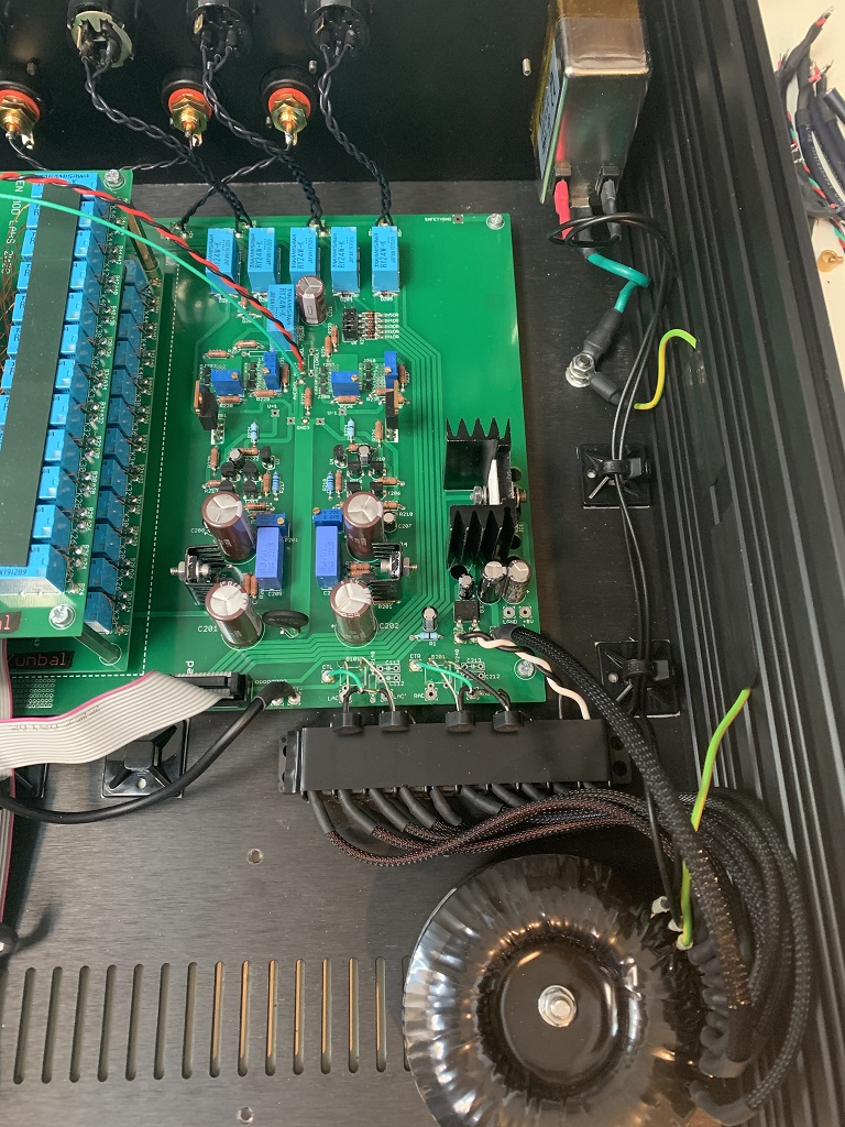

Hi ZM,
I've just finalized all the transformer cable sleeving and will be testing to make sure everything is good, then, I'm totally going for it! Do you have some in stock at the moment?
Do

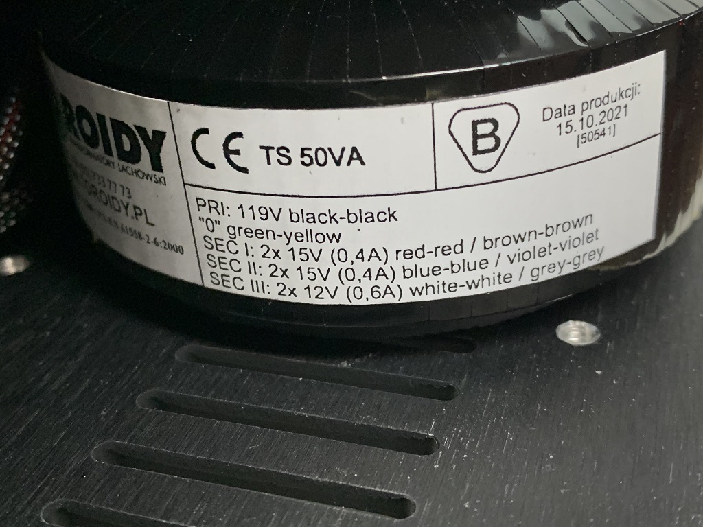

for audio - in this case Sec1 and Sec2 - 20VA is plenty enough....... I mean - as prescribed
for relays/Logic - in this case Sec3 - 10VA is plenty enough....... I mean - as prescribed
better to be exact than abundant, when putting mains xformer in same case with Turtle
Nicely done Do!
Yes, you have to watch out with the transformers as I also just found out.
In my iron pumpkin I have 3 transformers, two toroidy for the pumpkin and one EI 10va for the arduino remote.
The cause of the hum was the small EI transformer,
when replaced with a toroid, the harmonics went 10-20db lower (measured in REW).
One mod that I will try is to add some shielding to the ribbon cables,
I think they act as a receiving antenna for the transformers leakage.
Danny, if you really want to invest some elbow grease in final tweaks - just put xformers in separate box, which you can toss conveniently on the floor
with my custom made xformers , I don't have hum problems
simply - nature of the beast demands best solutions, and there are few different ones - price well worth paying
