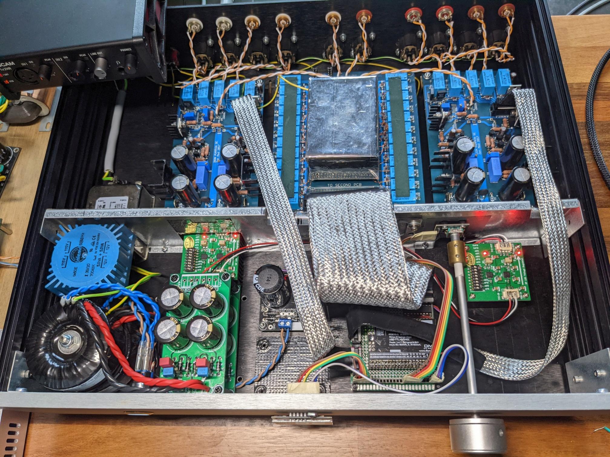

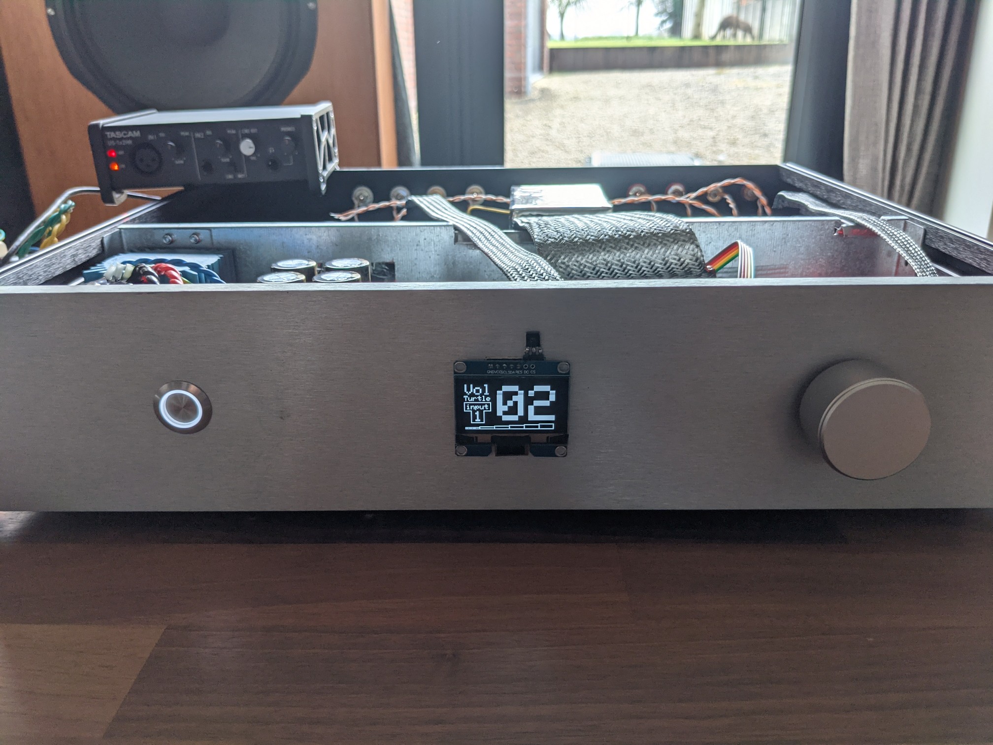

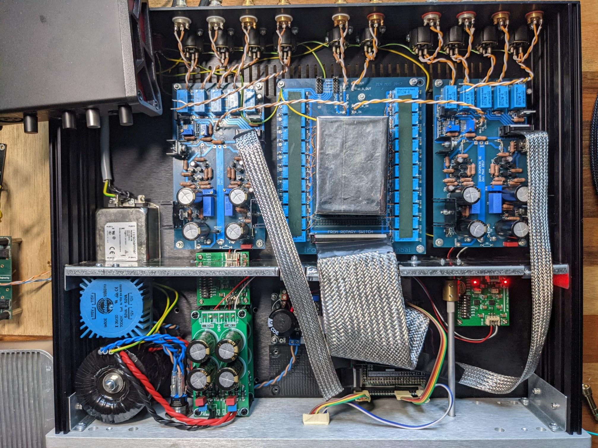

My Pumpkin has reached the stage that the lid can be put on the case 🙂
Here are some pictures of the final version with the arduino remote developed by Berny.
Great sound and ease of use 🙂

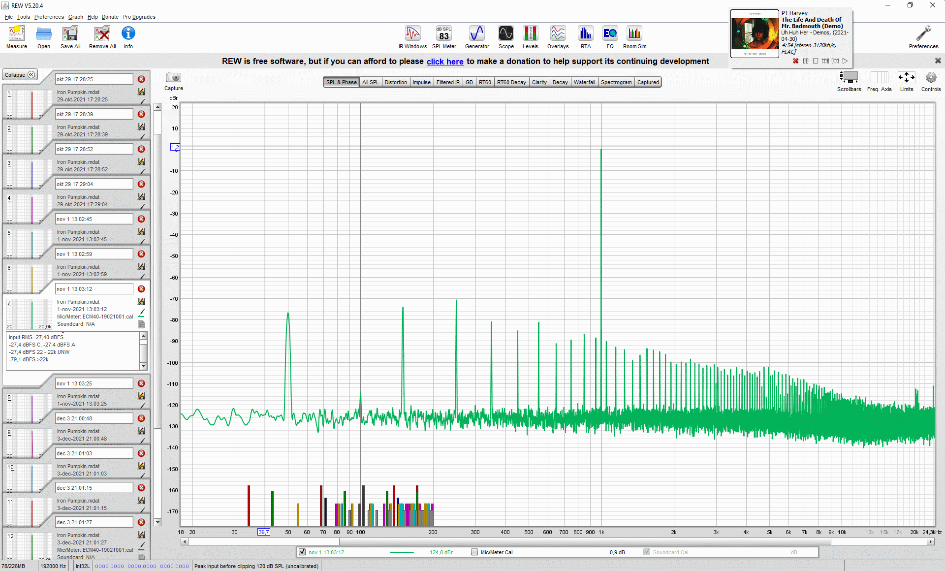

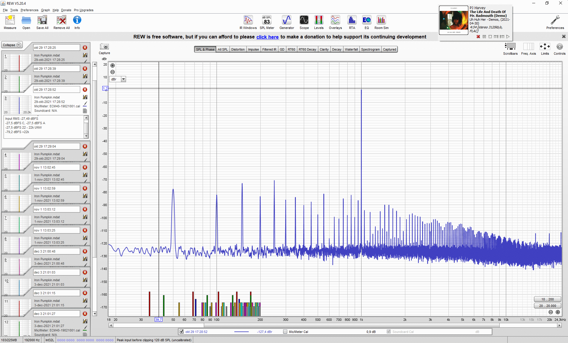

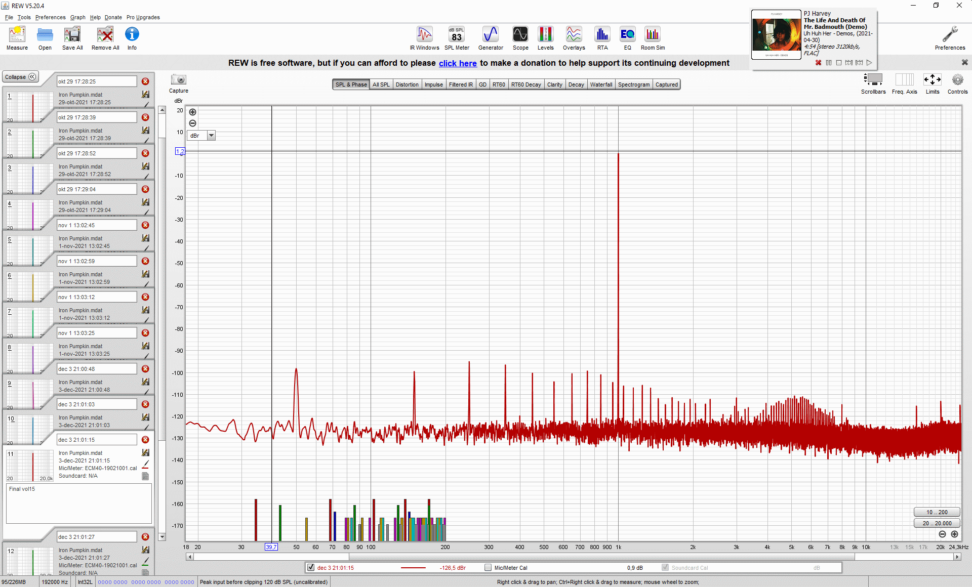

When I installed the remote in the pumpkin I noticed that I had some hum on volumes greater than step 10.
So off to hum hunting, it finally turned out that the small 10VA EI transformer I used for the arduino was the guilty one,
replaced with a toroid and the noise levels dropped 25db !
Here some measurements (vol 15) of three different PS versions:
The first version had R-cores and a small EI for the arduino,
second version still R-cores and a EI, but preregs added before the shunt
third version all transfo's replaced with toroids from Toroidy and Talema, Bingo 🙂

that cute display - it was starting (well, one of) phase of my logic module development
I got software and basic setup from guys but then - I was too stupid, too stubborn and had higher ambitions
couldn't manage with their code, so started learning and with some help, ended with all new code....... also for fancier screen
anyway, considering everything, it wasn't walk on the Beach ...... it took me considerable burst of energy to learn from 0, what I successfully avoided for a decade or so
cute small display: Iron Pumpkin Logic development 05 of 10 - YouTube
