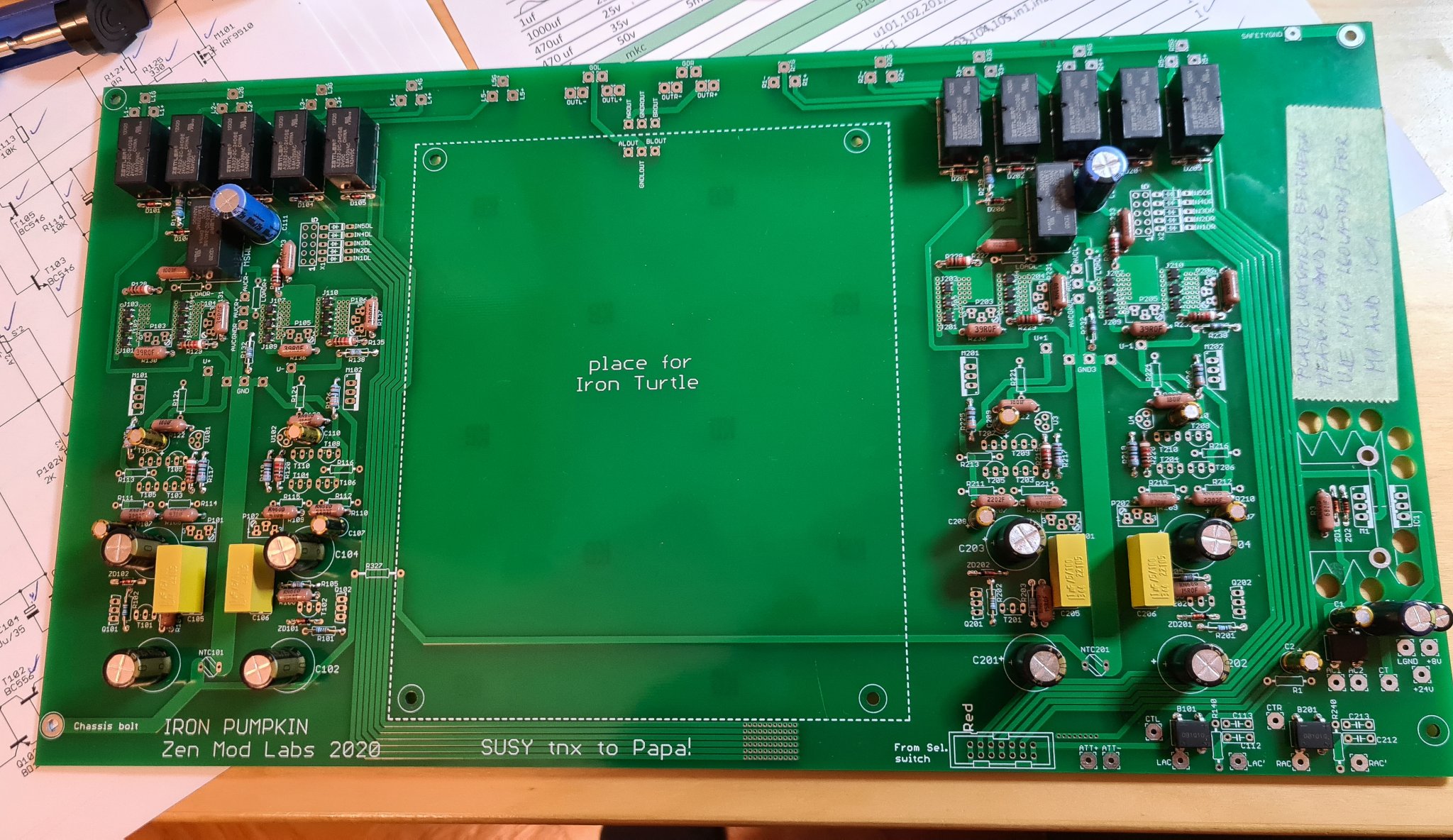

Your Mightiness,
I am about to order the parts and have somequestions 😀
- Zeners: is 500 mW okay?
- NTC 10R: dito, is 500 mW okay?
- What should be the value of C112, C113 and R140? (connencted to the rectifier bridge)
- What should be the value of the optional LoadR and when should it be used?
- R121 (and others) are 0R - just a wire?
- yes
-no, choose them by size - 10mm Dia , I believe you'll find them as "surge limiter"
see https://www.conrad.de/de/p/tdk-b571...egrenzer-10-s153-radial-bedrahtet-419723.html and https://www.conrad.de/de/p/tdk-b572...egrenzer-10-s235-radial-bedrahtet-419728.html
-if you ave Quasimodo, you need to test your xformers; if not, omit them
-only in ase if you want to invoke much heavier load for buffer, thus invoking some higher 2nd ; say that things are starting to happen with values down from 4K3; but - you didn't go for IP because of sweetness...... so don't bother
-value of 0R means - either wire ( take care of isolation in some positions) or fancy resistors with one black stripe; reason why fancy resistors with one stripe exists - robots for parts populating ( industry) are much easier working with resistor shape than with shape of plain wire bridge
Dear ZM,Donuts
- relay side - 10VA 2x12V or 24Vct
- audio - either one piece of 20VA with two 30Vct secondaries, or two pieces of 10VA with 30Vct secondary

Hi ZM,
before ordering the donuts (from Antek) just a quick check: could the audio-side donut also be 2x15v or is a 30vct a must?
Because the relais-side can use both.
Thanks!

rectifier arrangement is with CT
and you're big boy enough, to connect 2x15V as 30Vct

Thanks, I know, and I have done it that way for most of the parts.
For the rest (and missing parts) a sligh bending of the parts legs right behind (below) the hole helps keep them in place 🙂

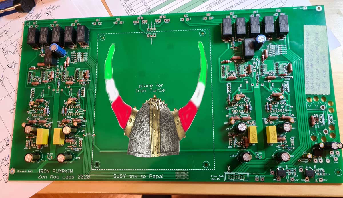

I'm preparing special iteration, common for Italian and Scandinavian market
dedicated biiiiiiiiig pic in central part of pcb
Just kidding. Build looks lovely!!....where si****s means what? 🤔![]()
maybe missed some posts, but what transformer(s) have you chosen? (Brand/type)?
That’s heritage right there!! Almost, only missing this 🙂I'm preparing special iteration, common for Italian and Scandinavian market
ThanksJust kidding. Build looks lovely!!
Anteks, 1x 12v 10VA, 2x 15v 10VA, they are under way, but USPS needs about 3 weeks or so
