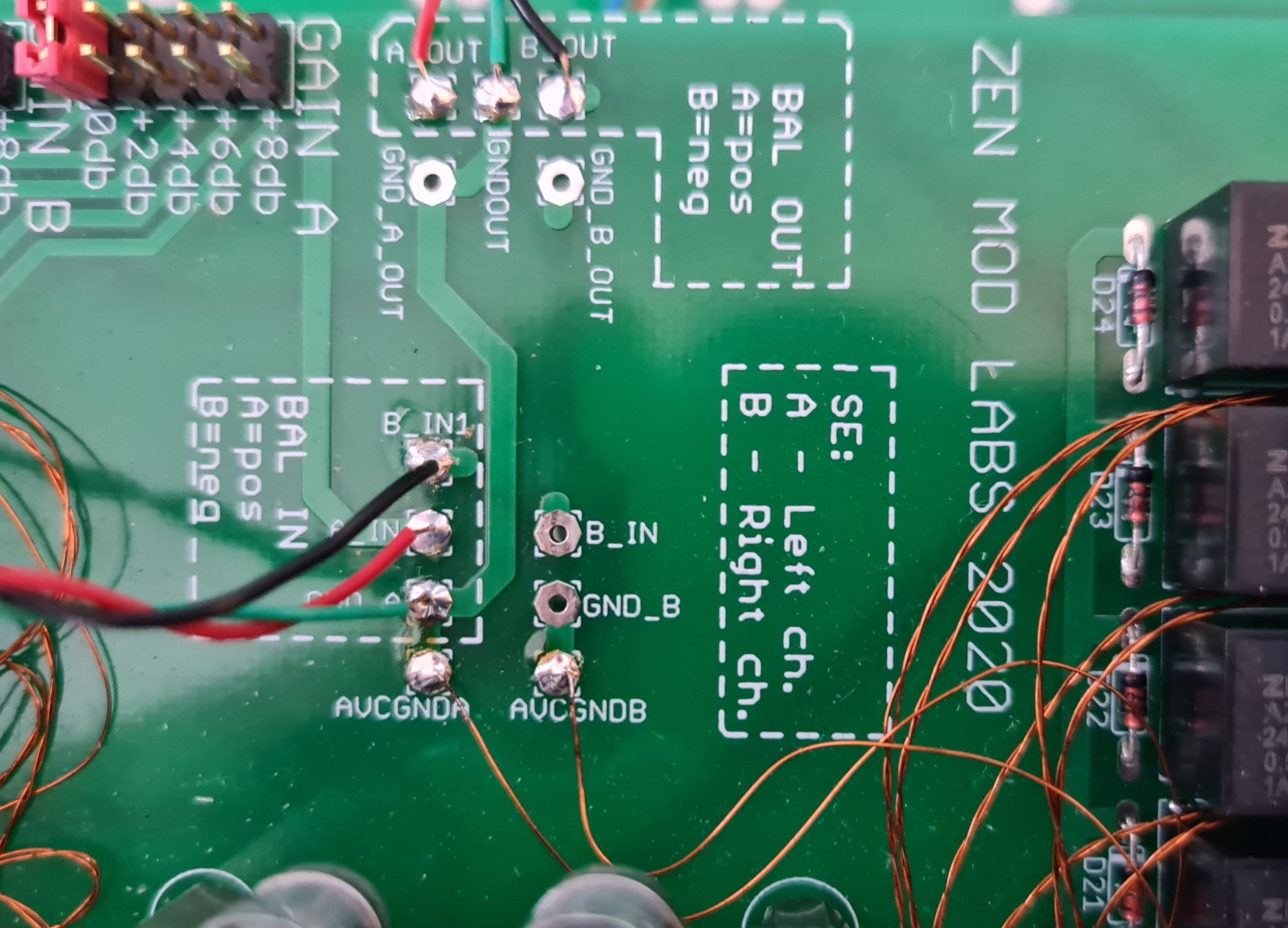

do not forget, when doing final wiring, put tiny wire short between GND and Neg input pads, on each input you're wiring for SE
not so necessary, but better to have neg buffer input grounded, instead of flappin' in da Breeze
for your case, that would be inputs 1, 2, 3
so short between L1- and L1G
same for
L2- and L2G
L3- and L3G
R1- and R1G
R2- and R2G
R3- and R3G

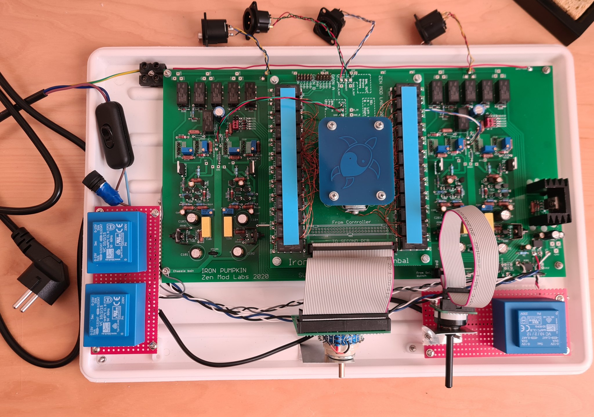

First time in the system - lot of hum, even if the Pumpkin is not turned on. After turning it on even more hum.
There must be a ground loop, I think. I connected the mains ground to the "chassis bolt" (don't have a chassis but it seems to be the main gnd connection), and to the safety grounding point on the pcb.

those EI xformers are most likely culprit - they're emanating huge magnetic field - practically 95% of print xformers are made with cost-cutting approach, so they're simply bad in that position - move them 1m away and you'll be good
I had one iteration of Iron Pumpkin with two EI xformers in case, proximity, and everything was silent - but those xformers were heavy artillery , bespoke pro quality
edit: considering that you now (in test setup) have common xformer for both channels, that means that channel GNDs are tied ...... while in proper arrangement everything is dual mono
feel free also to remove any connection to pcb Safety GND/Chassis - maybe you'll remove hum or decrease, that way

To the xformers, I don't have a common one for both channels, left you can see the two separated 2x15v xformers for the two channels and on the right side the 2x12v relais xformer.
All relais are working; in the penultimate position there is a faint beeping coming from somewhere on the pcb (power amp off) 🤔
I could reduce the hum with removing the safety earth from the pcb and with some shielding of the xformers (but it is still here); with increasing the volume the hum gets quiter from the position 0 to 4, here almost disappears, but f.e. at position 5 there is more hum again.

Checked everything and found a $%×=€£%%&^ short circuit in one of the xlr's, a hair thin wire.
Grounded the unsused inputs of the SE buffers.

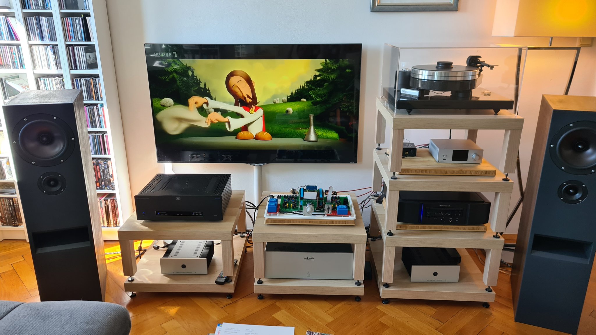

The hum is very very quiet, one can hear it near the speakers - it will go with the donuts.
And - it sings, it sings beautiful 😍 It is unbelievable clear, detailed, with huge dynamics, great mids, crisp highs and deep and dry bass... the instruments are placed wide and deep on the stage. I'm speechless and get goosebumps
