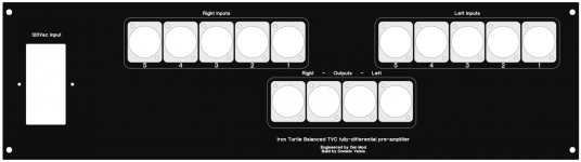

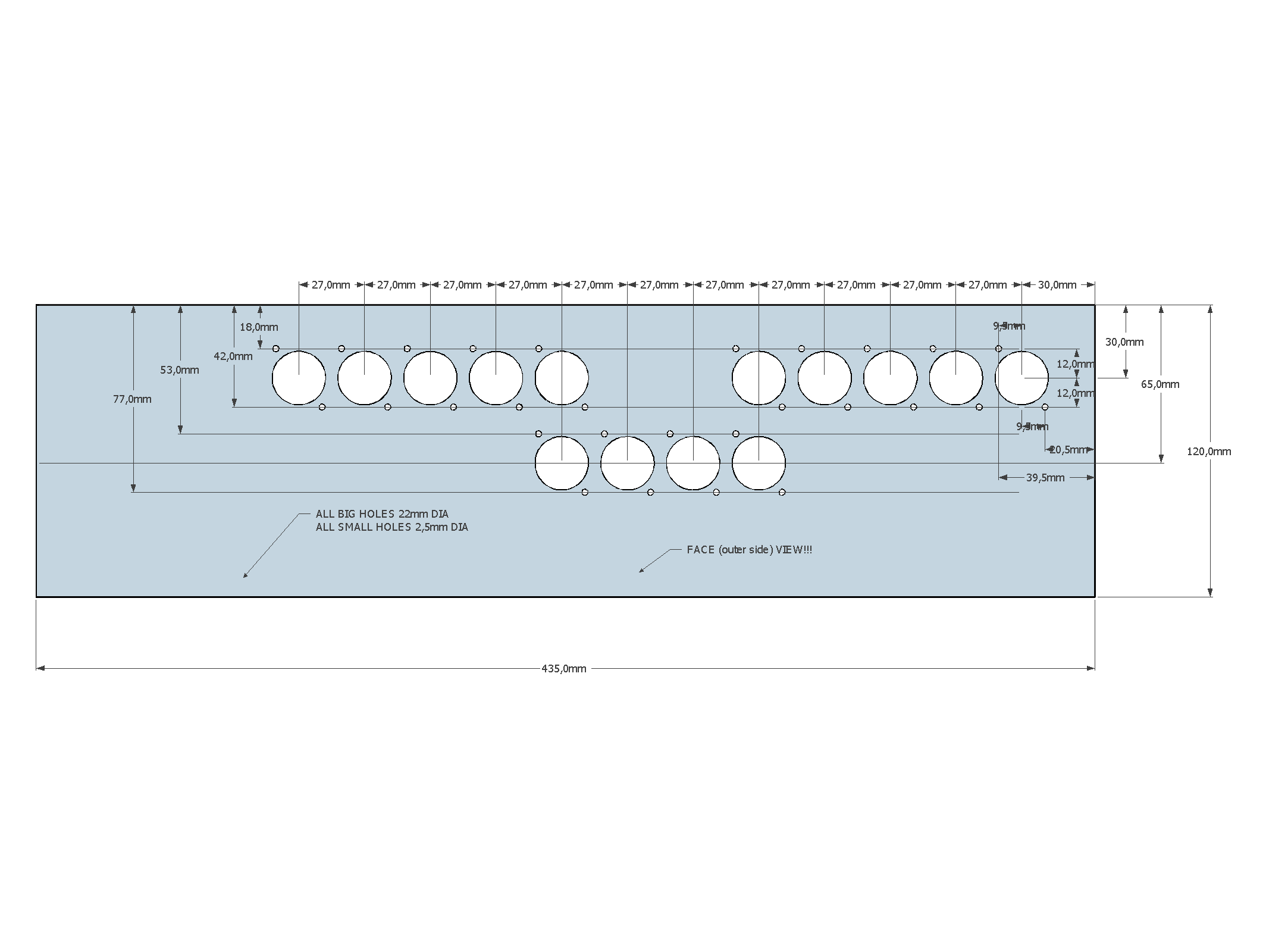

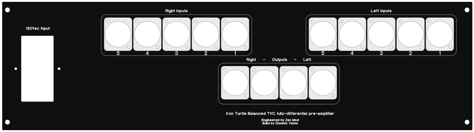

I believe that I sent you drill table for one I like most
it is synced with MoBo
ok, just in case, attached
edit: applicable for Neutrik connectors, both XLR and RCA,
ok, thanks!

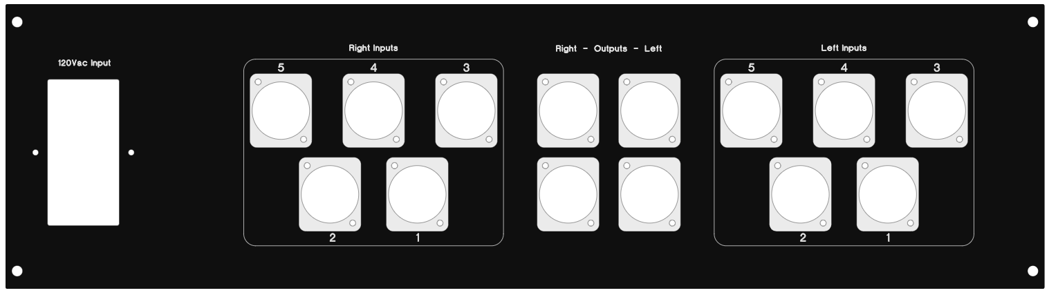

Let me see what I can design on Front Panel Express with your template. I'll see if I like it.
Do
Do

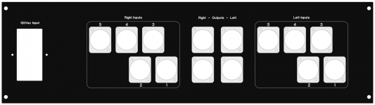

Since I have two RCA inputs and 3 XLR inputs, I just wanted to group them and I measured the cable length inside, it is all fine.
I'll take your panel design and put it in FPE to design it in there, then I'll compare.
Do

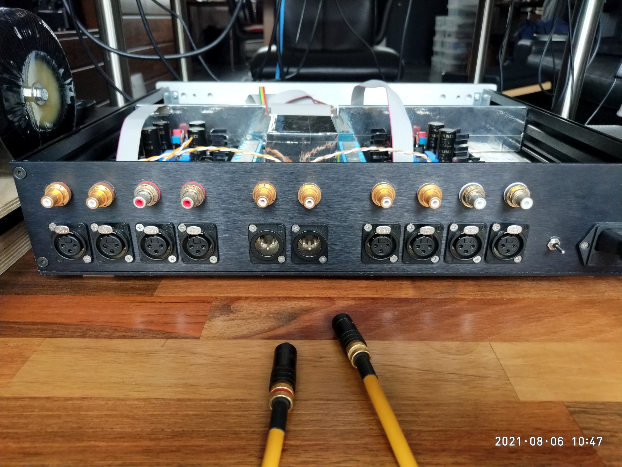

Here's the backplate of my SE iron pumpkin.
I've only used 4 of 5 inputs, 4 is still plenty for me.
The XLRs are not balanced but SE inputs and connected to the same RCA input,
so I can use SE XLR or RCA for the same input.
I use the very good Neutrik XLR NC3FD-LX-BAG NC3MD-LX-BAG connectors.

Yeah, I'll be using the same Neutrik connectors. They have the same form factor available for RCA and XLR, so I will have 2x RCA and 3x XLR inputs.

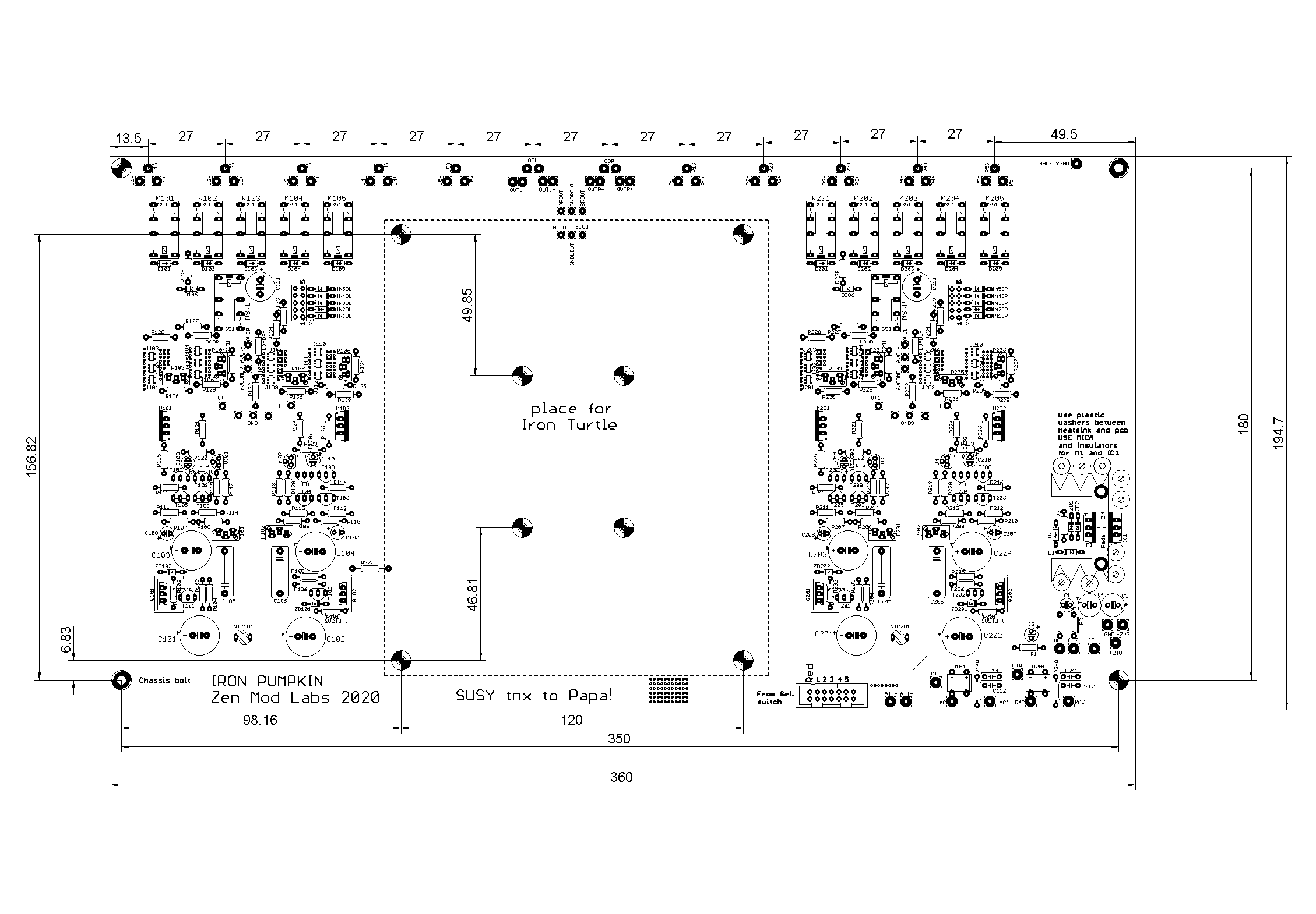

just a general reminder - you did put jumpers (for energizing 6th relay) for each SE input?
also, on SE inputs, input pad 3 must be shorted to pad 1 (tiny wire bridge)
regarding SE out, that's correct - using GND and positive hot
no need for grounding of rotary switches, relay PSU is anyway in all possible ways isolated from audio PSU
