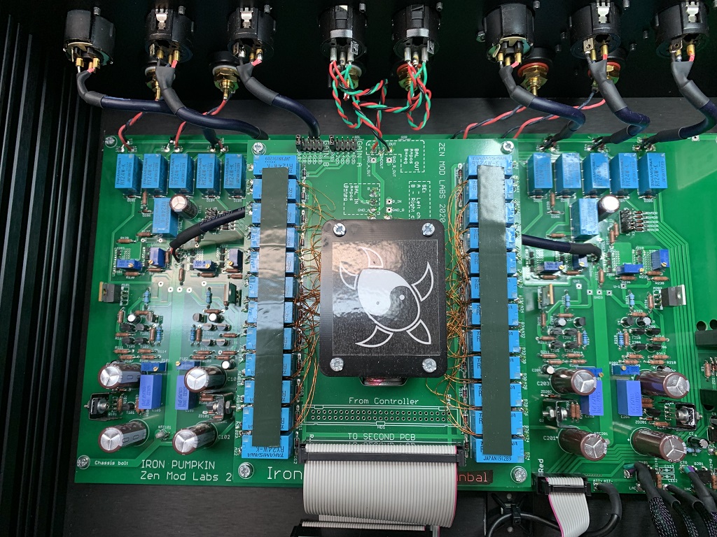

not really hum related in this case ( important in case of catastrophe) - those small NTCs in each PSU - are too small ; put ones having 8-10mm Dia

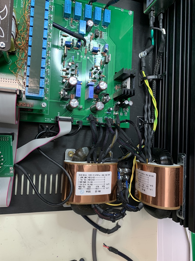

now - I know it's bother, but you must try - move those RCores outside ( at least 30-40cm) from box, then observe hum level
there is shorter way of trying it - try preamp in proper Bal In/Bal Out arrangement, and hum will not exist if everything is OK..... balanced operation will kill hum induced by magnetics

Just tried balanced input and output and same result...
I think I will change the transformers to test... Will use toroids and put everything away. Weird though as r-core have very low magnetic stray field.
Other than this, everything adjusted easily and properly and looked ok on the scope...

Just wanted to start with a big thank you to everyone who chimed in to help, this is greatly appreciated! 🙂

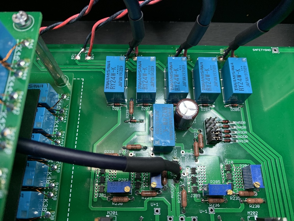

So... I ended up replacing those NTC with bigger ones, then connected a ground cable from the PCB chassis ground directly to the chassis star ground, isolating that standoff. All this didn't seem to do any good...
Then checking those all XLR and RCA jacks on the back and measuring ground to chassis and audio ground to chassis. Ended up noticing something weird with those male XLR... I bough a different brand (io audio) than the usual Neutrik just because Neutrik was out of stock... Something was weird with them... When I was measuring the chassis ground pin with chassis star ground on the Neutrik, I was getting ~0.02 ohm, but with both io audio XLR jacks, I was getting ~3.2 ohms... Something was not proper... I decided to scavenge on another preamplifier some male Neutrik and once installed, they measured like all the other ones ~0.02 ohm.
Once I connected the preamplifier, I was getting a lower fast hum, but increasing the volume did not increase the hum. Now I'll test fully balance and ear if it's still there.
Do

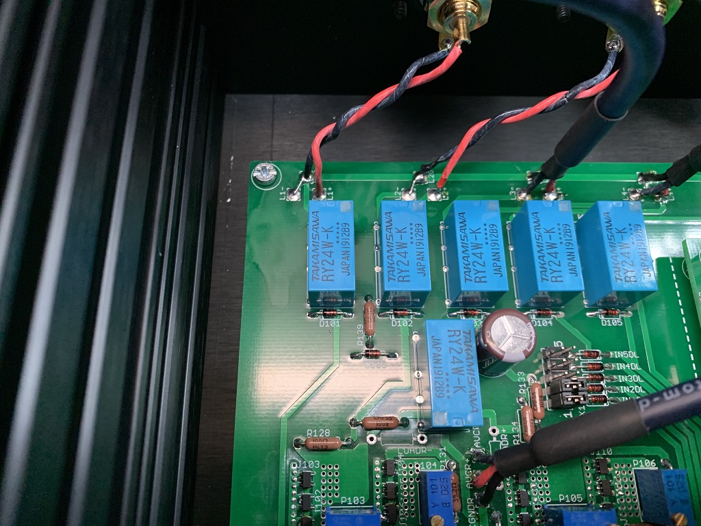

these two NTCs are connected to chassis/safety GND through bolt - mounting pad at left front corner of pcb; so be sure that there is continuity
easiest to check - each channel GND must show NTC value ref. to chassis
IEC mid pin - you can bolt its wire to chassis or solder to pad - right back mounting screw of pcb
ok, added bigger NTC

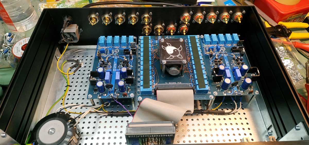

Tried just about anything, including external transformers (different ones) and nothing will do. It's only when I hit volume position 8 that the hum starts to be noticeable. Positions 1-7 is barely audible, you need to have your ear to the tweeter, but then position 8, hum starts... The infamous "bzzzzzz"...
I noticed that I have the best result when earth ground is not connected to chassis.

You will see in there two different power supplies (i mean just transformers), one internal and one external. On the picture, only the relays transformer is external, but I have tried fully external as well. Also, earth ground is also not connected as there's more hum when connected. I've also isolated the IEC inlet metal casing so it does not ground to chassis for testing.
